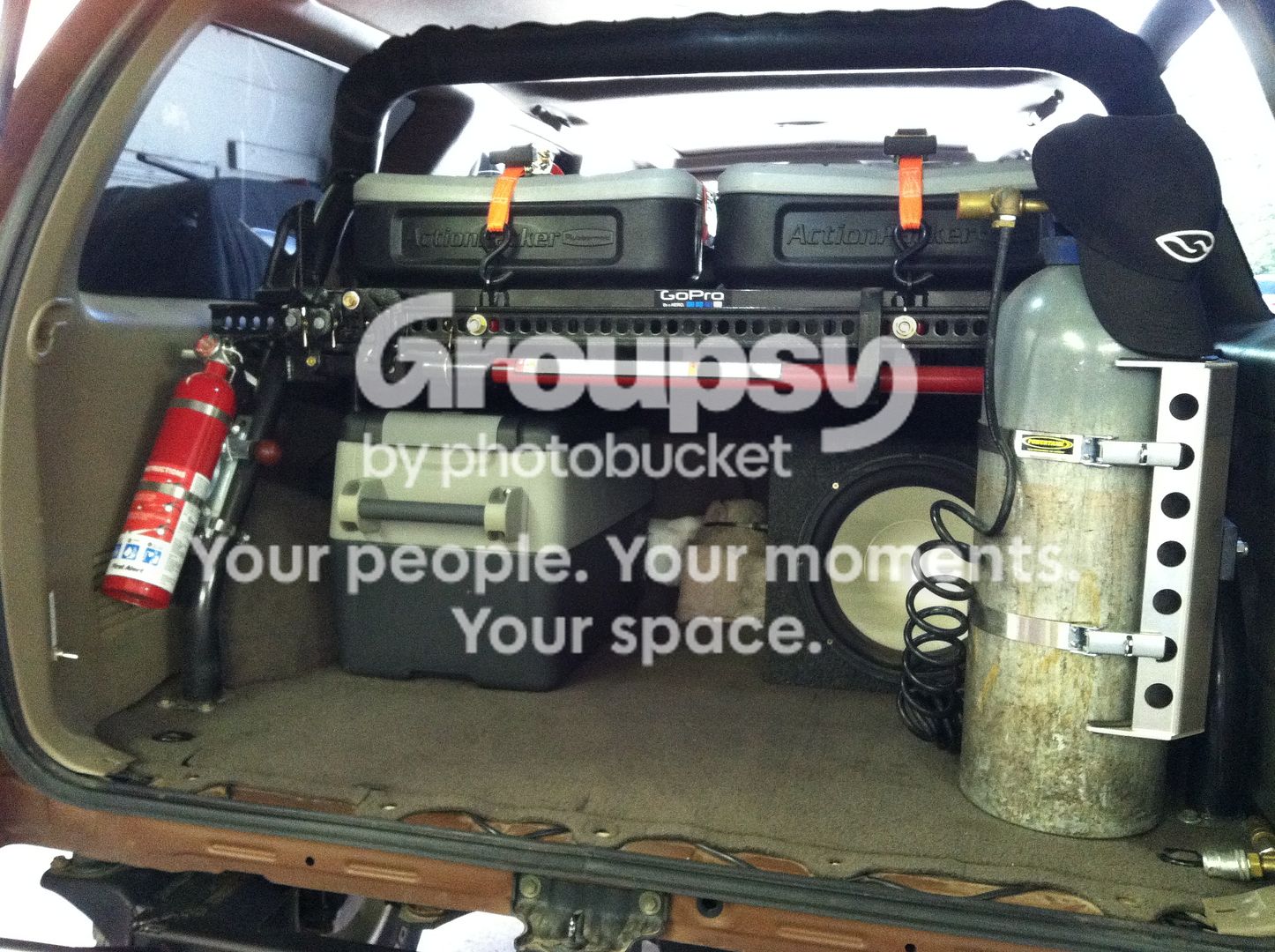

On a lighter note, I've been woking on making room for the fridge. I relocated the cargo rack two inches higher, I just need to make a slide out for it, and reorganize some of my gear.
