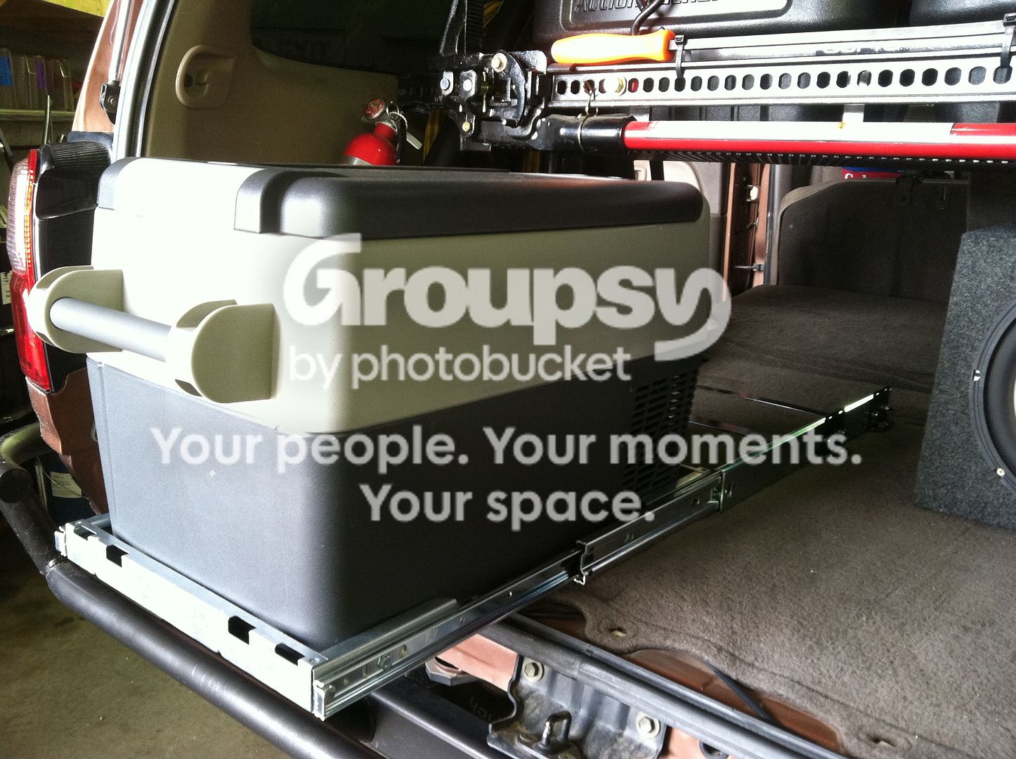

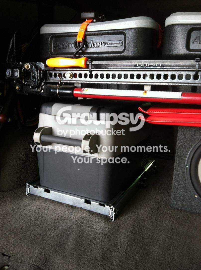

Next on the list was to get my fridge installed, it needed to be on a slide because of the upper cargo basket I have.

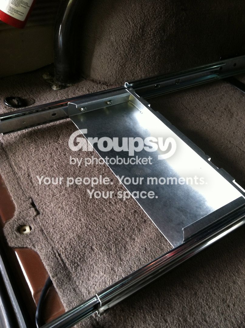

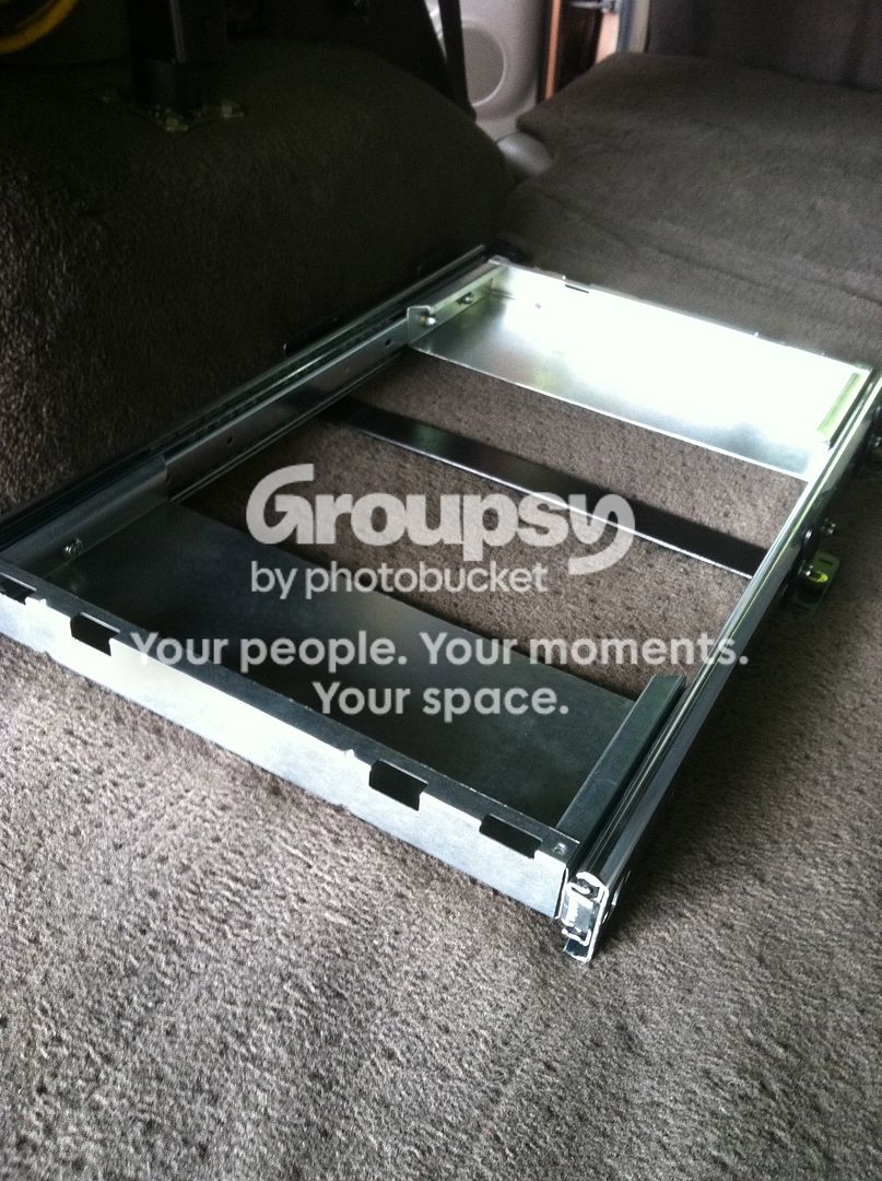

Ironman4x4 sells a fridge slide kit, but it's $290. That's way more than I wanted to spend!
Ice Cube Fridge Freezer Slide

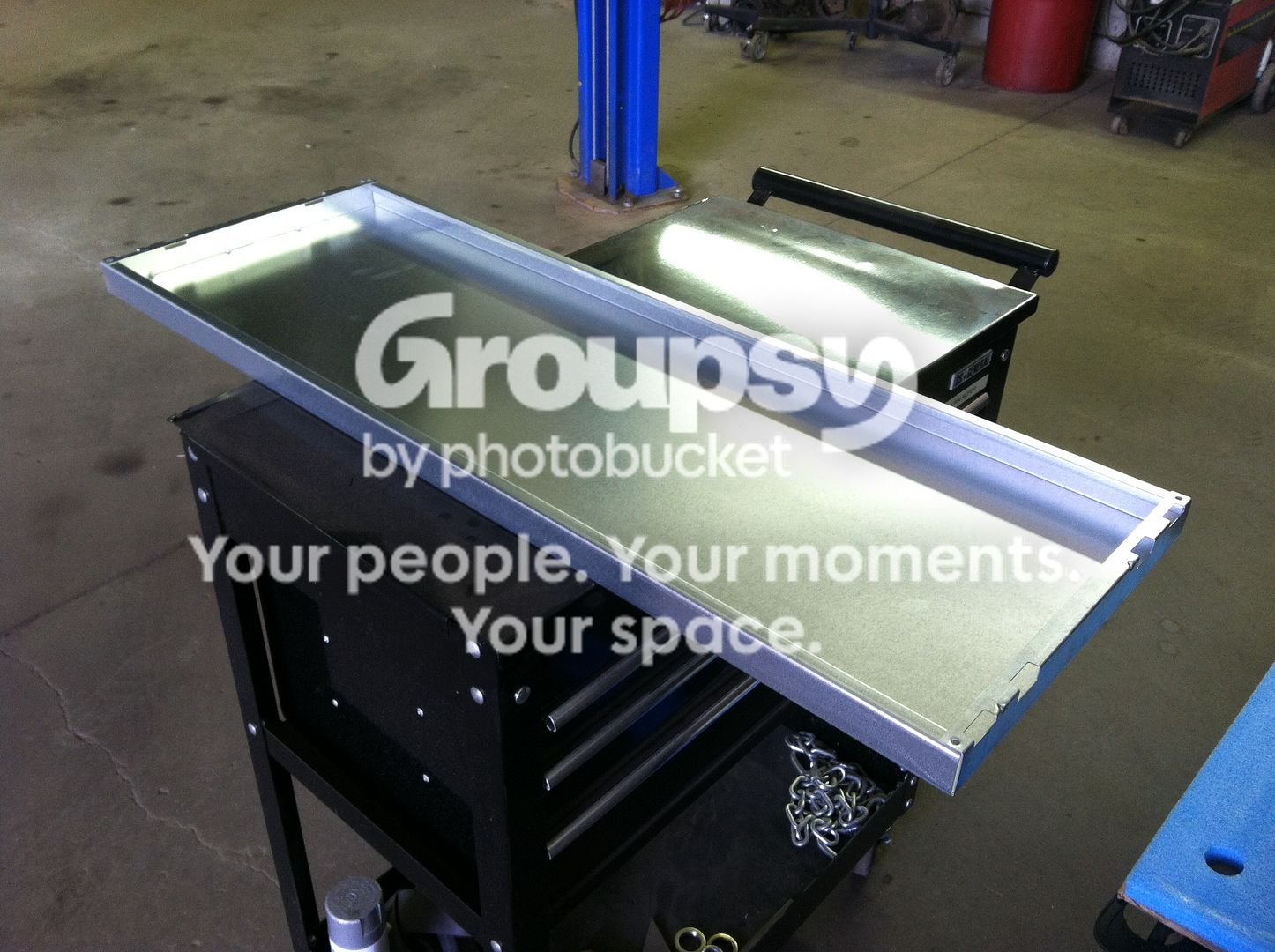

So I ordered some 200#, 24" slides off Amazon for around $40.00. Then I found an old shelf in the basement of the shop that fit the fridge okay.
I liked the idea of having the center open for increased air flow to the fridge; especially when the back of the 4Runner is packed, so I followed the design of the Ironman unit and built this. The lack of "excessive" material also cuts down on the weight.

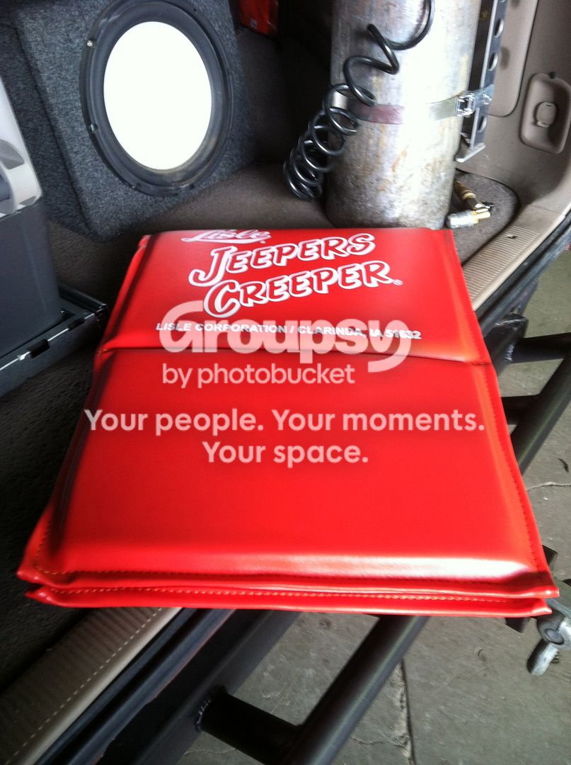

When I ordered the slides I also ordered a creeper pad (it opens up to a full size creeper). It should make times like this a little more bearable...

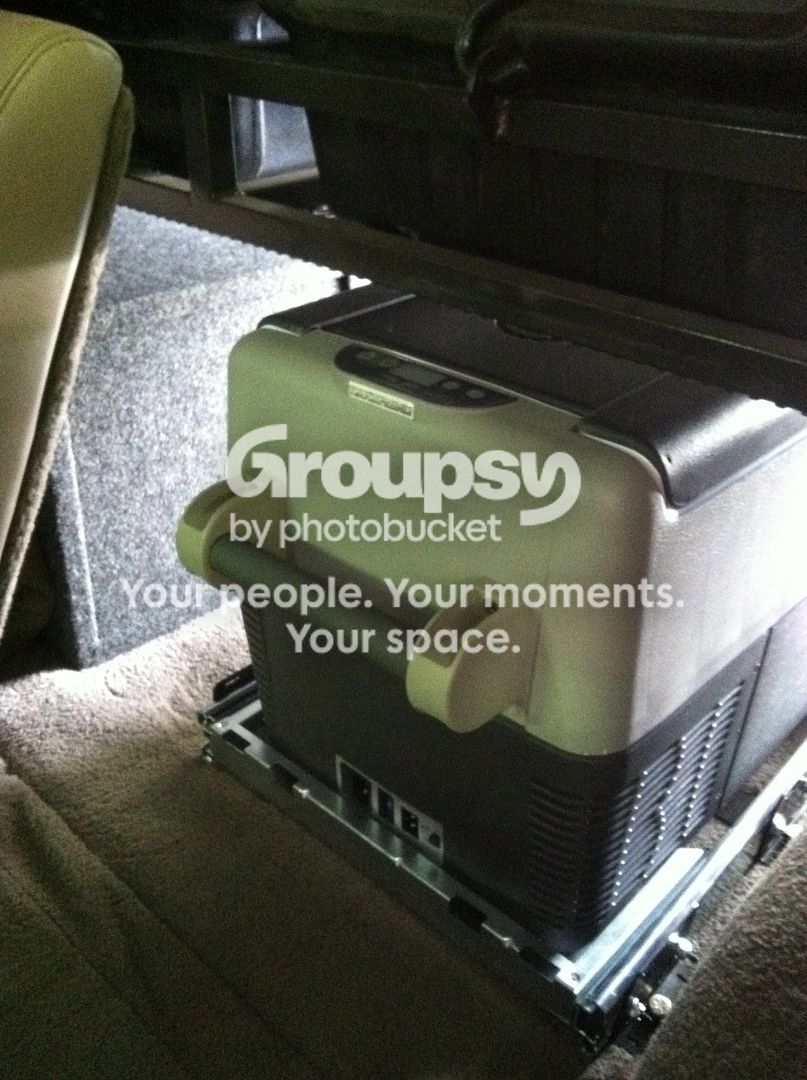

Behind the fridge there is still room for my spare CV; I always wrap it in a towel, with extra rags, gloves and a trash bag inside.

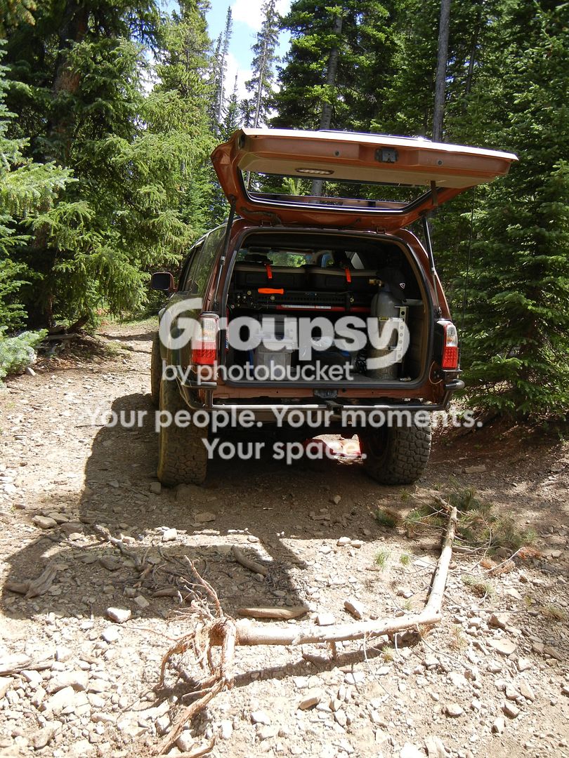

And, some how I managed to spear my truck! Luckily it only knocked one of the reverse lights loose and put a small dent in the floor of the cargo area, it came really close to taking out the rear brake line. It could have been a lot worse! The tree must have been just hardly in the trail (off to the side, at an angle), and I think the rear link guided it up over the axle. It jammed up into the cargo area, snapped, then got wrapped around the rear axle and uprooted the damn thing. I thought that I had just run over the edge of a tree and it bounced up and hit the skid plate. Nope, I was dragging around a tree…

So much for treading lightly! jk
:lmao: ^^^ that tree branch looks right at home
It would look better in it's real home, the ditch next to the trail! :D
I was Treading Lightly; the tree, not so much! :)
I didn't even see the damn thing, and it couldn't be more than a foot into the trail. I was trying to connect several trails together, which I accomplished, but there was a lot of dead ends and spurs that went nowhere. I also got a good amount of Rocky Mountain pin-stripping, but it was worth it. It will buff out and I have a couple new "low-key" wheeling spots that don't have gates. It's steep terrain so it's not ideal for deep snow wheeling, but there are still a couple other roads to check out in the area...

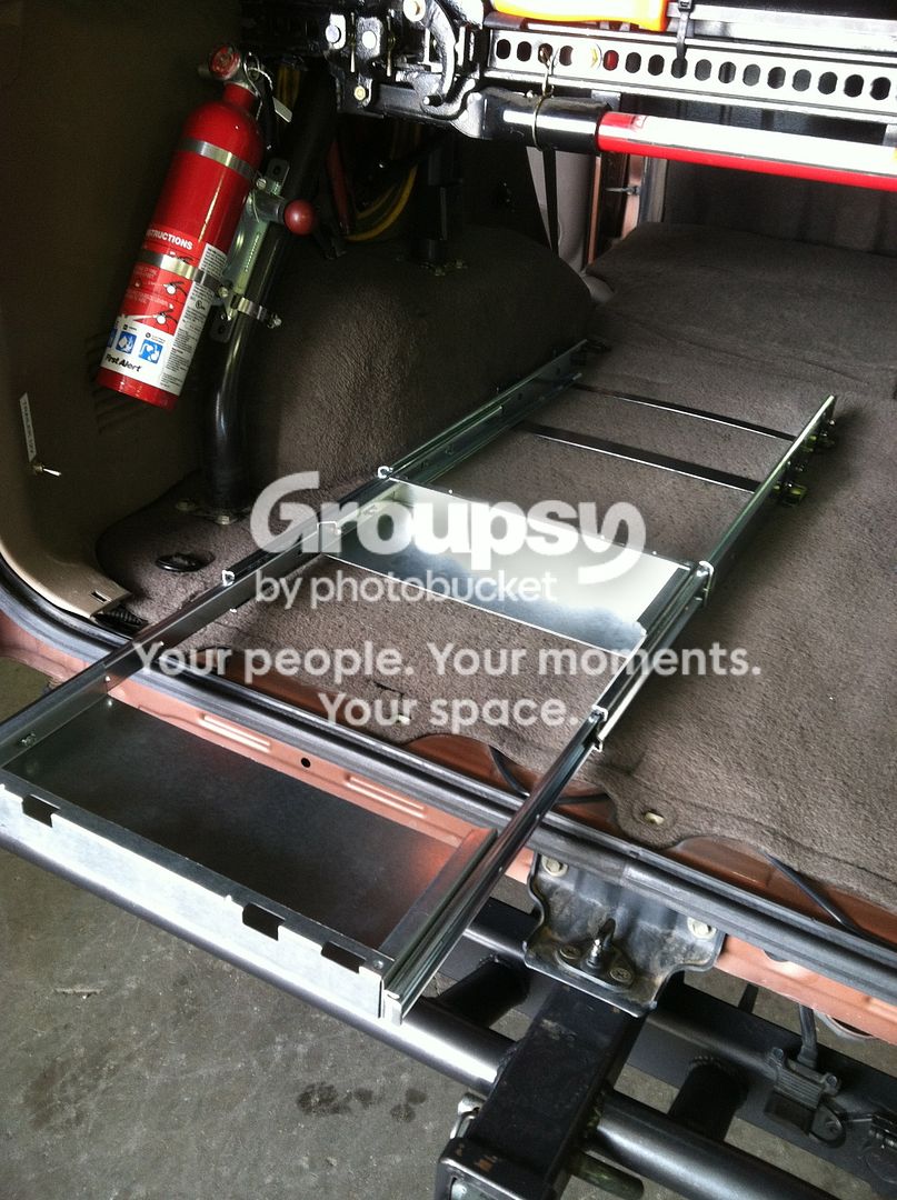

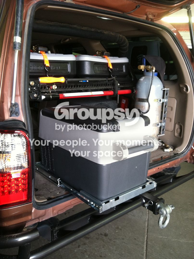

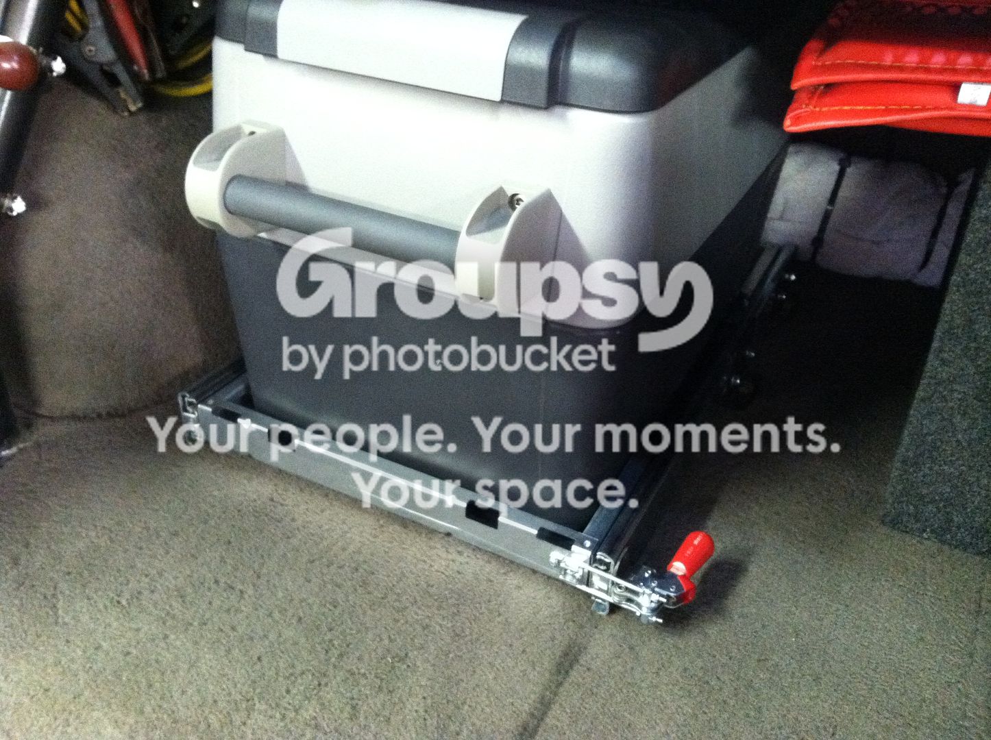

I got the latch installed on the fridge slide out, screws would have interfered with the slide so I welded it in place.
Also hard wired it to the fuse block I have in the back cargo area, so the power cord coming loose will be a thing of the past. I have some ARB fridge tie down straps coming, but it's pretty damn solid just the way it is.

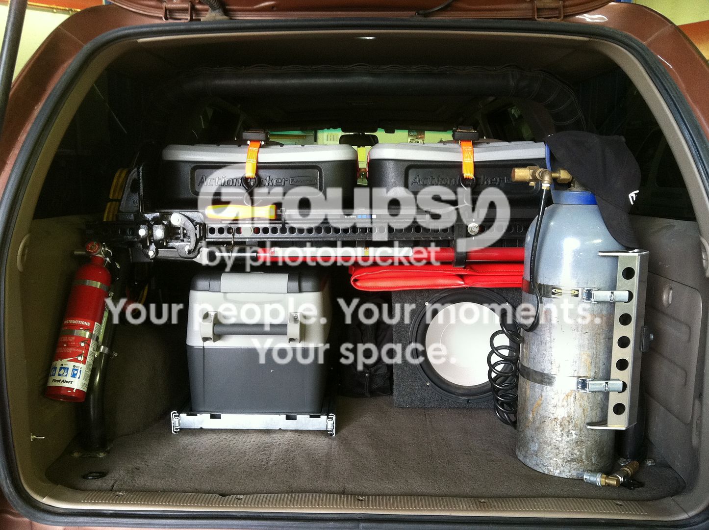

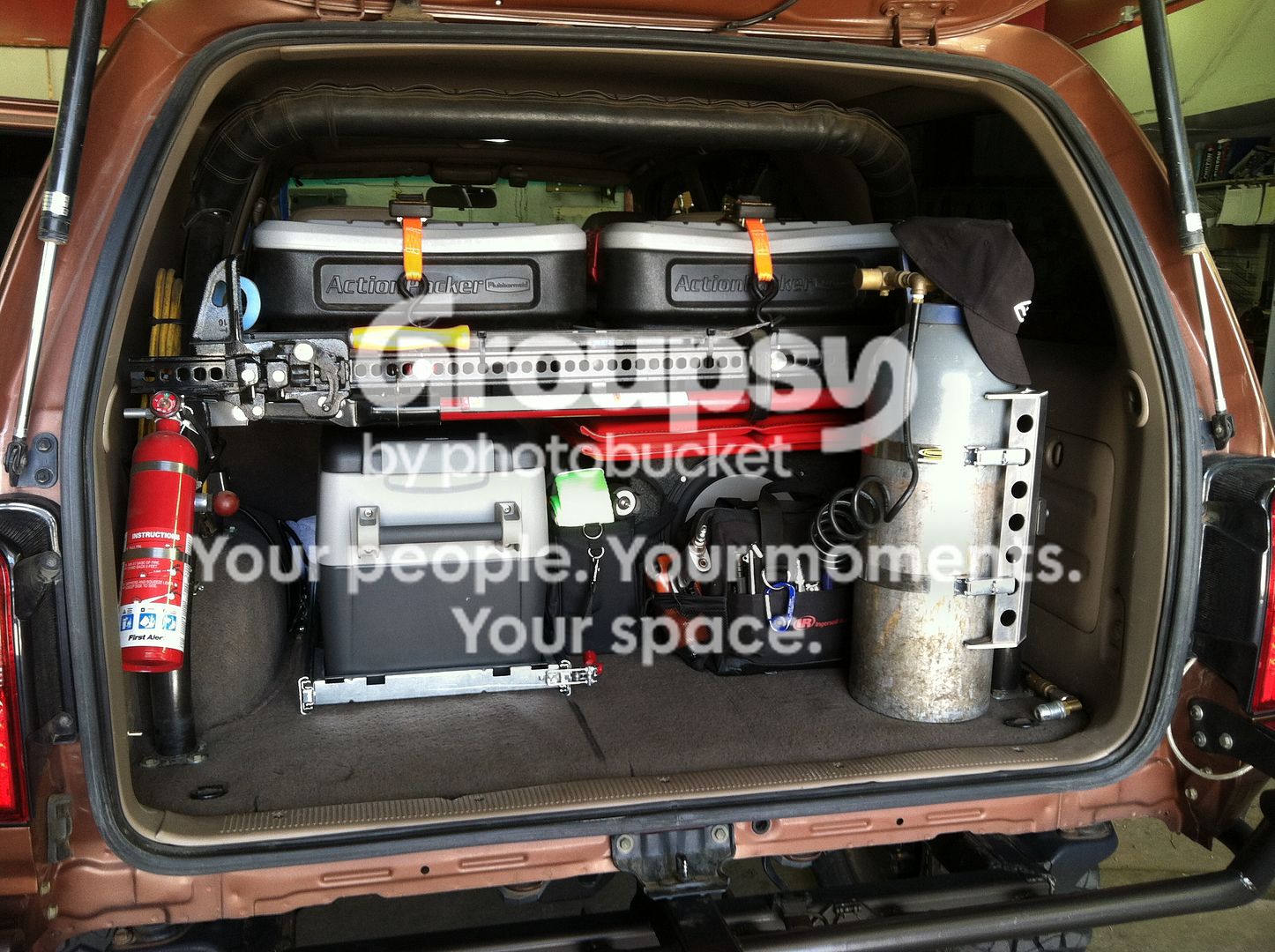

The fridge takes up more room than my old cooler, and I was limited on space before the fridge, so I needed to sort through my stuff and try to make some room. With some creative packing, along with using a smaller tool bag and recovery bag, I was able to get the back of the 4Runner down to this. I'll need to carry a winter survival/recovery tote for snow wheeling, but I had planned on that anyway.
I'm going to have to figure something out for my spare tire. I don't carry as much stuff as you but I don't seem to have room for the stuff I do. I admire how organized your cargo area looks, mine always looks like I just rolled the truck over lol.
