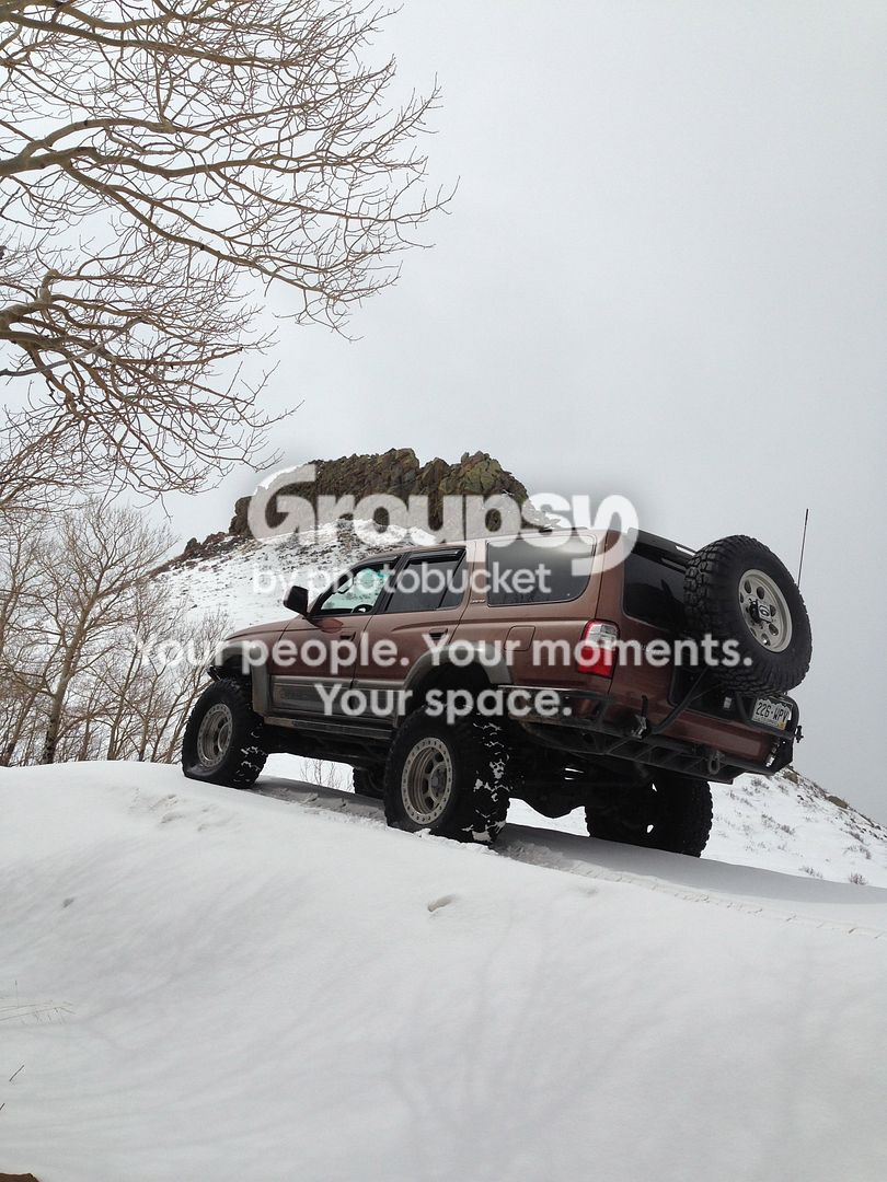

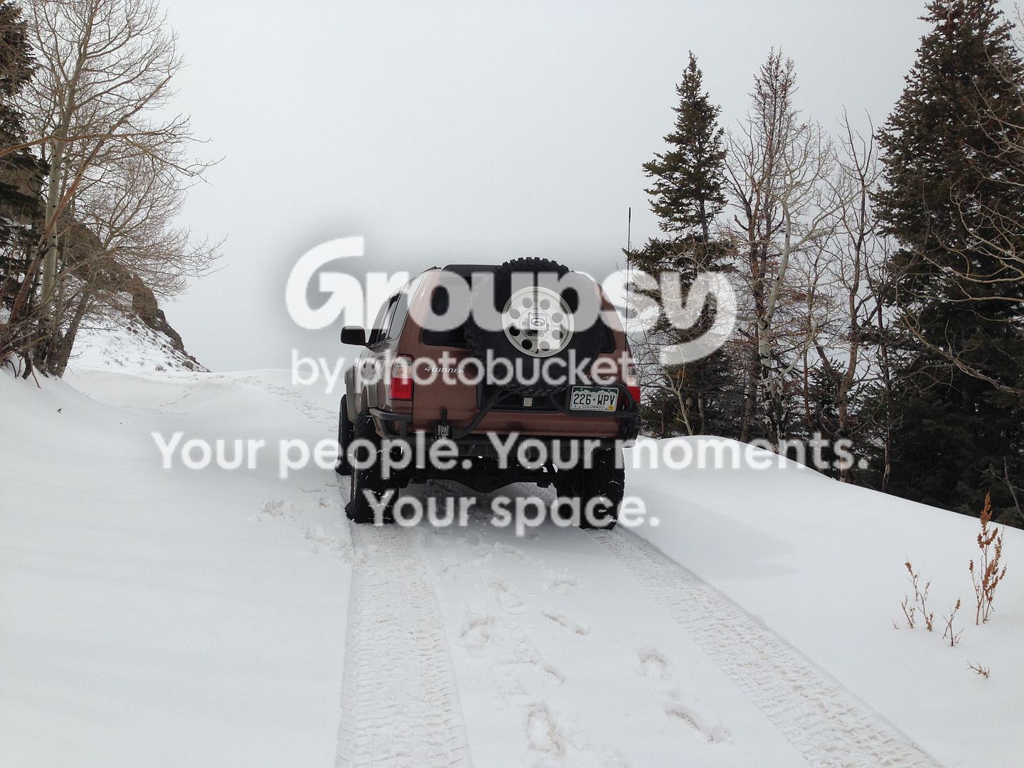

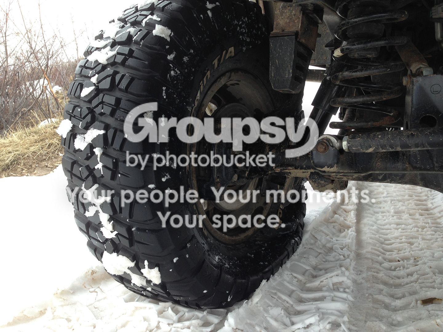

I took the 4Runner out snow wheeling last week, it's been a couple months since I have been out to my normal spot. It was typical early spring conditions, with deep snow, and an icy crust on top of sugary softer snow.
I started at 4psi, but I was breaking through the snow more than I liked. So I dropped down to 2psi and was able to stay on top of the snow for the most part. I fell through a couple soft spots and had to dig out twice, and winch once. All in all it was a fun trip!
