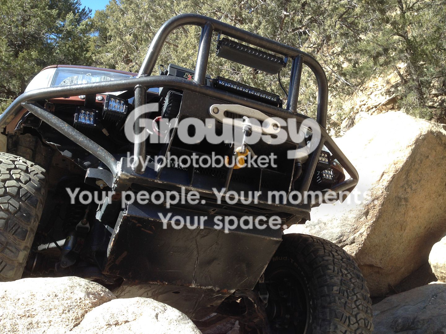

I used the 4Runner for a couple months to commute back and forth to work, and that really took a toll on it. It was only around 30 miles a day, but it was the road conditions that became an issue. It’s been a rough winter, and CDOT has been using gravel and mag-cloride like crazy up here, it’s nasty shit!

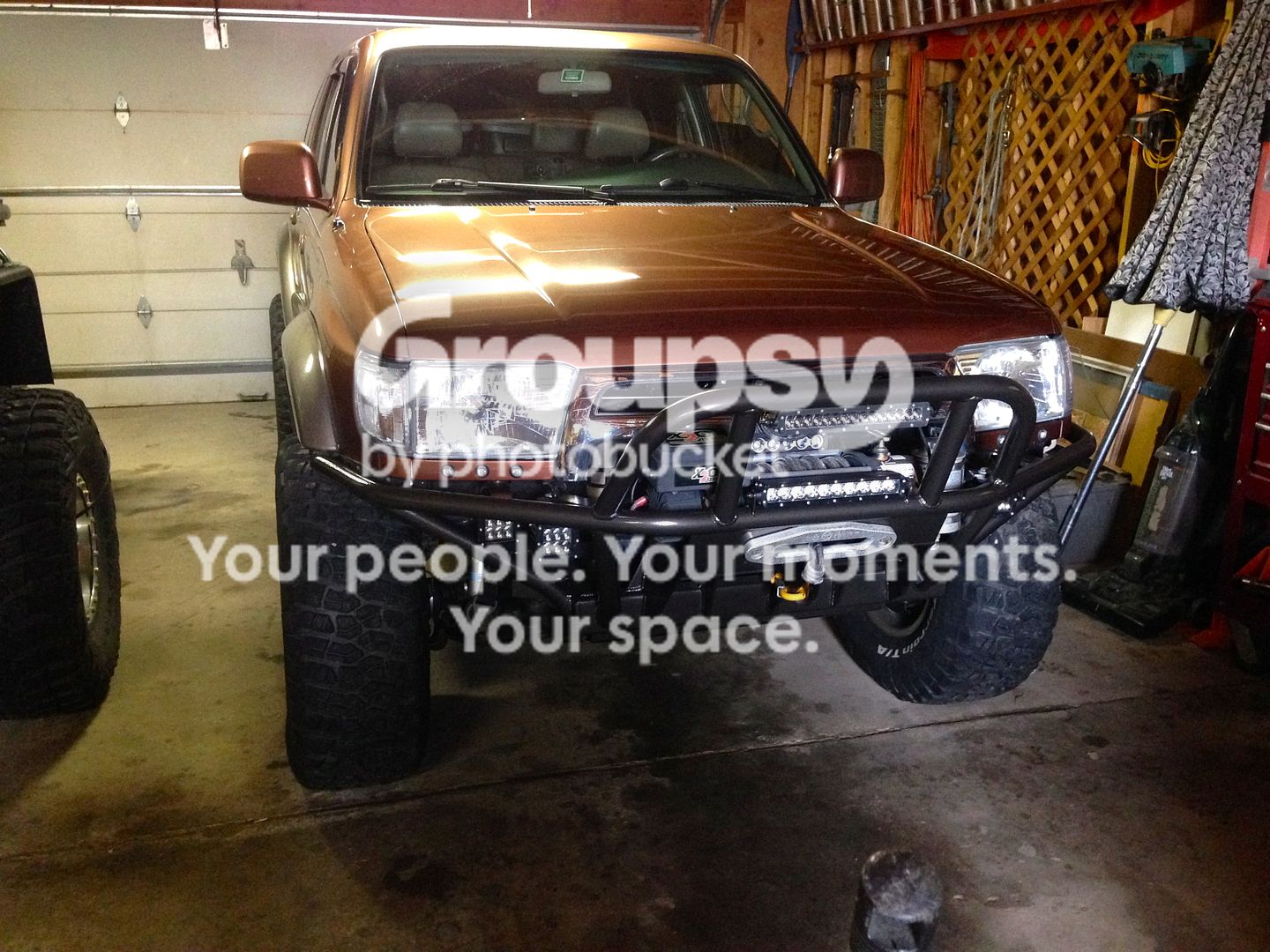

I started by repainting the front bumper, rear bumper, tire carrier and rock sliders; the gravel chipped the paint, and the mag-choride started pitting the metal below. I wanted to stop the process before it became so bad that major repair was necessary.
You can see how bad it was getting from this picture:

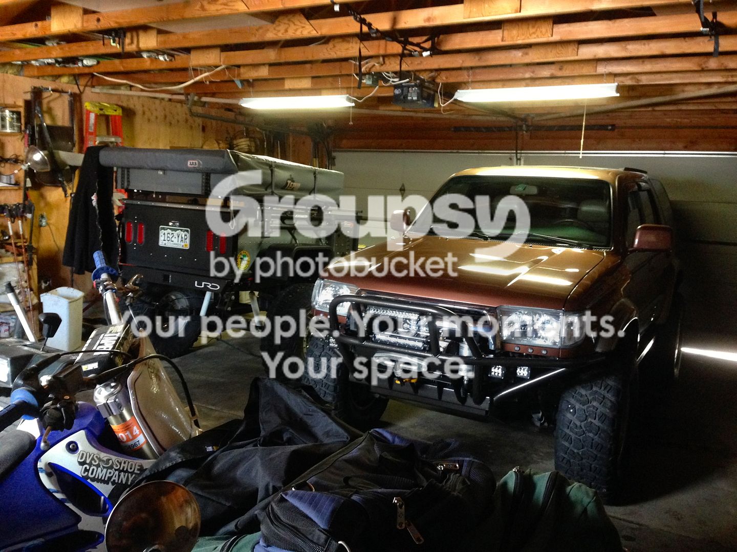

I used my Dad’s garage to sand everything down and repaint. It’s the same place the trailer is hanging out until it warms up. The undercarriage needs some touch up paint, and the wheels need polishing really bad (due to the same reasons), but that will have to wait until later this summer when I have more time.

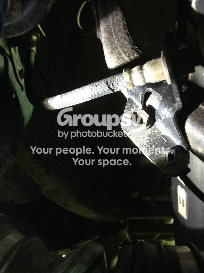

While giving the 4Runner a good once over I noticed the front brake lines are dry rotted and cracked, bad. So I ordered some braided stainless steel replacements from Wheeler’s Off-Road. I’m just glad I caught it before the trip; loosing the brakes with the trailer behind the truck would be bad, on a trail like Hell’s Revenge or Cliffhanger it could be even worse!

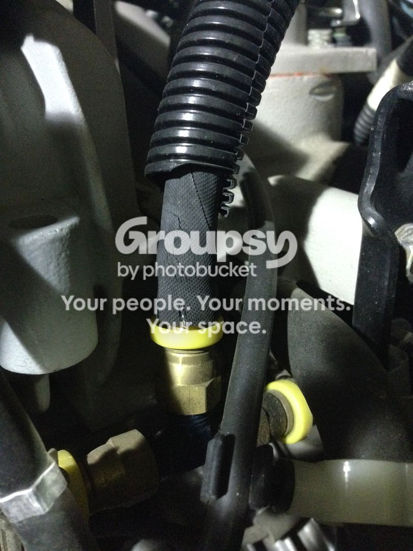

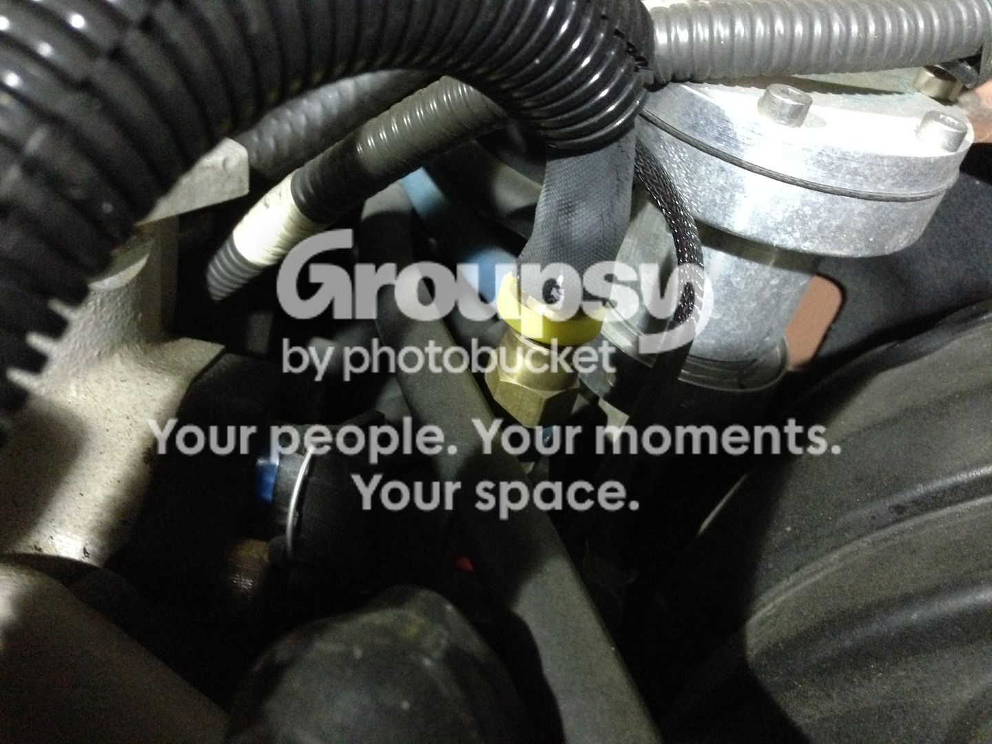

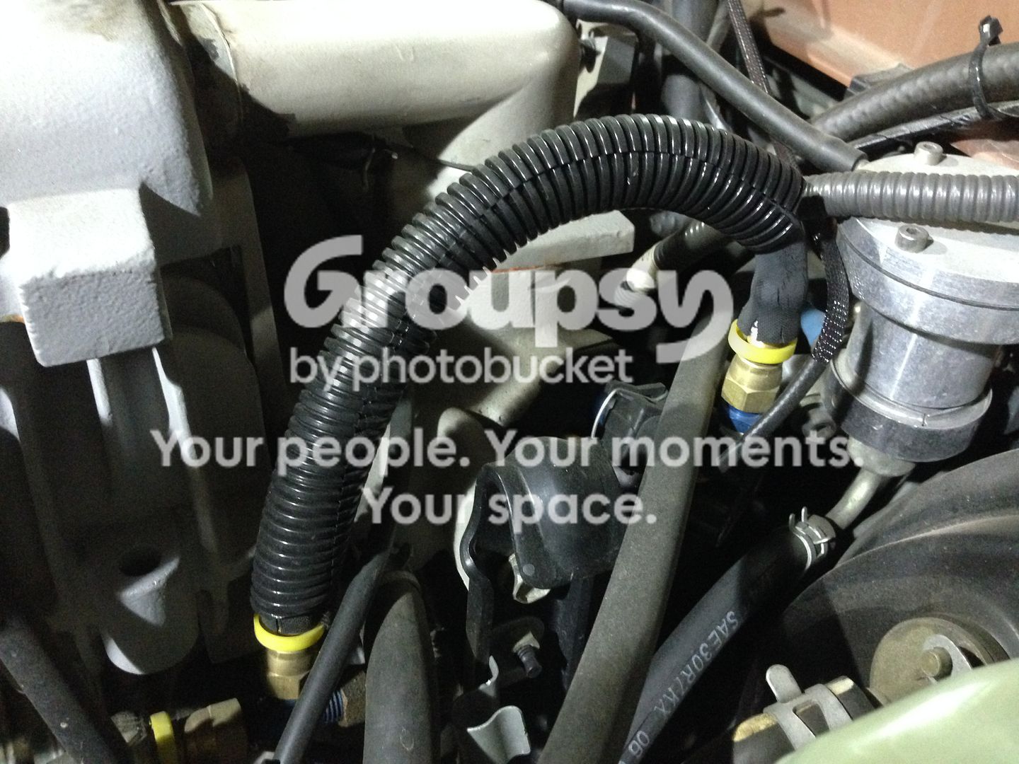

I noticed the fuel line for the URD 7th injector kit is cracked pretty bad. I wasn’t thrilled with this hose set up when it came with the kit, and it confirmed my fears (I think the newer kits come with a braided stainless line). For the time being I think I will heat shrink the ends, and then hose clamp them. After Moab I’ll talk to URD and see about replacement options.
I had the same crappy URD line, they sell the replacement fuel line for like $35 or so. Much better
Thanks Casey! I would much rather replace/upgrade the thing than try and rig something up. I'll call URD on Monday and see if I can get the new line in time for my trip.
