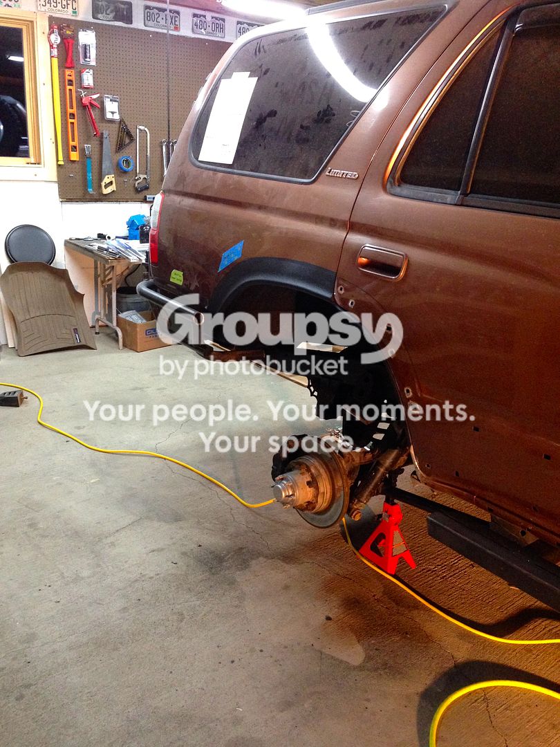

That actually looks pretty good. I was a little concerned when I saw you cutting the fenders and such, but I think you did a good job! Do you have any pictures from farther back so we can see what it all looks like together?
I was little concerned too, but once it starts coming back together it's not so bad! :)
I have cut the fenders out of my last three rigs (from mild to extreme) so I had a good idea what I was getting myself into. I'll see what I can do for pictures, my garage isn't very big and it's hard to get a good side picture.
Edit: I looked through a couple more pictures and this is the best I have.

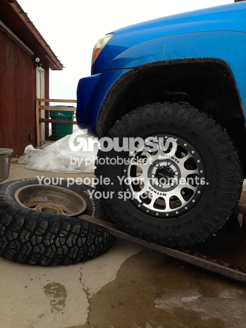

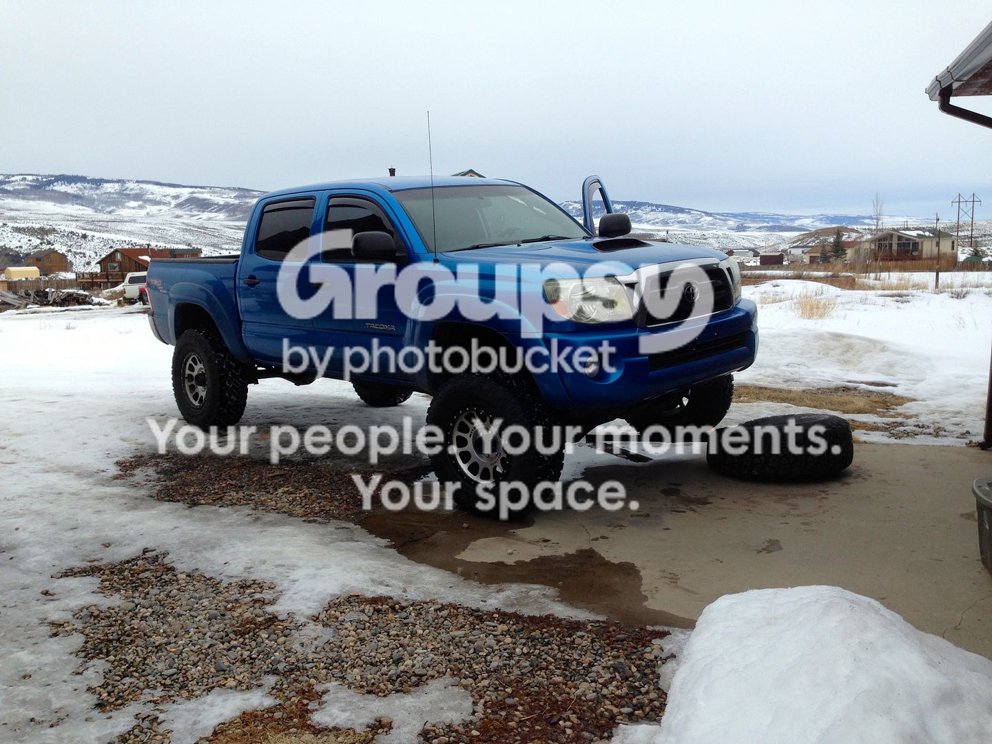

I really needed to get a tire mounted so I could check for firewall clearance. The nice thing about beadlocks is you can do it at home, as long as you can find a way to break the inside bead. Here is what I came up with, the Tacoma and a heavy wall piece of steel tubing.

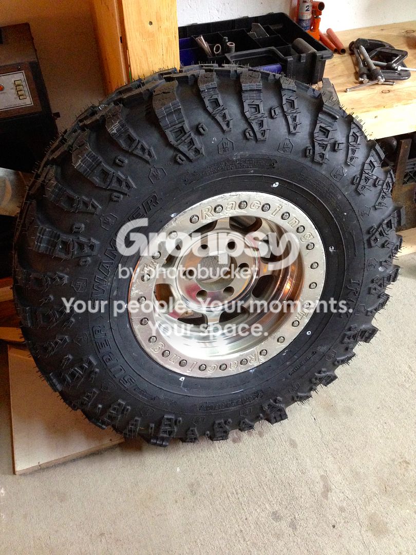

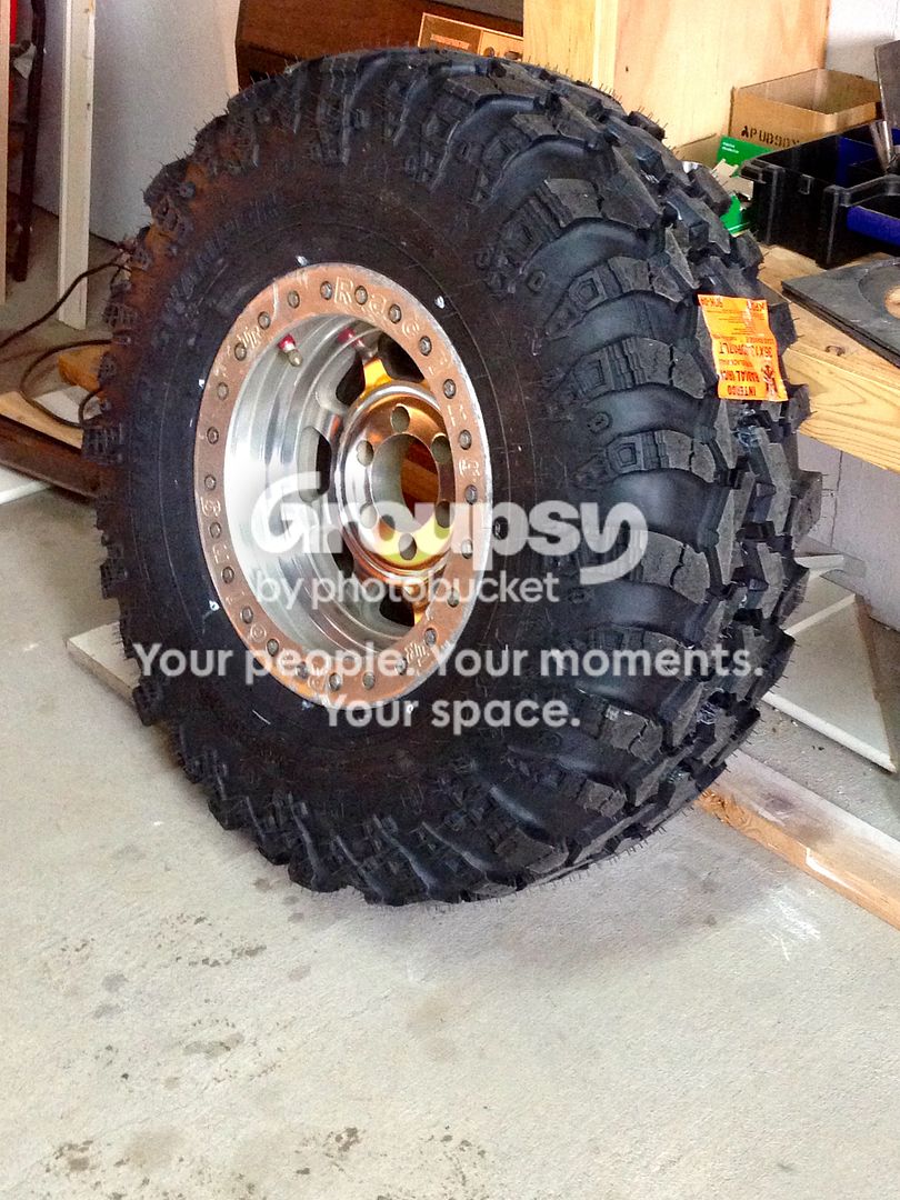

And here is the first tire, ready to go! I still need to balance it, but I’ll take them all to work and balance them at the same time. Also, while it was apart I polished the inside face of the wheel.

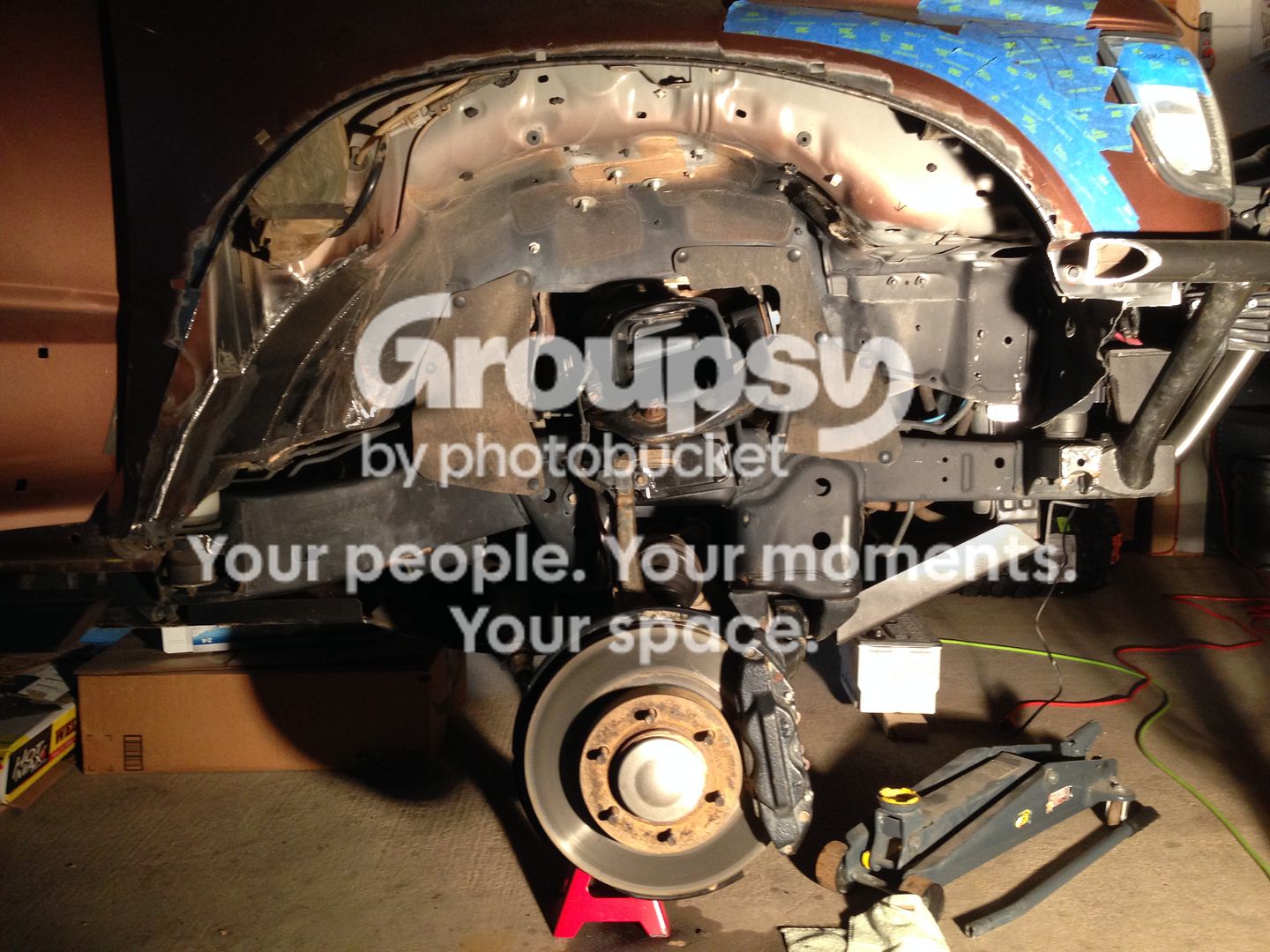

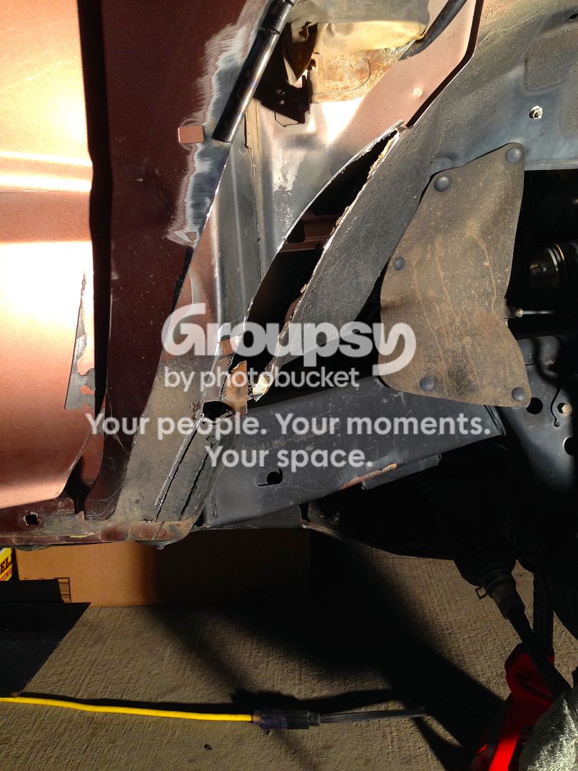

Cutting through the firewall and into the passenger compartment can be a daunting task (all the more reason to jump in and get it over with). I know [MENTION=63060]rickashay[/MENTION] can relate to me!

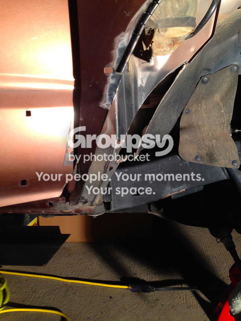

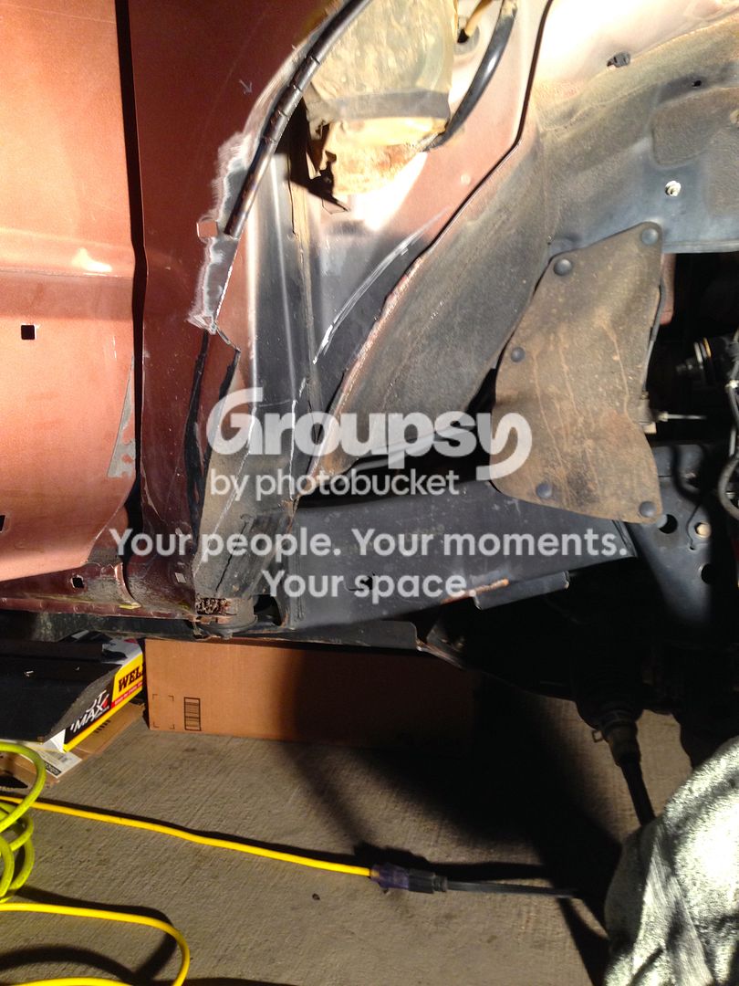

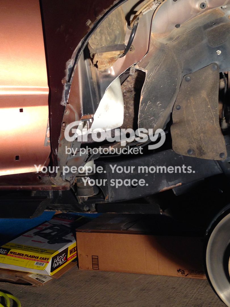

Here is what I was starting with; I did a small trim job on it when I first built the 4Runner to clear the 35’s, but they still rubbed a little (especially once I got rid of the sway bar).
Round 1

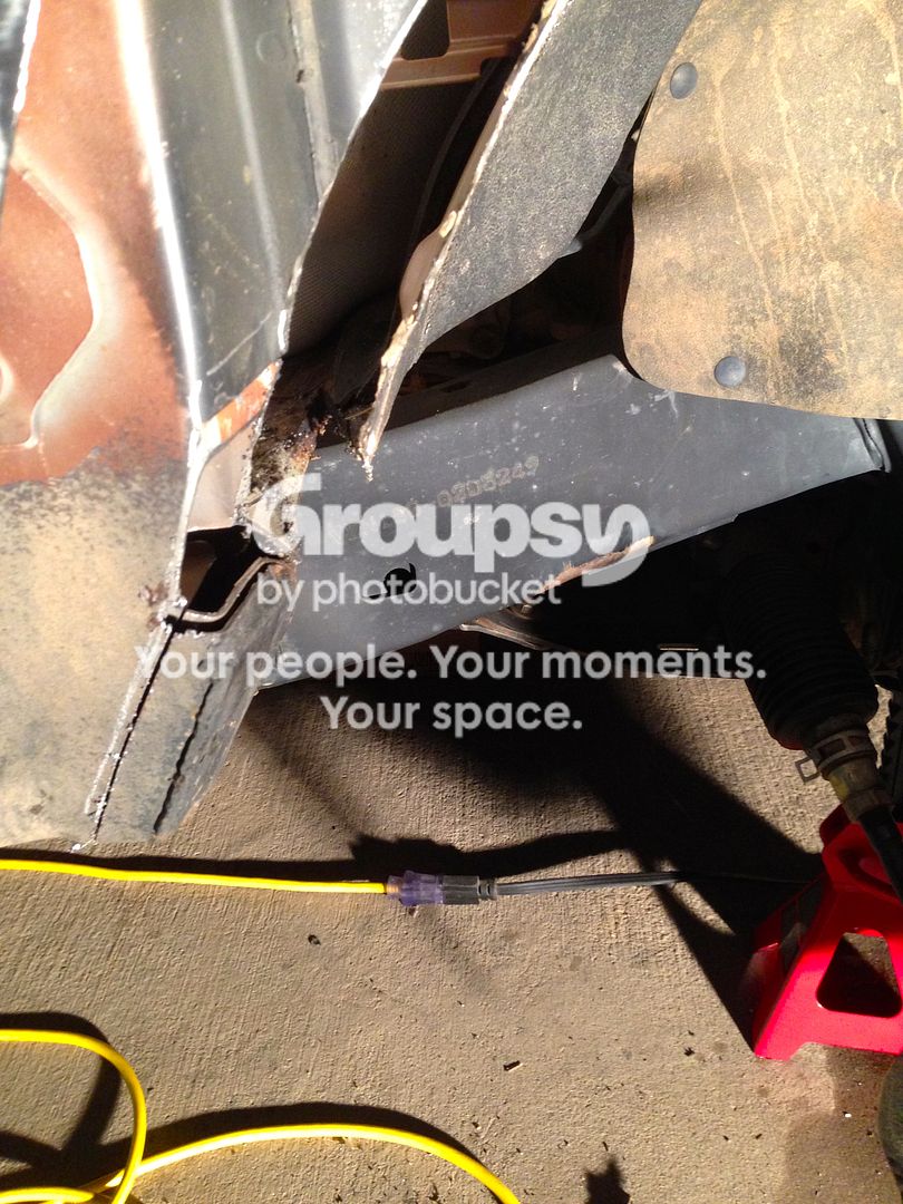

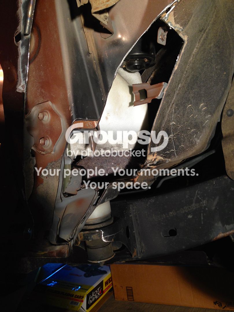

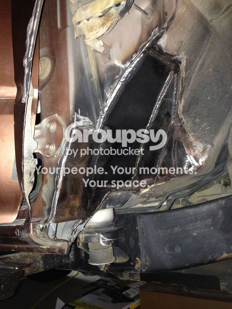

I thought that was going to be enough, but when stuffed at full lock it rubbed pretty hard. This is the kind of job you only want to do once, so out came the cutting wheel again…
Round 2

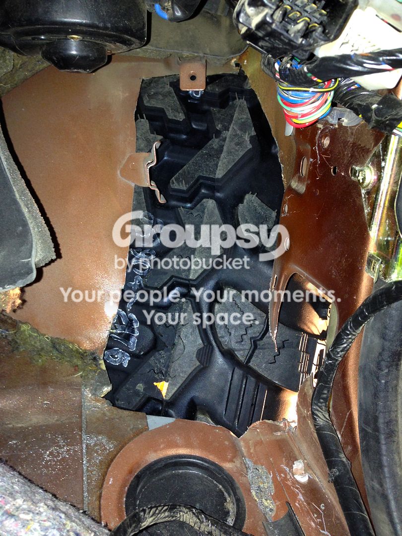

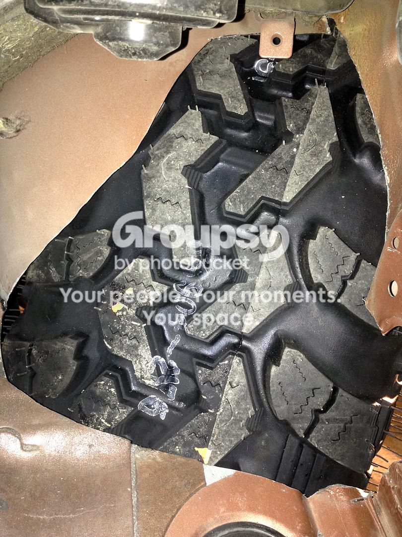

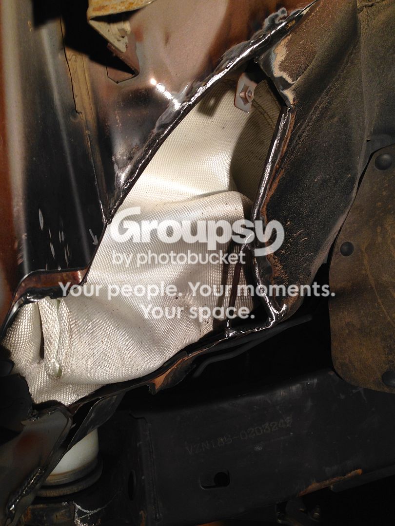

Here is the view from the inside; the tire is rubbing on the left side of the opening.
Round 3
Yep, that’s a pretty big hole in the floor!

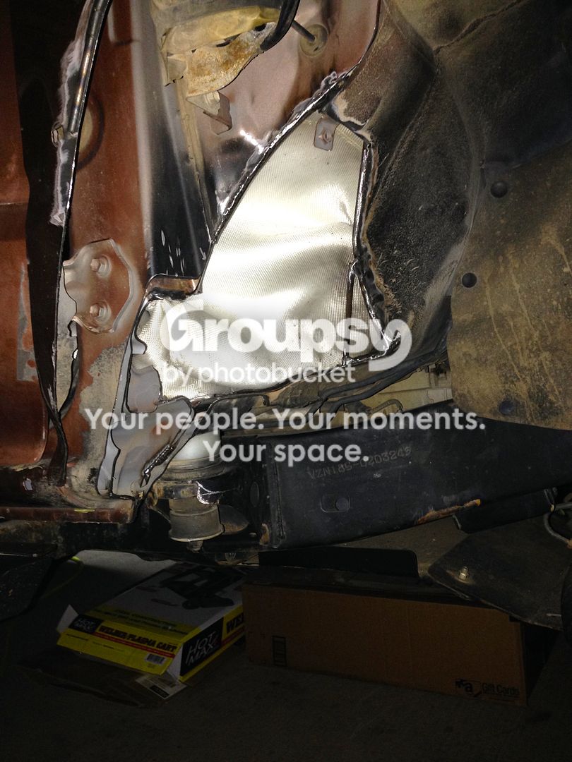

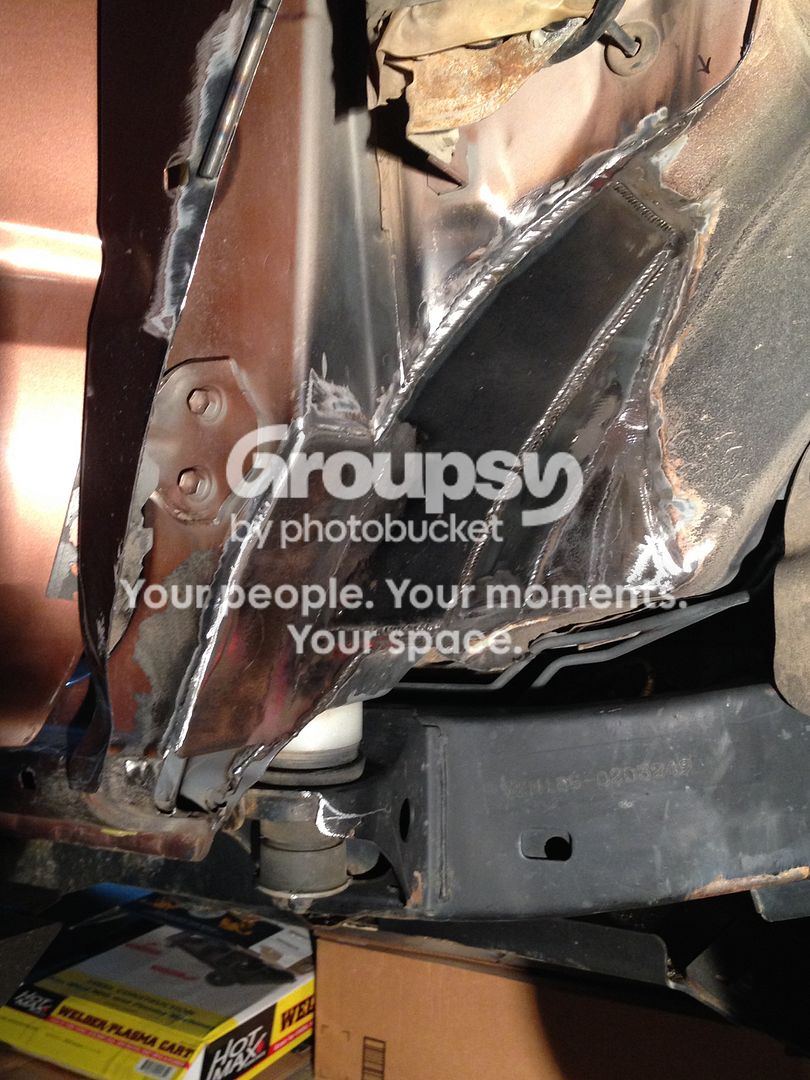

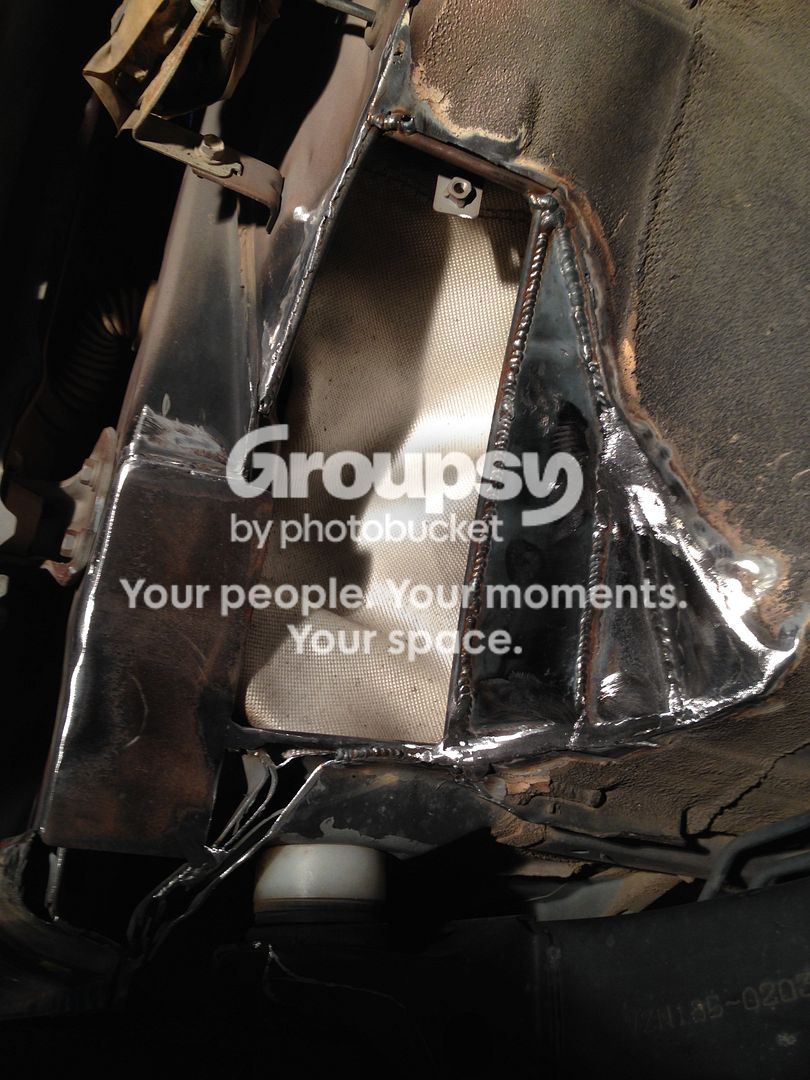

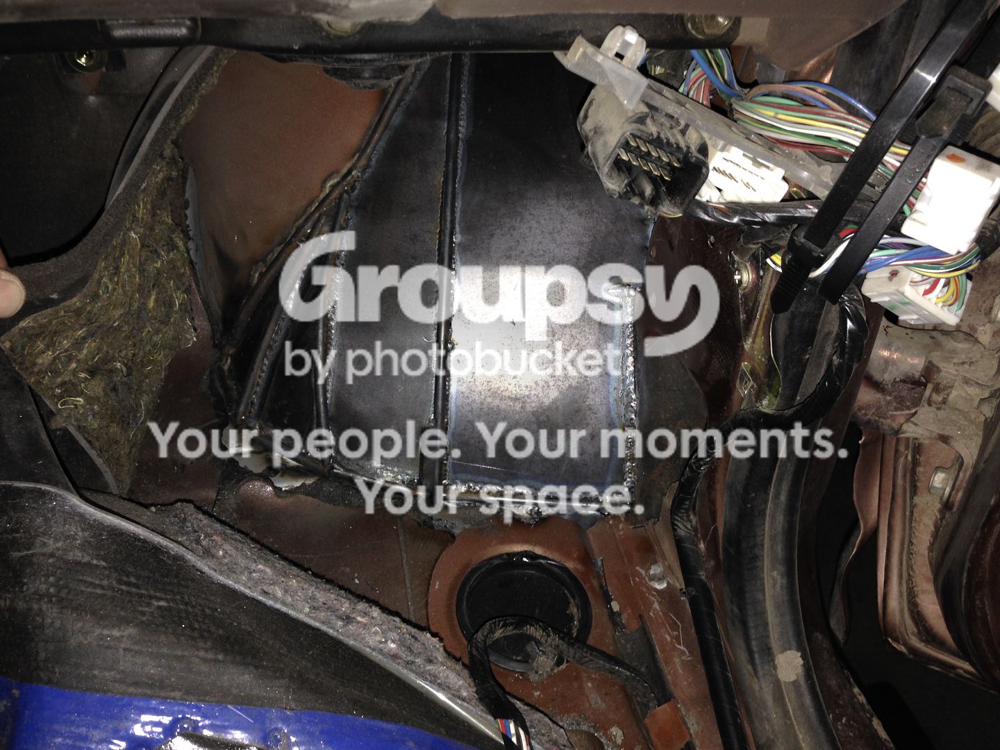

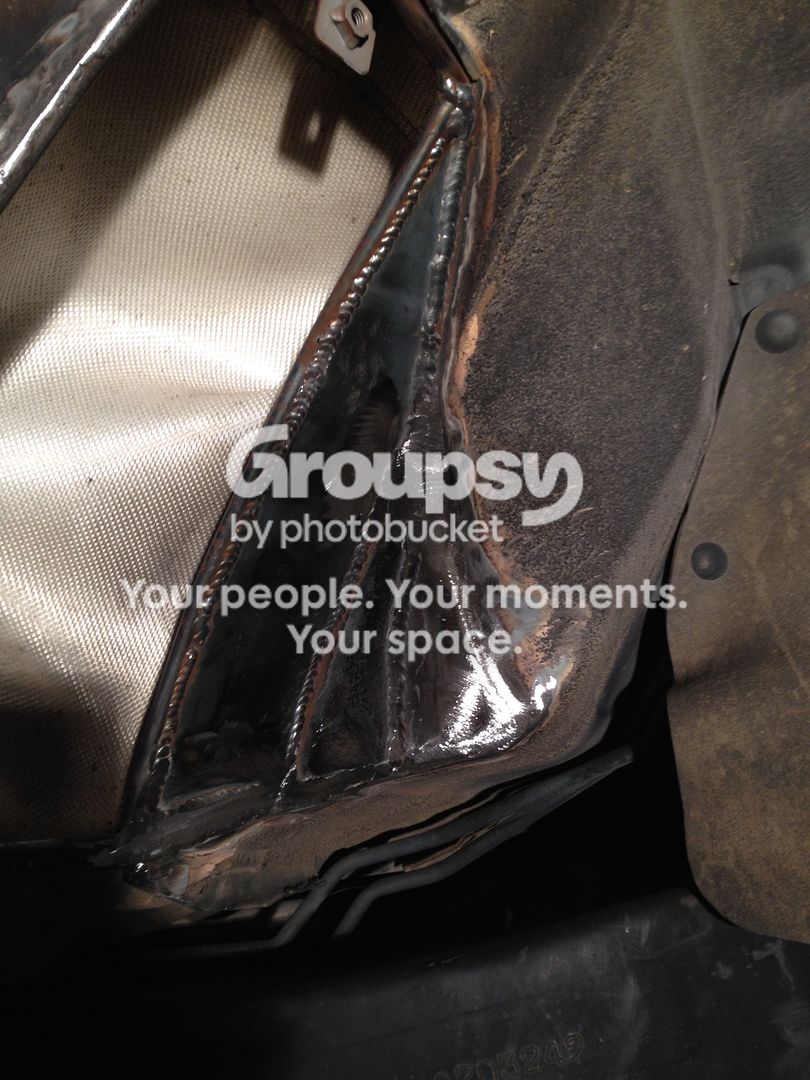

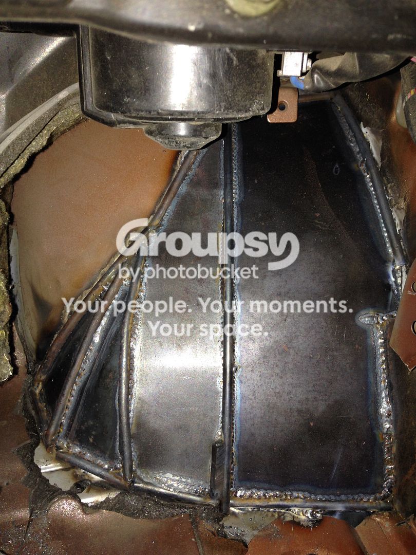

Most people just weld in a piece of sheet metal to cover the hole, but with this large of an opening I wanted more structure. I started by contouring and welding 1/4” round rod around the edge of the opening.
Then I added some sheet metal and 1/8” plate
