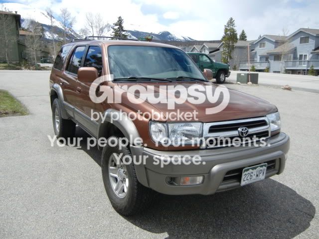

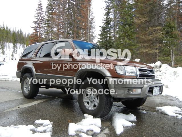

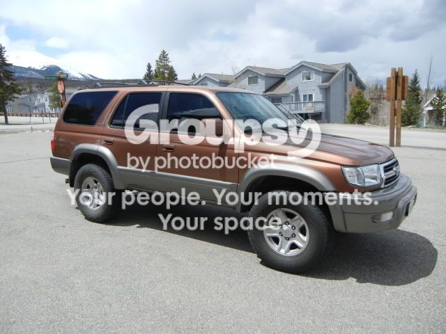

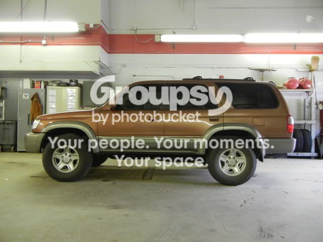

And here is the 4Runner shortly after I got it. I removed the running boards, trimmed the rear mud flaps and installed the clear corner marker lights.
1999 Limited 4Runner - Autumn Blaze Metallic
Supercharged 3.4
Auto
E-locker
115K

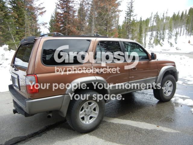

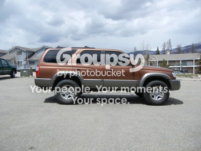

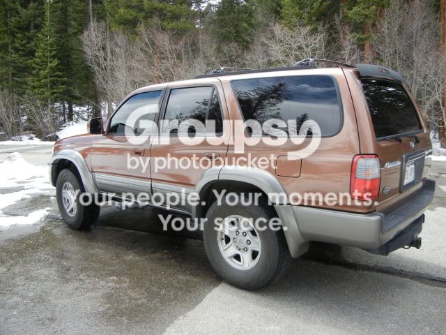

And a couple side shots for future reference… ;)
DSCN0278.jpg~original
DSCN0277.jpg~original
wow, sexy ride. I've never seen that color before

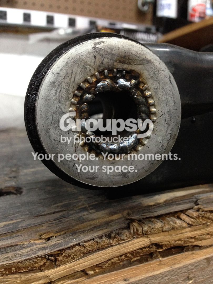

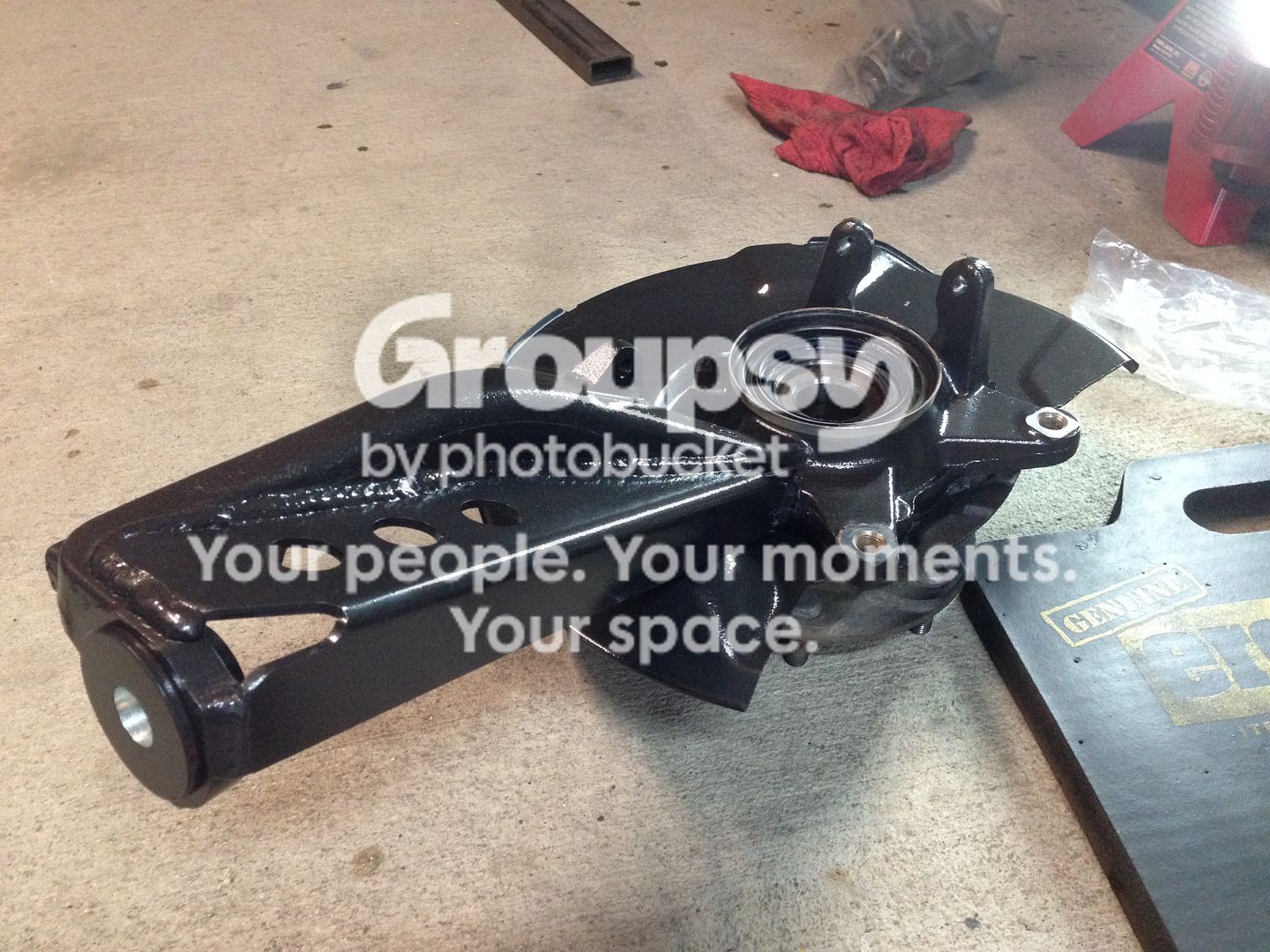

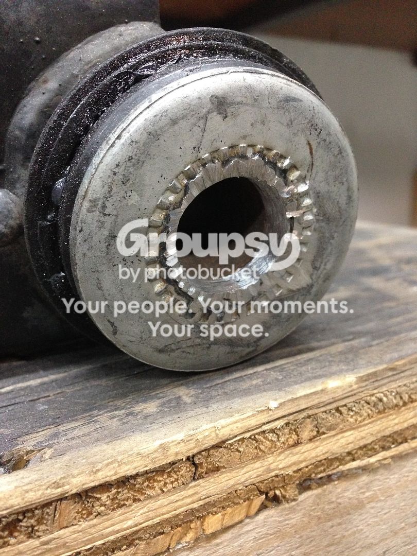

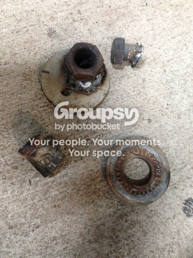

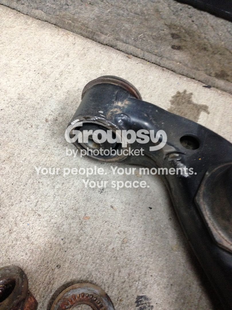

I bought a set of stock LCA’s a year or two ago to install Energy Suspension bushings in (when the time came). You have to reuse the inner and outer sleeve, which makes it a pain in the ass. I got the new bushings in, but it wasn’t very fun and it sure was messy. I tried to remove the old LCA’s but there was one frozen alignment cam. I welded a nut on the cam to try and break it loose, but that didn’t work and it just broke off. I ended up just having to cut the cam out with a grinder; luckily I had the spare cams to replace the broken one.
In order to replace the bushings you have to press one of the outer washers off of each bushing assembly. I wasn’t very happy about how they fit back together, so I welded the washer back to the inner bushing.
And I cleaned it up to fit (I also added some notches in the weld to give it a little extra bite).

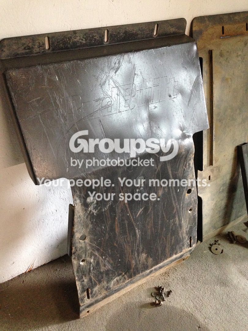

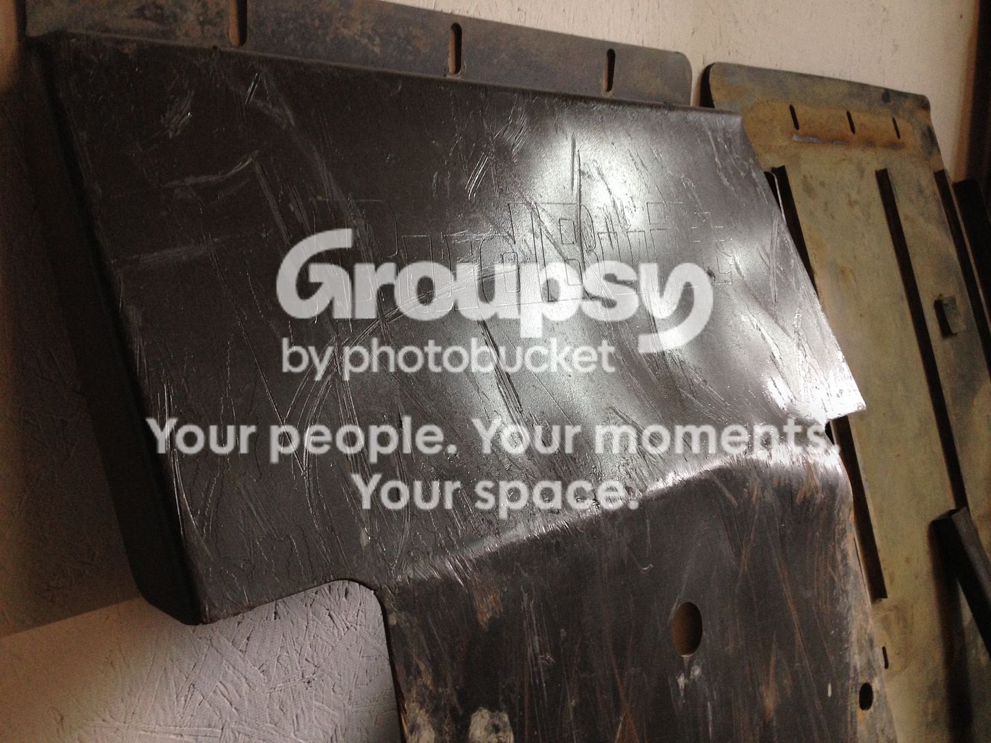

I also installed the Safari LTD steering rack, it was a little difficult due to the fact that the back side of the skid plate mounts to the steering rack, and everything was a little tweaked. I made it work, but I’ll need to add some better support for the skid plate down the road.
Pictures of said skid plate.

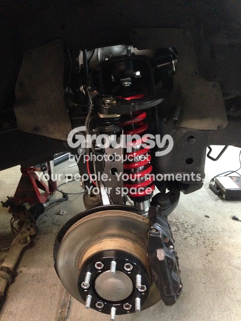

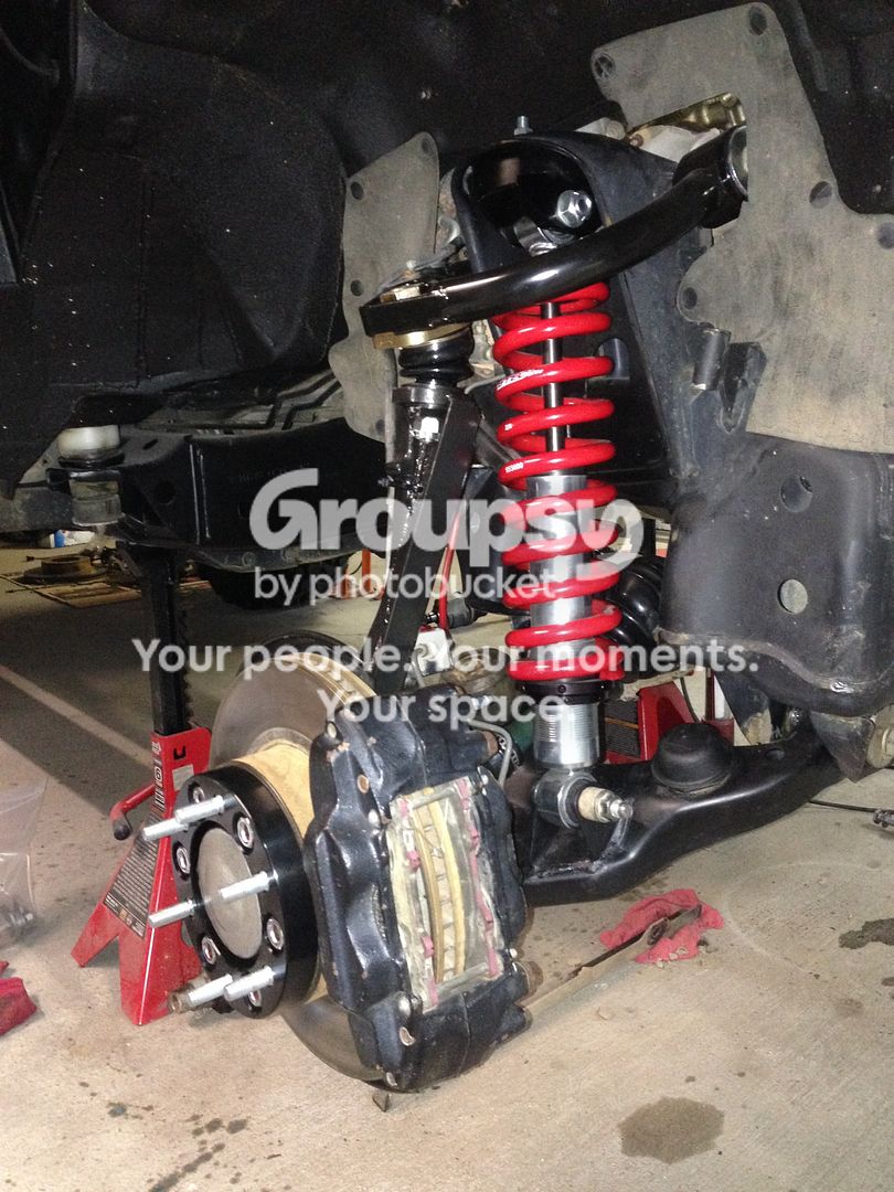

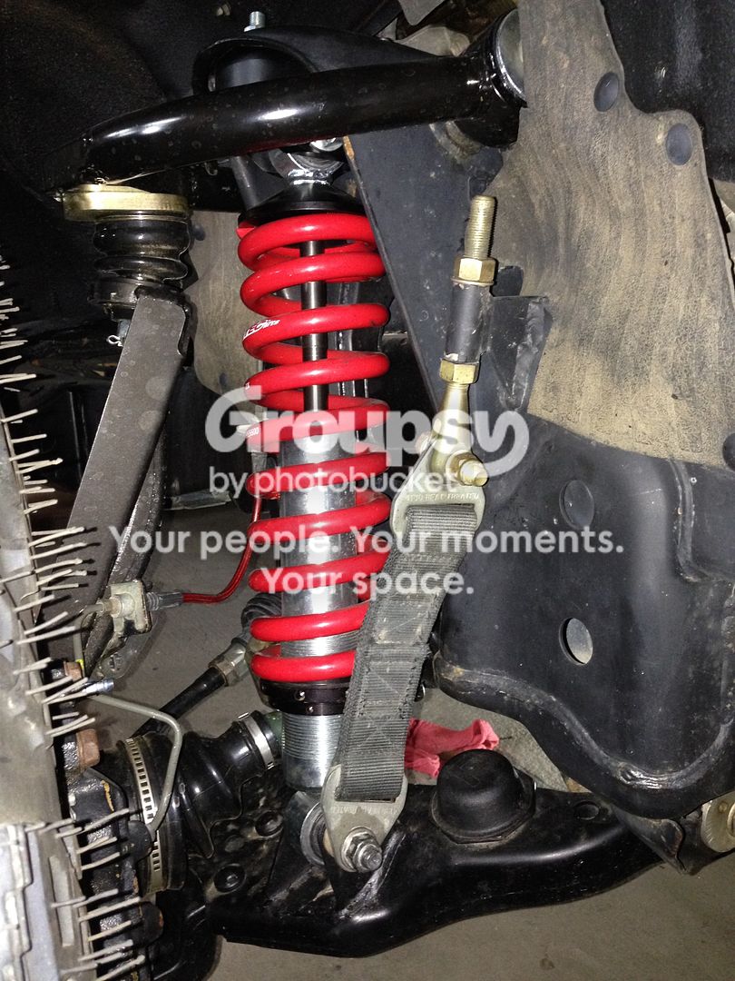

And I reinstalled the limit straps once I knew the coilovers were setting level (since ToyTec rebuilt one). I now need to balance the tires, get an alignment, and replace the panhard bar heim joints, then the suspension and steering will be all wrapped up.
Man that is looking so clean and fresh....you must be anxious...Final stretch..keep pushing...can't wait to see it get dirty

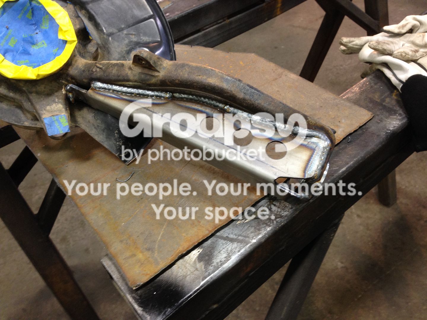

[MENTION=67615]Dirtco[/MENTION] Looking killer man! How did you end up re mounting the brake line with the spindle gussets? I kinda bent the bracket a little and it worked well enough so far. My brake line doesn't touch but I wish i could get it a little farther away from the gusset.
I did the same thing, it's a close fit but I don't think it will be a problem. I'm going to keep an eye on it and make sure it doesn't rub around.

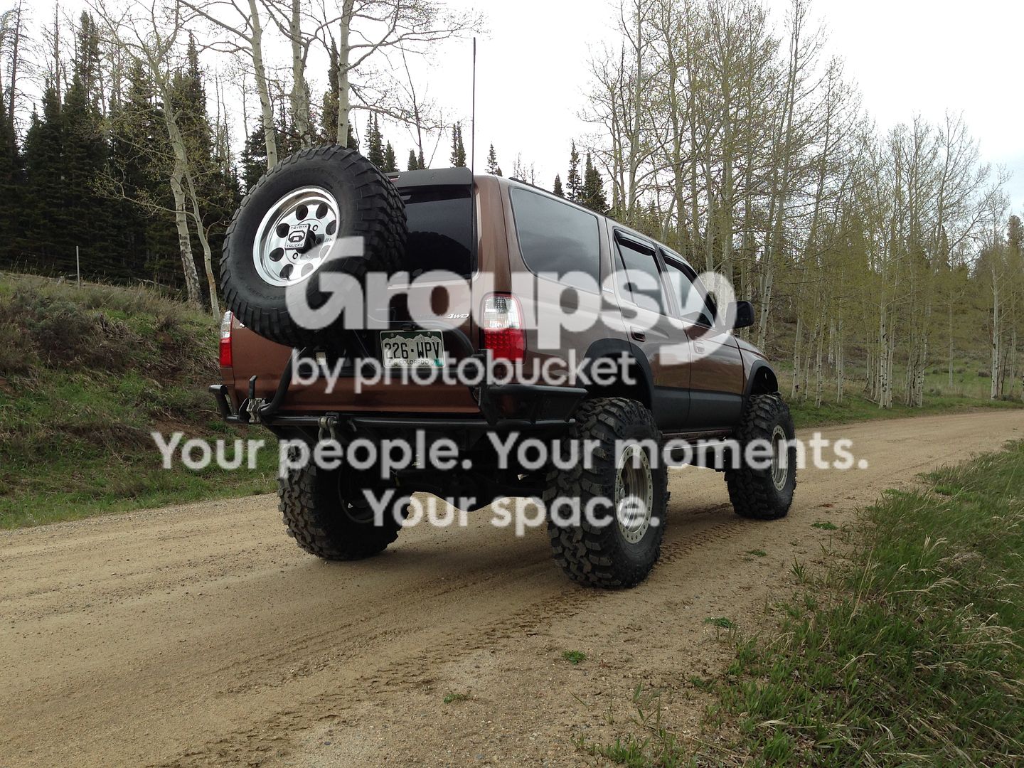

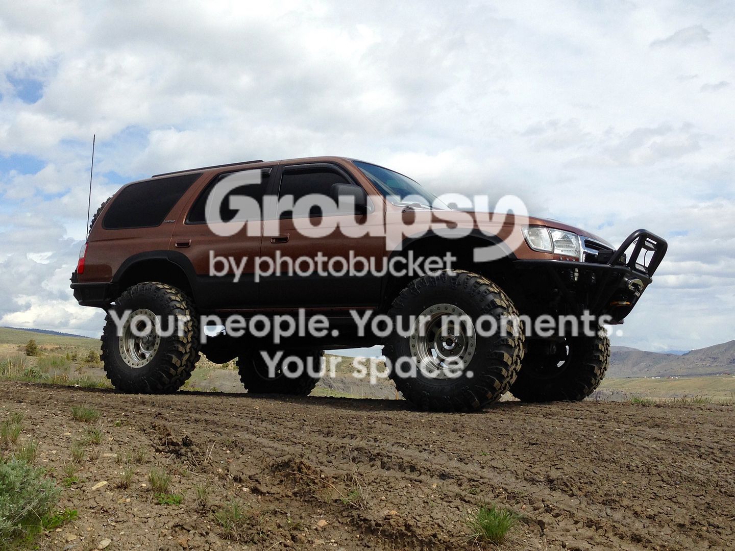

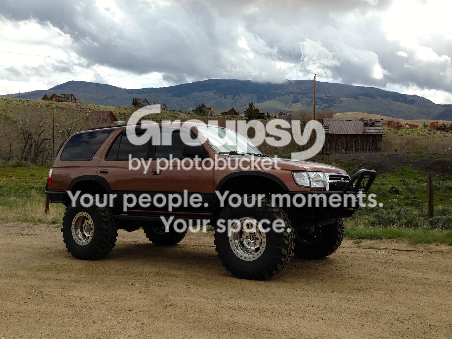

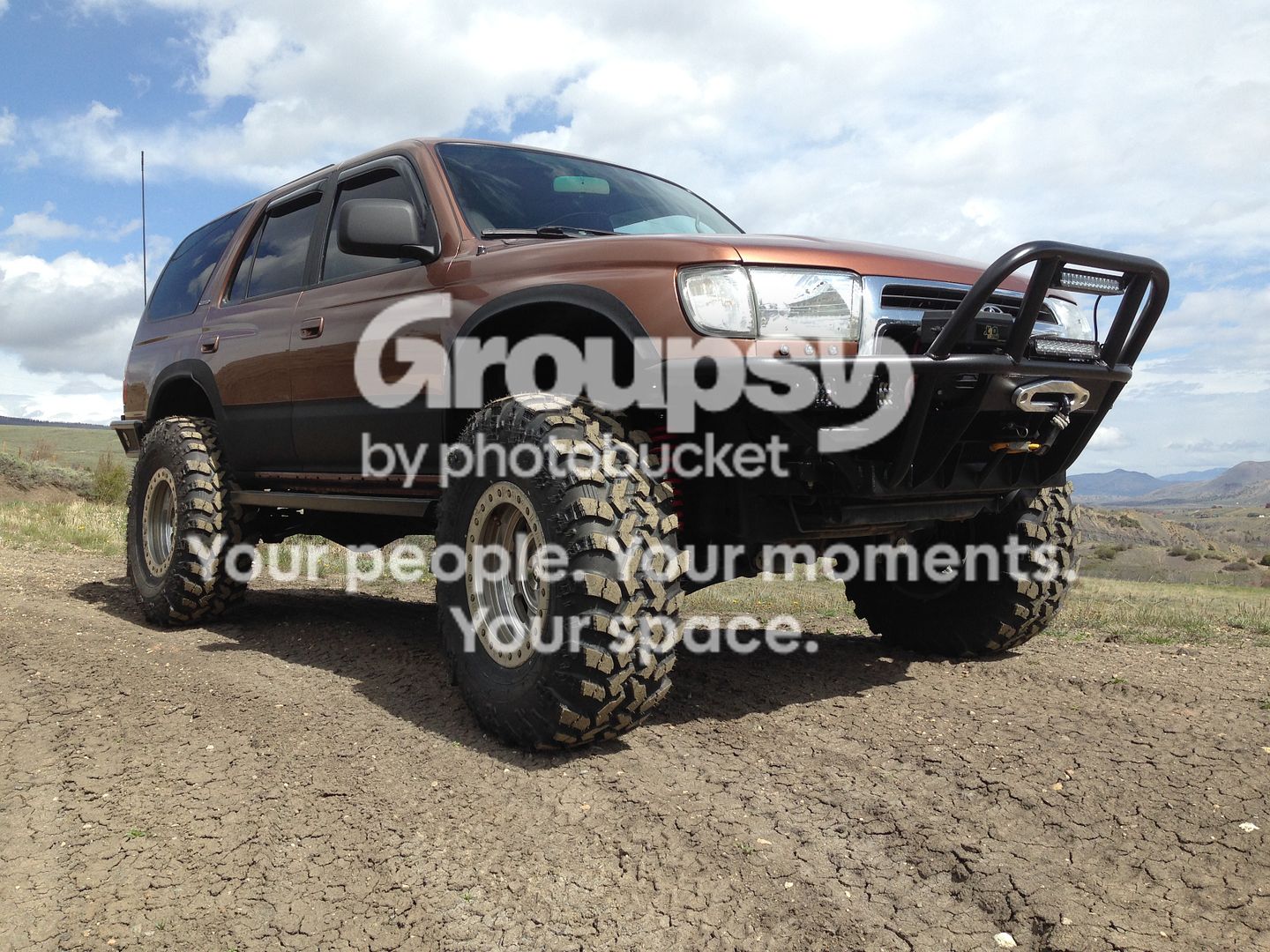

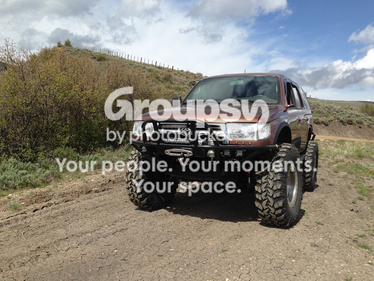

I pulled the 4Runner out of the garage to clean up and resituate. It was filthy with body and grinder dust, so I hosed it off with the garden hose and gave the interior a good detailing. While it was outside I couldn’t help myself, and I took it for a short drive up behind my house. After six months of not driving my 4Runner, even a short drive up a graded dirt road sounded good.
Your CV axles look tiny in comparison to those monster tires. I wonder how those lotus ales will hold up.
