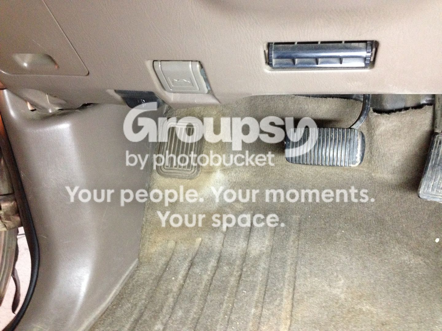

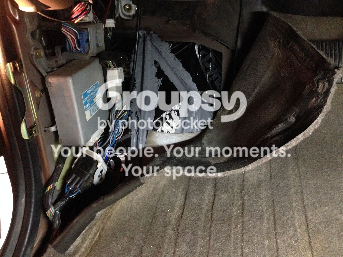

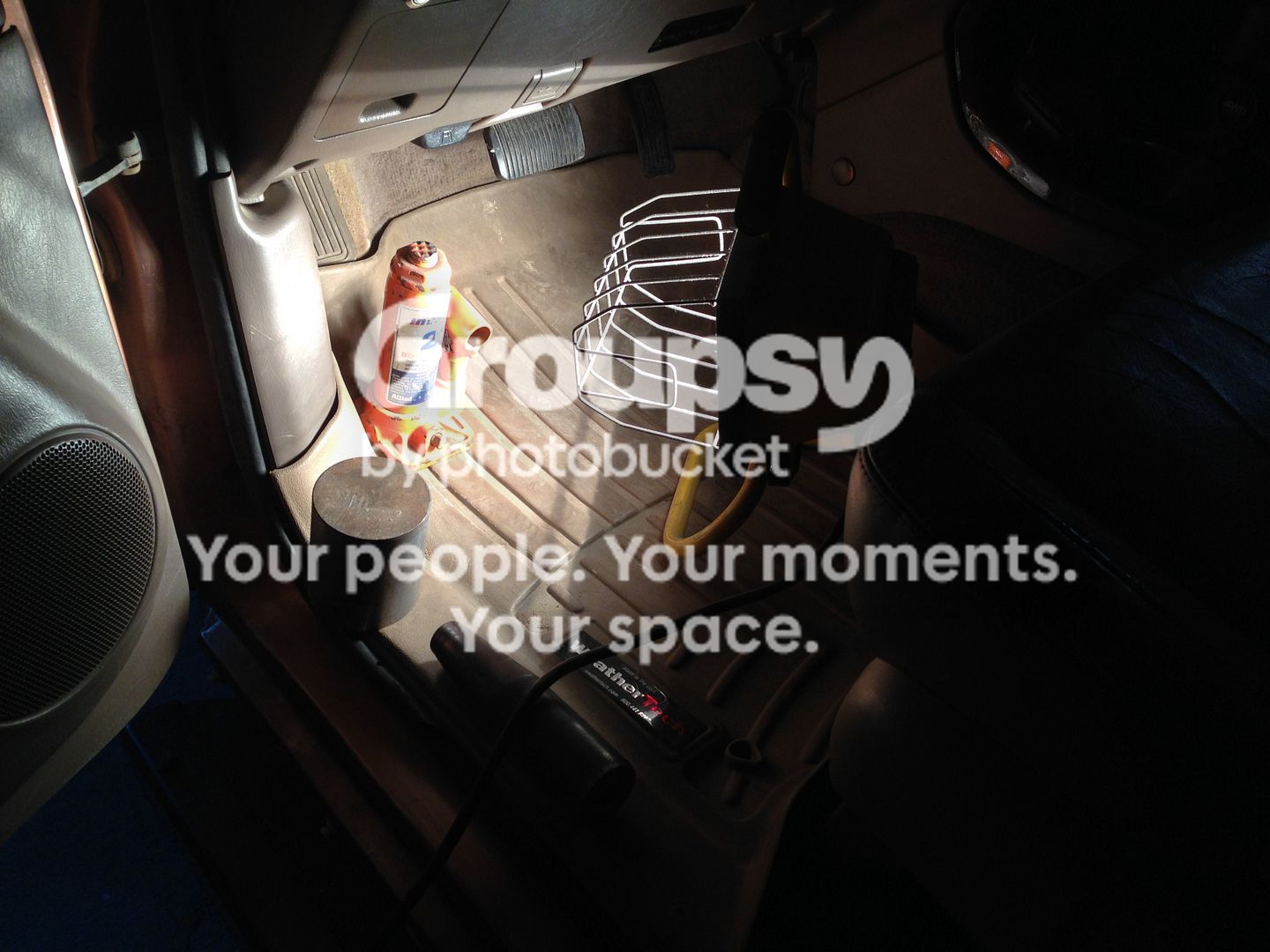

And here is the driver side interior with Dynamat, seam sealer, and the electronics reinstalled. It’s a tight fit, but it all fits behind the panel!
I was a little worried that the floor mats wouldn’t fit anymore, but they still fit pretty well. I heated up the mat with some weight on it to try and get it to conform a little better. We’ll see how it works.
If you want to add more sound deadener second skin audio has a 40lbs pack 60-90 Sq ft on sale. I just ordered one myself to finish off the 4runner.

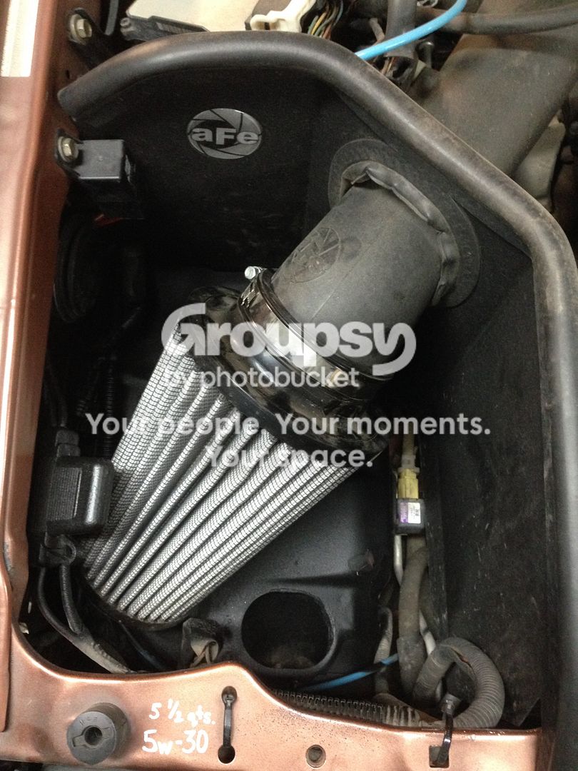

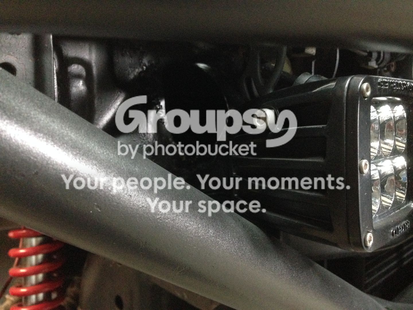

In other news, I've been slowly chipping away at the 4Runner. Relocated fresh air intake is done:

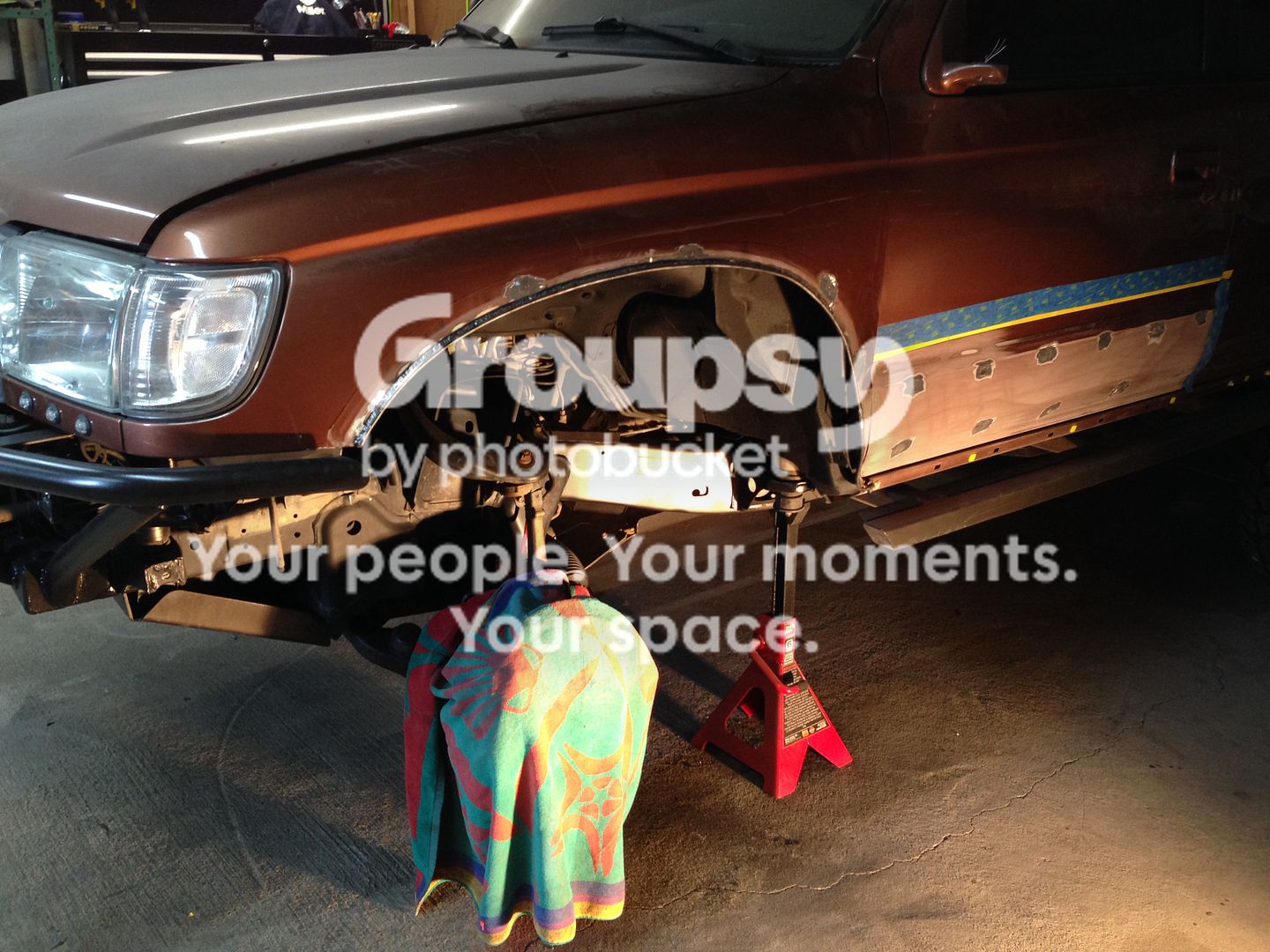

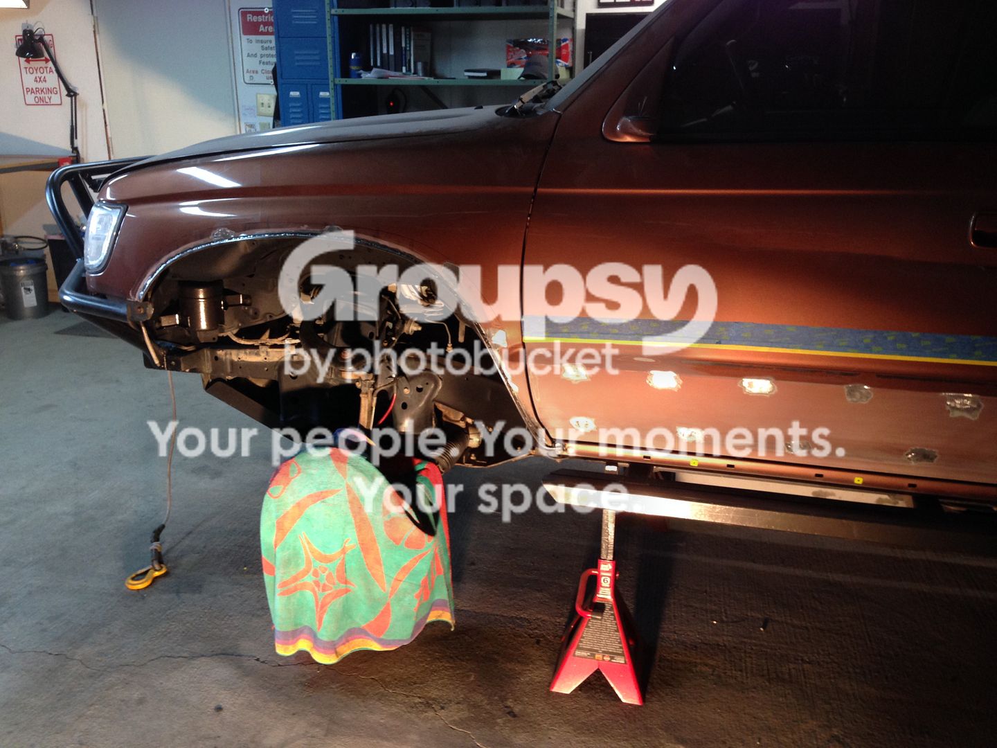

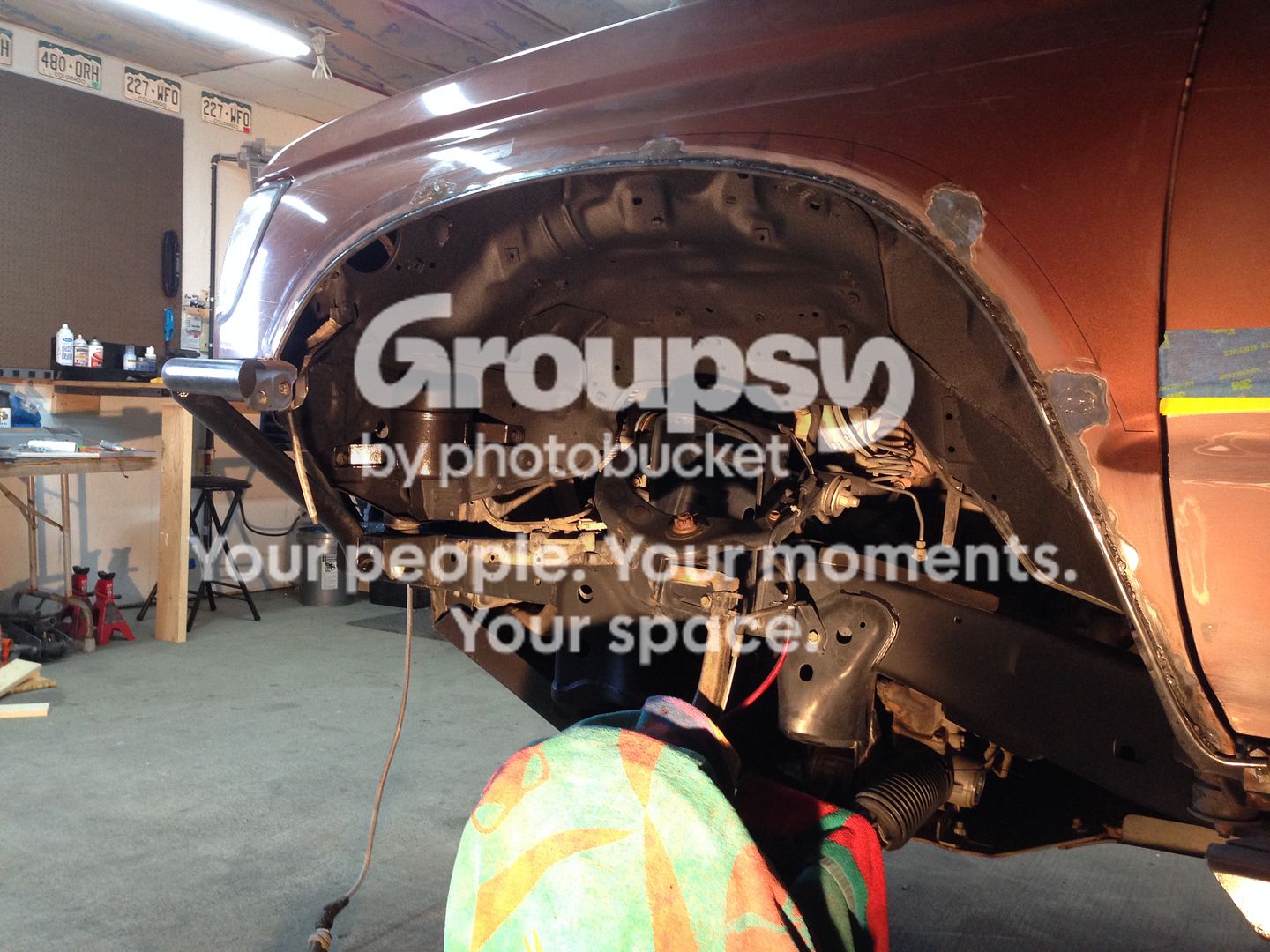

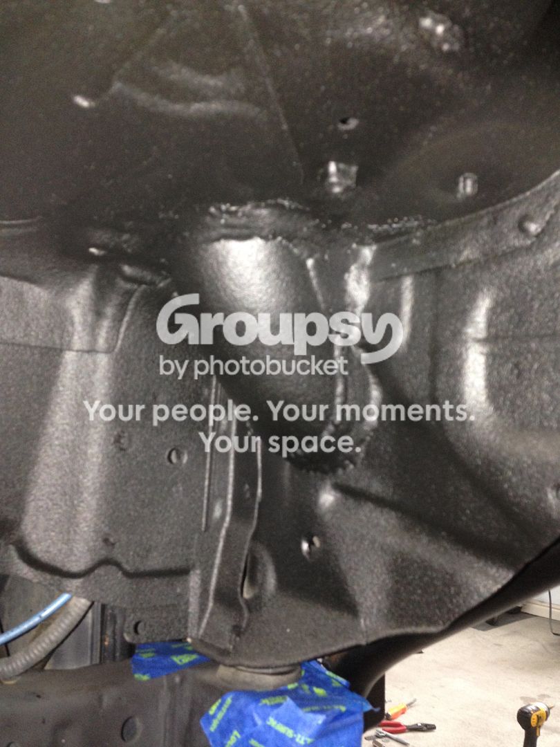

The driver side firewall is tubbed, body mount clearanced, fender cut and round rod welded in, and the holes are filled on the front door.

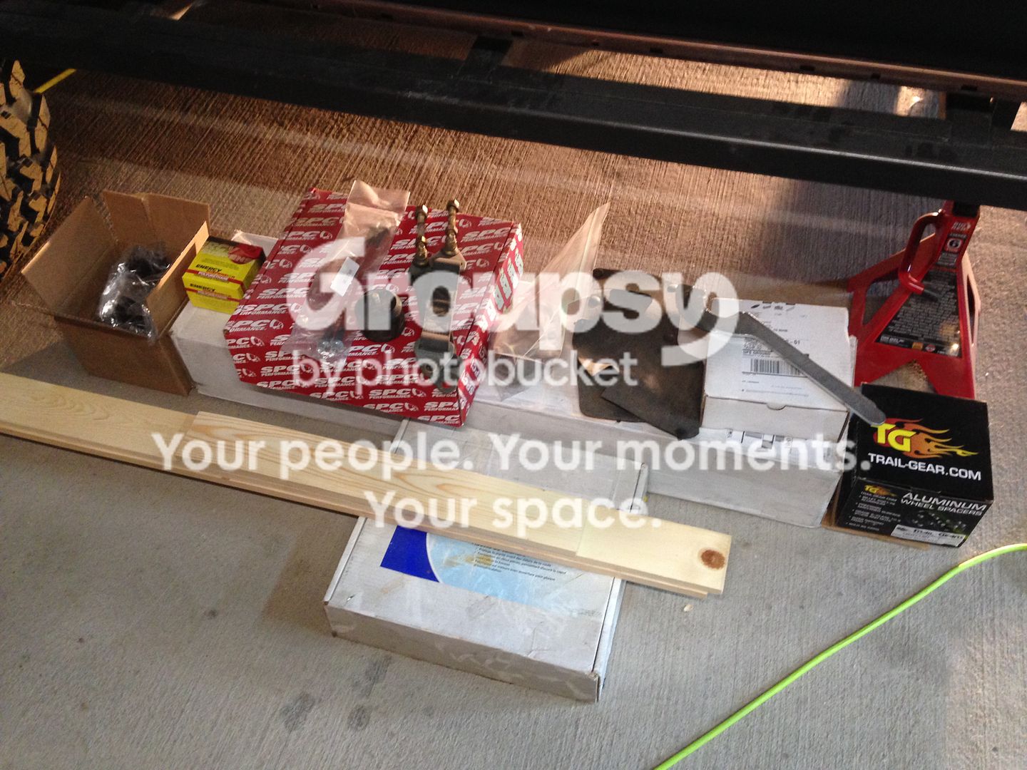

And all the parts for the front suspension and steering are finally here, I've been collecting parts for a while now:
- Safari LTD steering rack
- Energy Suspension steering rack bushings
- SPC / Light Racing UCA's
- Replacement Lotus CV boots
- Replacement brake lines (Wheelers Offroad)
- Energy suspension LCA bushings
- Total Chaos spindle gussets
- Wheel spacers for the front (there was no way around it, the tires rub the frame like crazy. I'm going to start with one inch and hope that's enough.)

Be careful with the wheel spacers. I tubed my inner fenders with stock wheels. Then when I got wheels with more back spacing (same as wheel spacers) my tire hit in all kinds of places and I had to re-attack some areas. You have done some beautiful work on your fenders, would suck to have to change it up again. I was considering welding onto the lower ball joint where the steering stop is. Then grinding it down smooth to extend the steering stop so that the tires would not hit the frame. Haven't done it yet but I don't see why it wouldn't work....
Your 100% right, but I think I'll be okay with the one inch spacers. I took into account that I might have to run them when I was doing all my work. I still need to test fit one to make sure, but I'm not too worried. I thought about limiting the steering stops as it would be really easy, but I really like how tight the 4Runners turns and I would hate to loose that. I didn't mind the little amount of rubbing I was getting with my old 35's, but these 36" Iroks with the monster side lugs rub like crazy!
