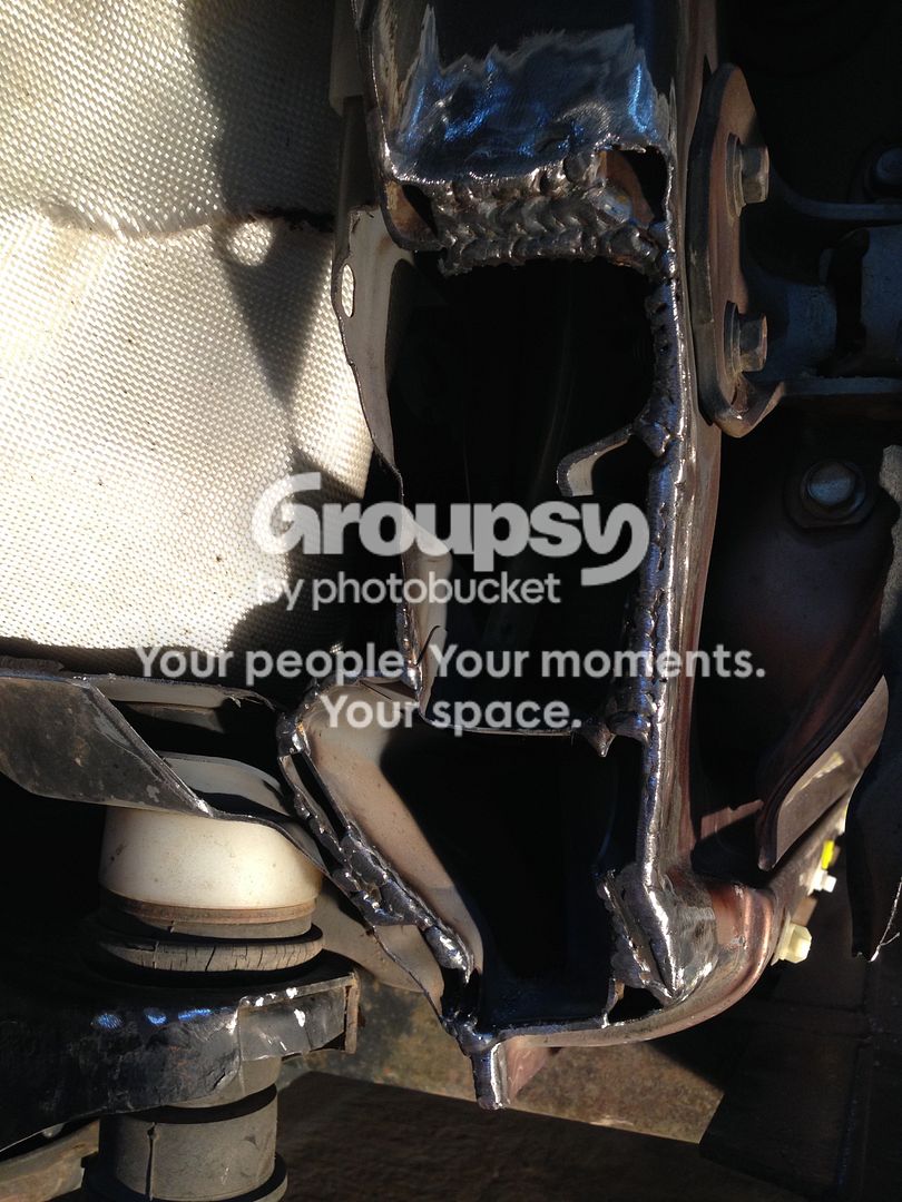

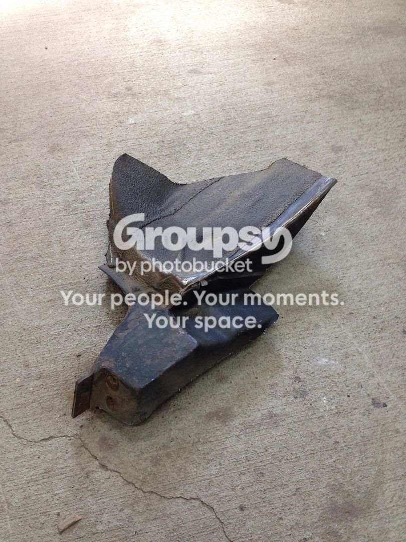

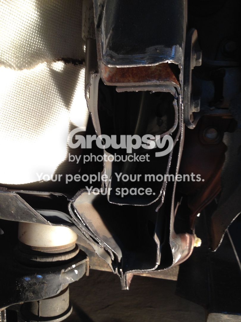

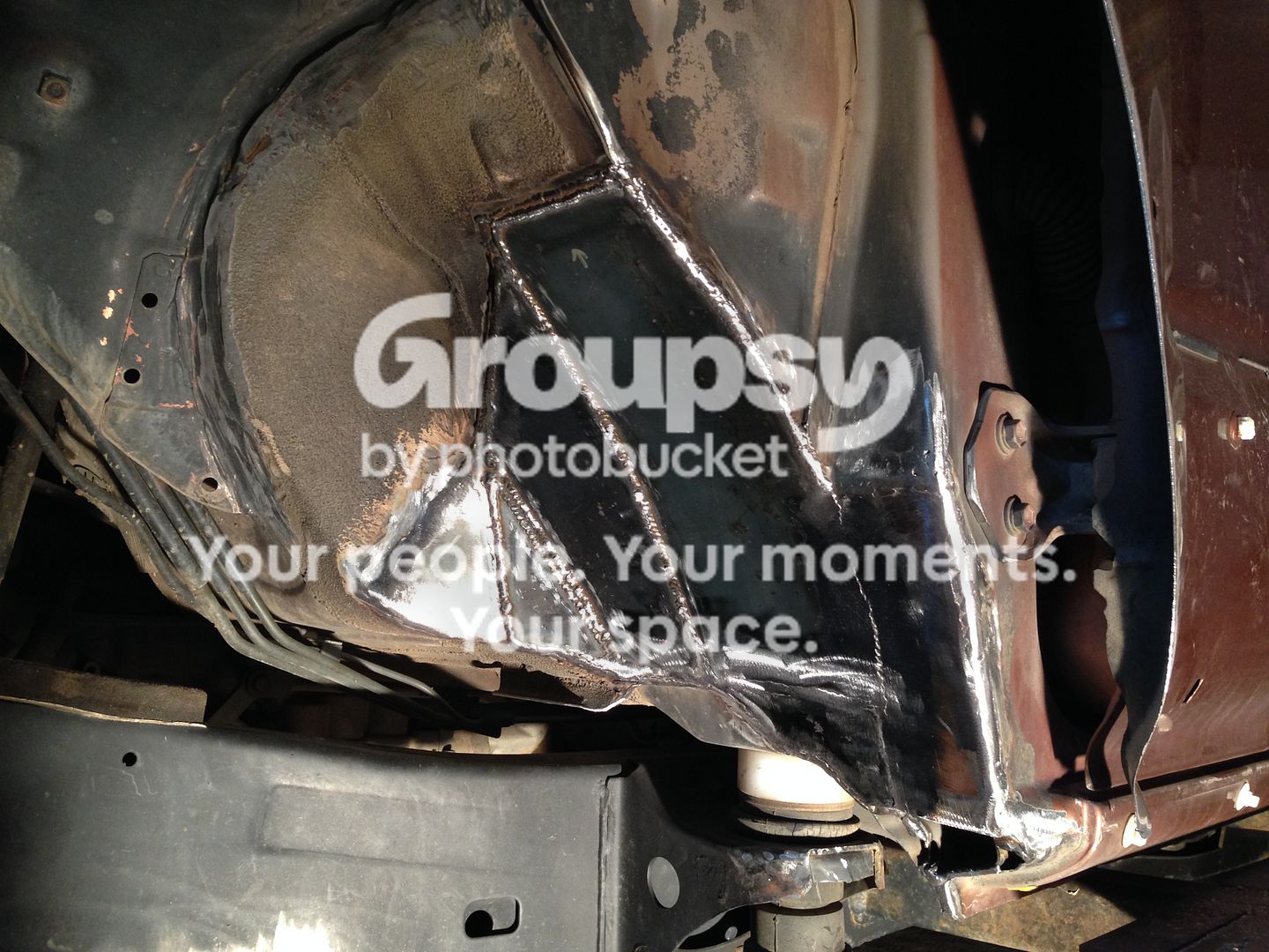

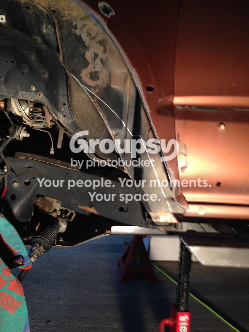

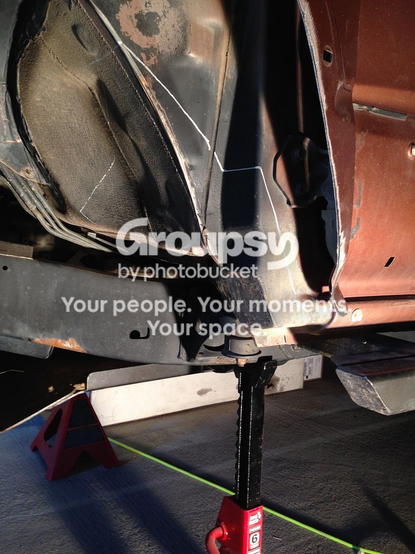

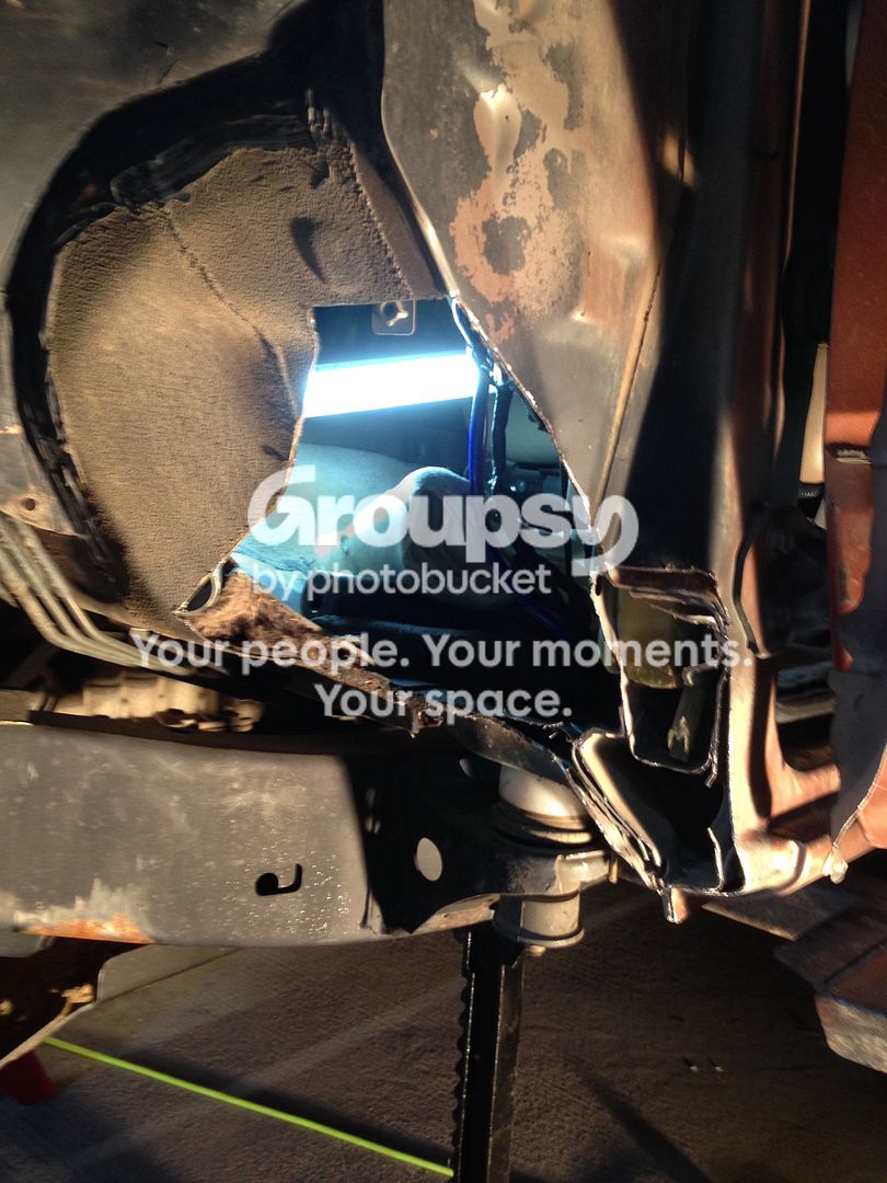

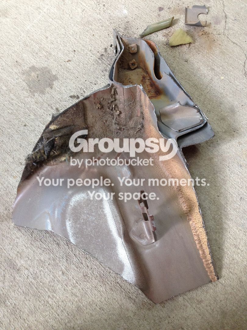

I tubbed the d/s firewall this weekend, I was able to measure off the other side and cut the whole thing out in one piece. That's a whole lot of sheet metal!
As you can see in this picture, all the support has been removed from the firewall.

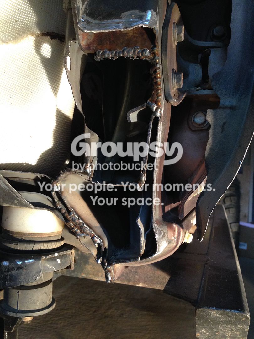

So I welded all the inner layers together before I capped it.
Almost done

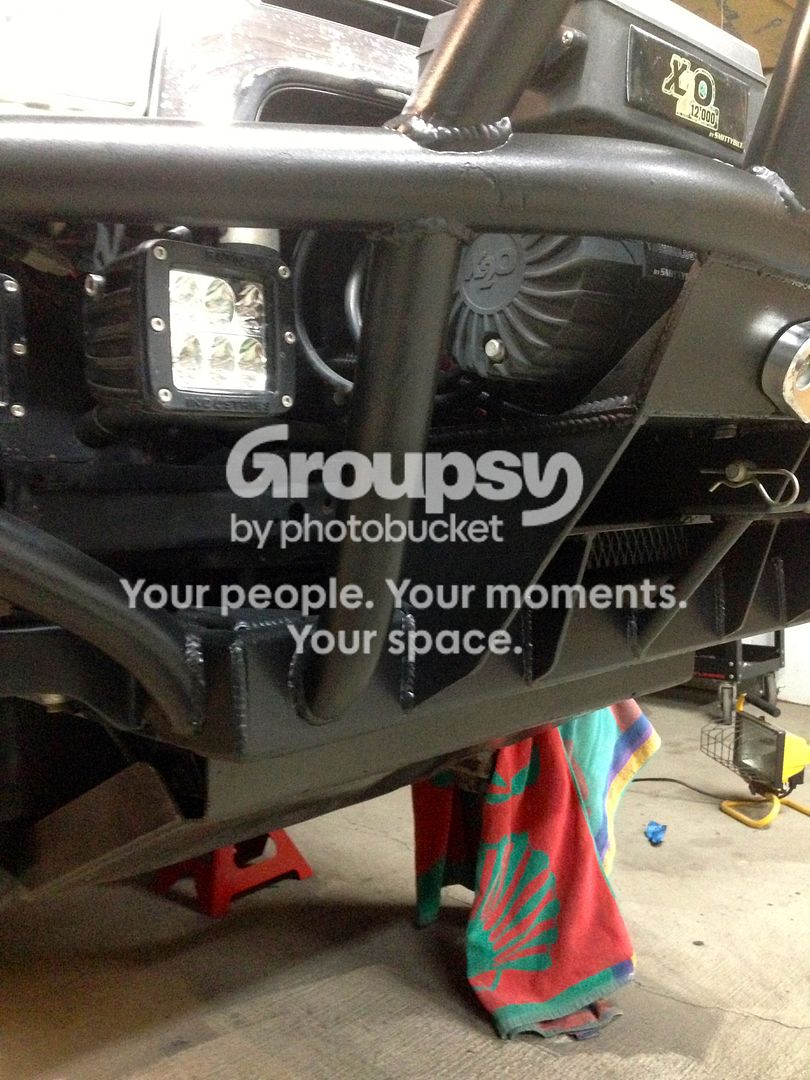

The front bumper was in rough shape, and needed a color change to match the bedliner. It seemed like a good "nap time", and evening project since it didn't make any noise.

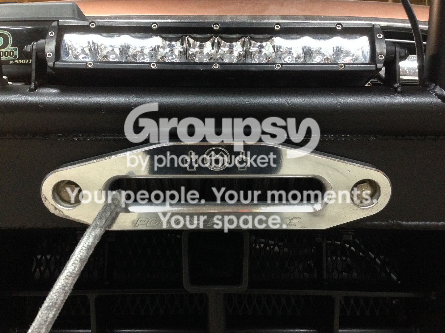

The winch fairlead looked like crap from several harsh winters, so I gave it a good polish.

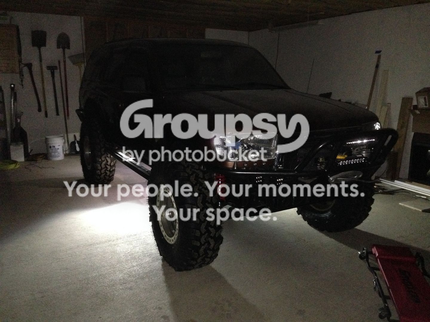

And a little motivation to get it finished and on the trail. I would be lying if I said I wasn't getting burnt out, but it gets a little closer every day.

Amazing fab work man. I am slack jawed that you are able to tear such big holes in your truck and then patch it with the 4runner looking like it should instead of like some trail buggy that's beat to hell.
That's insane, chopping the firewall like that! So much unique work going on with this build, nice job!
Yeah, I didn't realize I had to cut so much until I removed the coilover and test fit the tire. At that point there was no option but to keep cutting, I'm just glad I have an automatic!
