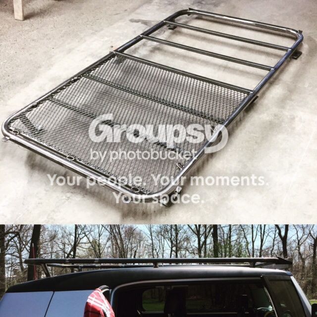

Step one of this process; I needed a low profile and light weight roof rack to hold my awning and Hi Lift jack, along with extra camping gear and firewood. I prefer the clean look of no rack, but with the sleeping platform in the back cargo space will be at a premium. I wanted to stick with the cheap or free theme (BajaRack has one, but I can think of better ways to spend $500) so I reused the rack that I built for the RTT and modified it to work for this application.

:bravo: That gusset on the corner is gold! I like it. Couldn't have a roof rack without a little Dirtco flare on it! I like the round bar idea up the sides tho, that was a good call. Everyone always builds them and then has to build in tie down points as almost an afterthought. Looks sharp man I love it!
Thanks Rick, that gusset is just for you! :D

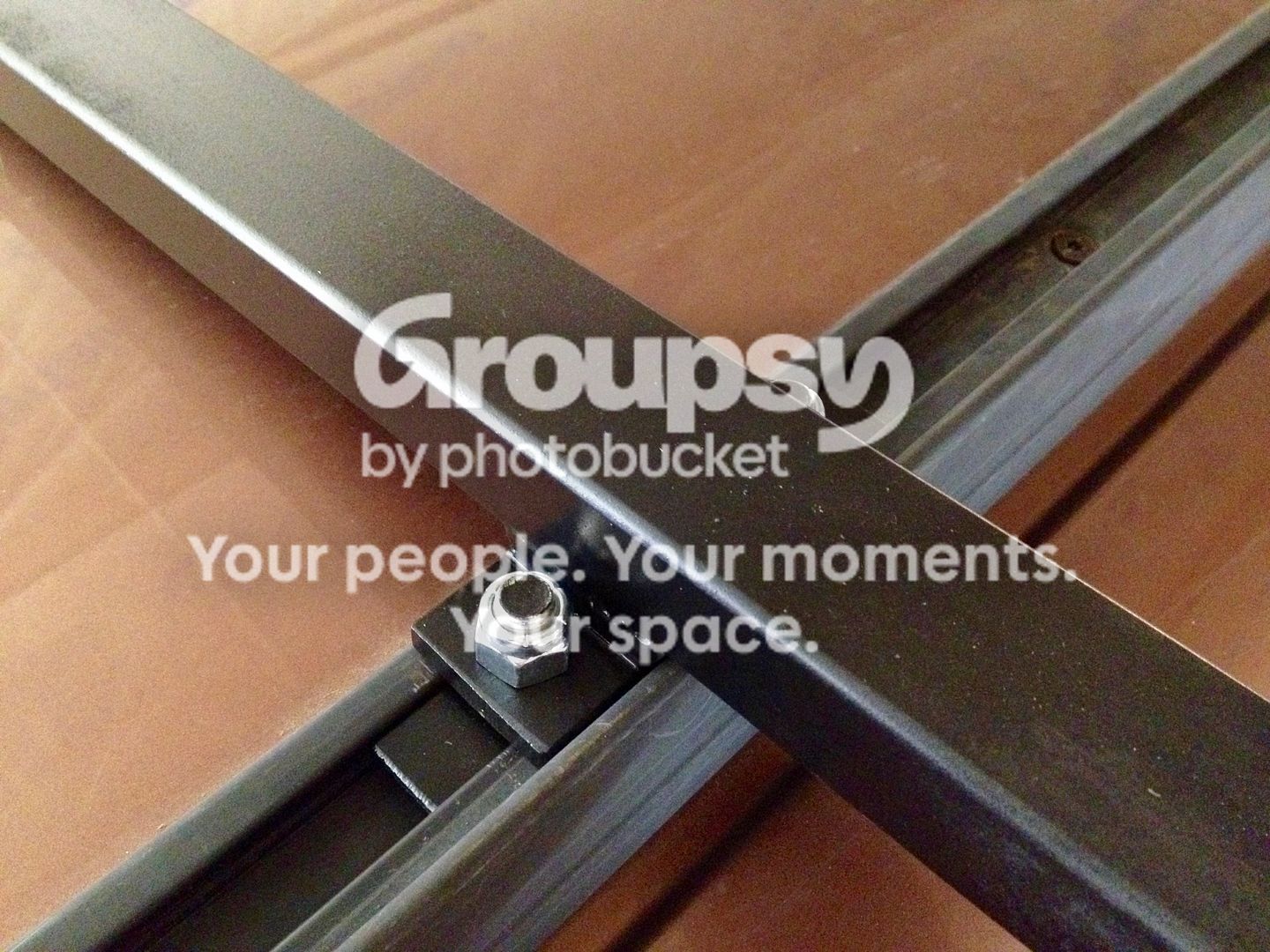

Roof rack 2.0 is very slick, also noticed the gusset detail, nice touch. Do you have any plans for alley lights on it? If so what lights are yo looking at? And the bolts holding the rack on look larger than stock yet in the same rail..what's that detail?

The bolts are welded to the inner plate, I had to grind them down a little to fit but it makes for a stronger mount. I'll rip the roof rails off the 4Runner before the rack breaks.

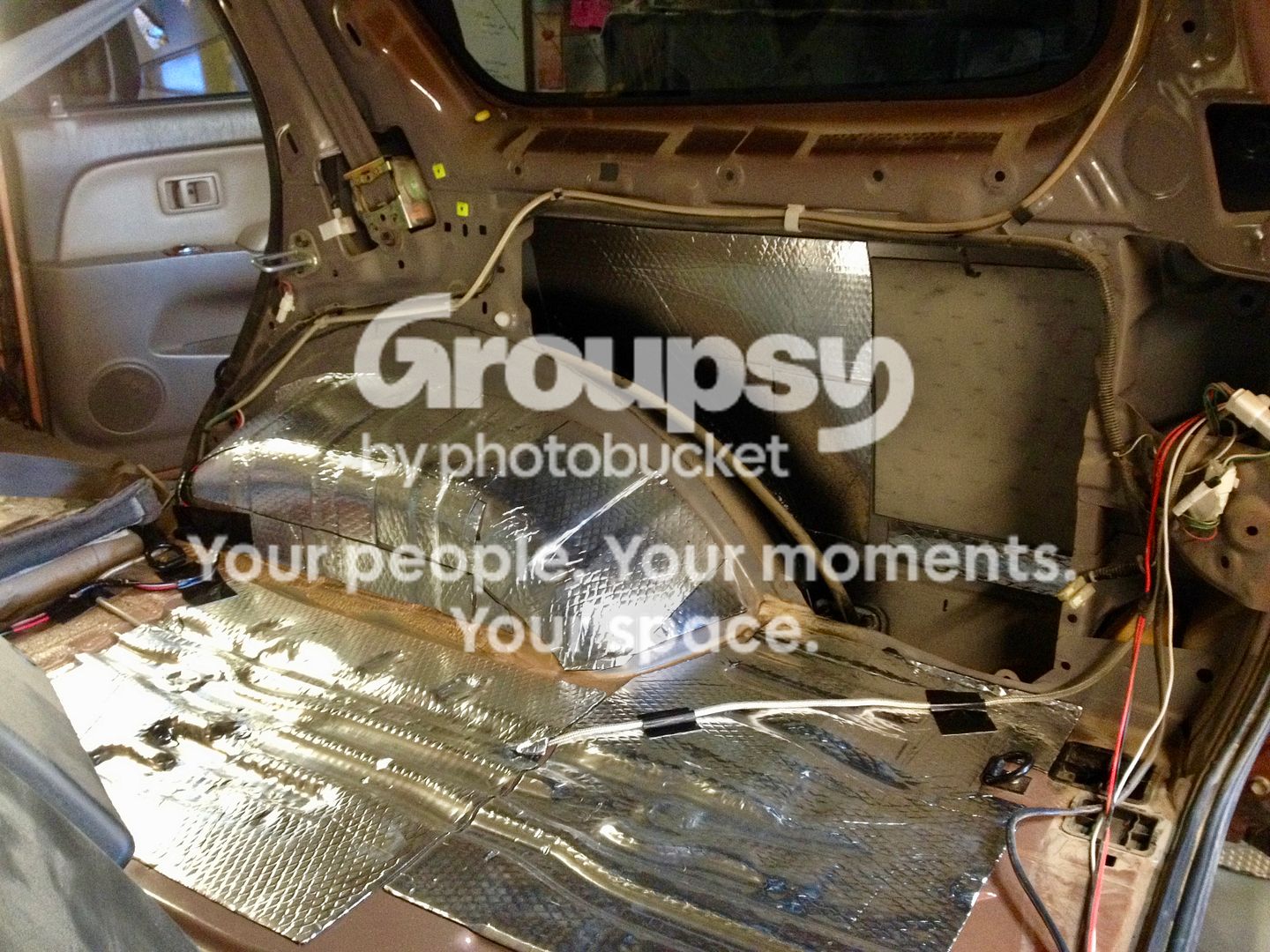

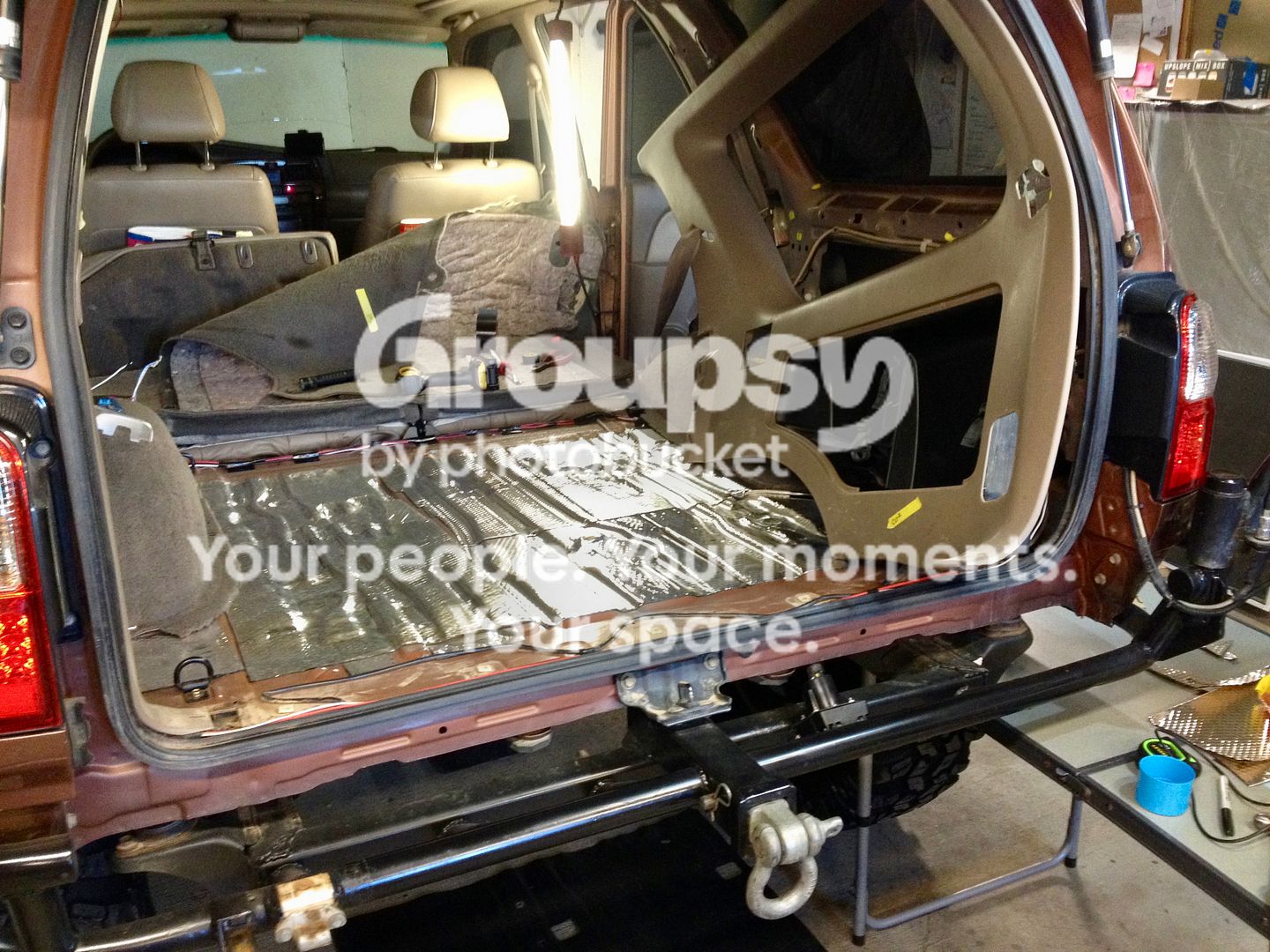

Step one was to install sound deadening in the rear cargo area, this is primarily for temperature control but if it cuts down on noise thats a plus too. While I had the rear cargo area apart I ran all the wiring for the electrical accessories.

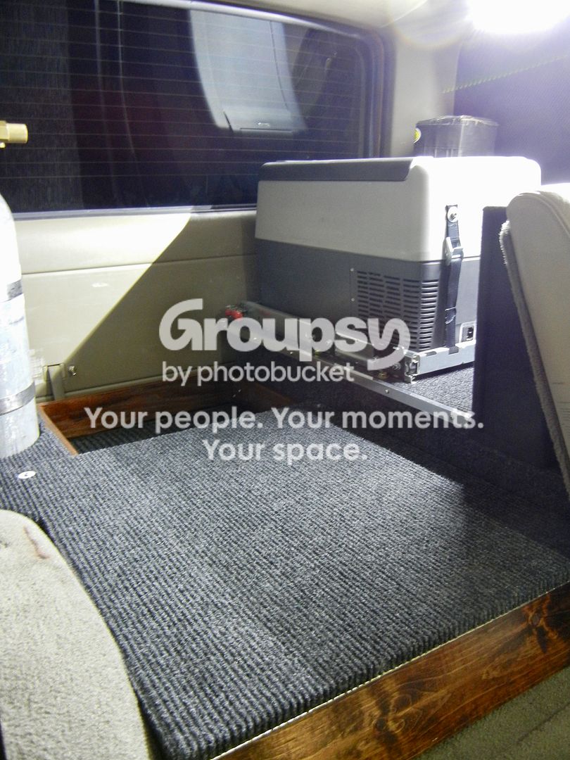

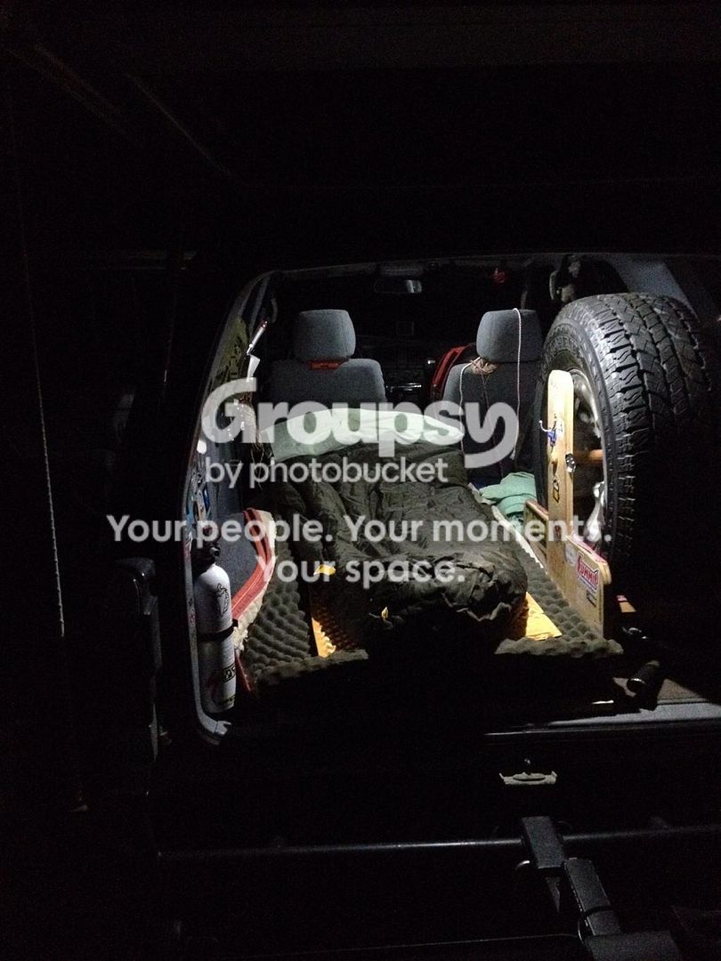

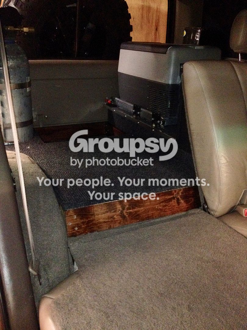

I had several ideas and requirements for the sleeping platform, I looked at literally hundreds of pictures to get ideas. First and foremost the platform had to look professional, and not like a random box in the back of the 4Runner. Also, the sleeping area had to sit as low and wide as possible. I want to be able to sit up in bed and not feel like I’m sleeping in a closed coffin, and I had to be able to get into the fridge while in the back of the 4Runner. On top of all of that, it had to be modular with the ability to convert the truck back to a regular four seat configuration. So here is what I came up with, remember this is a work in progress and it’s not done yet.

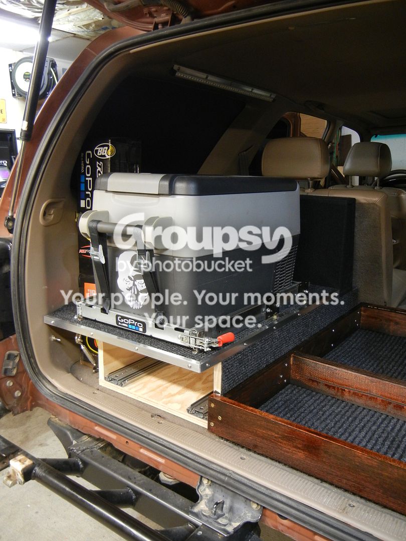

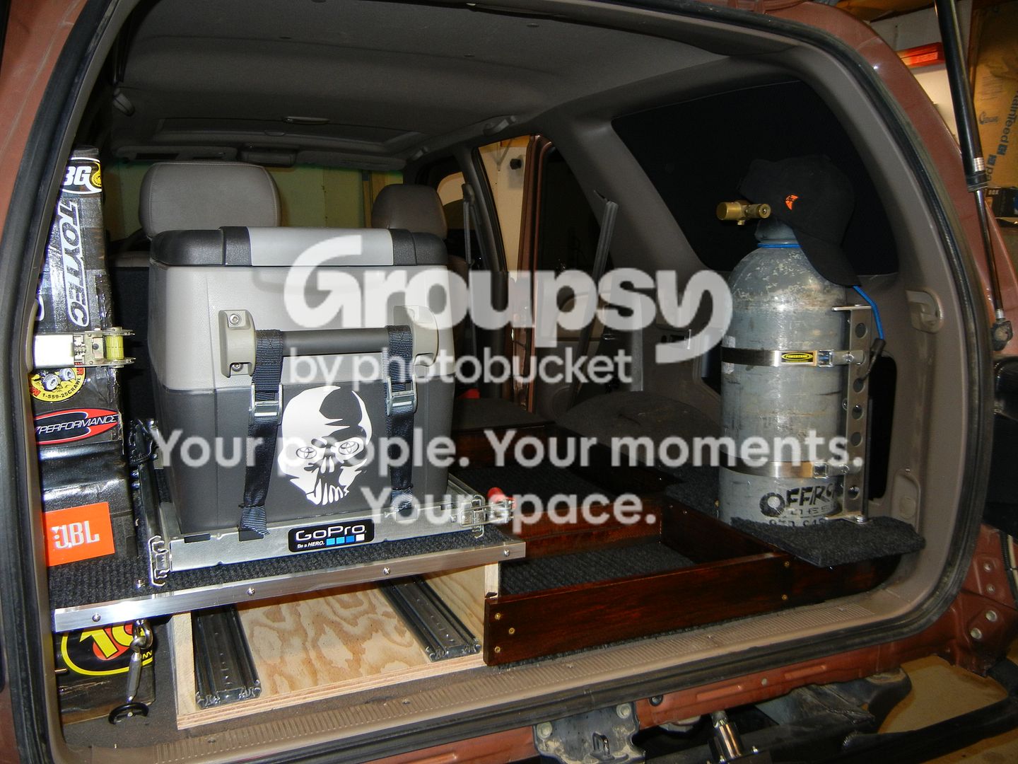

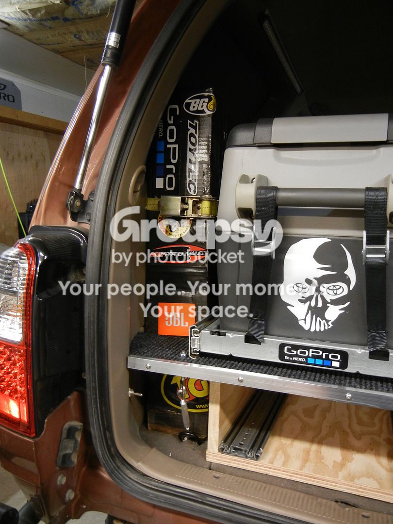

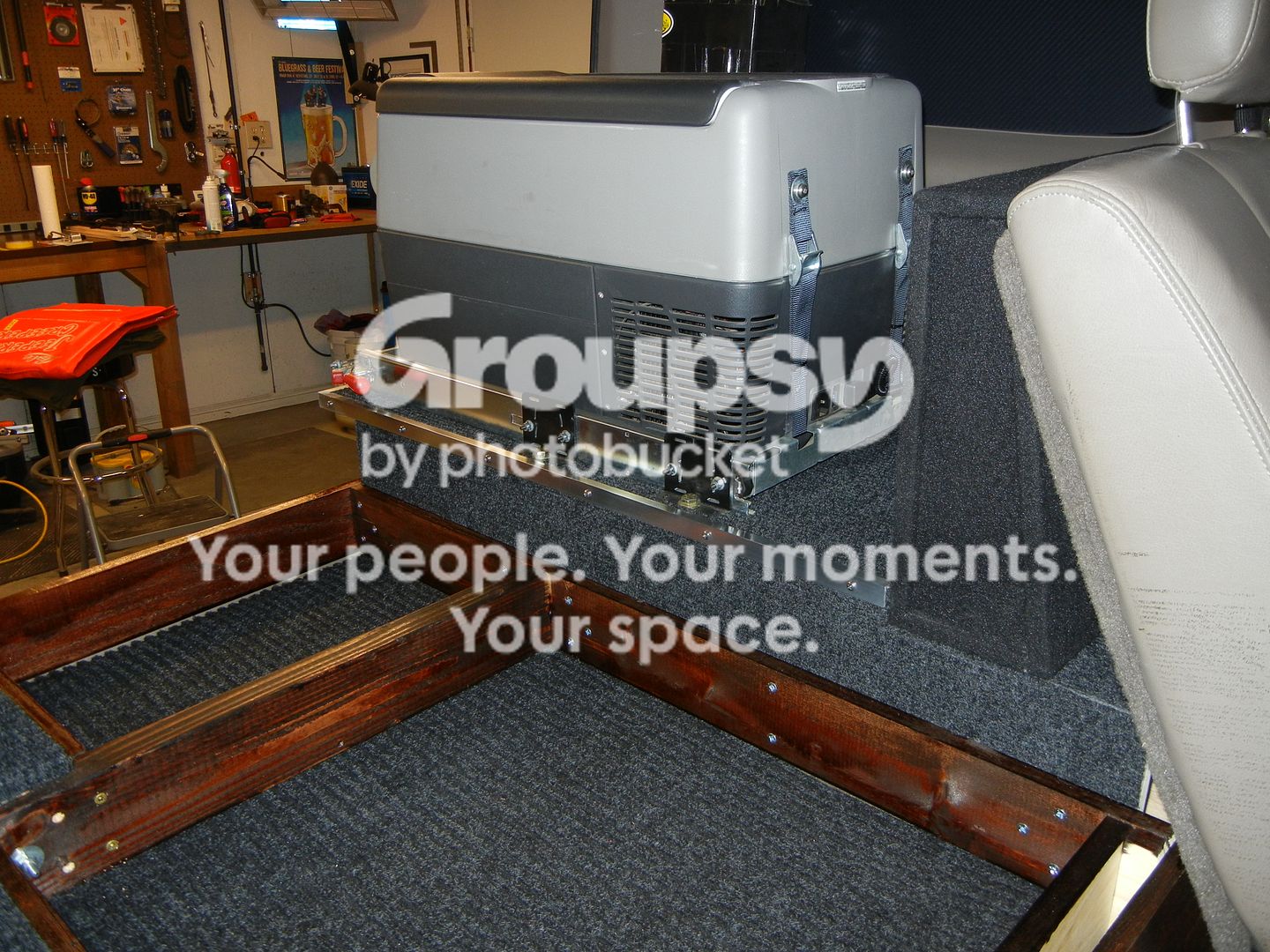

The biggest challenge was keeping the platform low enough that I could still sit up in bed. I wanted to maximize every bit of space I had, so I decided not to have a drawer under the sleeping section and instead have two cubby’s. The area under the fridge has full length drawer slides and will house my camp stove / grill and some basic kitchen supplies.

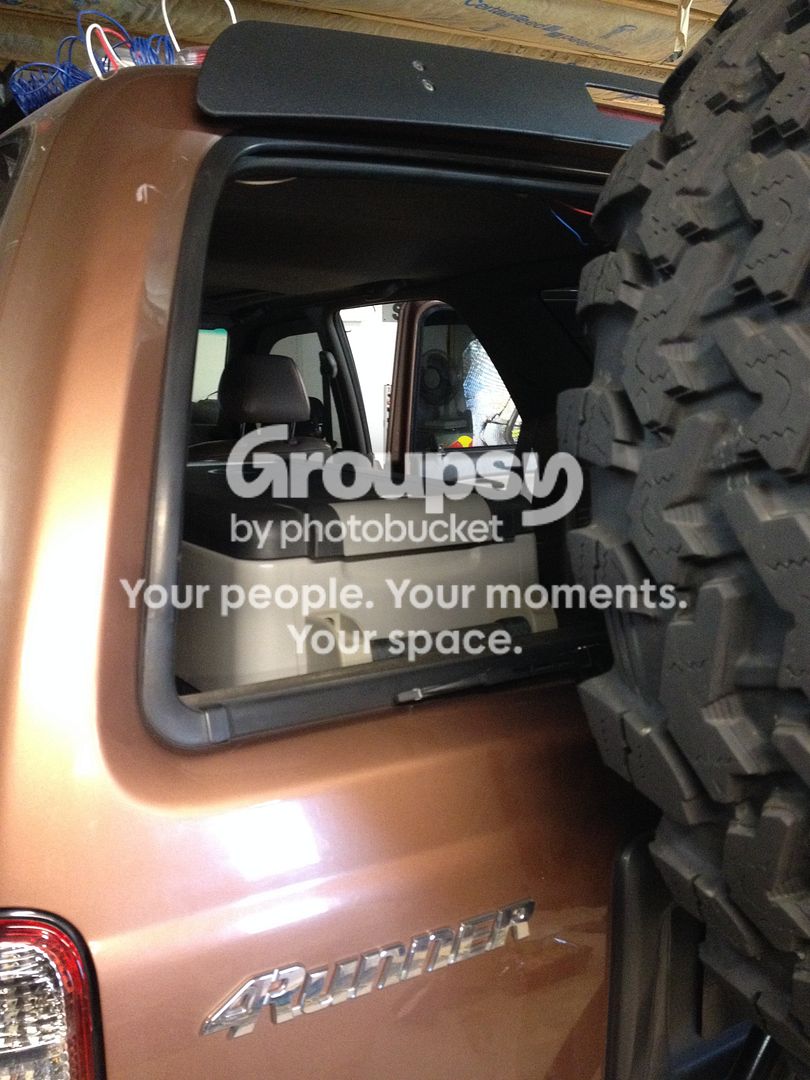

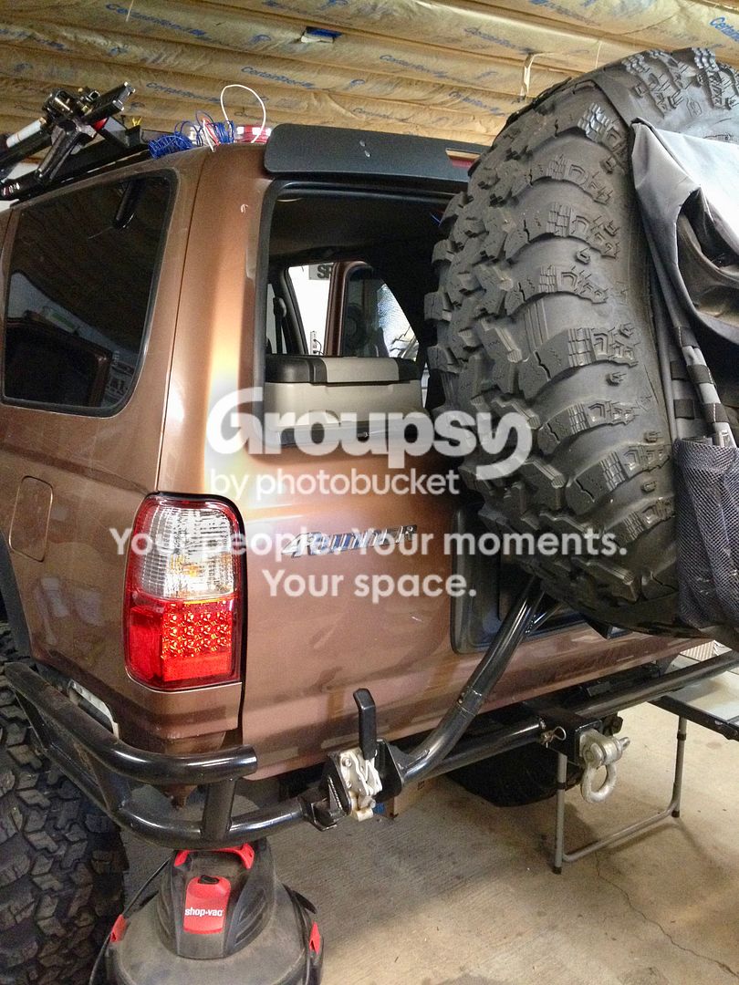

I can access the contents of the fridge from inside the 4Runner, and an added bonus is that I can get inside the fridge without opening the spare tire carrier and hatch.
Next to the fridge is my spare Lotus CV axle, it drops through the platform and has a ratchet strap that runs through the interior panel to the steel body structure. When I slide the fridge all the way out there is more than enough room to pull the axle out.

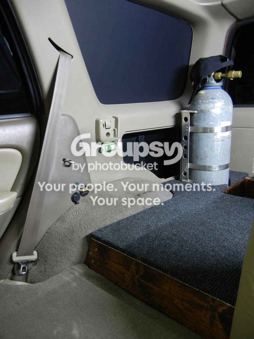

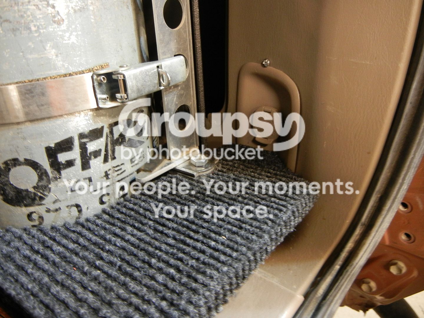

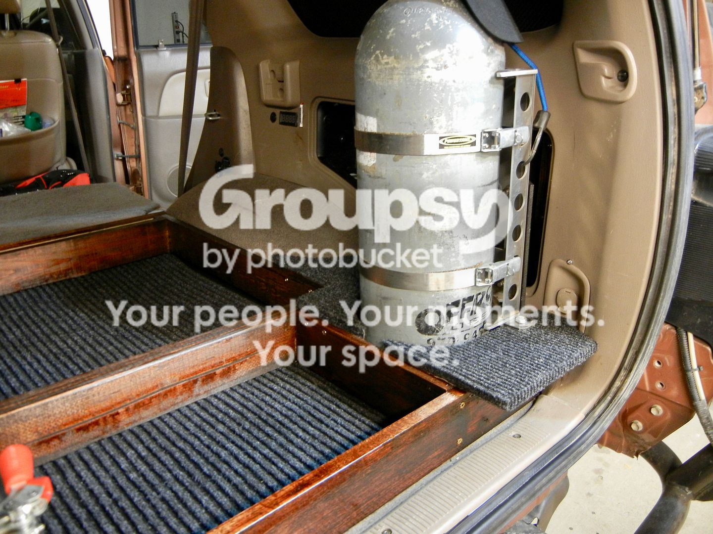

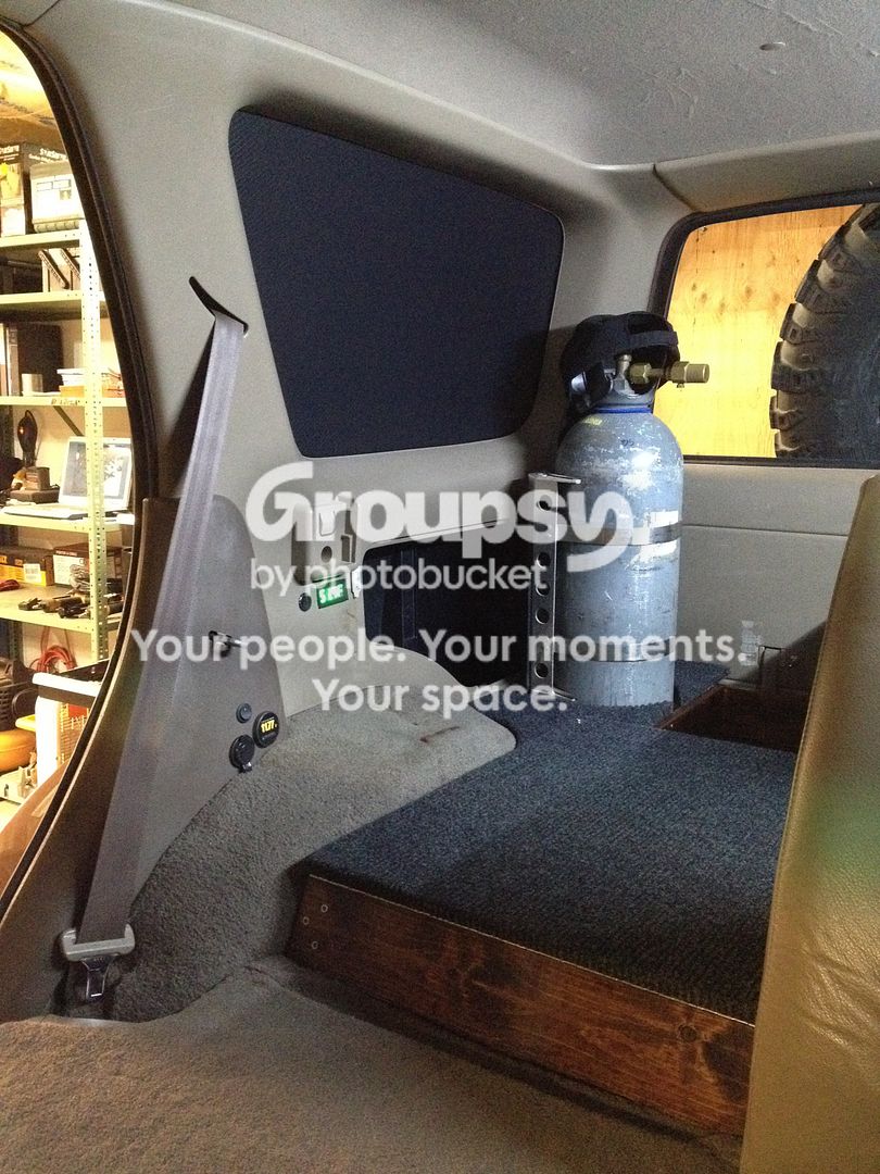

I had to build a bracket for the CO2 tank holder, it bolts to the floor in several places and the tank drops through the platform to the floor.

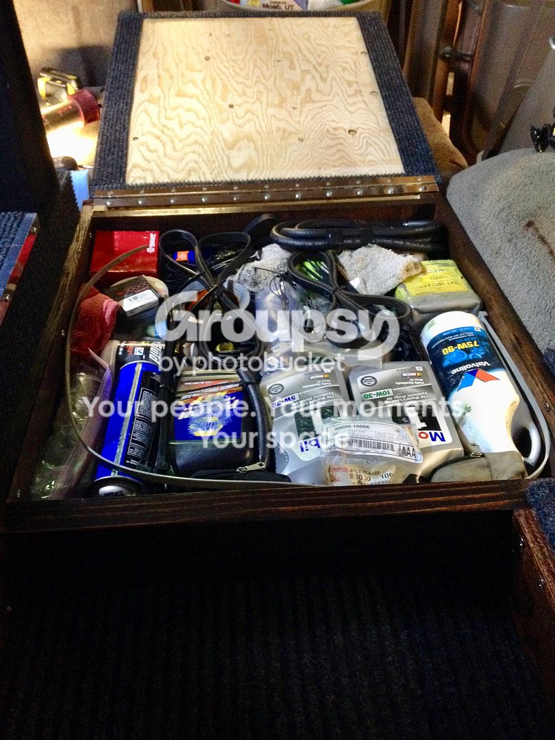

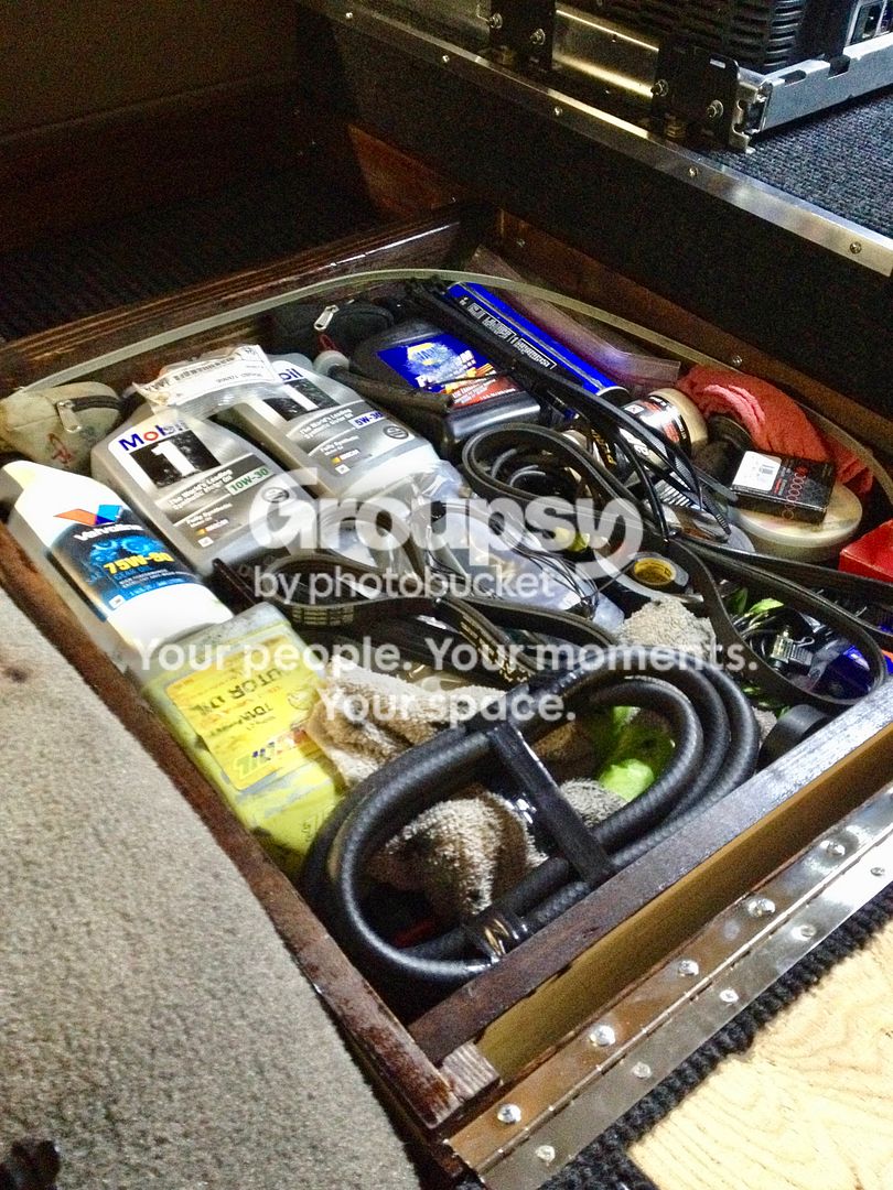

The largest storage area is for emergency vehicle parts and fluids

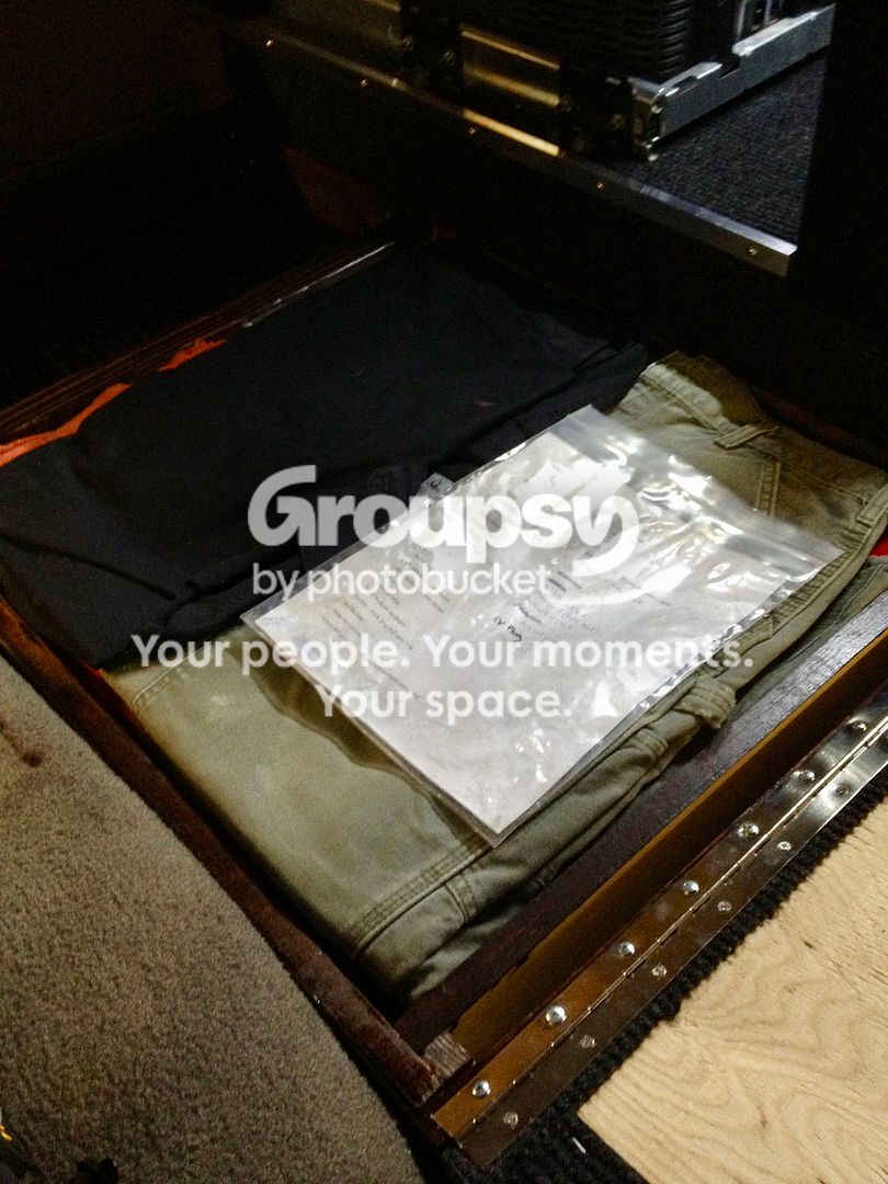

I also have a set of work clothes and a full list of everything inside. That way I don’t have to dig around looking for that “one thing” I swear I had but really don’t. If it’s not on the list it’s not inside the storage area.

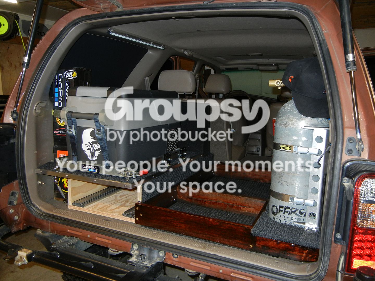

And here it is all closed up.

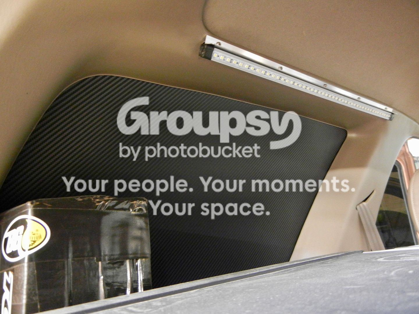

One of the big problems with sleeping in a vehicle is the windows, even with tinted windows they don’t offer much privacy and you have to deal with the early morning sun. To combat this I wrapped the inside of the two rear side windows in 3M Carbon fiber.

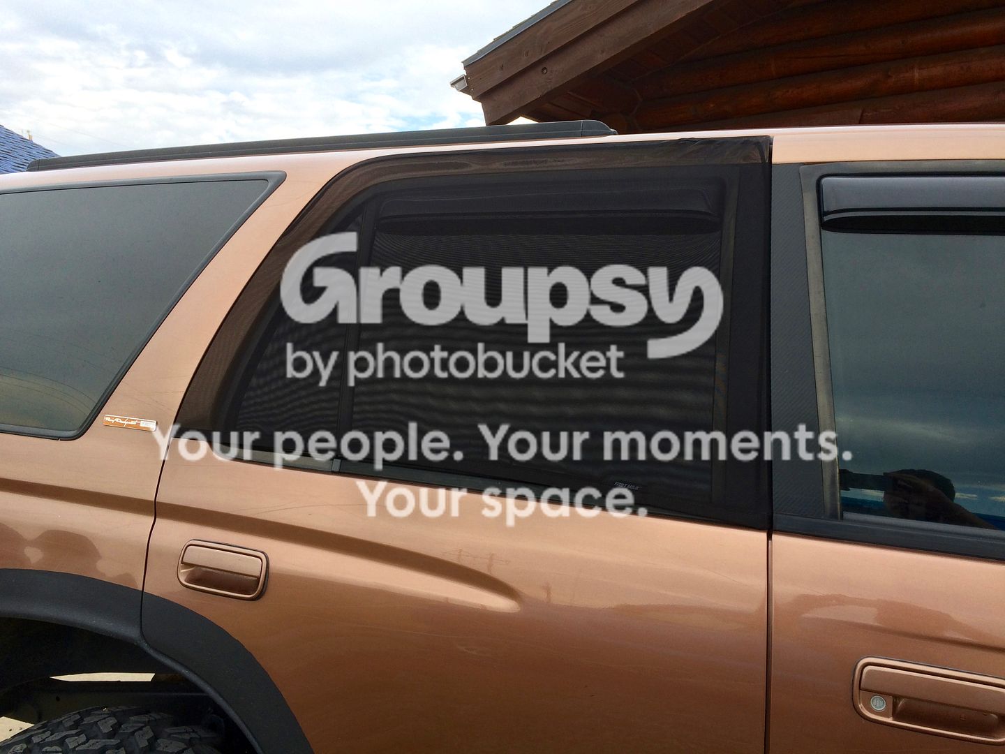

For the rear doors I picked up these window screens last summer, not only do they darken the rear of the vehicle but they also allow me to open the rear window for ventilation without bugs getting in. I also plan on having some kind of a privacy curtain behind the front seats.

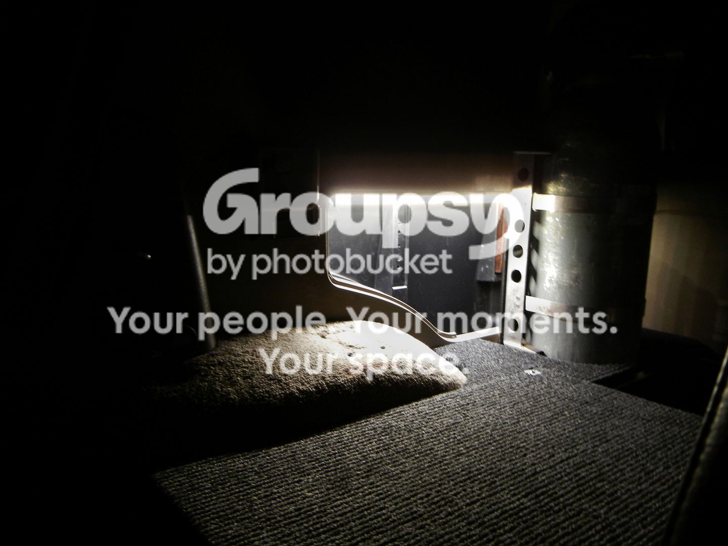

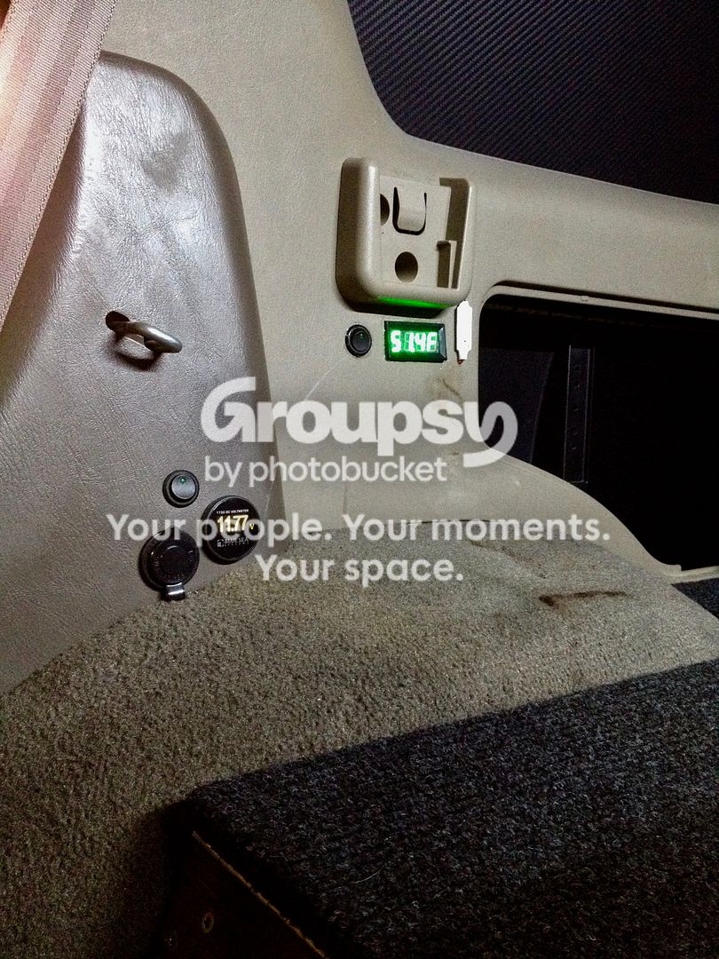

The main light is a LED strip light I had from another project, it’s mounted on the driver side above the rear window and I made an aluminum shroud to direct the light.
When the light is turned on it displays the outside temperature and battery voltage. I also have a 12 volt outlet for my electric blanket, and there is a switch for the awning lights.

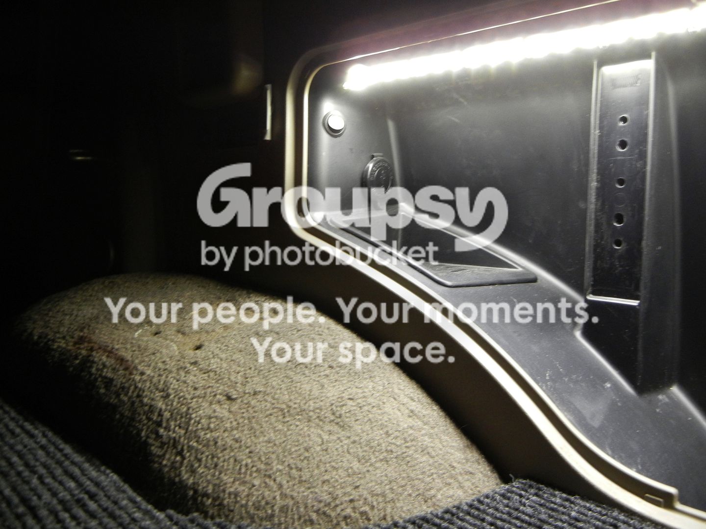

I converted the rear cubby into a nightstand area, where I can put my keys, wallet, phone, etc and not worry about loosing them. I installed some soft white LED lighting and installed a remote dimmer control. I also wired in a fast charge USB port for my phone and GoPro.
Great work that is superb! As usual a couple questions. Where are tools going and what is reasoning for keeping CO2 on such a soace limited build? No dual compressor buried somewhere..Looks like I could fit between the fridge and tank but I drink less beer. How wide is it? Ultimately Looks like you'll be able to break camp or hit the hay in no time now.
