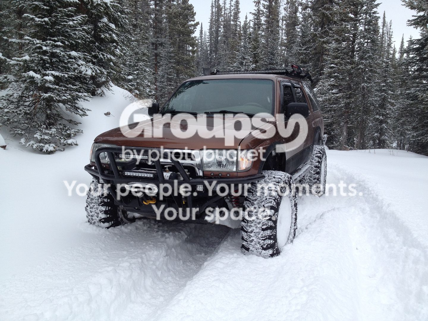

Unfortunately I’ve been super busy and I have not been able to take the 4Runner out as much as I would like to lately. We’ve had some unseasonably warm weather here, so I decided to take advantage of the situation and hit a couple high mountain passes before the snow moved in, and the gates closed.
These pictures are from November 14th, normally there would be several feet of snow.

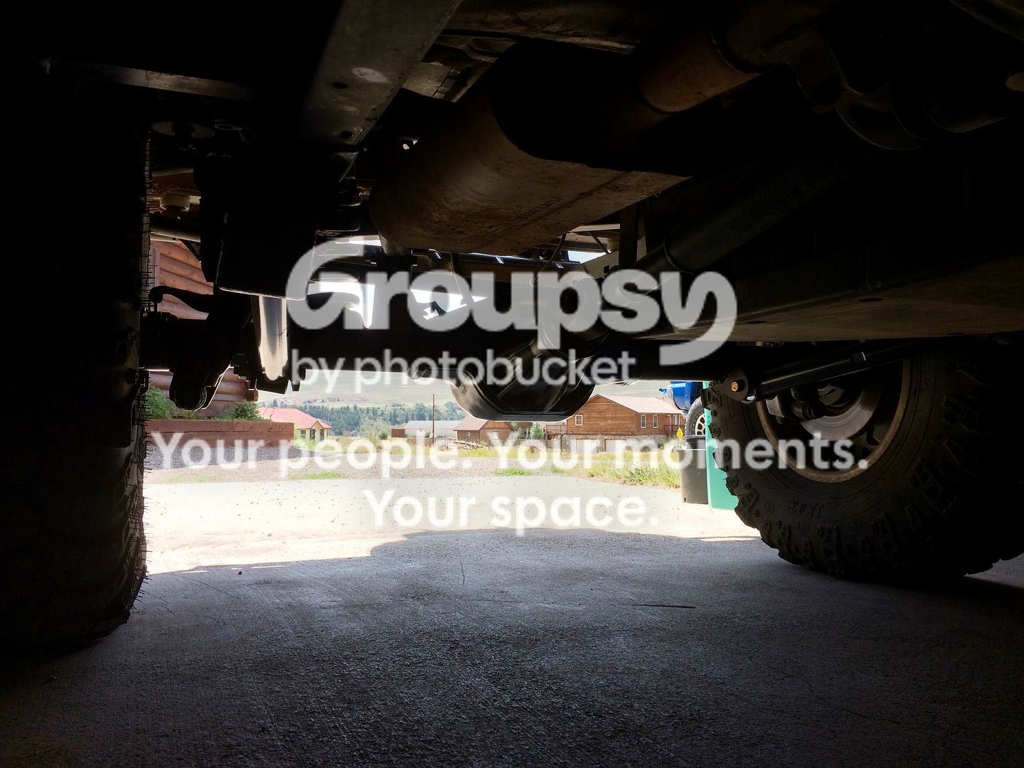

And now for the pictures everyone wants to see, the axle under the 4Runner! Note that I also built an adjustable panhard bar bracket to better the geometry a little.
Tons of clearance under the axle!

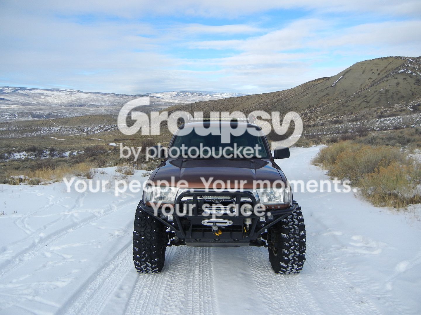

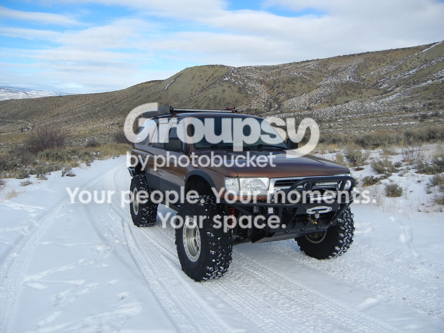

We finally got a little snow so I went out for a little adventure. The snow pack is well below average, but I guess something is better than nothing. I decided to run some other trails in the area; normally they would be snowmobile trails by now, but not this year.

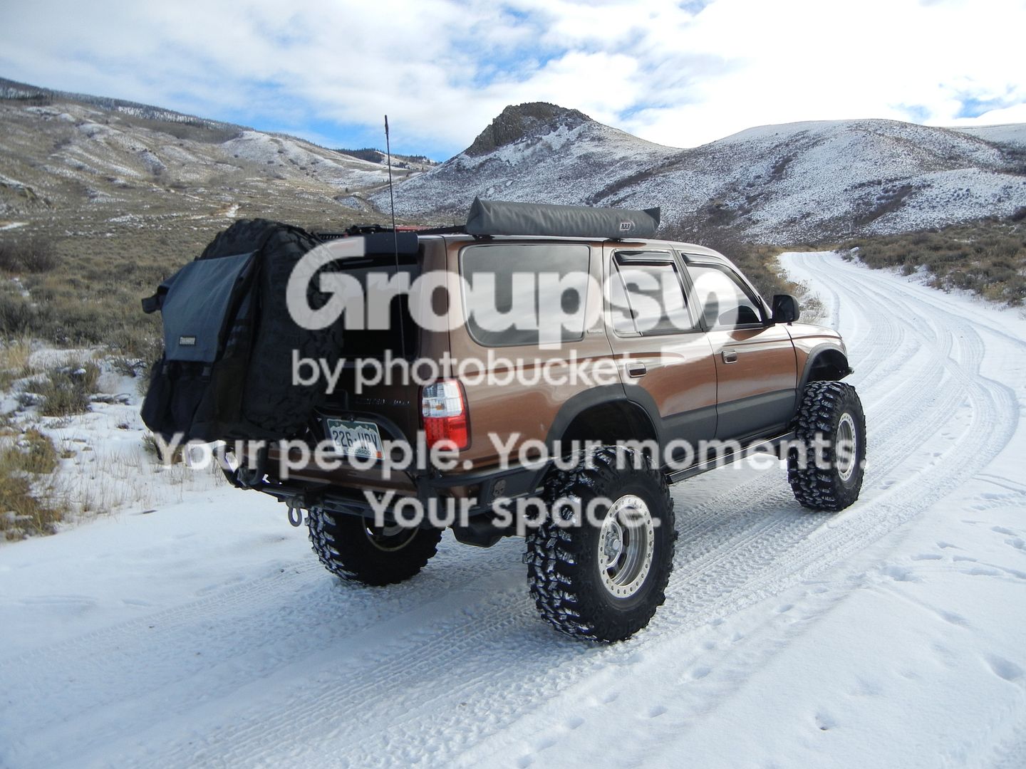

Sometimes you get an idea that sounds great in your head or on paper, but in real life it’s less than ideal. I was extremely excited to get a roof top tent for the 4Runner, as I’ve said before I loved the tent on the trailer. But, having it on the 4Runner was not ideal and not the same experience as the trailer. So I decided to remove it for the winter and think about whether or not I wanted a RTT on top of the 4Runner.
After my last couple wheeling adventures it sealed the deal, the tent will not be going back on the 4Runner. There are several factors, mostly logistical (I can get into details if anyone is interested), and the issue that the tent does not match my driving style or the terrain I like to wheel. It was a hard conclusion to come to, and I tried to make it work, but it’s not the right combination for this vehicle and now I know.

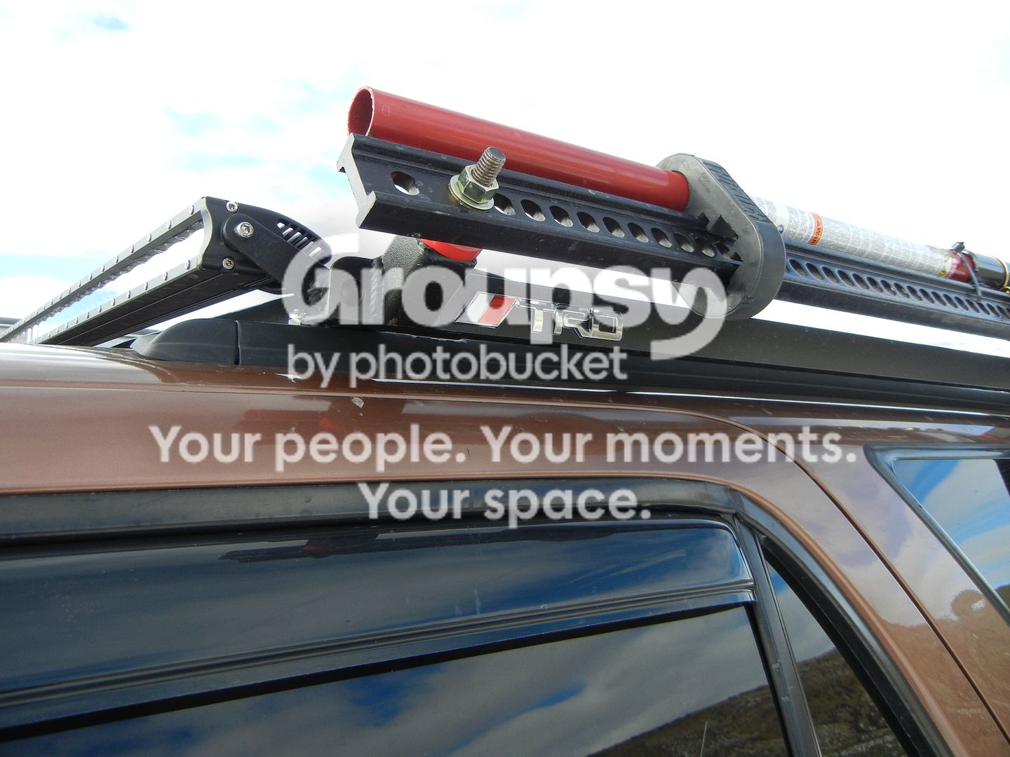

Step one of this process; I needed a low profile and light weight roof rack to hold my awning and Hi Lift jack, along with extra camping gear and firewood. I prefer the clean look of no rack, but with the sleeping platform in the back cargo space will be at a premium. I wanted to stick with the cheap or free theme (BajaRack has one, but I can think of better ways to spend $500) so I reused the rack that I built for the RTT and modified it to work for this application.

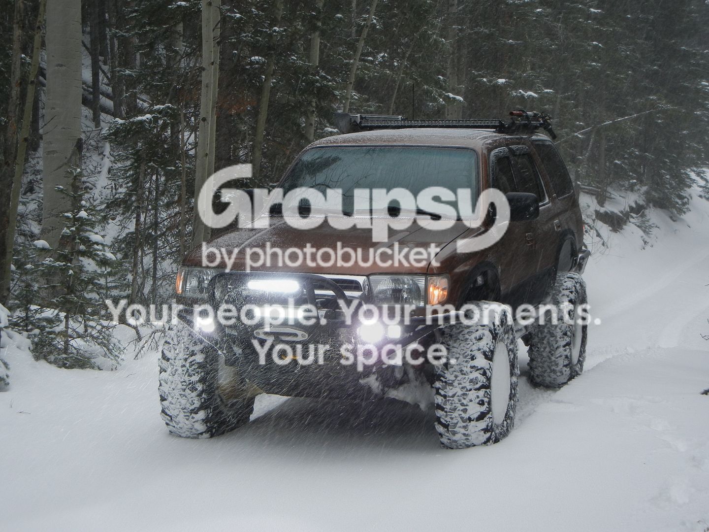

UH OH! Do I spy a new a new single row set up on the roofline?
Good eye Rick! The light bar is a 40” Rigid knock off, it will be wired to a remote so I can turn it on while driving, hanging out around camp, and when sleeping in the back (with out crawling up front).
