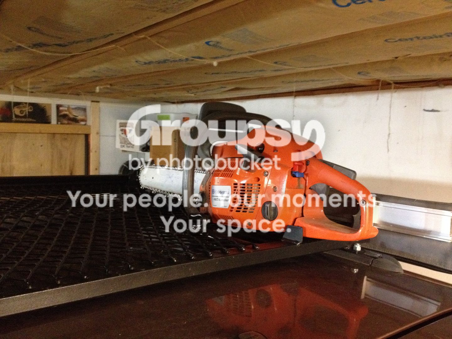

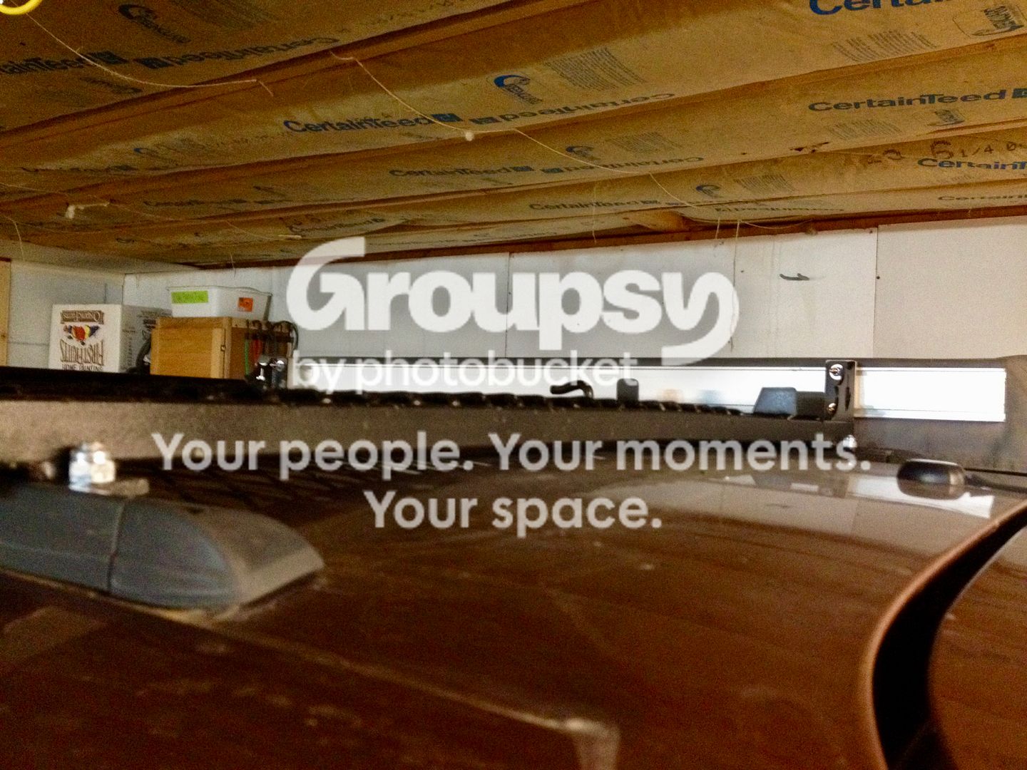

Here are some more details on the rack (sorry for the crappy pictures).
The crossbars are so low that I had to contour them to the roof.
The top is covered with expanded steel (used but free) for holding gear. The supports on both sides is round tubing so I can use tie downs wherever I want.
I also built a spot to carry my chainsaw, it has guides to keep the saw in place and tie downs for a ratchet strap.
