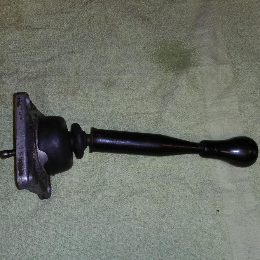

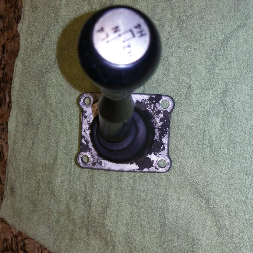

No luck on the shift rail but i've got the shifter. Its yours if you want it. It will fit in a flat rate padded mailer
