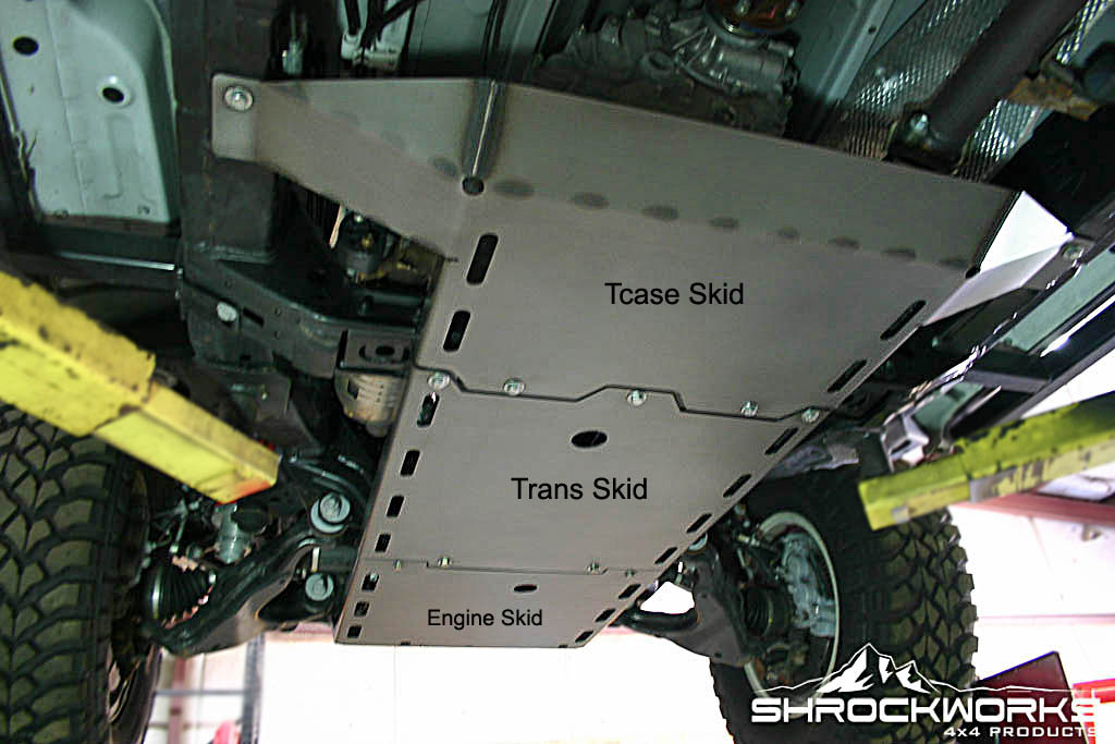

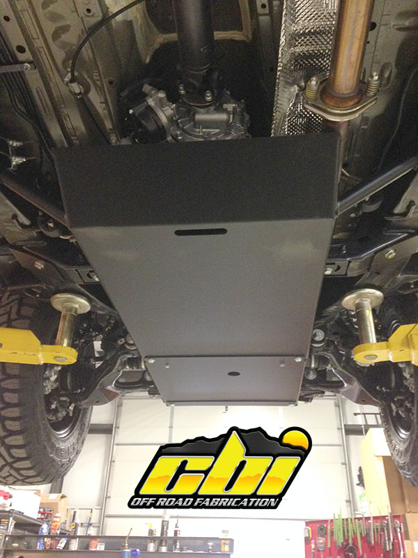

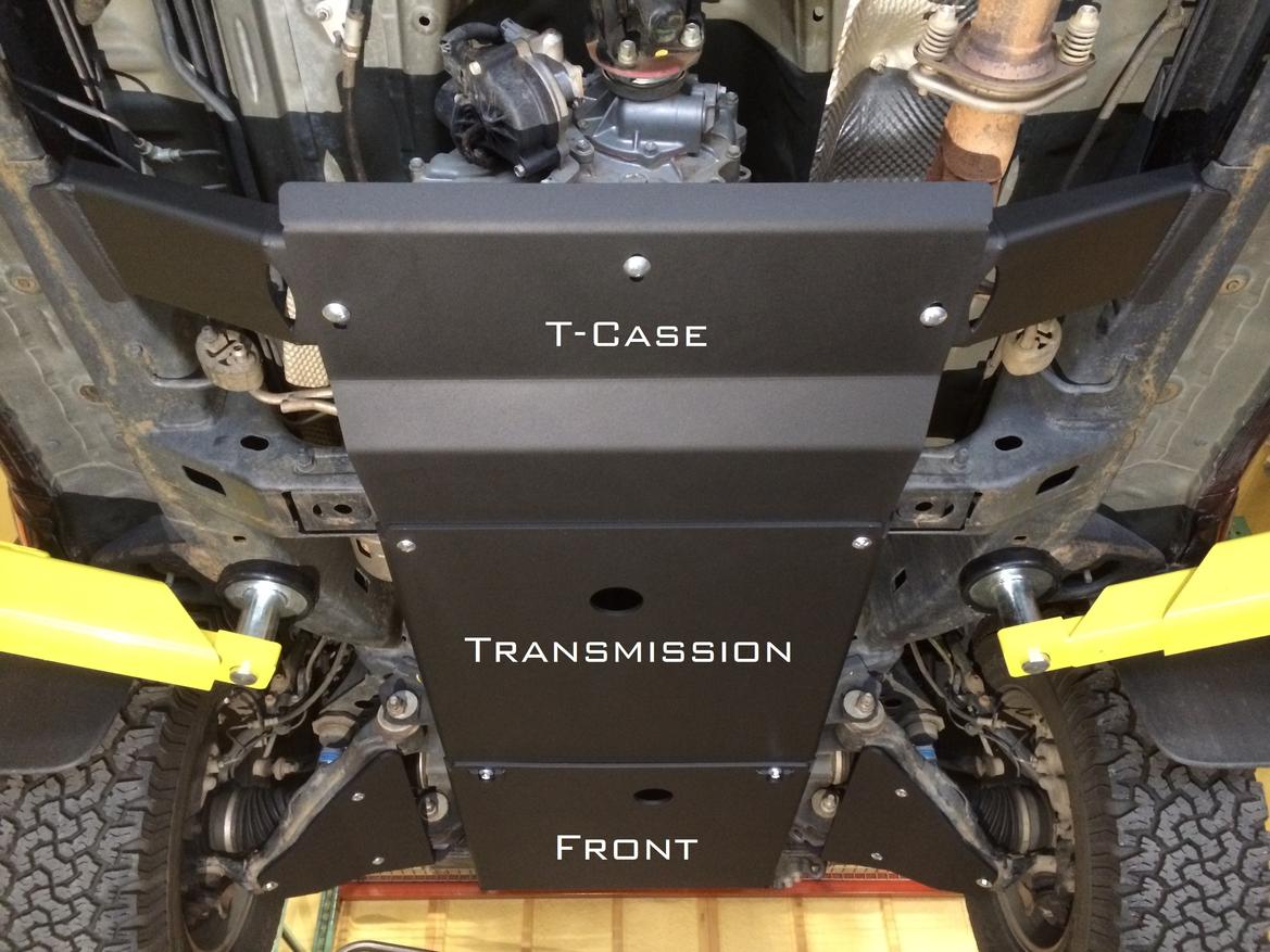

I'm looking for some DIY belly skid plate pics for the plate that is traditionally called the "second plate" from the front. This one goes under the Tcase/Tranny area.
I have a 1/4" alum plate that is fairly long and would like to make it work for the second skid plate. Before anyone asks, I have no idea if this is 5051 or 6062!! Already got a Asfir front skid plate so the area under the engine, all the way to the cross member is covered.
It looks like most of the belly pan skid plates simply anchors themselves to the same holes in the cross member that the first skid plate uses. I'd like to know what folks are using for supporting the second skid plate toward the rear. I assume y'all are building your own cross member and this is where I'd like some pics/ideas.
I uploaded couple of pics just for S&G.
Thanks.

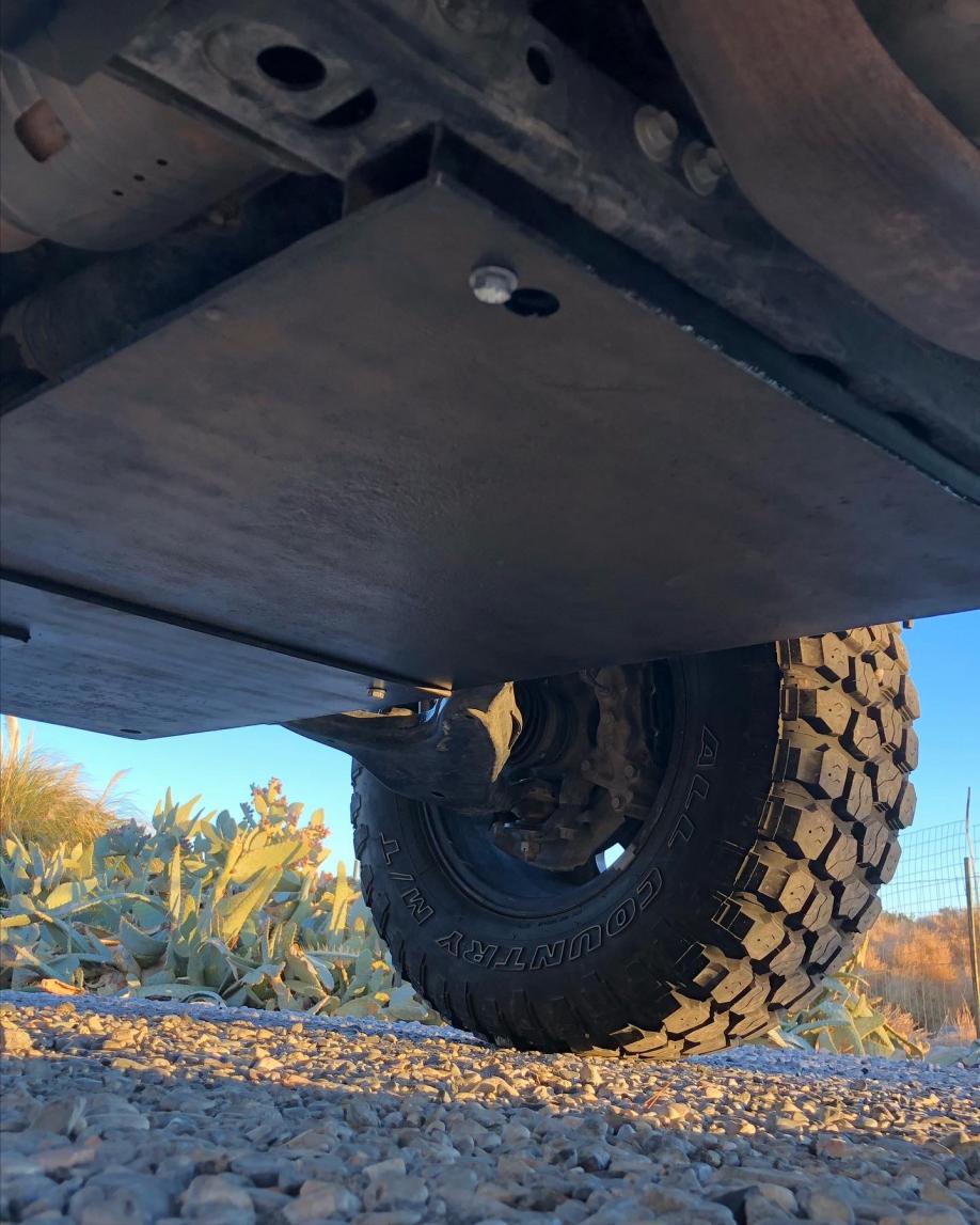

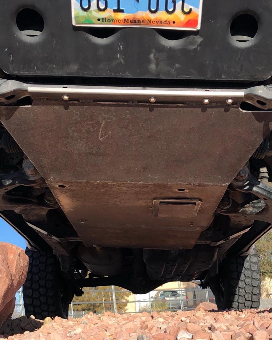

I’m DIY’ing my own skid plates too. My big question is with how you installed your transmission skid with the support bars removed. It seems that with the sheet metal spanning the gap between the crossmembers that it’ll be more than rigid enough. Also with tying in another crossmember behind the t-case too. Any input on this years later?
They've held up great to heavy wheeling, somewhat surprisingly.
With one caveat, if you try to remove them they are tricky to reinstall, the rear skid requires a floor jack to 'press' in place as the 2 tubes have flattened a bit over time.
Middle skid is bent and mangled but still does its job.
There are a few strength improvements I could make in hindsight but I have no huge reason to swap them out at this point.
