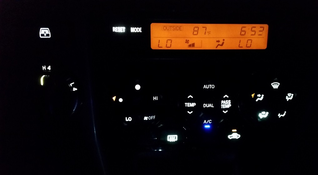

I'm open to any suggestions............. :shrug:
I don't have a lot of experience with screen backlighting, but the hot spots are definitely due to the spacing and light distribution. You need wide angle LED's that distribute the light better.
Good point, but with a distance of less than 1/2 inch to play with, a "wide angle" LED won't do much. I'm going for a "cluster" of leds with the factory light disperser and maybe another piece of plastic ( [MENTION=5149]riceandpho[/MENTION] ) to further disperse the light. That may be the trick.
Anyway, LED strips ordered...................
Yeah I guess he can spray it a reflective color or put reflective tape in there. Never tried it so I would know. I used the sanding etching trick in a few audio builds though.
I tried both of these methods with no luck. I used aluminum tape and then tried chrome paint. On both occasions it made the light dimmer. Of course this was with the reflector assembly stock and not cut up. What I found out with the stock diffuser method is the LED actually makes the square piece over it glow. So the little square piece is doing the lighting since it is thin enough to let the light glow thru it. Putting tape or spray painting over it just defeated that function and made it dimmer. I ended up carefully filing the square cover just a bit thinner and that helped but very slightly. Hopefully a better solution can be done. Good luck
Etching spray pretty much does what sand paper does. The reflective tape was for the backside of it, if you recess the bulbs a bit and use the light and reflective tape as a reflector.
I think your main issue is in the type of led though. It looks like it don't diffuse the light it'd all centralized. What was behind their originally? I never tried modding that area.
I understand where you guys are getting at. Thing is, there isn't much space to put traditional LEDs (big round ones and then file them to widen the beam) and the fact that I already hacked up the back plastic assembly, LOL. If my new idea doesn't work out, then I'll get another "untouched" assembly and jam NEO4 bulbs (make their own 12V connection) and call it a day.
I still think smd leds on a custom board will give you exactly what you are looking for. This is how many of the older tacoma radios were done. The was like 30 1206 (and many times just swappped to plcc-2) leds behind the screen. Search for posts of guys with 05-08 tacoma clusters.

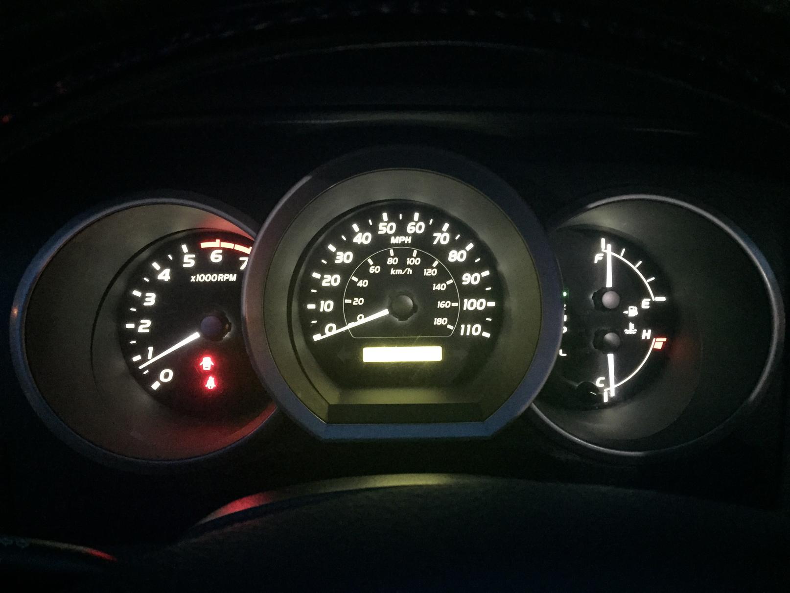

Thanks Yosh for my LED gauge swap. Great work, fast turn around time. If anyone else wants there's done I highly recommend Yosh and his work.

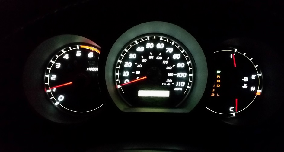

I finally did it! Thanks to all who posted pics of their adventures, findings, and accomplishments! Special shout out to darkie3495, of course, for the fan-freakin-tabulous post and follow up answers, HokieRunner, Riceandpho, CookieRoe, Yosh2000, and again, others for posting what you found.

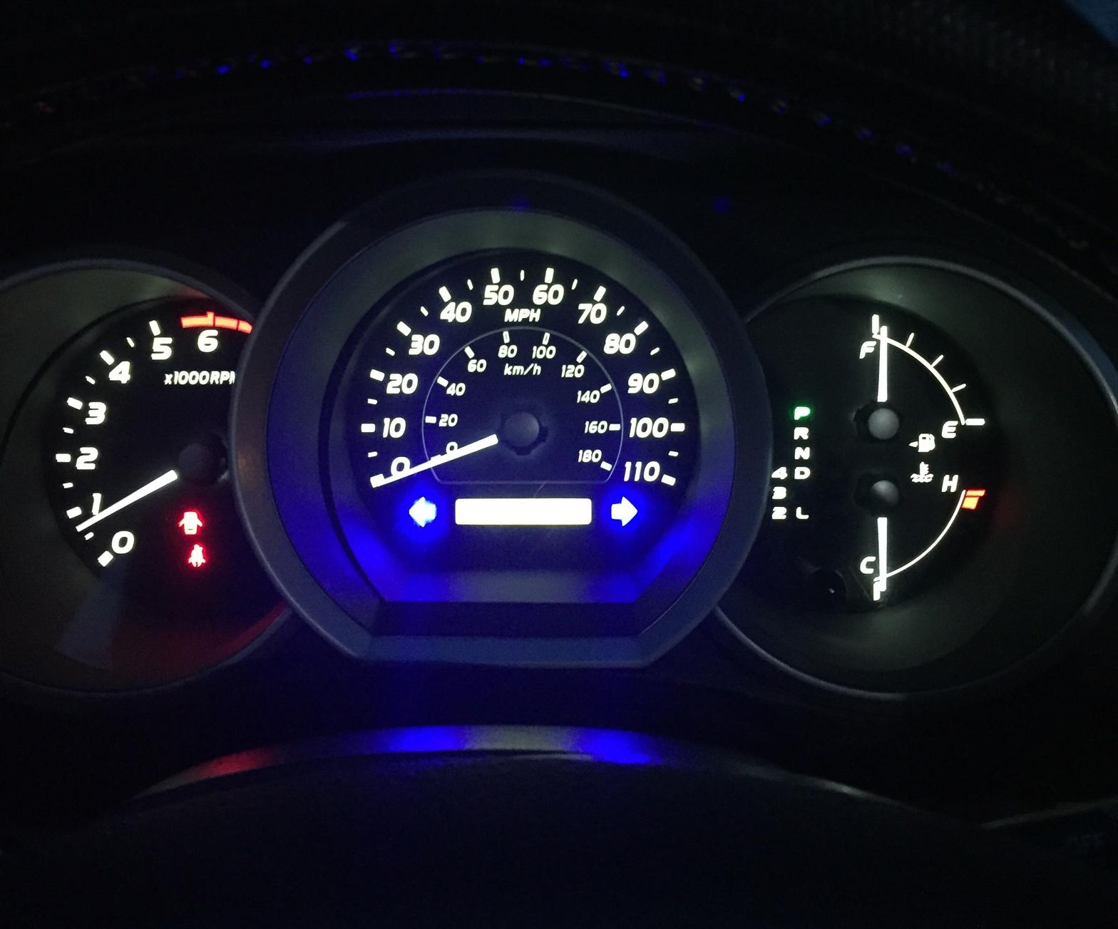

I replaced my backlighting to white on my instrument cluster. I didn't want anything else changed to different colors, such as the warning & caution lights. Sorry about the crappy pics. My phone didn't want to take good pics without a flash.

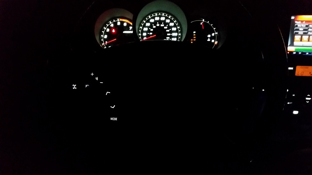

I also changed the steering wheel illumination.

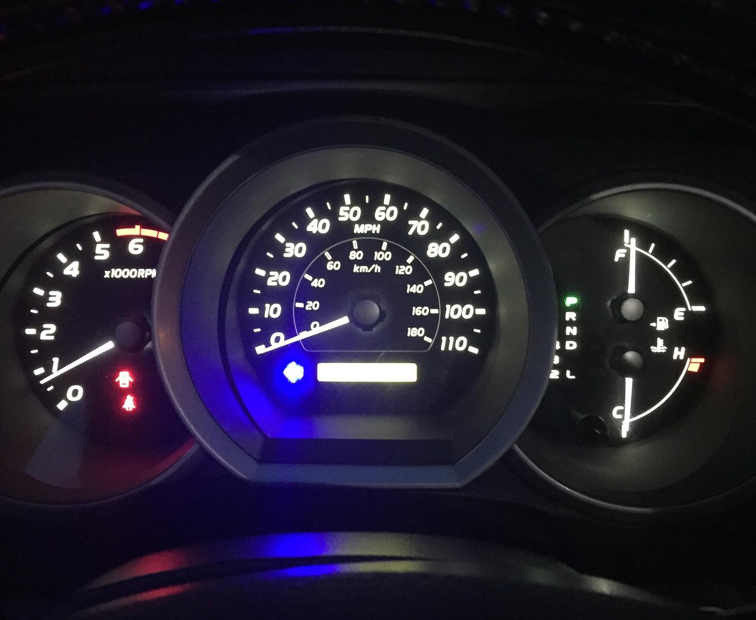

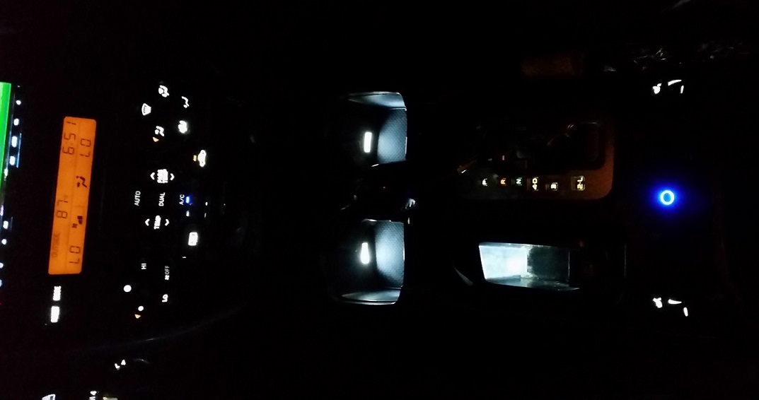

Next, I did my rear window switch, 4wd switch (used 2 plcc-2 LEDs), and the climate control switches. As you may have noticed I changed the A/C LED to blue as well. I haven't touched the display illumination - yet...... Not sure if I'm gonna. Still working out the particulars on it. I'm not thrilled with what I've seen on others, and I actually have another unit I have taken apart playing around with. More to come on that.
And here is my center console. I added a 3mm LED for each cup holder, and since I have no desire what so ever to install the "smoker's kit", I also added a 3mm LED to the small storage area next to the shifter. It doesn't bother me when I'm driving, and you can't even tell the light is on with the cover closed. I then replaced the shift / gear position light with a plcc-2 LED, and installed plcc-2s in my seat heat switches as well.
The slight amber light that you may notice reflecting off of the shifter assembly is from the Lexus overhead console, which has the ambient lighting. I haven't decided if I'm going to do anything to that.

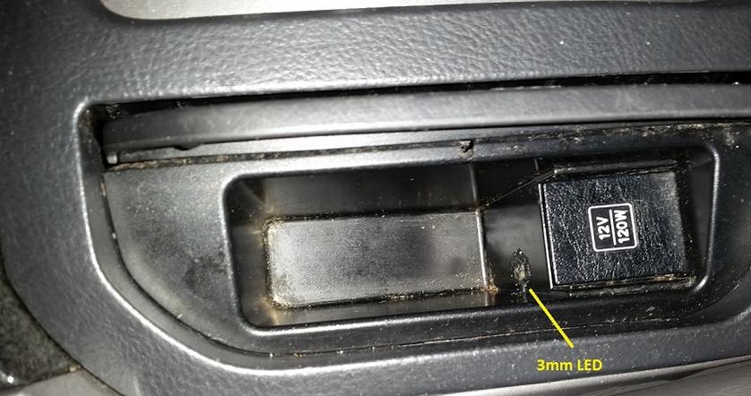

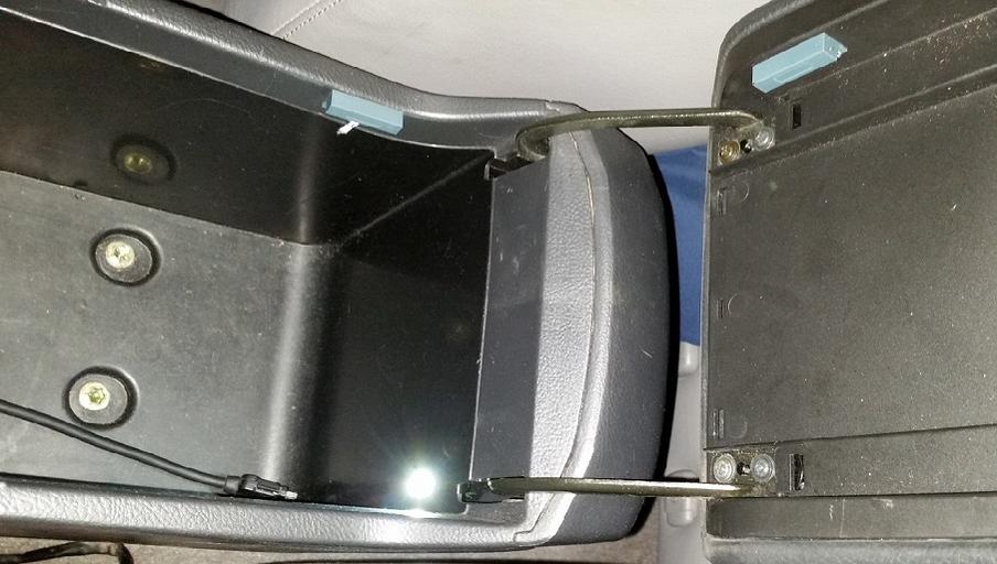

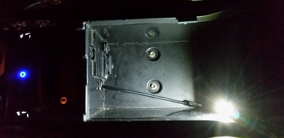

Then I decided to throw an LED in the center console storage box so I can see in there at night. It turns on by a magnetic switch mounted on the lid & side.

nice work. did you happen to take out the center console to get to the cup holder to do the leds? im just to lazy right now to fix it lol, but i do have a nice dim blue glow in mines, i had to dim my bass remote by using a sharpie to go over it. it dimmed alot so no one can see me inside.
Thanks! Yeah, I had the center console removed and completely taken apart so I could better run the wiring, drill the holes I needed, and install the LEDs easier. I then installed Molex connectors on each piece that I may remove again in the future, so I don't need to cut wires, remove LEDs, etc. I simply unplug it as if it was an OEM plug.

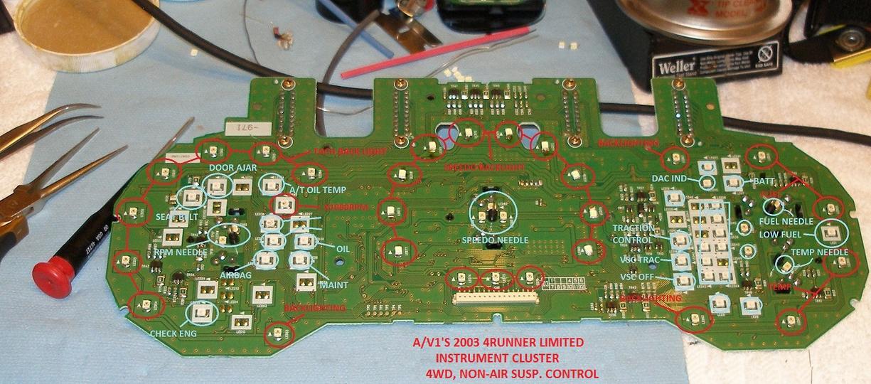

I also unfortunately didn't take too many pictures while I was doing my work. I think I get caught up in it and don't think of it LOL! But I did snap a few of the instrument cluster, which I labeled the ones I changed out in RED, and the others are simply in turquoise blue. There are a few I'm not sure what they are, but it really didn't matter. I wasn't going to change it out. But for anyone else with a Limited 2003 - 2005, this should be similar.

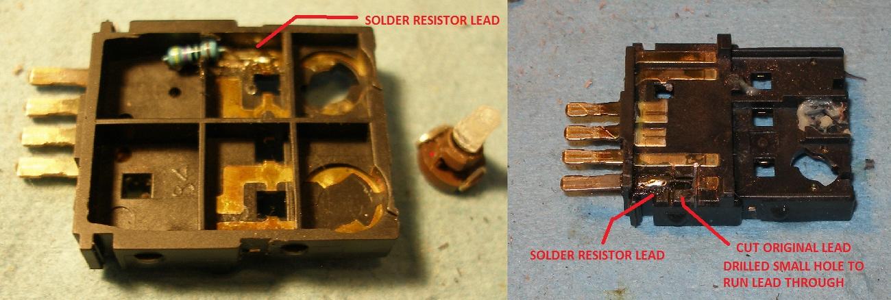

I did my switches somewhat different as well. Instead of installing the resistors into the lamp holders with the LEDs, I modified the switches to integrate the resistor into the switch itself. Then the LED was either hard wired (soldered), or installed into the lamp holder alone. I filed down all the 3 & 5 mm LEDs for better light dispersion.
