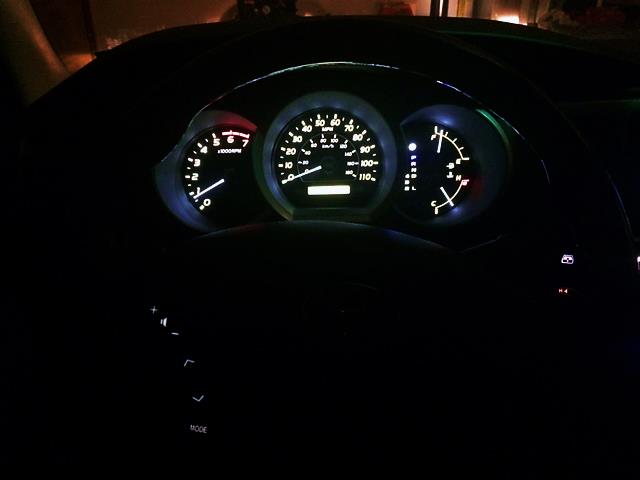

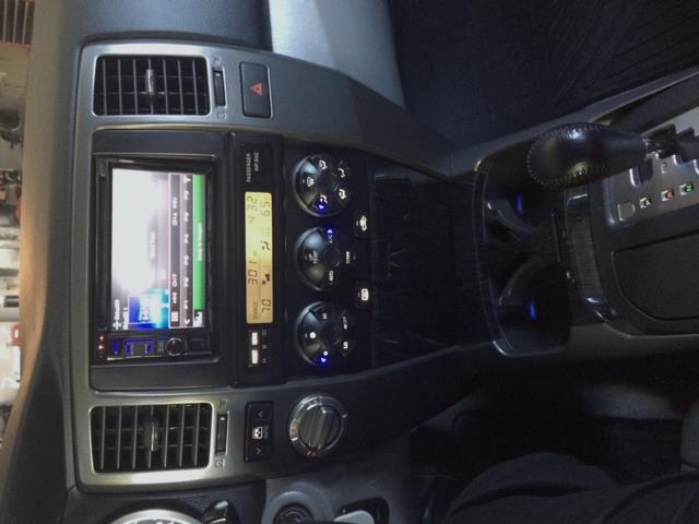

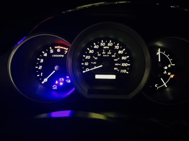

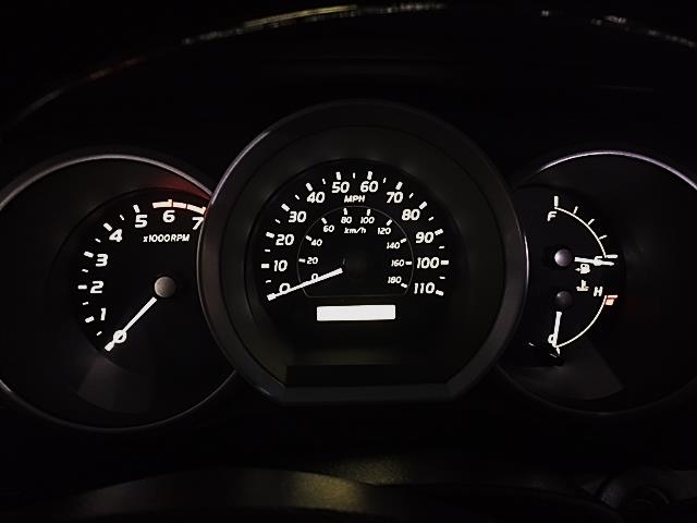

I'm sure its been done before, but I've never seen pictures of an LED swap using white backlighting with white needles. So... I thought I'd post mine. I'm very happy with them. Also changed most of the warning lights in the dash with blue.
Note, since the non-Limited 4Runners don't have needles individually lit, you can't just change the bulb to make the needle whatever color you want. You have to sand off the orange paint and add new paint. Or, in my case, just use a somewhat coarse grit to make an opaque white color.
Also curious what everyone thinks of the trim. I painted all the bright silver plastic trim to an Anthracite Gray using Plasti-Dip, plus Glossifier. Also put in a new Kenwood DNX572BH Head Unit with GPS, Bluetooth, and SiriusXM. Love it.

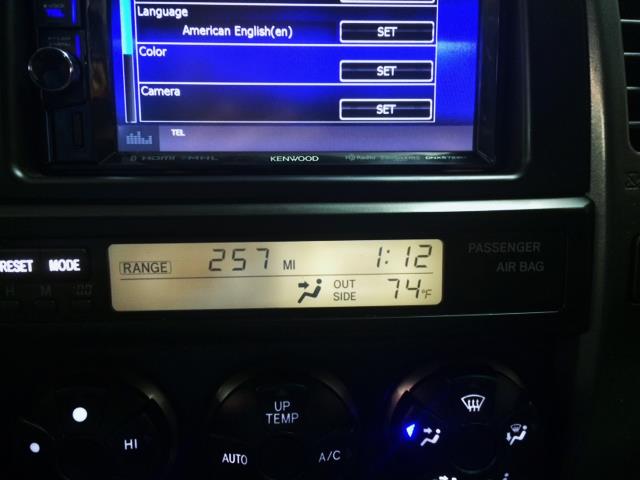

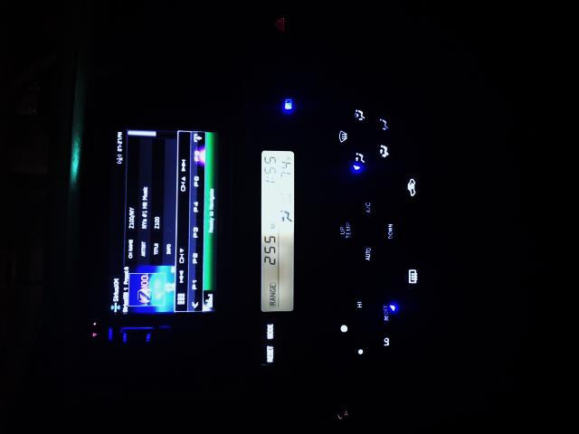

I used Neo4HPs on the HVAC screen, Neo3 standard bulbs on the switches and knobs, and 74 LED Bulb - 3 SMD LED - Miniature Wedge Retrofit bulbs on the shifter, cup holders, and glove box. The 4WD switch takes a Neo4 bulb... but because it uses a diffuser, the lighting won't be uniform. I decided to keep the existing bulb but remove the little rubber colored jacket from the bulb. It's still an amber color, but maybe a little brighter. I chose white for the the following:

looks good [MENTION=130045]SteveAndStaci[/MENTION]! Seems as though one side of your info display is brighter than the other, or is that just the camera? also, you used HPs in the info display, did you wire them for 12v or did they just work? i was always under the impression you had to do the highly secret 12v mod to get them to light up, is this not the case?
Yeah I can't take credit. The guy with the highly secret 12v mod did mine. You're right about the screen. Both sides are working but one is dimmer than the other. I'm sending it back to redo... all we can guess is maybe a bad resistor in the LED. I have a new one on order.
For as much stuff as I just finished doing and for as far apart I had taken the vehicle, I'm happy with just having to make a couple small fixes!
resistors rarely go bad. i wonder if the secret way is wired in series, therefore giving less voltage to the one side?
Not sure. But all the other photos I've seen where [MENTION=63211]emelianenkov[/MENTION] has done the 12V mod, the lighting looks even. I think its just a one-off issue. He said he'd fix it and ship it back next-day. Hopefully soldering in a new Neo4HP bulb will fix the problem.
That's what I'm thinking, could be the same issue I had with mine. One side (LED) of my HVAC would constantly go out. The "secretive 12V mod" is faulty.
Well my version of 12v mod been flawless. No problem yet or led burnt out. Should of unwind the leads and find the pos and neg. Tap the pos to a switch acc source and ground out the neg. This way it'll stay on full when the key is in acc. Also it's not control by the dimmer no more.
