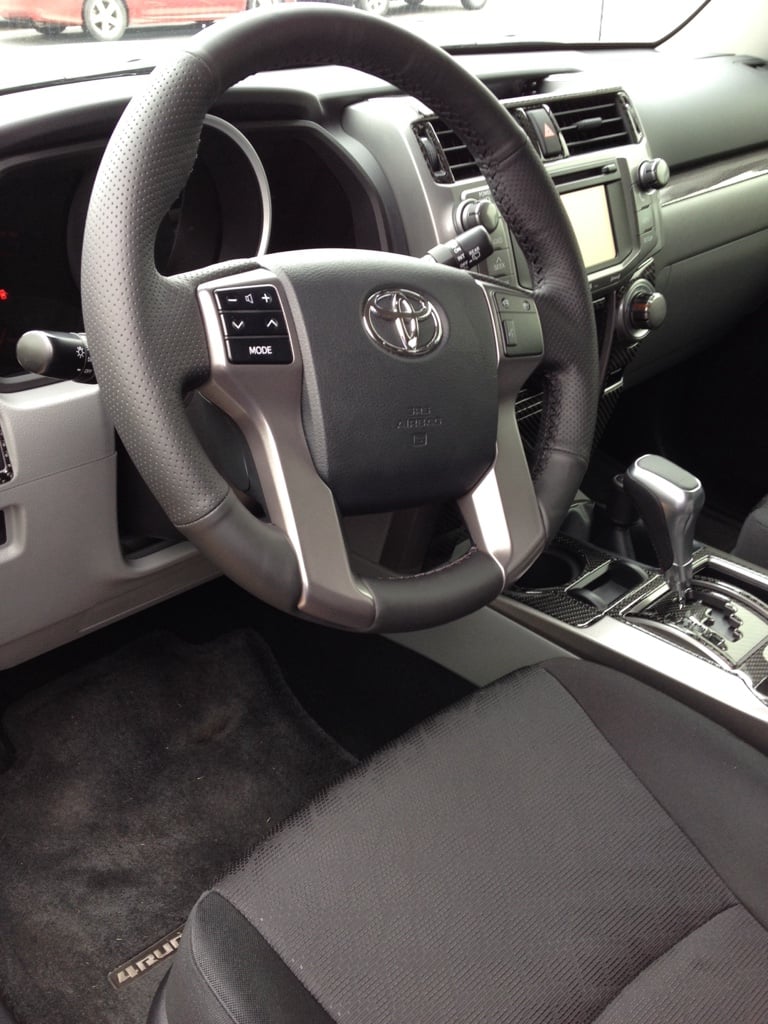

2. Installation examples
Leather Steering wheel cover '14+ - TundraTalk.net - Toyota Tundra Discussion Forum
803F0479-4ADF-4B7F-A9A4-B97709AC12EE_zpsmox7csxy.jpg~original
70F491A8-FDB7-44C9-BA04-BF4652321876_zpsf1gsmlzl.jpg~original
A50D0A3F-9C20-4202-9B9B-32B4E792A308_zpsbva1xavx.jpg~original

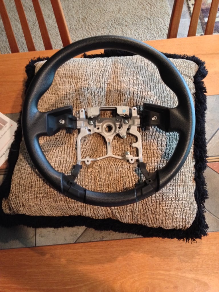

3. Optional Steering Wheel trim removal
Tundra to Tacoma steering wheel swap? - Page 2 - TundraTalk.net - Toyota Tundra Discussion Forum
photo1.jpg~original

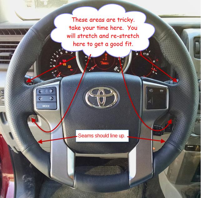

4. Kelbad's link
http://www.toyota-4runner.org/5th-gen-t4rs/195438-xuji-leather-steering-wheel-cover-install-goodbye-plastic-steering-wheel-oem.html
155671d1430366615-xuji-leather-steering-wheel-cover-install-goodbye-plastic-steering-wheel-oem-wheel-1-hints.jpg~original

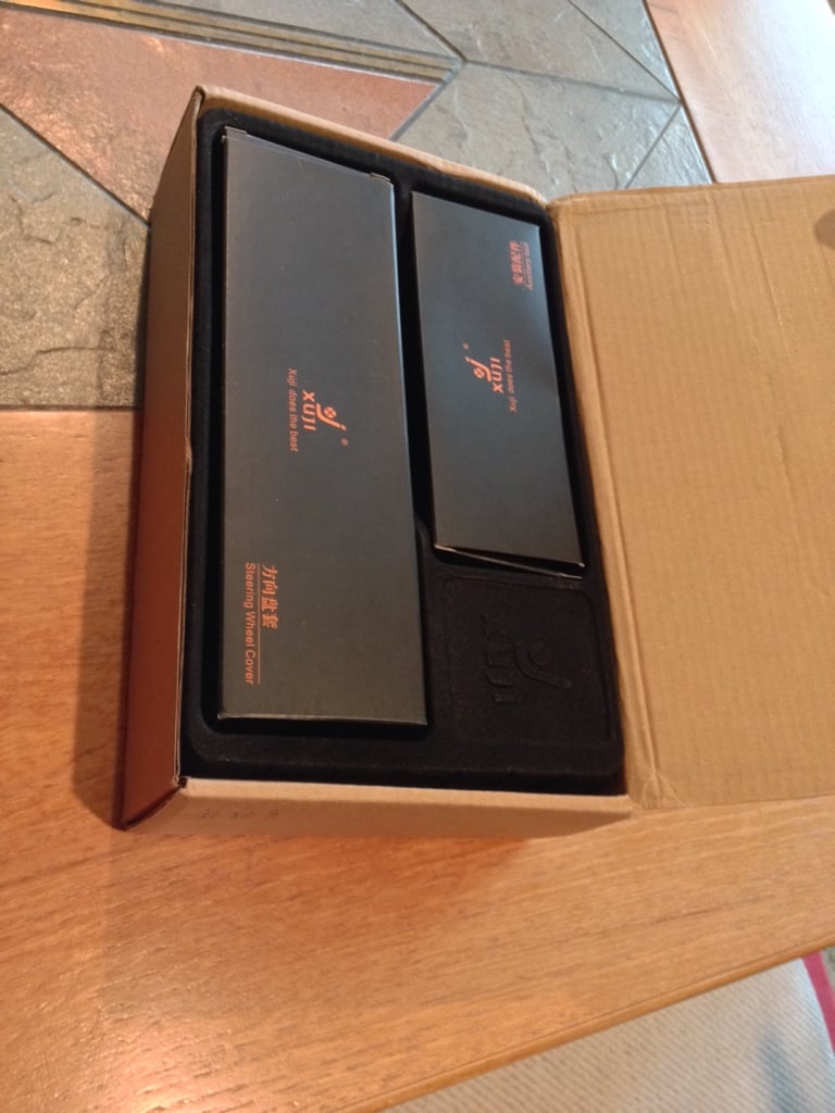

Okay, pics...
Here's the kit, pretty nice and pretty good quality leather if you ask me:

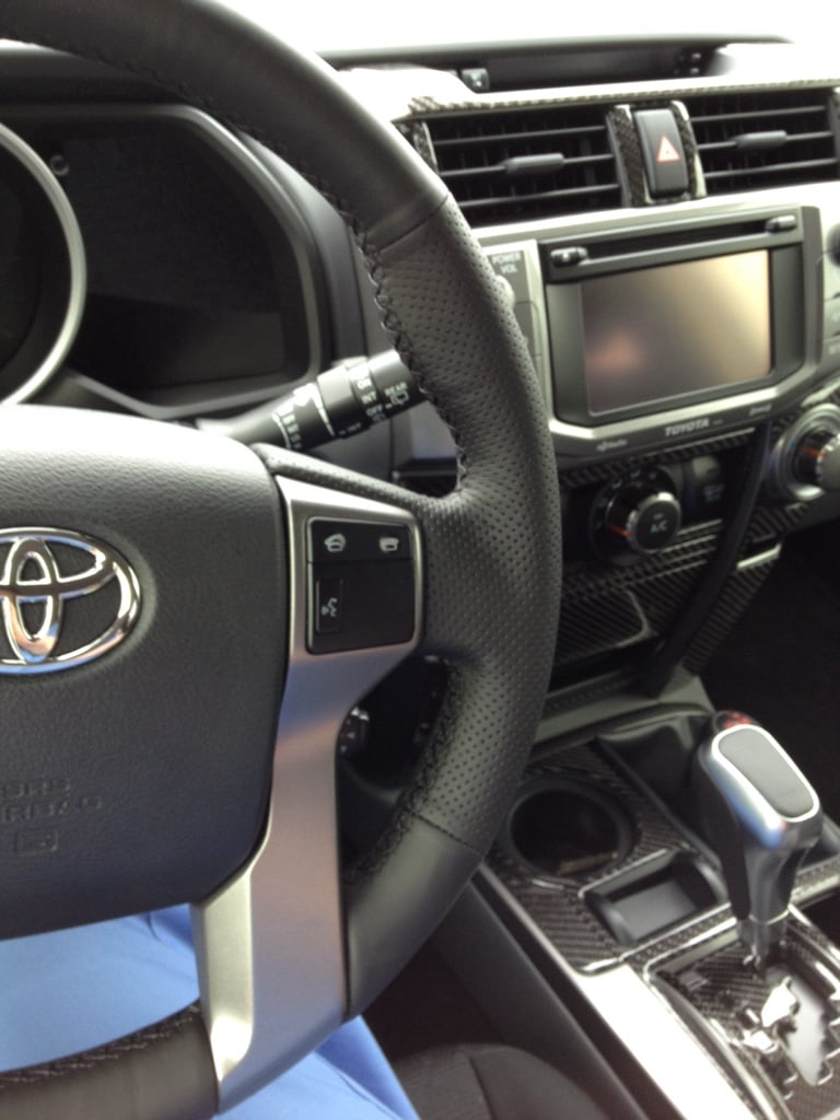

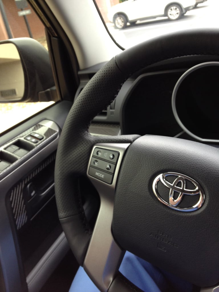

Finished product:
Overall, I'm very happy with the way it turned out, but it took me close to 5 hours to finish it, with about an hour searching around the 'net to figure out how the hell to start the stitching
I even had to figure out how to thread the needle properly, didn't see anywhere that said you have to pull the thread through the needle halfway, tie the ends together, trim excess string right up against the knot, then thread through the leather on the back side, from the inside first!
My fingers are definitely sore now, you pull on the thread quite hard to cinch the seam together. I thought for sure I would tear through the leather with the amount of tension I had, but I didn't, surpringly!
Took the vehicle for a quick drive and must say it feels really nice! Looks completely stock and doesn't twist or spin on the steering wheel, which was one of my other concerns about this "mod".
If I have any issues with it down the road, I'll post back here, but I doubt there'll be any---I hope!
