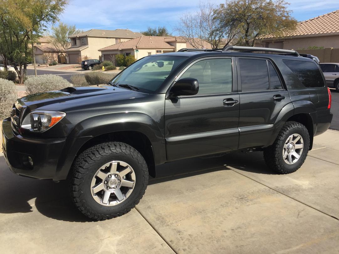

Do you have any pictures looking straight down the side? I'm debating on getting wheels with a different offset or fj wheels with spidertrax
I have the 1.25" SpiderTrax Wheel Spacers on but heret hey are...without the spacers, suck the front wheels in and you'll see how they look in raw form...
sorry for the stupidity but you confused me. You said you have them on but then here they are without the wheel spacers. From the picture that looks like there are wheel spacers on fj wheels correct?
I have them as well without spacers, and love the fit.
Sorry for the confusion...the wheels spacers ARE on in the picture. I have left them on since doing the wheel and tire swap. They work great and haven't given any issues to me while rolling or sitting...I had just a tiny bit of rubbing when I installed the spacers but that's easy to eliminate with pushing in the inner fender liner towards the bumper and I had no rubbing after that...I hope that made a bit more sense...
Perfect I'm on the same page now thanks for the pictures!

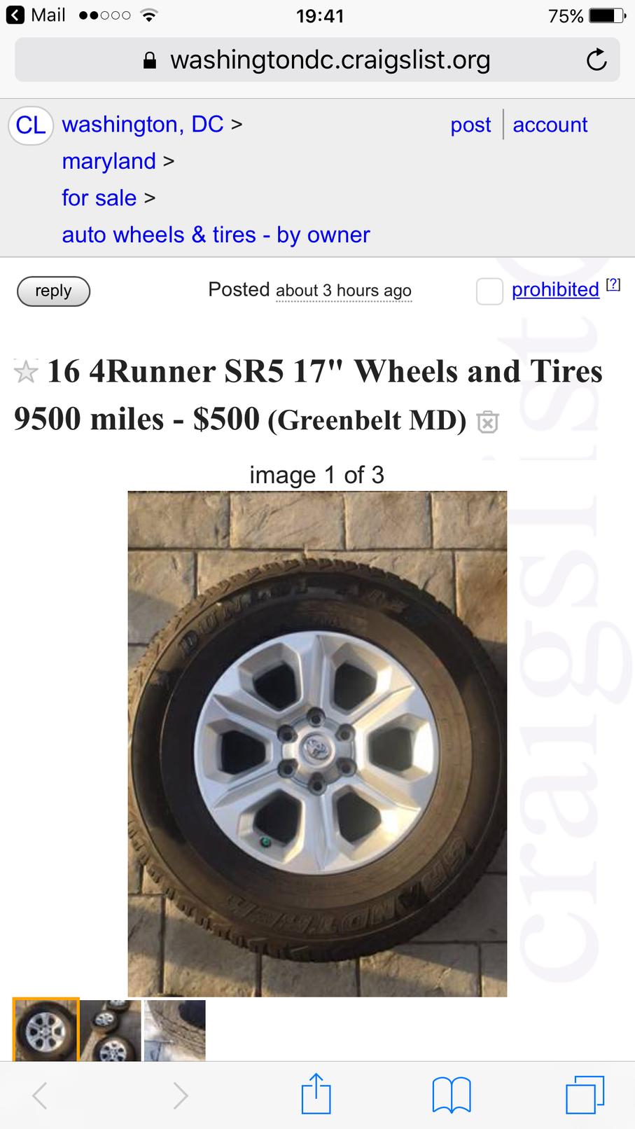

I think I'm good to go, but wanted to confirm. Will these 16 4runner SR5 wheels fit my 2005? Thanks

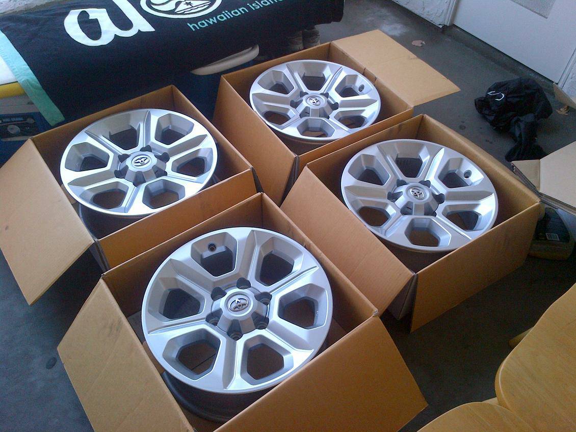

Got mine for $300 pulled the spacers and sold them for a $100 and sold the old sport rims and tires for $400. Love the new wheels and happy to not have baby sit the wheels spacers anymore....
