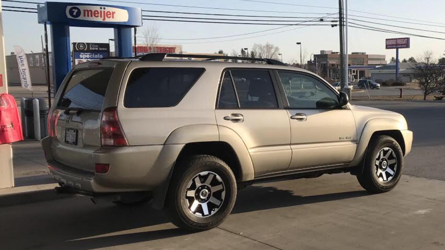

Got mine for $300 pulled the spacers and sold them for a $100 and sold the old sport rims and tires for $400. Love the new wheels and happy to not have baby sit the wheels spacers anymore....
Did you have to do any trimming to fit the center caps securely? or is this photo with wheel spacers still on?

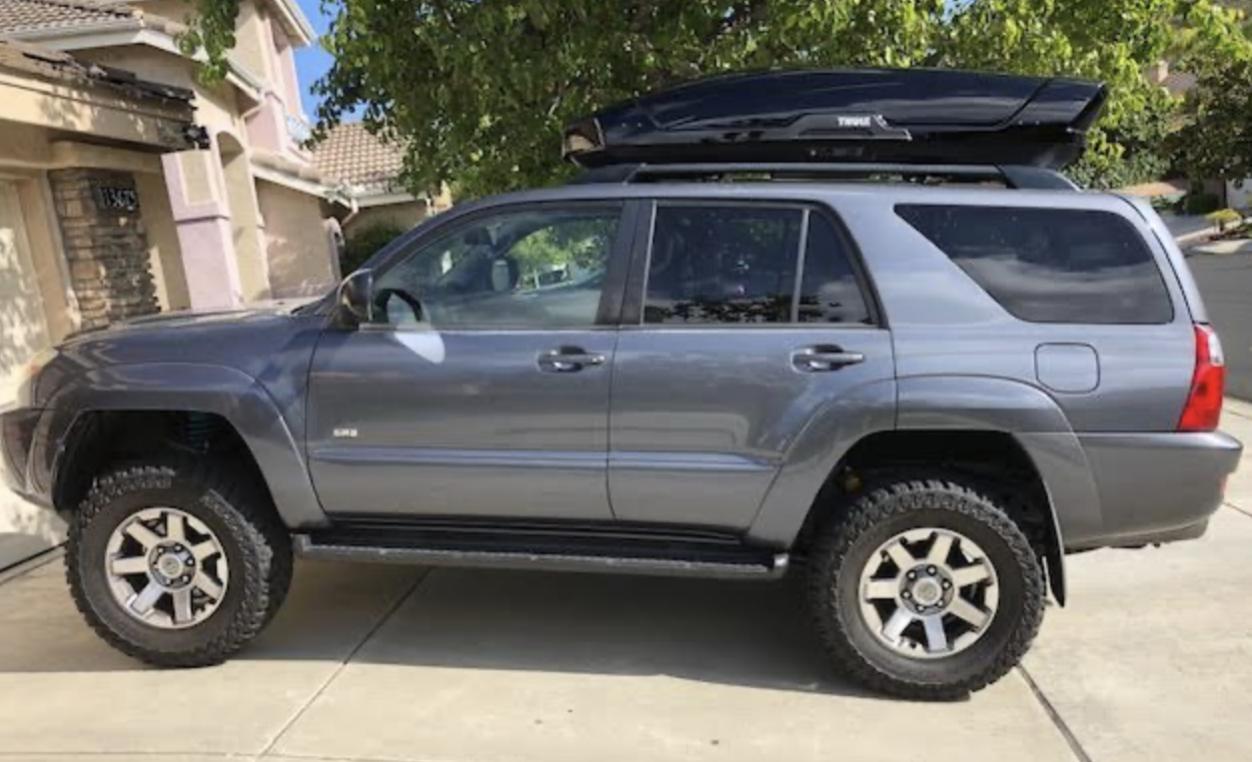

275/70 E Load Cooper ST Maxx w/ '18 Trail Prem wheels. Hefty at 31.7 lbs each but much better looking than than the 16" OEM they came with
