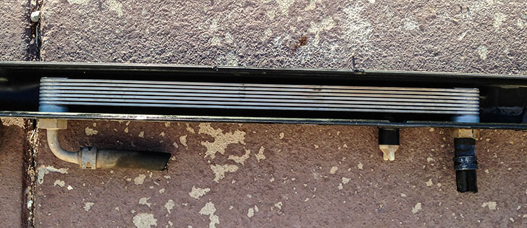

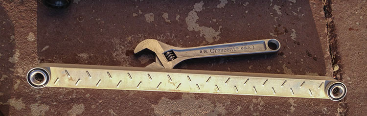

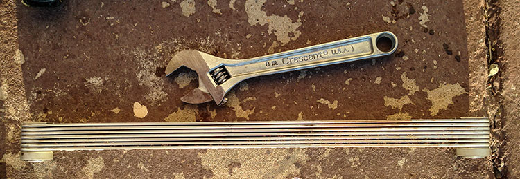

I was quite surprised! I suspected MUCH more cooling, like rows or a tube looped through somehow...
Obviously even the smallest B&M provides much more surface area and this explains why folks are getting improved tranny cooling with by passing this little thing.
Also I'm unsure about the circulation. I drained the trans pan again today and it is slightly brown and thin when cool. The stuff that poured out of here was quite dark and thick. Took some time to drain out...
Sorry OP..hopefully this adds to the discussion.
Warren

LOL thats crazy, how small the stock trans cooler is.
but that cant be? it seems like a standalone unit in your photo and the reason for pink milkshake to occur is there is some sort of area where they should "link" up and only be separated by some sort of gasket/o ring/ something
A thing to keep in mind is that oil/trans coolers that use water/coolant as the cooling source instead of air are much smaller. With air you need a lot more surface area and airflow so they need to be bigger. So comparing the size of this to the air cooled B&M just by looks and size alone isn't conclusive. Now I am not saying it works better or worse, just saying that different kinds of coolers are different sizes.
Here are some high performance liquid oil coolers by C&R, see how small they are, very similar in size to our stock one...
Not sure how these work. A quick google found little to explain. While they maybe efective they are being "cooled" with 180°-200° water compared to even extreme 110° ambient T, not counting wind chill and surface area.
Just yesterday I was a strong advocate for NOT by passing this puny cooler (before I realized how puny it is!) Now I'm not so sure. I can't imagine it adding much to the cooling system in exchange for strawberry milkshakes...I just put in a new radiator and B&M in circuit... may try it with just the air cooled.
