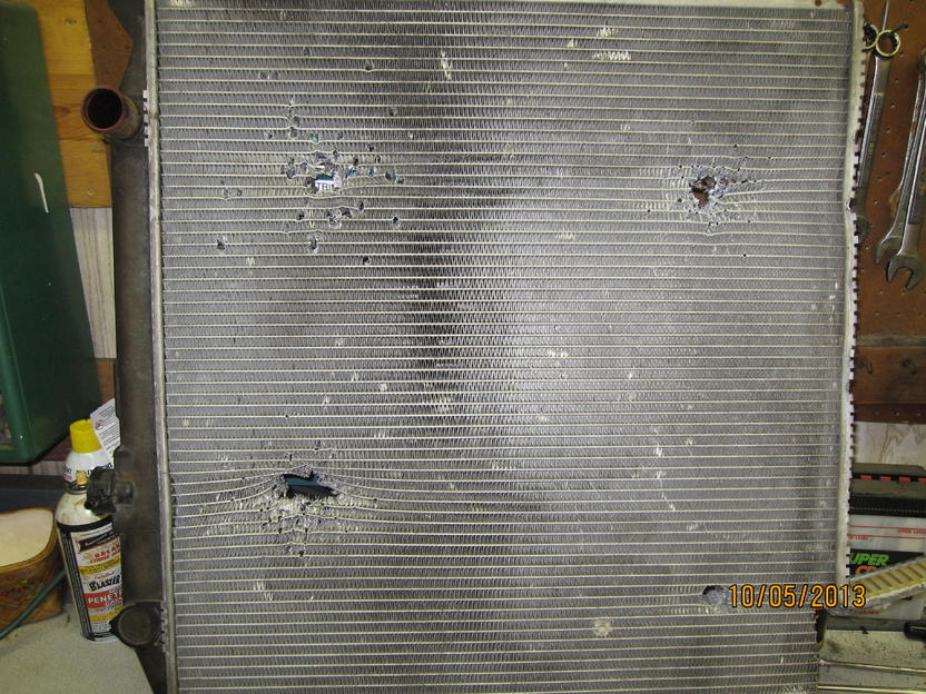

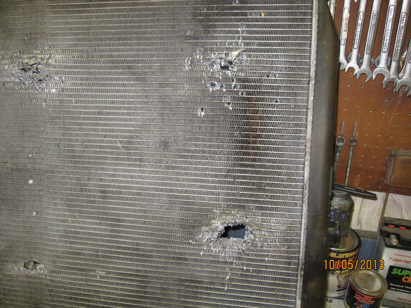

Do I sawzall my radiator in half for you'all

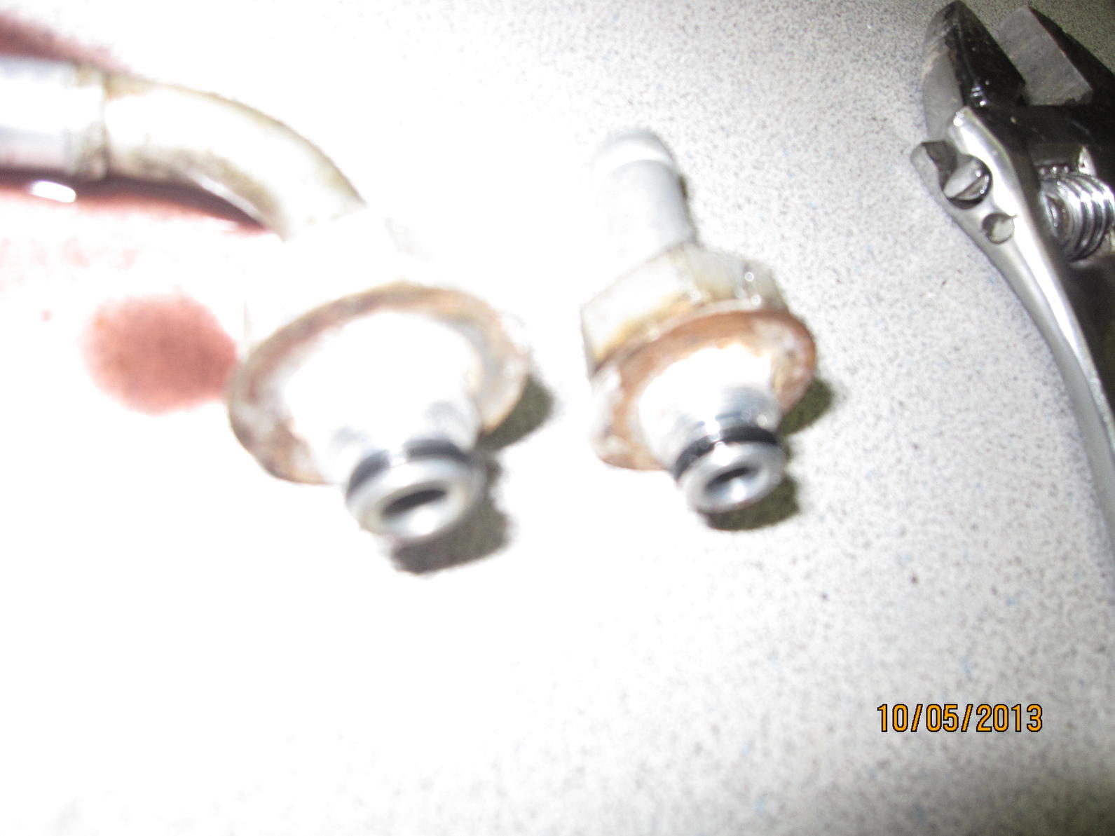

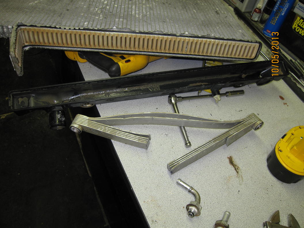

The 12 gauge slug was the big hole,#4 shot in other hole,all in all Toyota failed rifle test(haha) The close up of fittings was blurry but corrosion going on there.the sludge in bottom was gritty like fine talc powder,but brown.Once again very impressed with overall condition,any one note,It came from factory with green antifreeze,was switched to red toyota type by the dealership at 60k flush,unbeknowst to PO.My manual also states that red used only after 2001 models?

Thanks for the pics. As I suspected, with decent maintenance the radiator section is robust. I'm leaving my manual transmission rad in there for the foreseeable future.

What we need to do next time the milkshake happens to someone is take the bottom part of the rad off with cooler still intact and pressure test it.
Although I'm sure shooting it and cutting it up was loads of fun!
This would be a great idea. Kind of surprised no one has done this before?!? After looking at the pictures, I'm thinking the main reason for the milkshake is the "O rings". But like Kball said...It would be really cool if someone could actually test one!!
