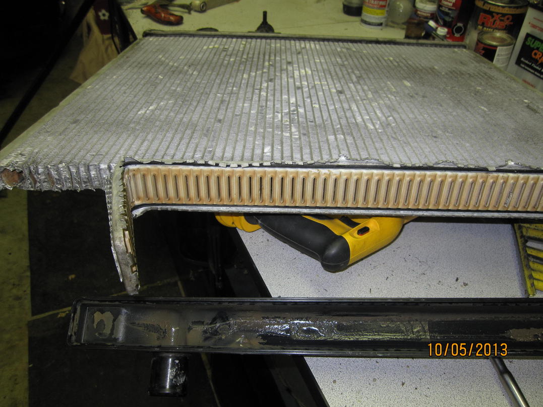

Hey Hey Hey dont be haters! With three kids,football games- wife -etc etc work in gargage is usually "all ahead SLOW",fear not last nite got new one in and after I run it a day with no leaks the old one WILL be cut up and then gracefully blown apart with the ol remington 870 12 gauge,till then -your gonna have to wait. guess in retrospect shoulda started this thread AFTER i had pics HAHA.

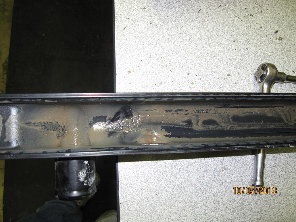

IMG_2659.jpgSludge in bottom

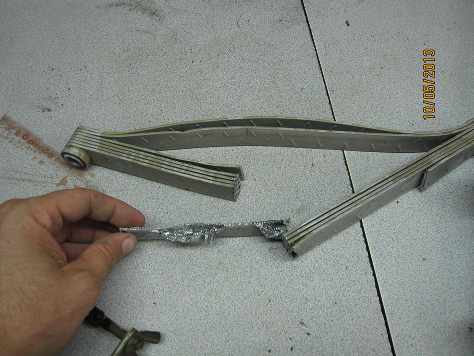

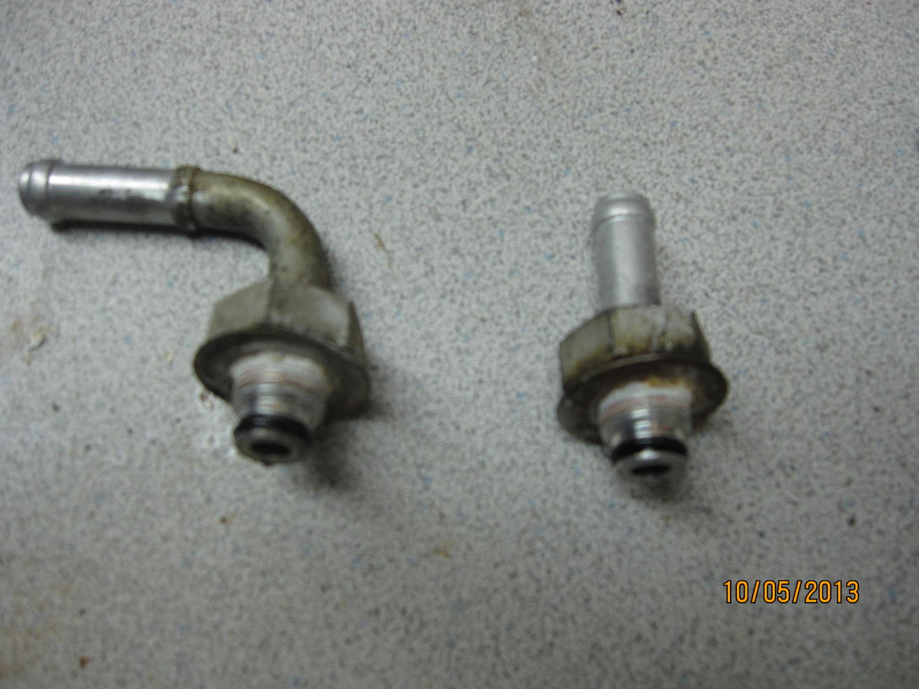

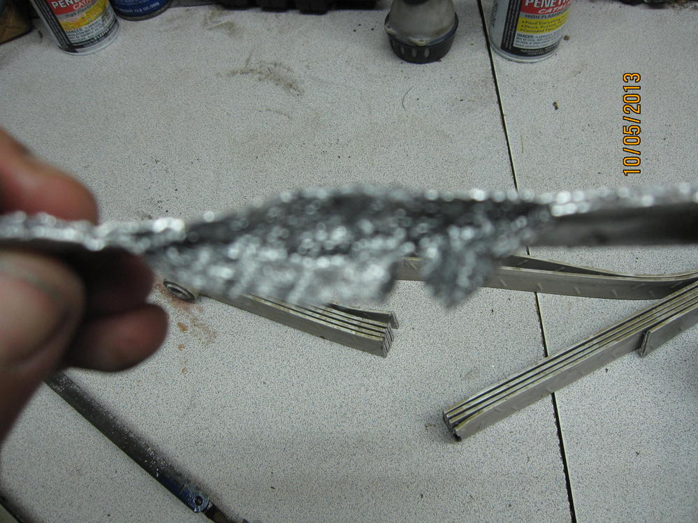

You can see the exchanger has a fine mess inside for gunk to accumulate on the tranny fluid side,also note the tran line connection corrosion beginning.That is where Im assuming pink milkshake is born,rest of inside of rad had only light tan film,no flaky white stuff anywhere,freakishly clean!
