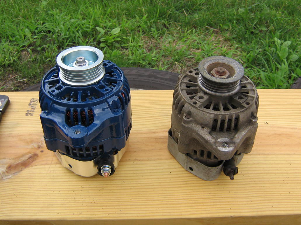

I painted mine with POR 15 caliper paint.

I painted mine.
