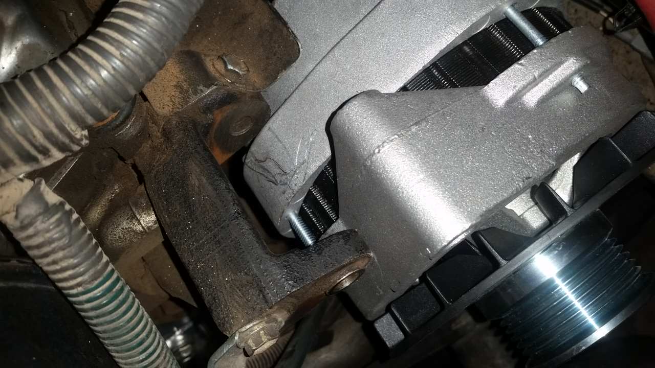

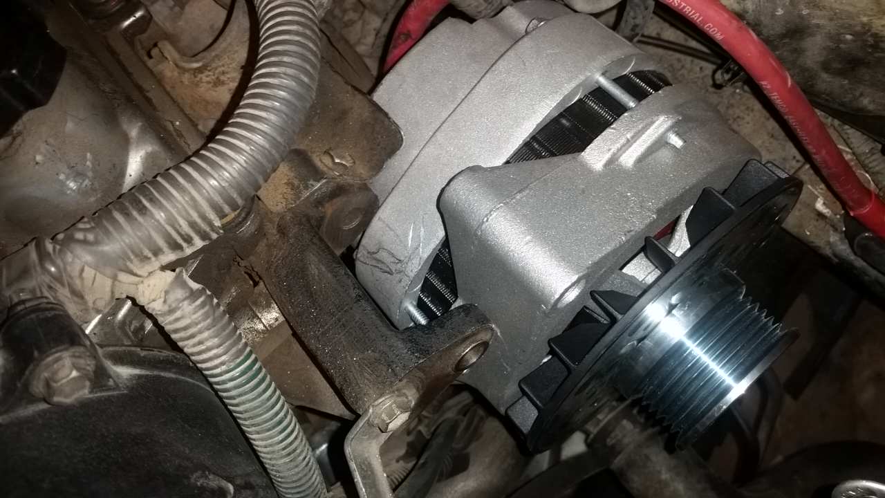

For the life of me, I can't this cs144 to fit in my 98 4run! Did you guys have to do anything to the lower bracket or the shield that's just under the valve cover? uhg!
this is the one I bought: https://shop.advanceautoparts.com/p/carquest-premium-remanufactured-alternator-7966-2a/5210984-P
feedback MUCH appreciated.
You will need to loosen the alternator adjusting bolt and slide it out in the bracket as far as it will go away from the engine. I've had to loosen the bracket itself a few times too just to get it into place. It's a tight fit for sure.
My issue was the lower bracket was in the way. I loosened it and let it drop lower. I now have the alternator aligned w/ the top through-bolt. Anticipating a fit to get the stock belt on. Hoping the bottom of the alternator lines up w/ the lower bracket.
APPRECIATE the feedback. Thank you!
UPDATE: Yup! "A fit" was had. I'm now well versed in 40 swear words in 15sec without repeating one. Do yourself a favor if you do this upgrade! Buy a power steering belt. You don't have to use it...but I'm betting most will appreciate having it. Trying to get the regular alternator belt on, despite maximum movement, was impossible for me by hand. I would have had to pry it on, and I didn't want to put that much strain on the pulley. Trust me. If you don't use it, you can return it.
