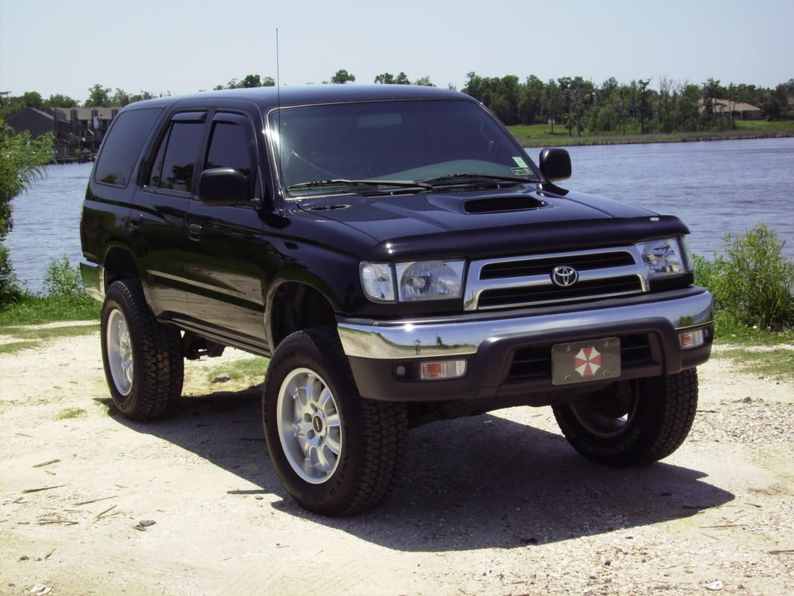

We have similar interest Doc! This was my 1st 4R from a few years ago
