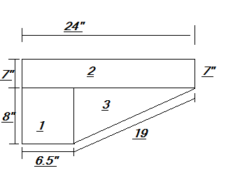

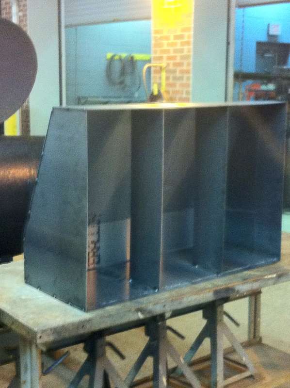

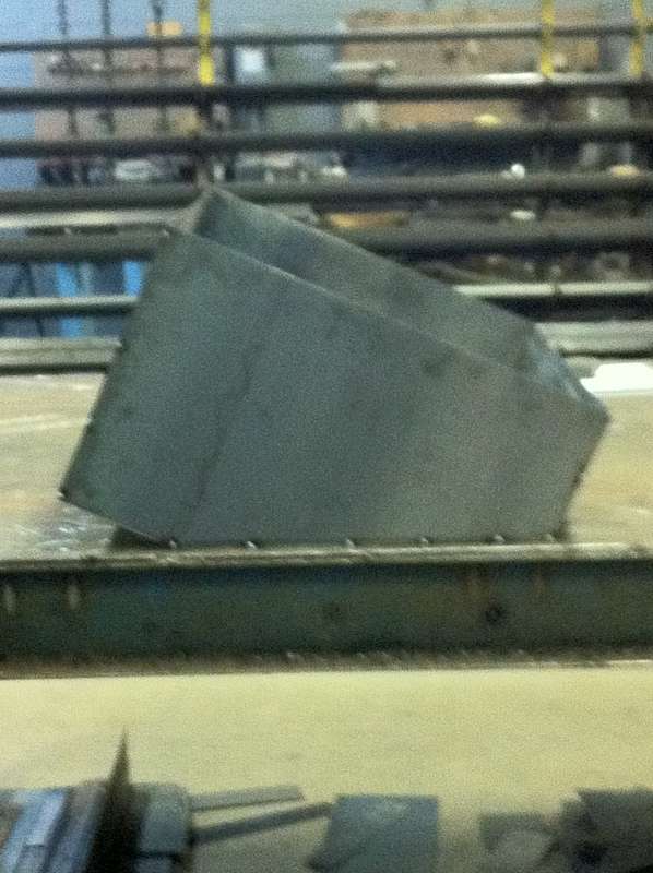

Some one double check my math on this; because, if I'm right, I just built a 45 GALLON TANK!!!!!
Here was my plan:
I wanted to keep as much of the OEM stuff as I could. So, I had to make the tank quite a bit deeper than I wanted to, but I think I did it in a very good way.
The length of the tank, front to back, is 24". The width of the tank, between the frame rails, is 35 7/8".
I'll explain this now....
The easiest way to figure out the volume of this tank was to break it down into basic shapes. Hence the areas 1, 2, and 3.
As I said before, I wanted to put the tank in the stock spare location. Well, If I were to do that, I would loose the ability to run the stock fuel pump. I really didn't want to loose that, and have to dump more momey into this tank. SO, what I did was make the tank drop behind the rear axle, and slope up to the frame rails. I figure the axle and tires will protect the long portion of the tank. The slope goes up to right inbetween the frame rails, so it'll be good and protected. I also plan on running an; at least; 3/16" skid plate over the tank.
So, on to the math.
To find the volume of a square, section 1, the formula is LWH. To find the gallons, you divide the volume by 231. THIS IS FOR INCHES!!!! The formula is different for feet. Therefore, we get the formula:
8"x6.5"x35.875(7/8)=1865.5" cubed. Divide that by 231 and you get 8.0757575...Gal.
To find the volume of a rectangle, section 2, the same formula is applied; LWH/231. Therefore, for section 2, we get:
7"x24"x35.875=6027" cubed, divided by 231=26.090909.....Gal
To find the volume of an extruded triangle, section 3, the formula is 1/2(LWH). Therefore, for section 3, we get:
1/2(8"x17.5"x35.875") =2511.25" cubed, divided by 231=10.871212.. Gal
Those numbers, rounded down just for the heck of it, are:
8+26+4(the only one that was above 0)=38 Gal.
Another way to do this would be to take all the volumes, in inches, add them up, and then divide them all by 231. Such as:
1865.5+6027+2511.25/231=45.03787878...
Now, for the pictures!!!!

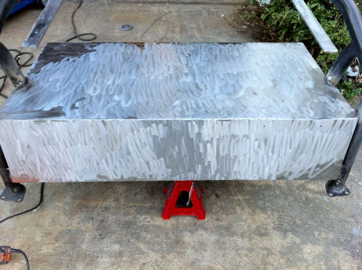

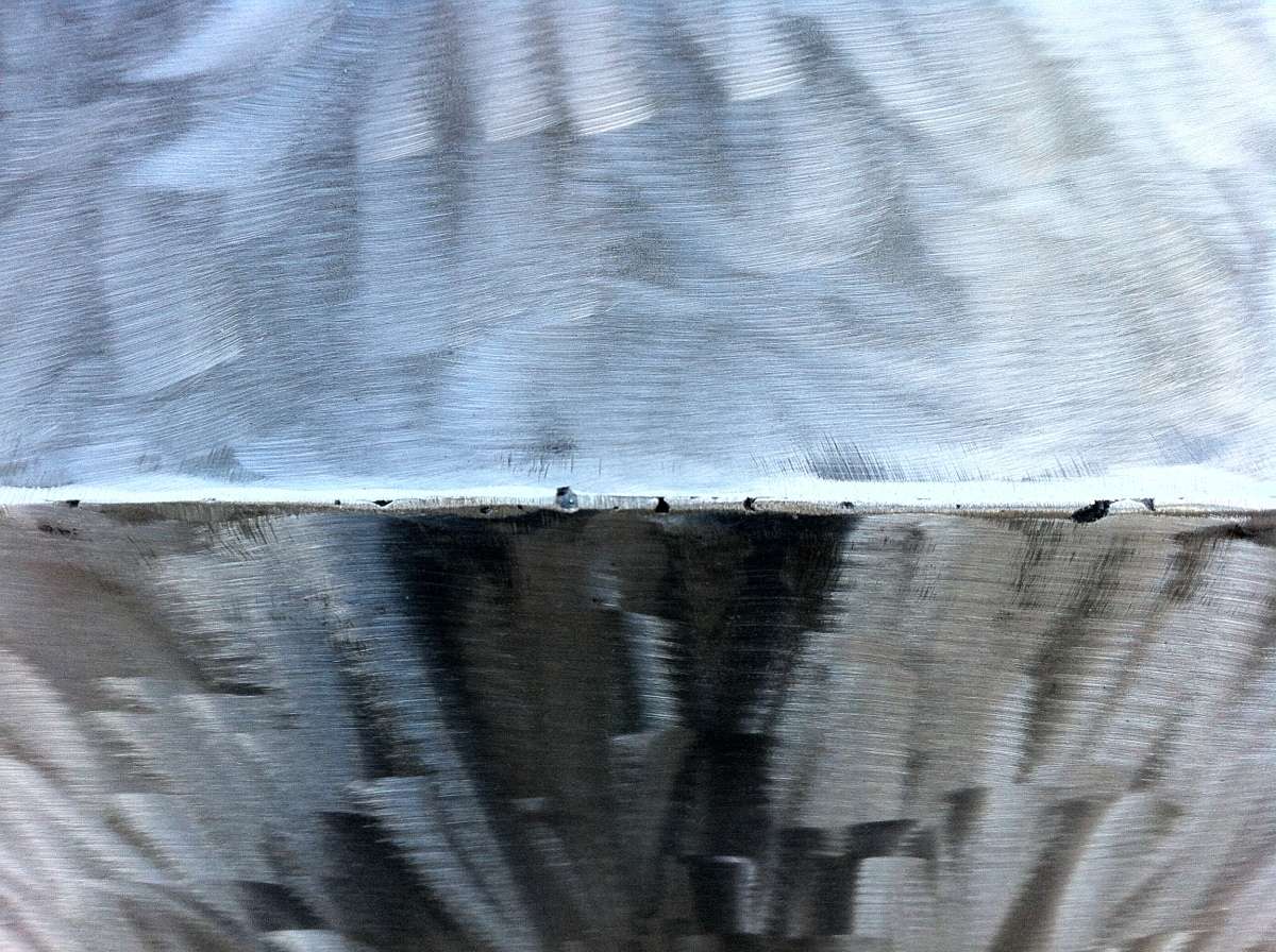

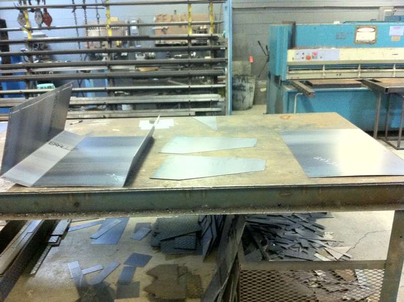

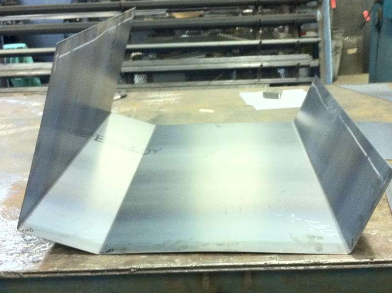

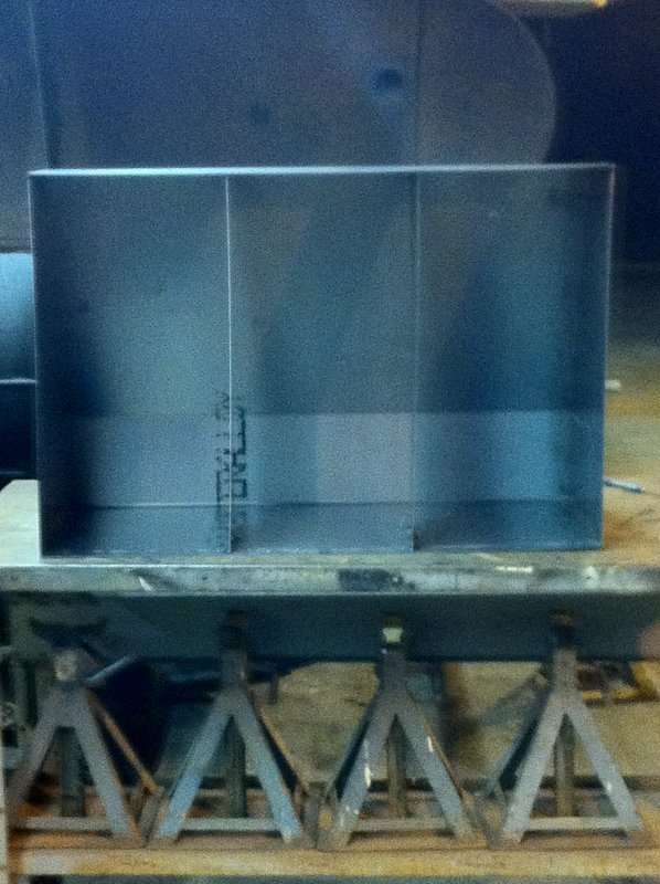

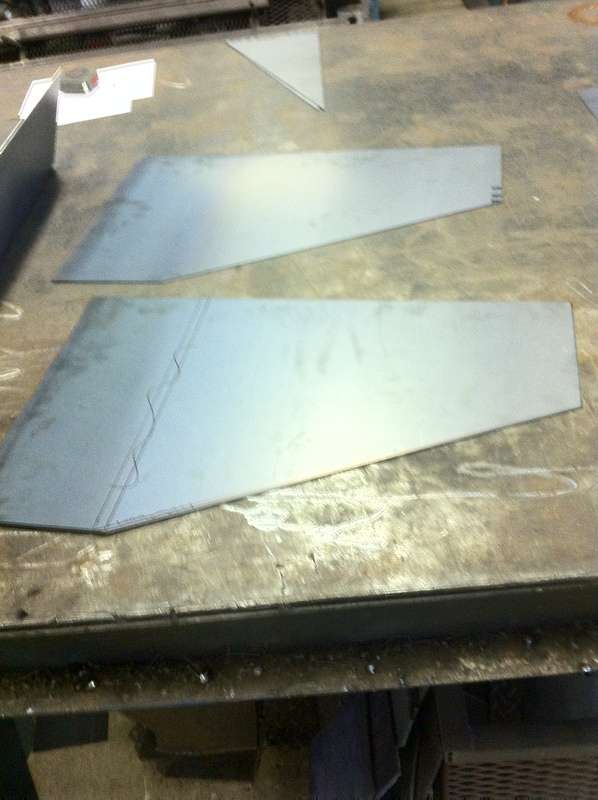

I made this tank out of 16ga steel. I'm in the air of coating it with something, because as long as I keep gas in the tank, which I will, then there shouldn't be any rusting. I still might get some of that stuff to coat it with, the POR-15 or what ever it is....
The front, bottom, and back are all one peice, with bends in the necessary places. The sides are tac-welded for right now, as are the two baffles that are in the center. There will be one more baffle going across the width of the tank, right in the middle, to give it more stability, and then the top will be welded on once it's all cleaned up on the inside.
(Sorry for the ****ty pictures. My iPhone case was nasty at the time.....)
SOOOOOOOOOOOOOOOOOOOOOOOOOOOOOOOOOO?
Whatcha think??
Put a baffle bracing from the bottom to the sides. It should help keep 200# of fuel from bowing it out.
Looks good. I did not check the math but looks well thought out.
Get it welded up and let see it completed.
Cool looking tank.
I believe your formula for the triangular piece is incorrect. If I am seeing it correctly, it is not a prism, but just an extruded triangular section. The formula should be 1/2(LWH). This would result in a total of 45 gallons.
I also quickly modeled the shape in CAD and it calculated 45 gallons too.
Cool looking tank.
Well sh!t!!! THAT'S EVEN BETTER!!!!! Thanks Bandit. That's why I put all of that up there, so someone such as your self could check it for me.

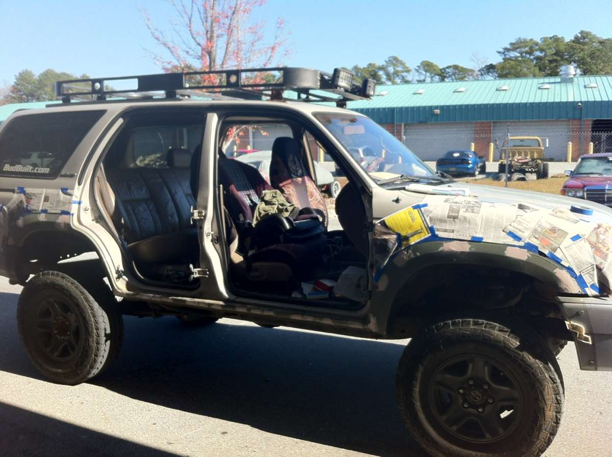

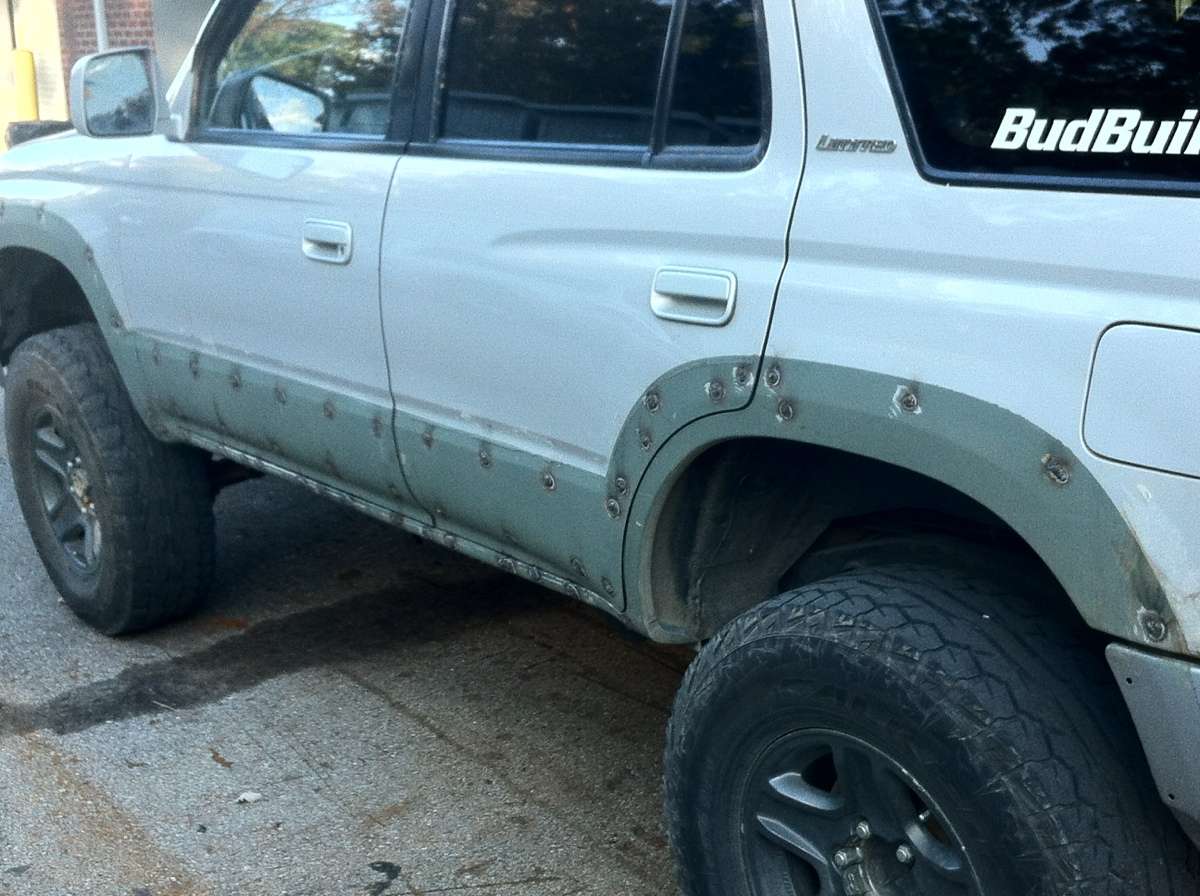

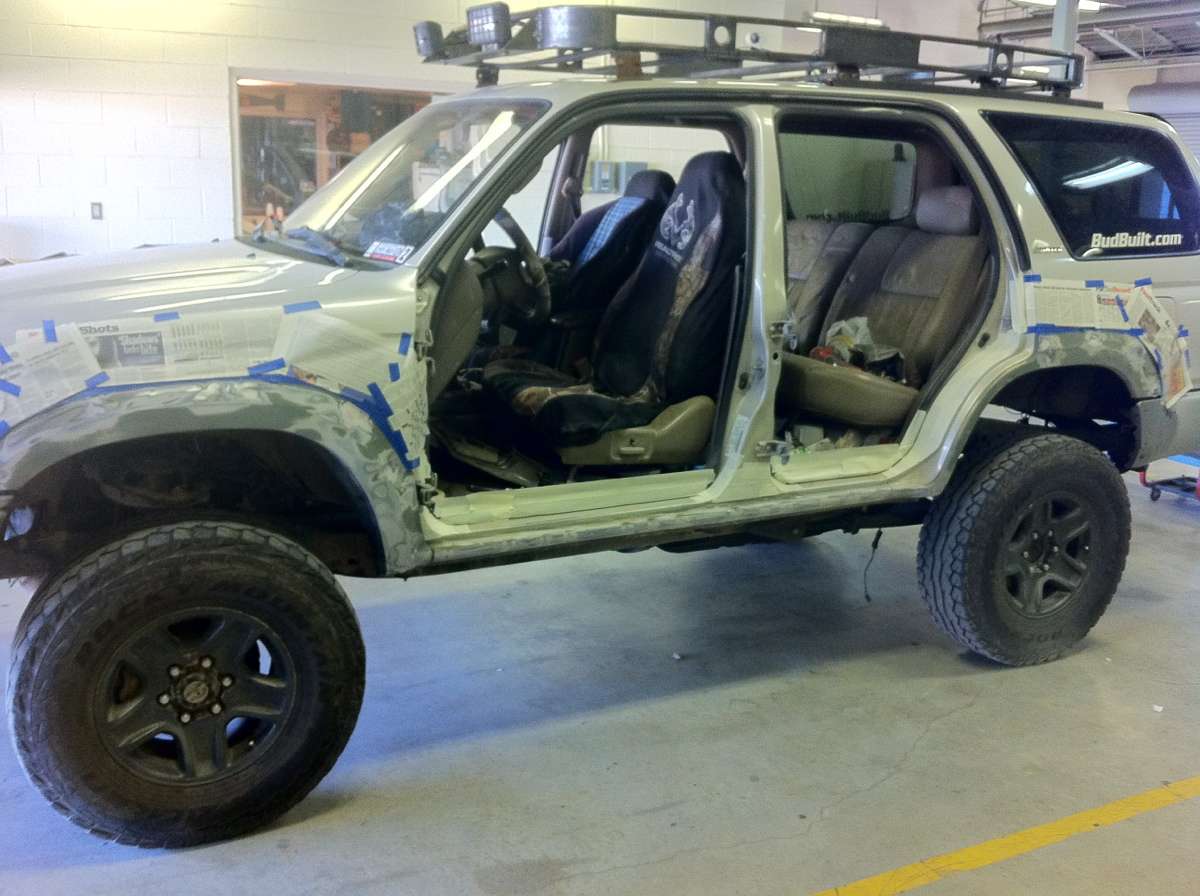

Here's a little update. Been chasing around a damn CEL, but got some of this stuff done along the way.

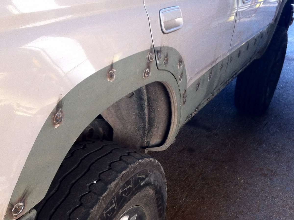

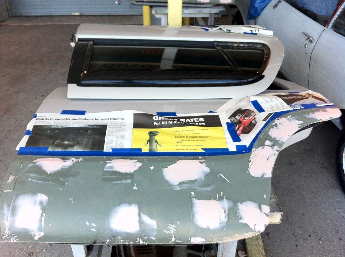

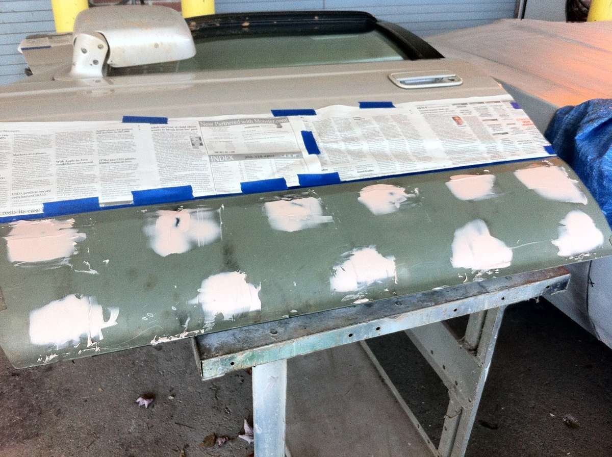

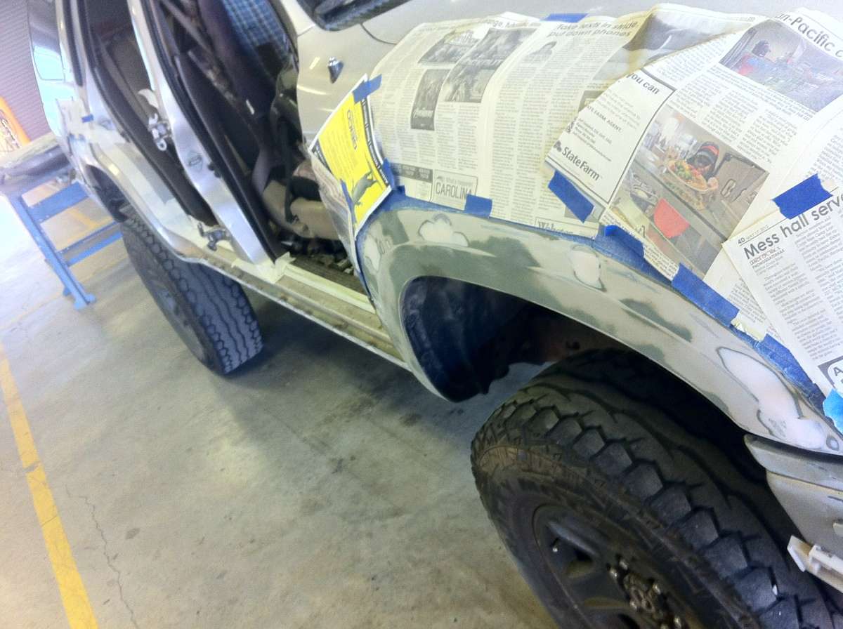

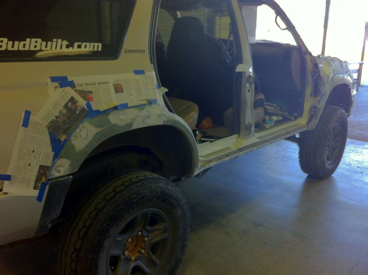

See above post for the before pics. See all the holes? Yeah, I took care of those.

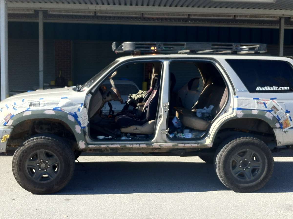

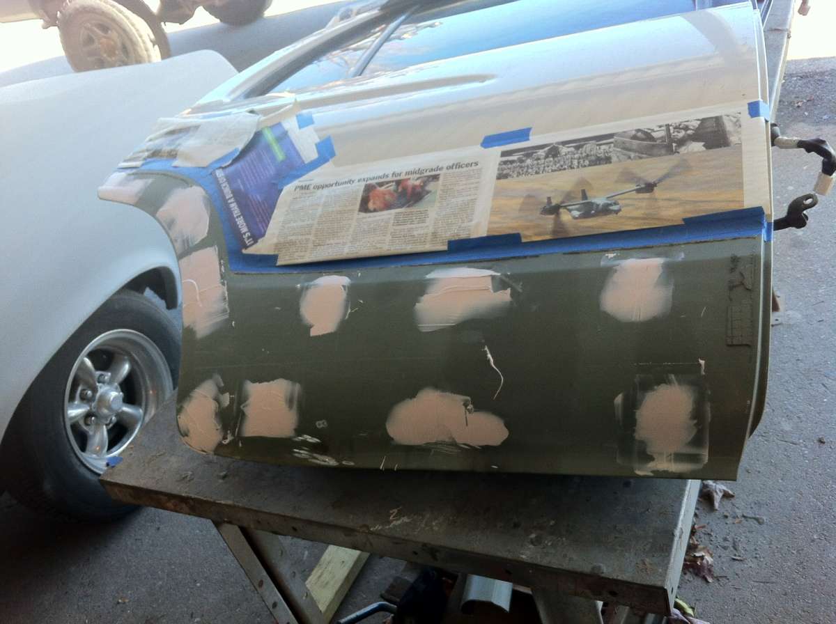

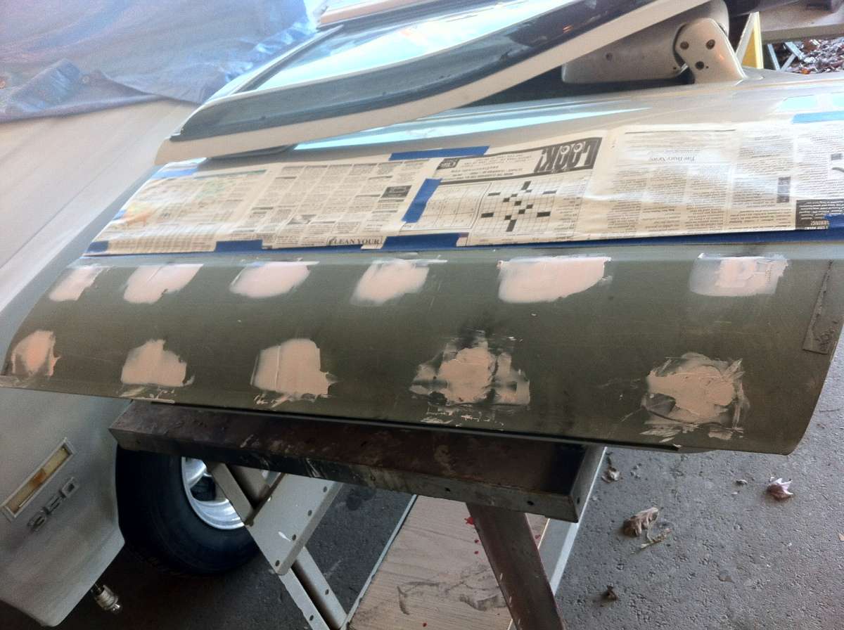

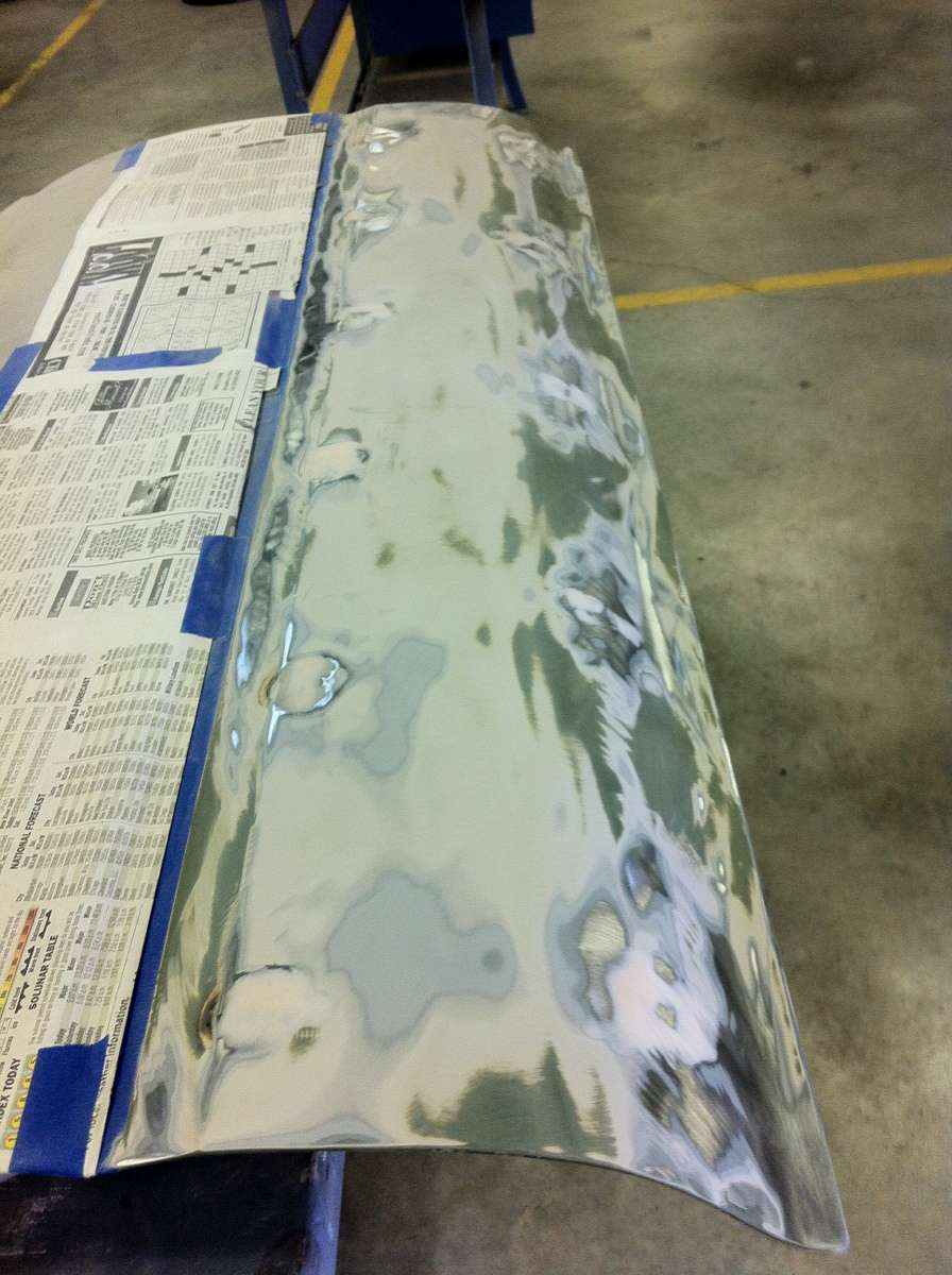

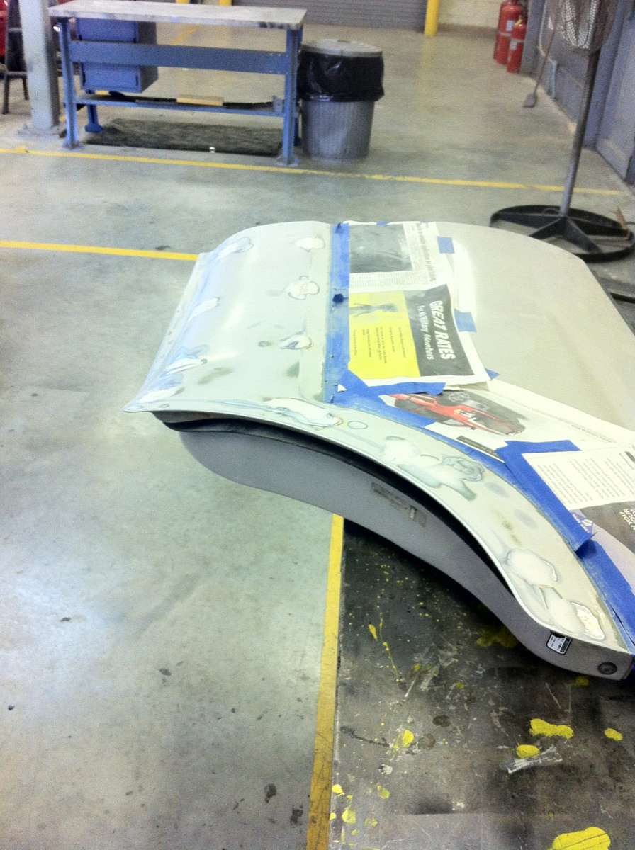

First, I cleaned up the paint a little bit, then welded the holes up.
Then, ground them smooth, taped off the truck, covered it with newspaper, and Bondo'd and sanded it smooth.
After sanding:
Then sprayed with Rubberized under coat:
And, the finished result:
Honestly, it looks really good.
The durability, not so good.
I've noticed that when she sits in the sun, the undercoat gets tacky, and then scratches very easily.
Hell, it scratches easily anyway.
I should've done it right the first time, and used the bed liner, but I got tired of looking at all those holes, and the ugly ass green paint that was all over the side of her.

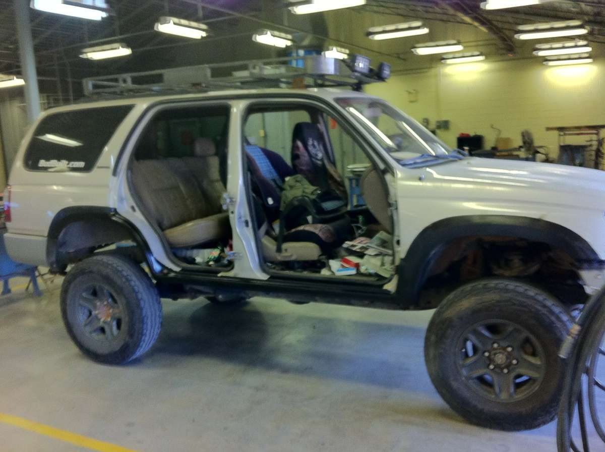

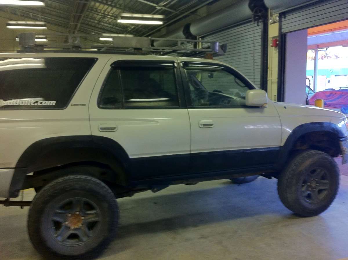

Oh, just for the hell of it, a couple Pics from Daniel when Rudy97 and I went two weeks ago:
I like the look of those half doors. Any reason why you kept the top half of the doors?
Because I'm going to eventually make an insert out of some vinyl or waterproof canvas to cover the area where the doors have been cut out.
That way, when I decide to go wheeling, and there's a drastic change in weather, I can just put those in there, and stay warm/dry.
That, and it keeps the doors stiffer, I don't have to worry about sharp edged when I have my son in there, and it keeps the flow of the body.

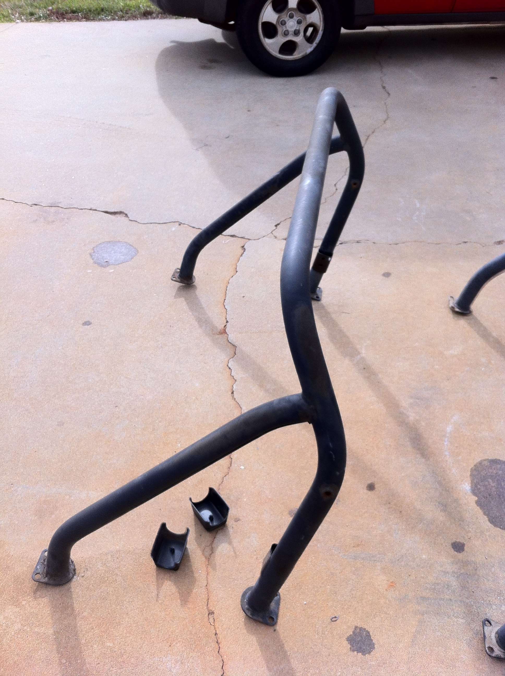

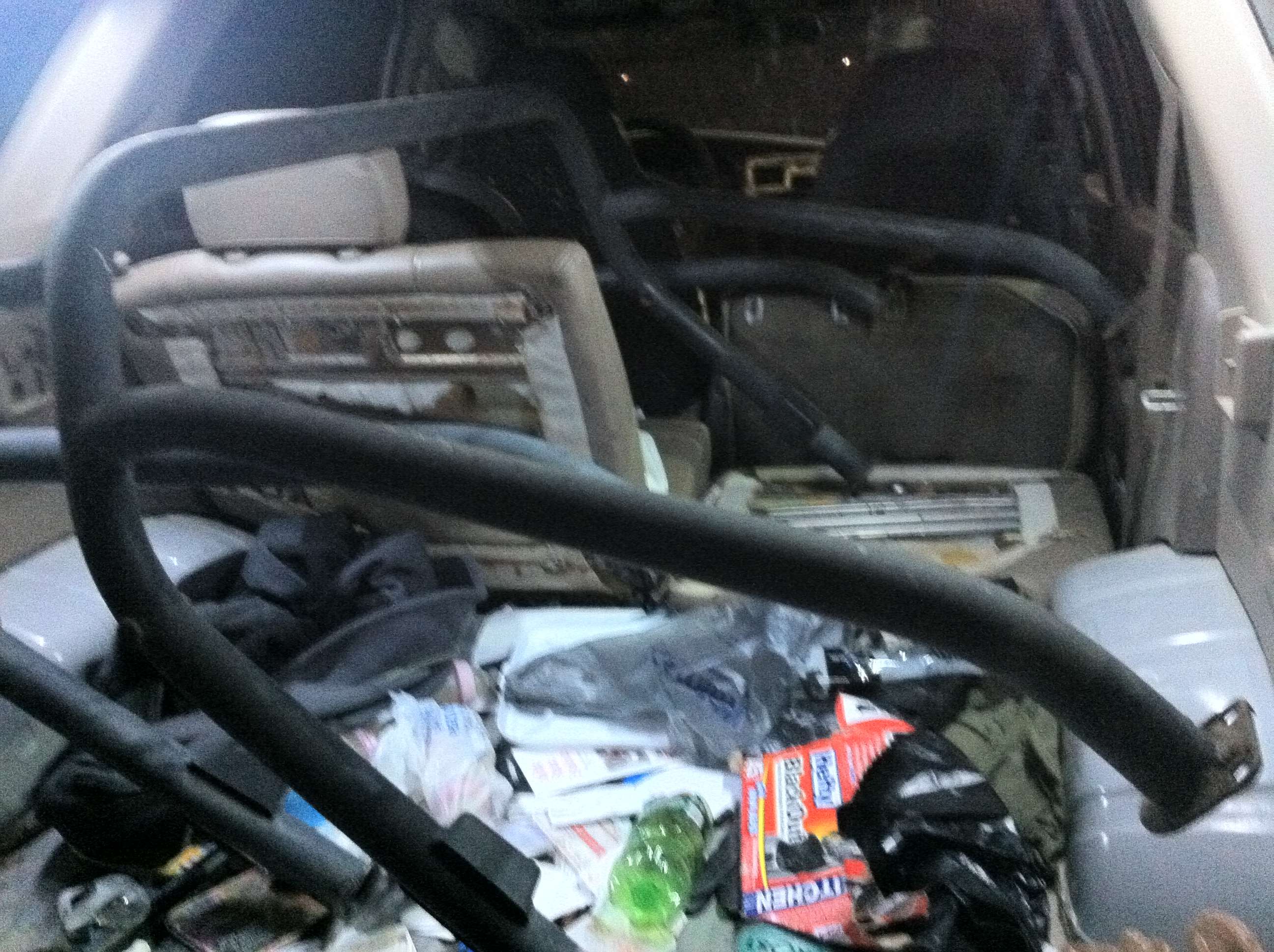

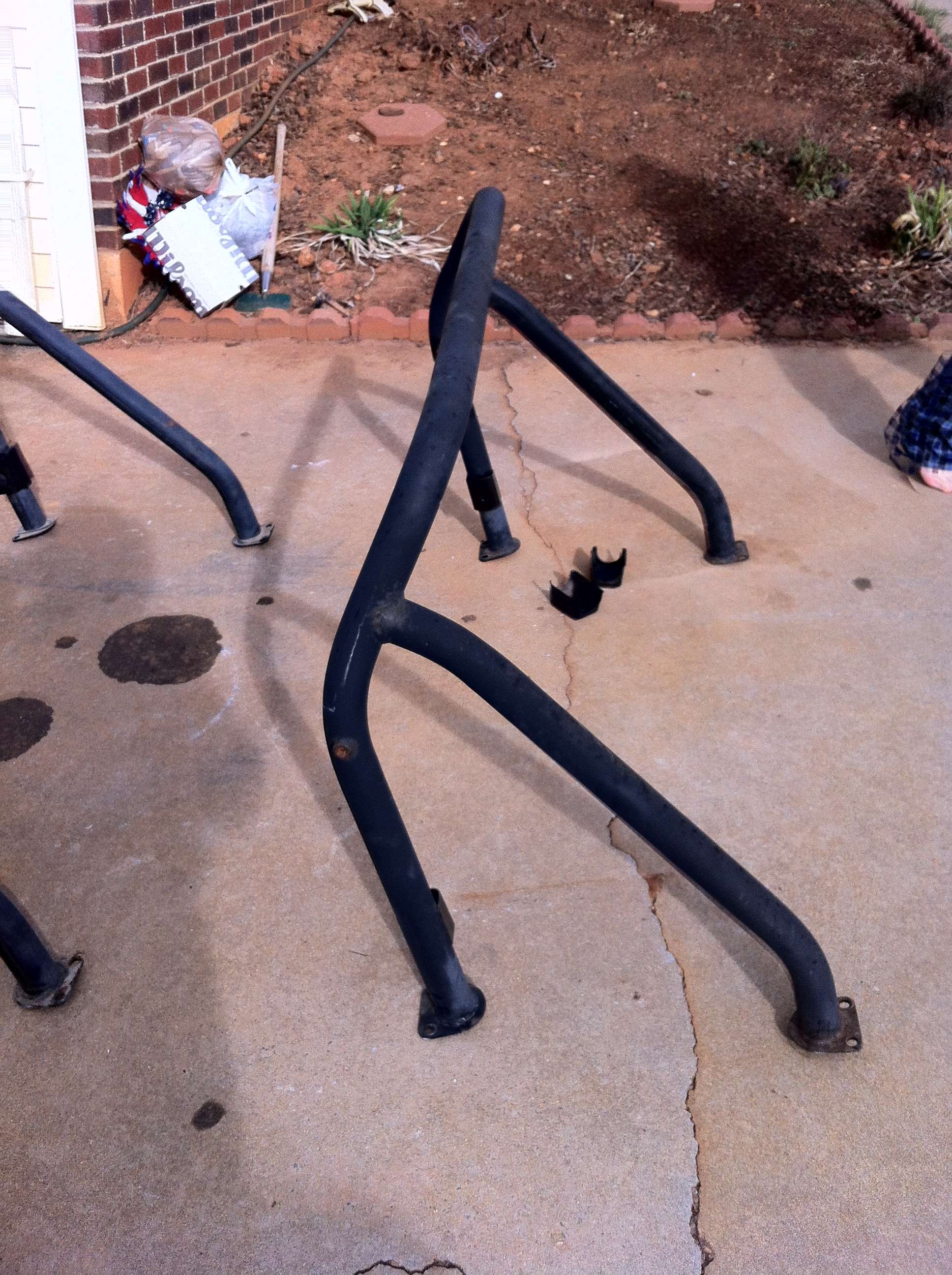

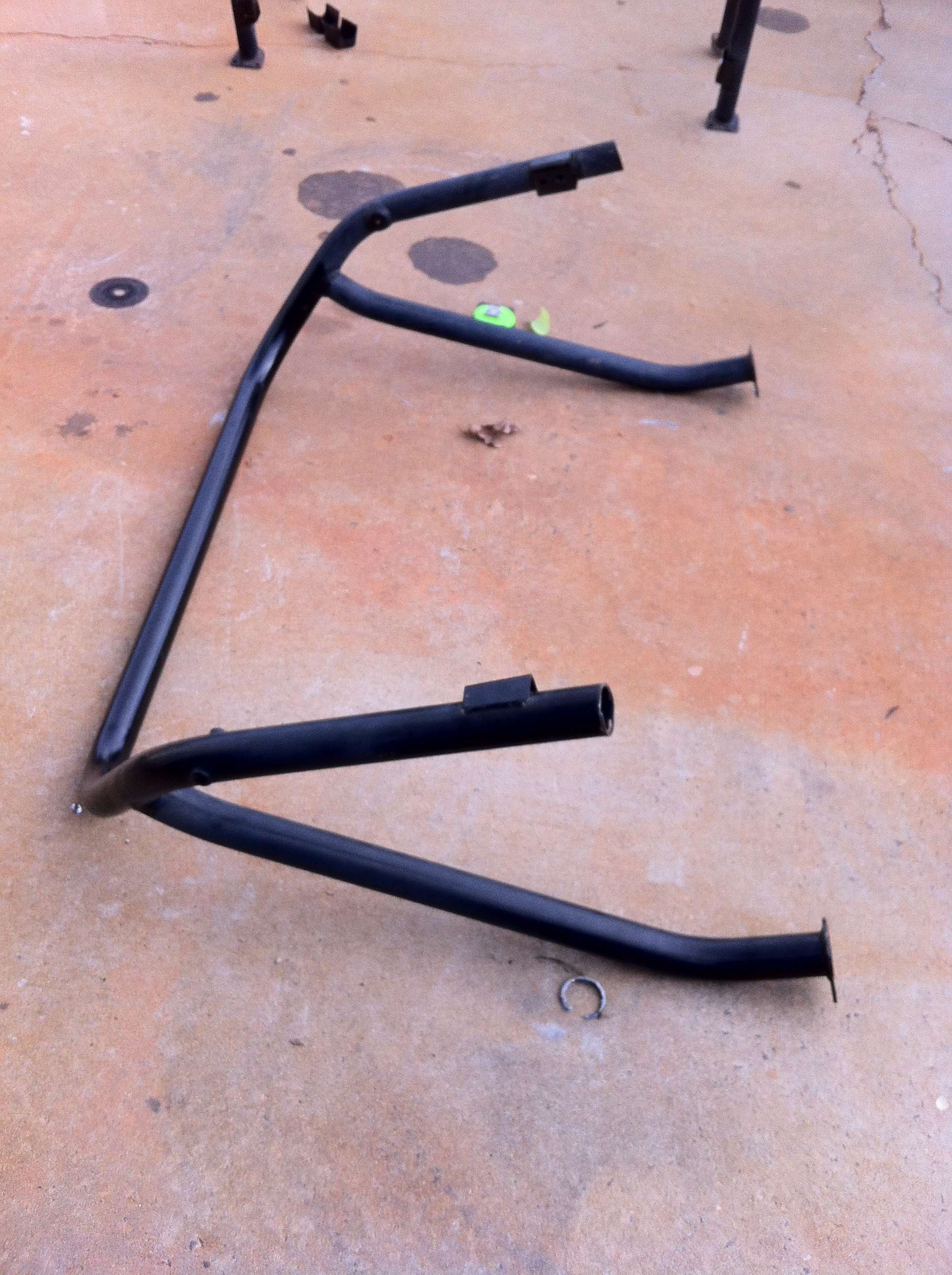

Got myself a present a little early this year: A 1st Gen Roll Bar.
Actually, I got two. One for me, and one for Rudy97.
I didn't take pics doing any of the cutting, so when I help Rudy out with his, I'll be sure to snap some.

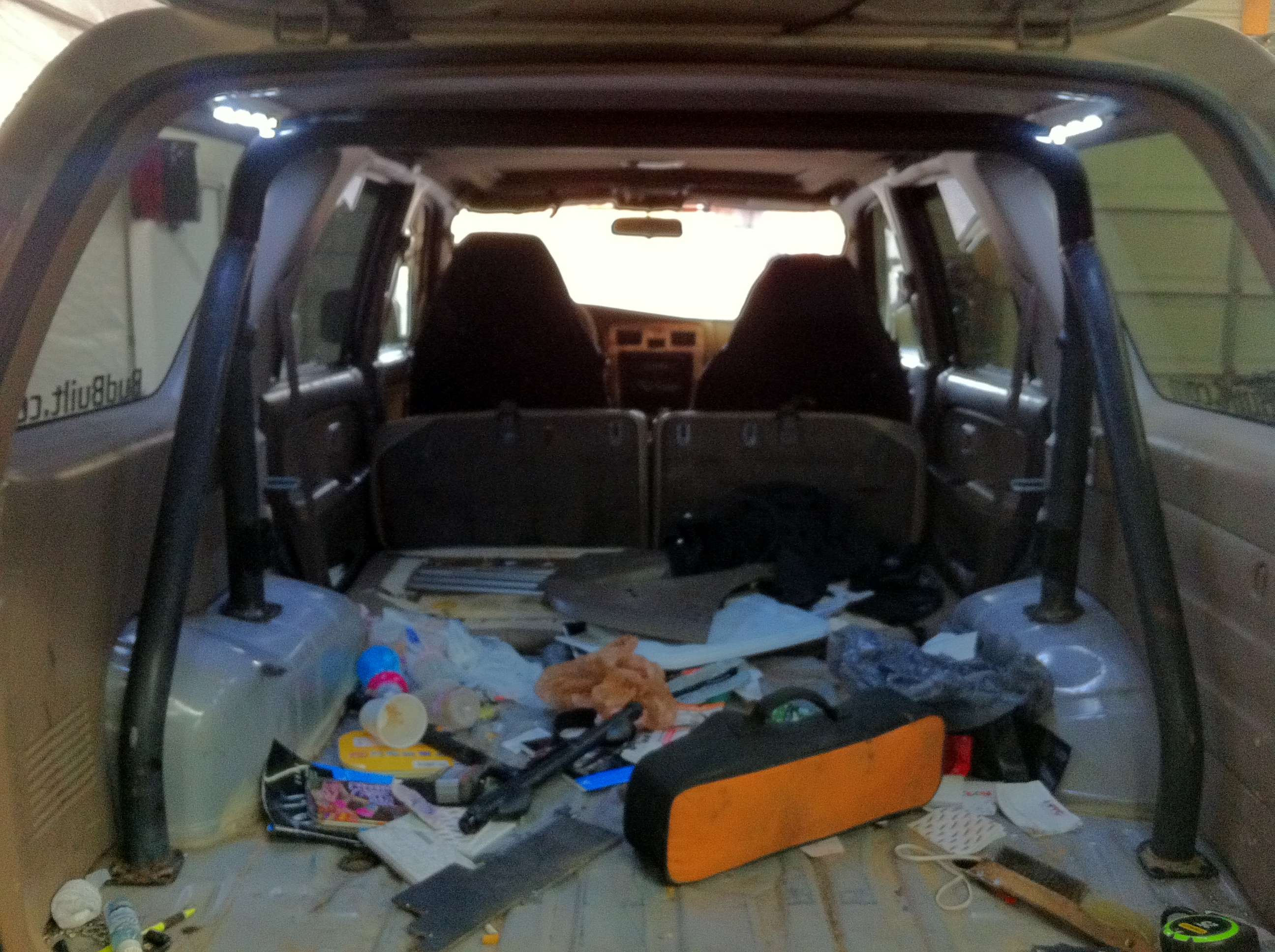

Here's the roll bars, and mine put in.
I know, I know. The back of my truck is a mess. Trust me. I plan on cleaning it while I'm off of work for the next few days.

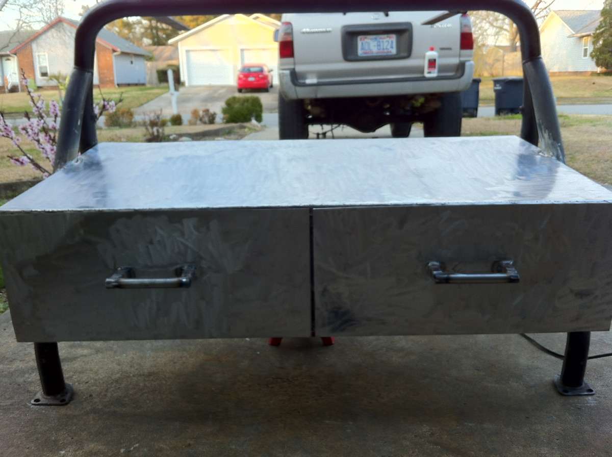

So, a few things I've been doing every now and then.

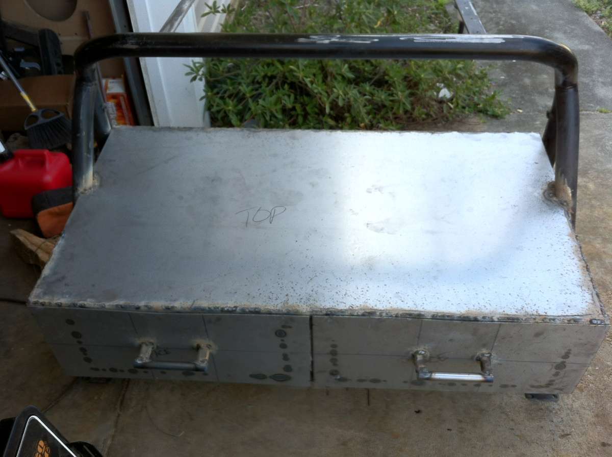

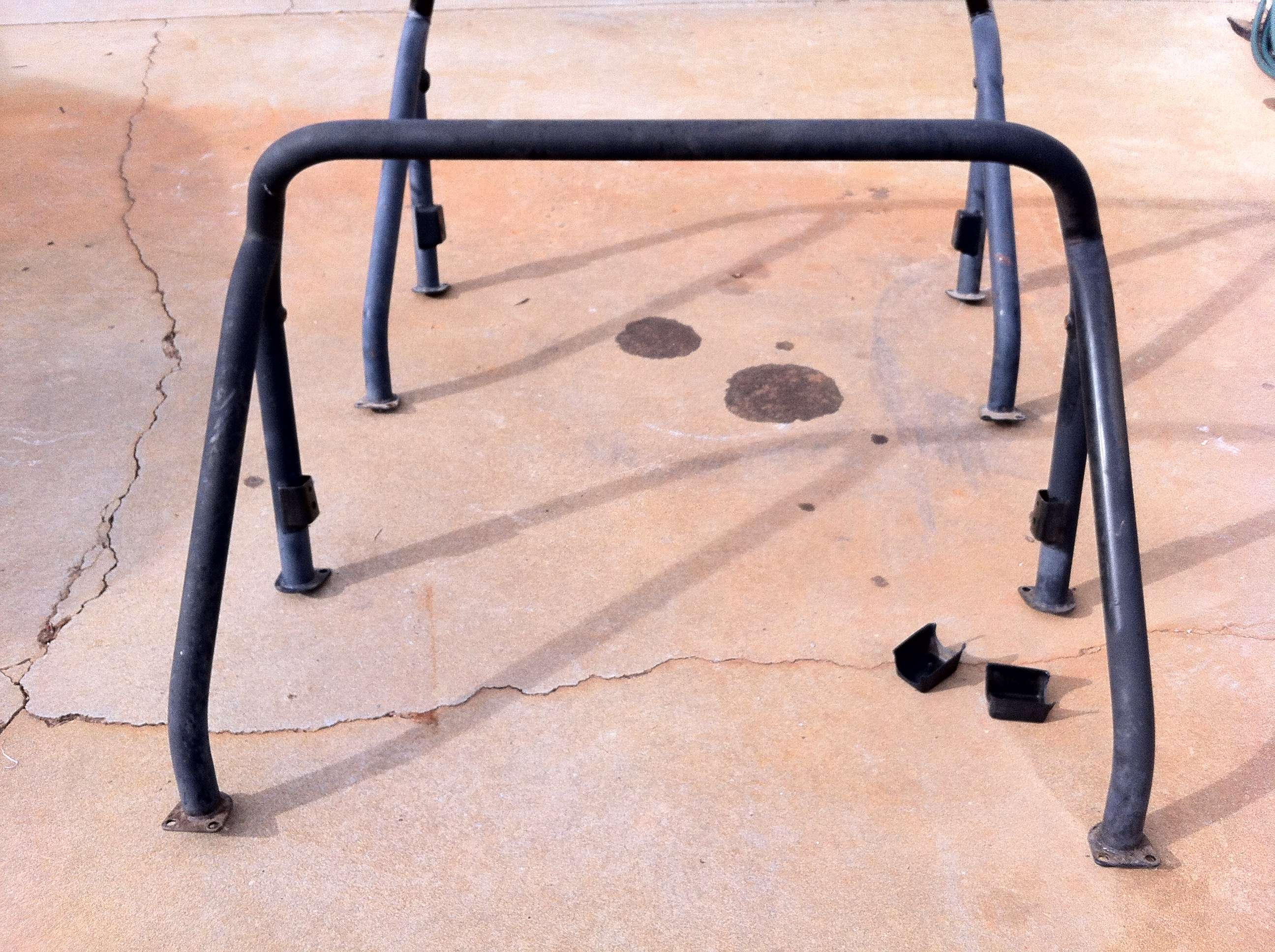

You've seen the Pics of [MENTION=81971]Rudy97[/MENTION]'s Bar. Here's mine.

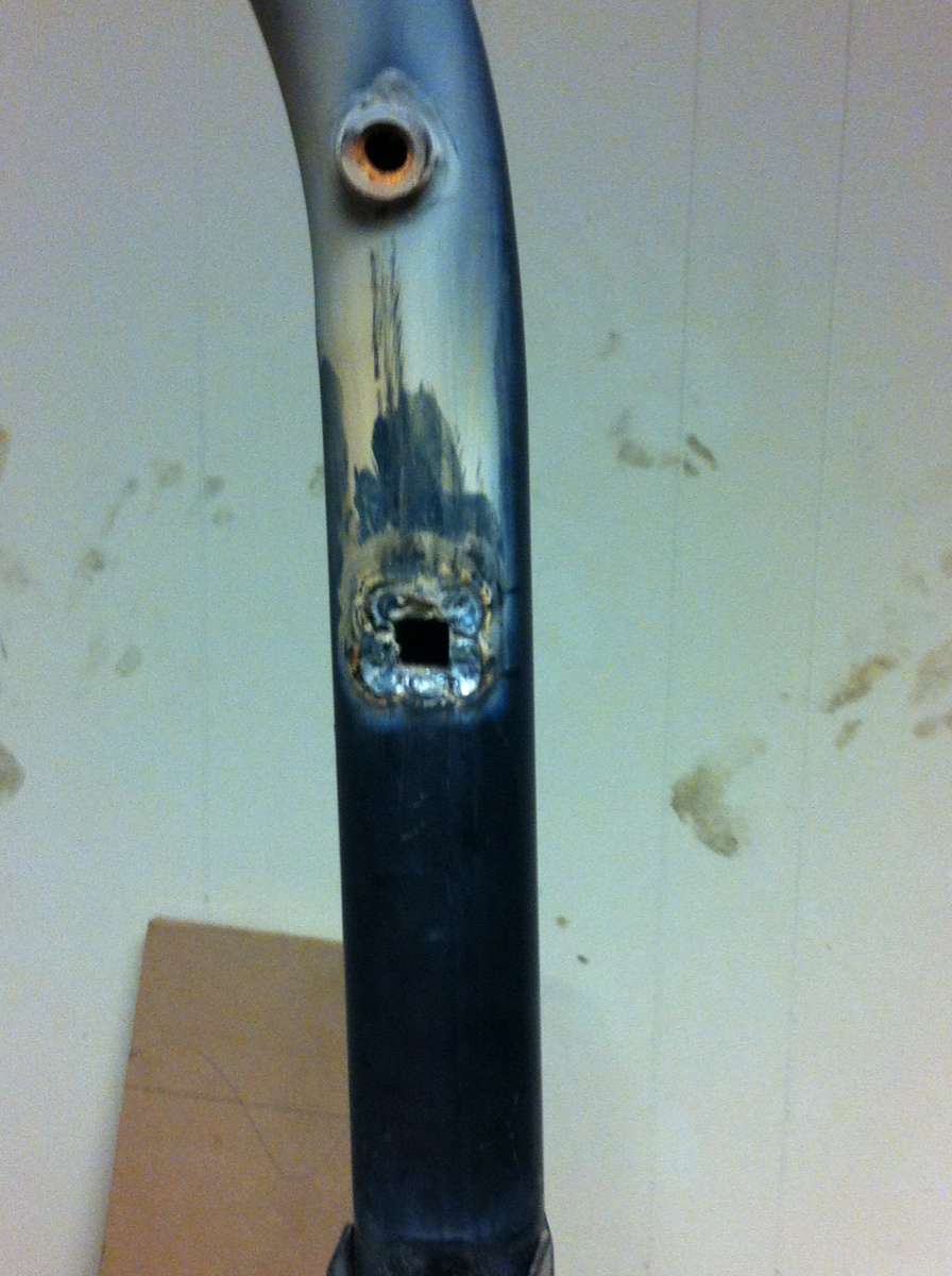

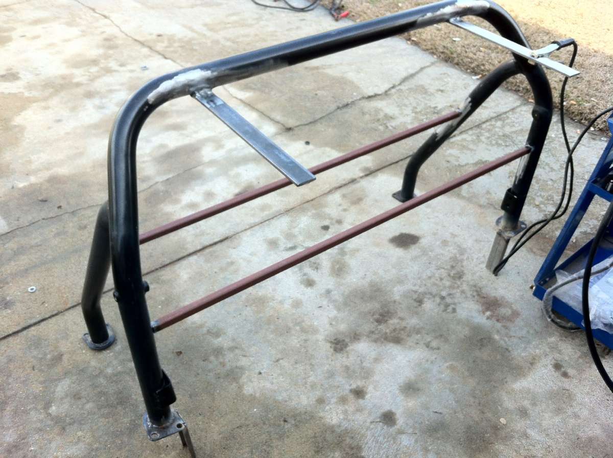

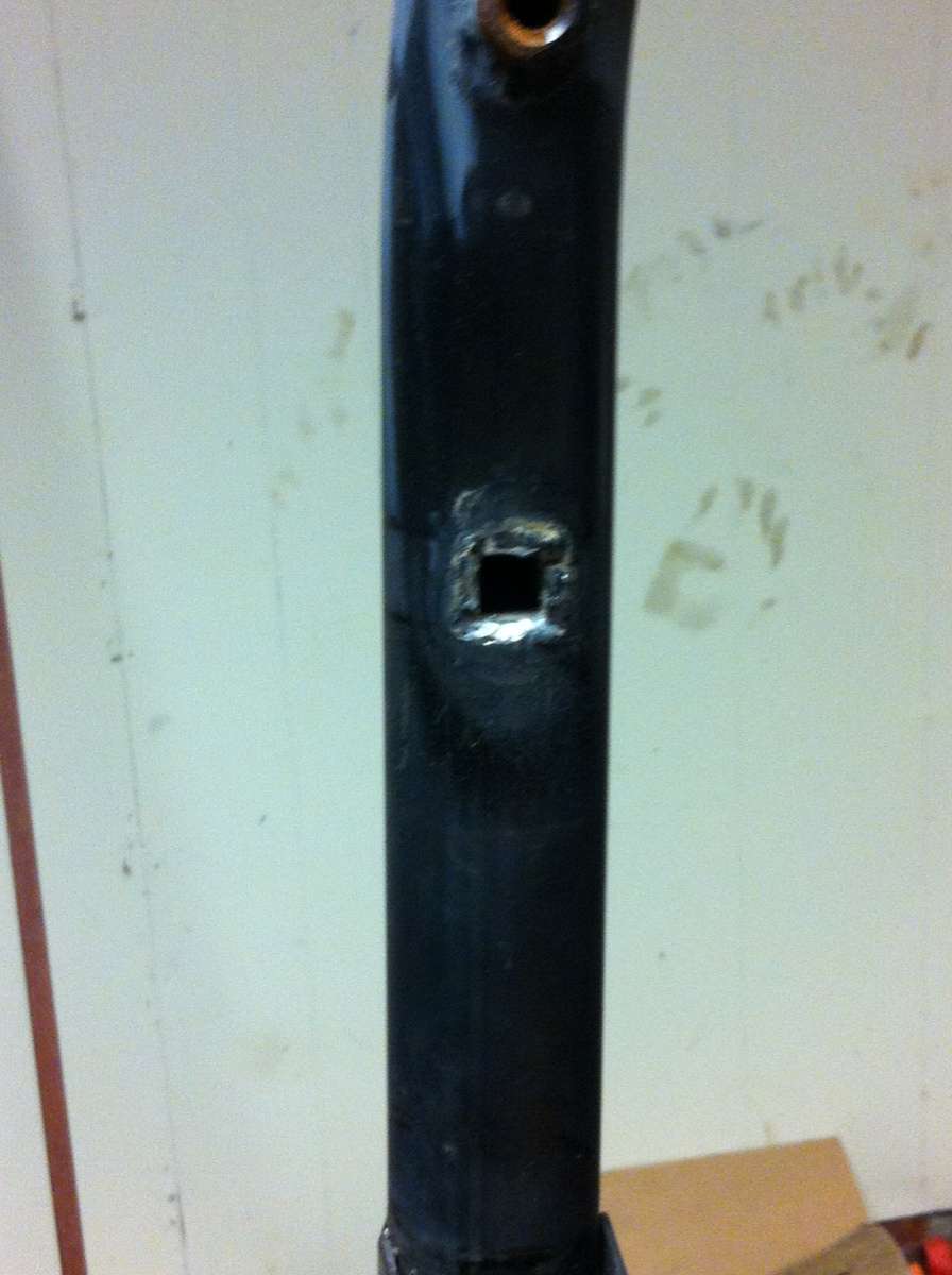

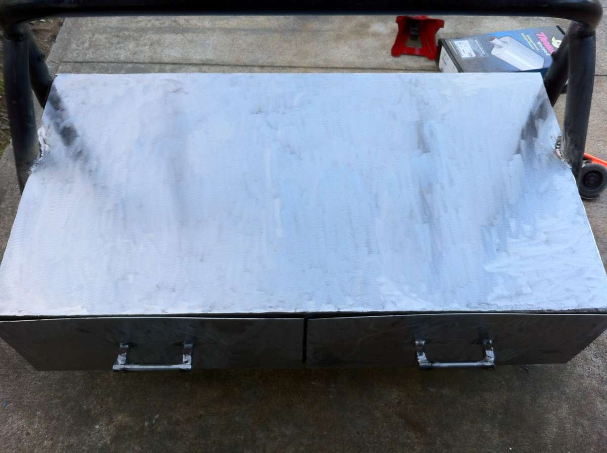

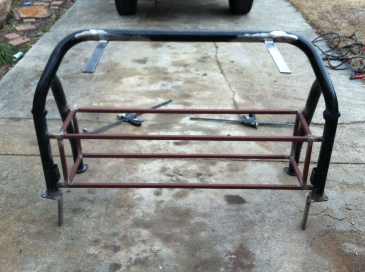

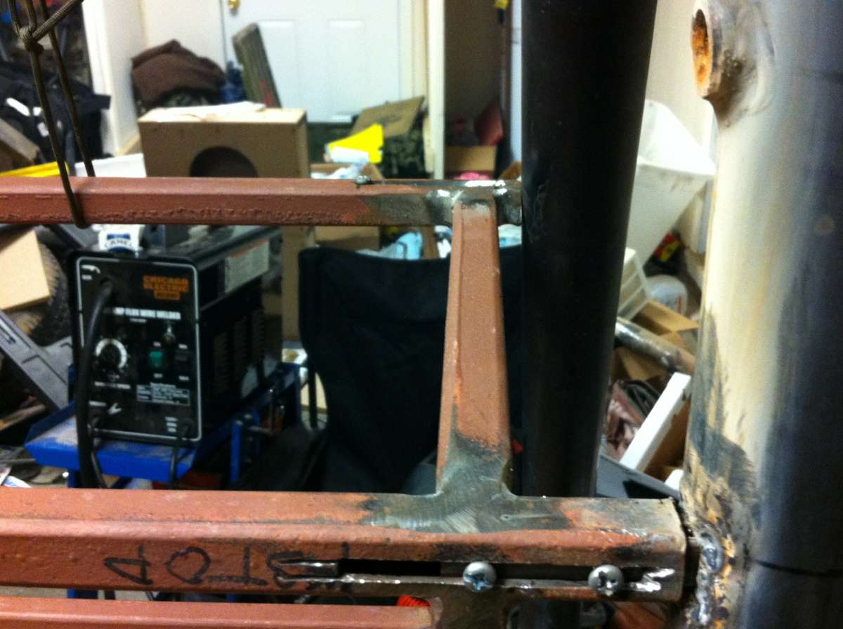

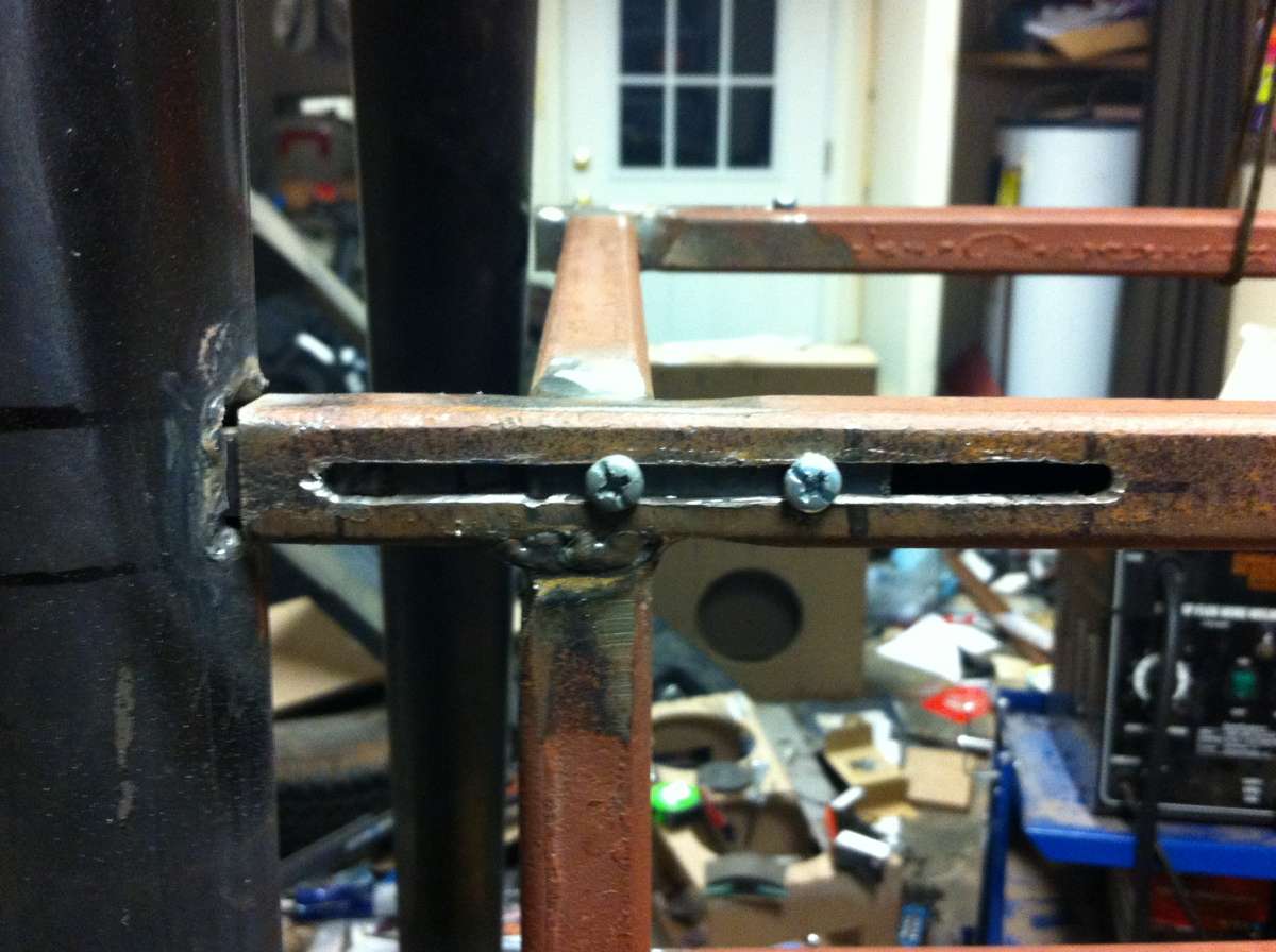

Started off using his bar. Made myself a "bracket" to add my drawers in. Just tacked them to the bar, and cut them off later.
Then, I figured out a way to make the box removeable. More pics and explination of that later.
Next, I took the bar, and cut two holes in it, one on each side. I then welded a sleeve of 3/4" square into the holes I cut. Ended up with this:
AAAAAAAAANNNNNNNNDDDDDD that's as far as I've gotten so far. This process will be repeated 4 more times, twice on each other bar that's touching the roll bar. Should be nice and stiff. Tehehe.

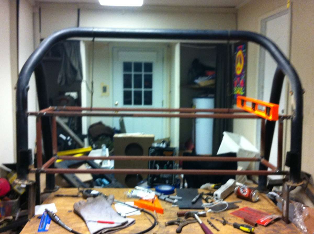

Here she is all mocked up, and some pics of the way I have the system in place to make it removable.
The slide is some 3/4" angle that I got from Home Depot. Put it in, drilled some holes, welded the nuts to the back side of the angle so I wouldn't have to mess with a wrench in there, slid them into the box, and added screws.
As I said before, the process of cutting the roll bar will be repeated four more times: Twice on the back part, and twice on the front bottom part of the box.
Then I will smooth the welds, and work on the supports and drawer system for the box.

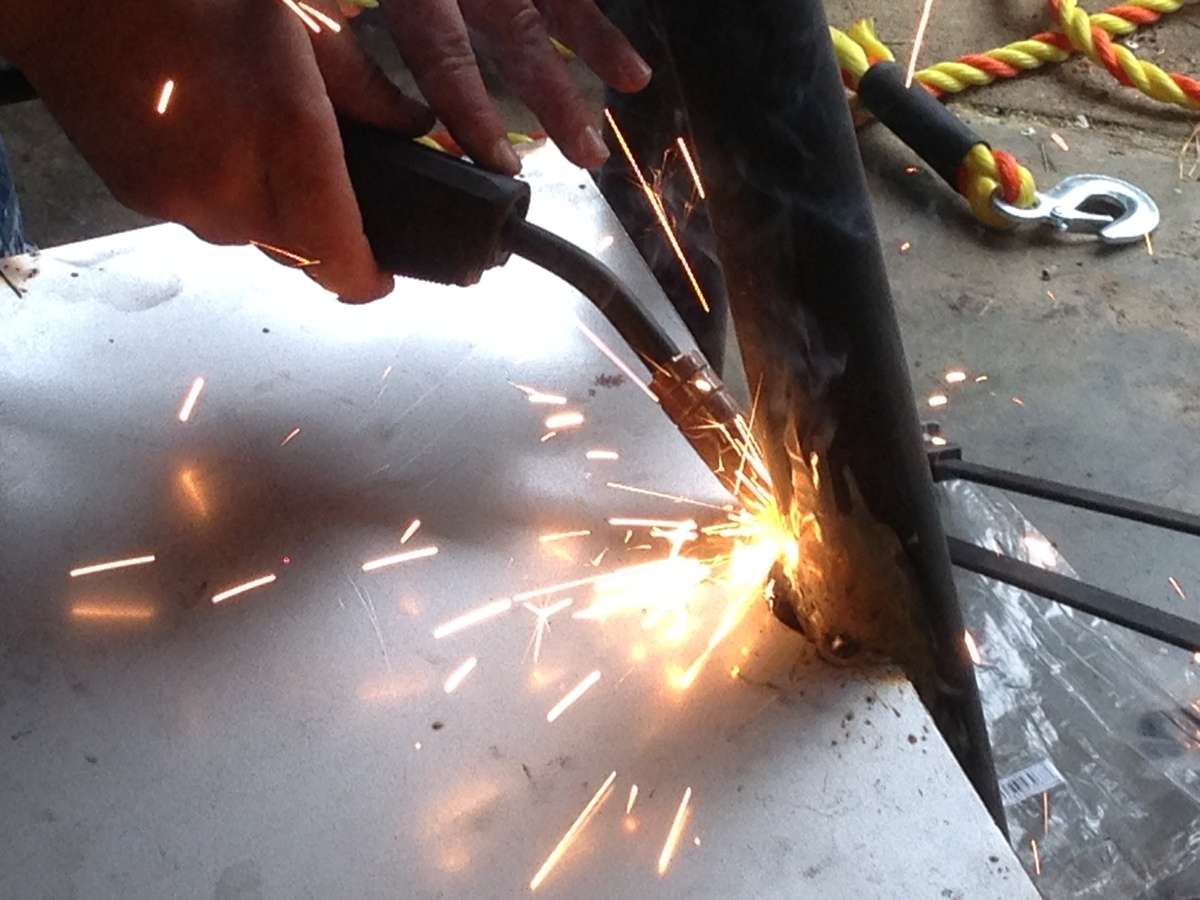

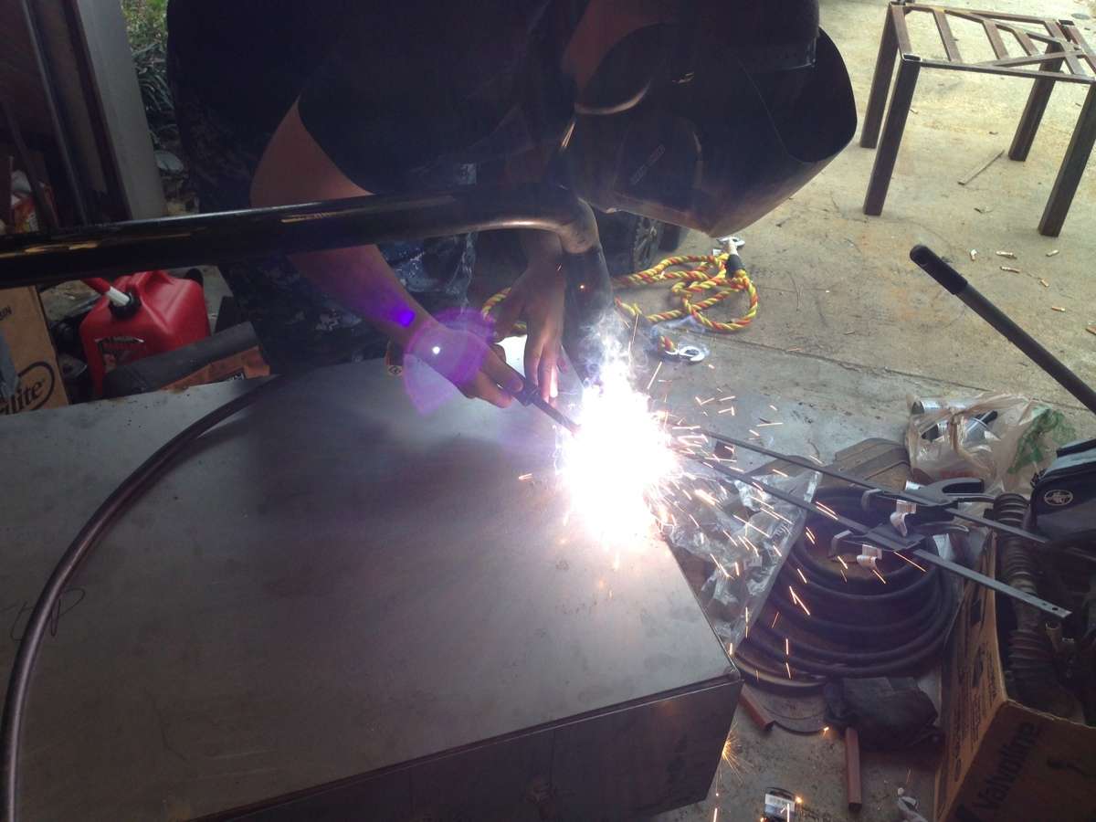

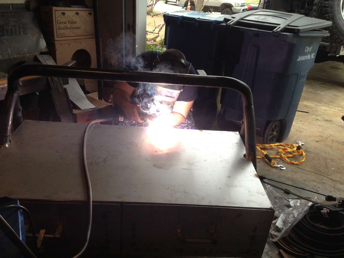

After I got the exhaust welded up, I went over to the roll bar that Josh( [MENTION=81971]Rudy97[/MENTION] ) and I have been working on.
Everything was pretty much put together, just needed some finishing up.
Finished welding around the top.
Then cleaned it all up.
I might go across the edges again with the welder. I was in a bit of a rush, and some of the welds didn't come out as clean as I would have liked them.
Here's a shot of it.
I really need to work on my welding of thin steel. I burn it too much. Just keep the heat on it. I know this isn't good. I need to do more stitch welding instead of trying to run straight beads.
If I had a MillerMatic MVP 211 with Auto-Set, I'd be alot better off.
Oh well, I'll continue to make do with my Harbor Freight Flux Welder.
Sunday I'm going to work on my box and bar, and keep working on this one. I don't need to do a whole lot to mine, but I'm going to get them both painted Sunday as well. We'll see how that goes.....
Whatcha think guys?
