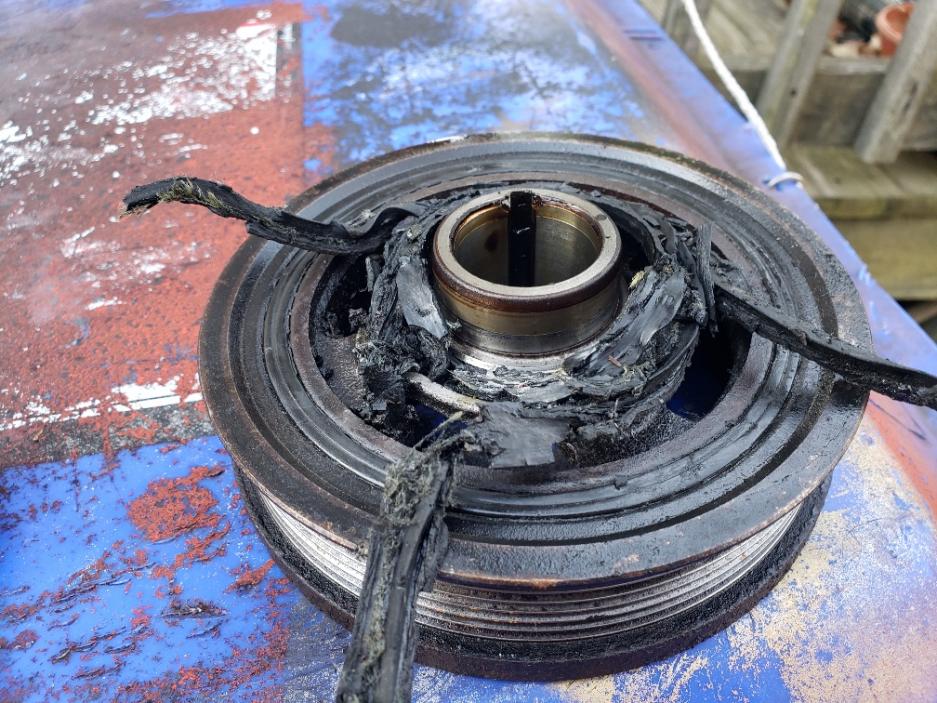

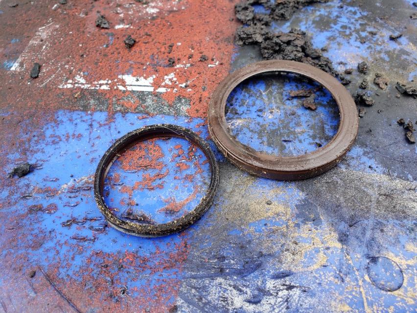

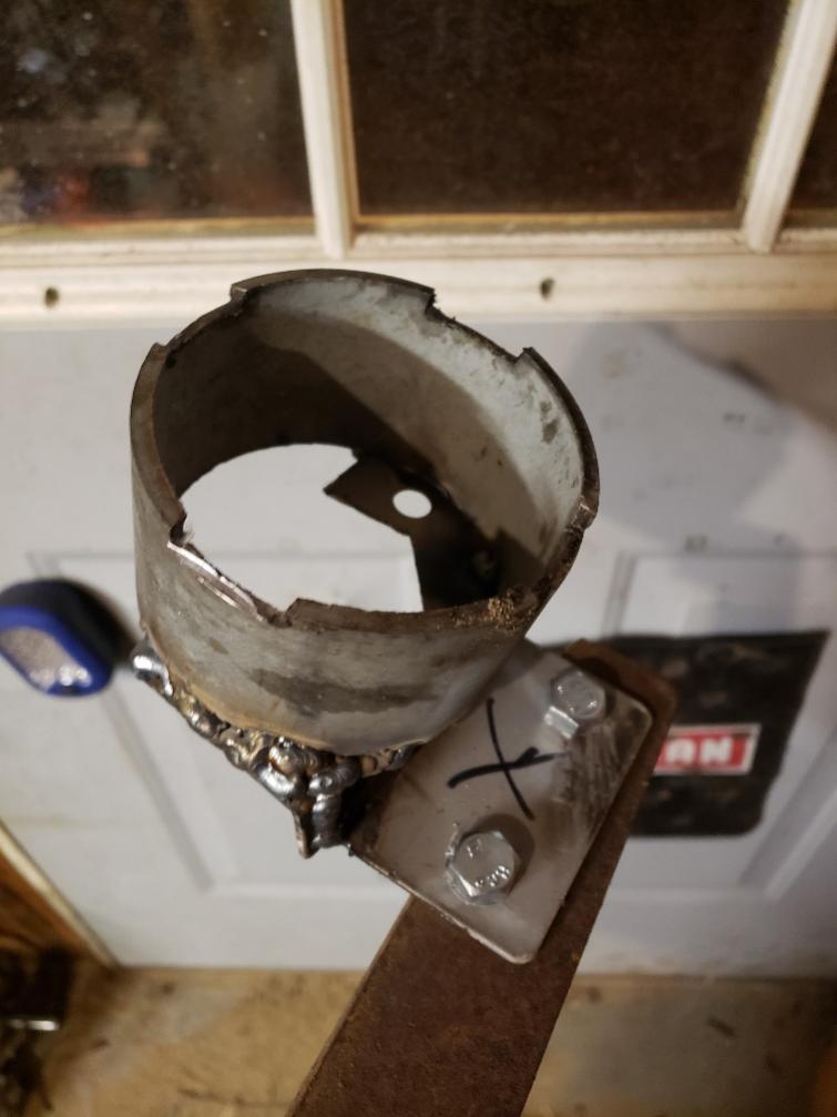

I'm here confessing that I ignored my belt too long even after my inspection guy said it was worn out. I forgot about it and then it shredded on me. It then proceeded to go behind the crank pulley and wreck my crank seal. Below pics show the pulley with the belt wrapped around it, the junk seal and the tool I made to hold the pulley. All in all not a terrible job. The pulley holder can be bought pretty cheaply online but that was close to a week to get it, I built this one in an hour or so.

Dang! Glad you were able to fix it.

Do YOU have a harbor freight nearby? They are usually great for specific job tools like that.

Yeah, I was dreading fixing it but actually easier than I thought it would be.
Ouch on the tensioner swap, I have a bit of squeak now so will need to figure that out. The pulleys are the same age as the belt, maybe 3 years but it was a cheapo belt as I didn't realize my alternator bearing was seizing up and breaking belts in the long direction.
Yes to Harbor Freight but I've never seen anything so specific for a pulley tool there. This is one brand.
Amazon.com: Sunluway Harmonic Damper Pulley Holding Tool Crankshaft Crank Holder Removal Wrench Tool Fit for Toyota Lexus : Automotive
