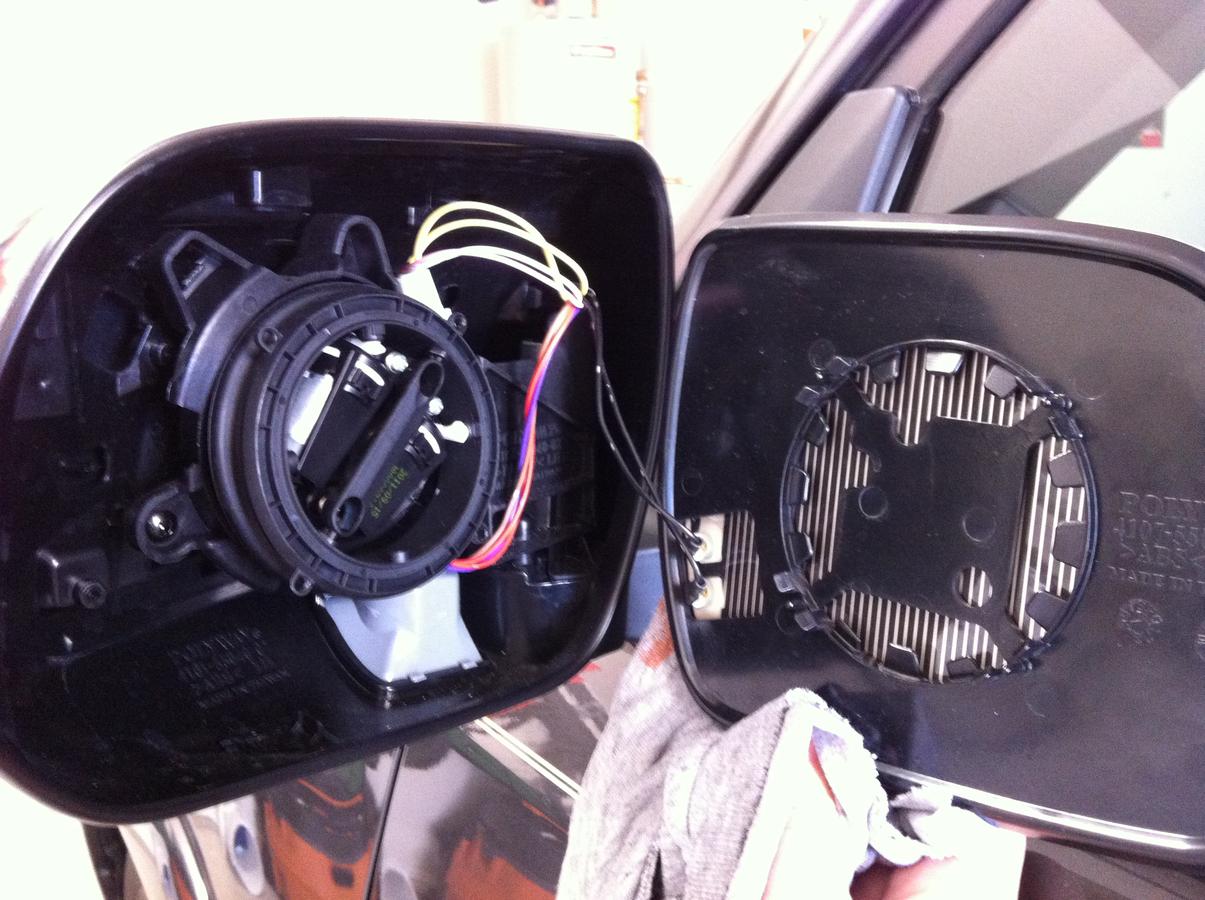

Okay so...I popped the mirror off of the driver's side, and it looks different than the OEM one that's on the passenger's side. I'm guessing that's why? On the passenger's side, when I try to force-move the mirror, it has a clicking sound. On the driver's side, it just moves smoothly. Ugh. Maybe I can get SK to get me the OEM one instead of this POS one that they put in.

Sounds like they gave you an "aftermarket" side-view mirror. From my past experience with those, the mirror piece will vibrate while driving.
After fixing many a loose mirror it really requires a good solid wack with the end of fist in the center of the glass to seat it properly.

The mirror is not seated properly.
Check out this link on how to seat the mirror- step #12 in particular.
