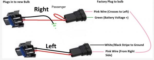

He literally *added* that one black wire. He repurposed the other wire to jumper it as shown in the diagram.
It shows a red loop wire yet the existing red wire from the harness is still there or is the red wire from the amazon harness actually pulled and used as the red loop wire and just not removed from the diagram?
Sorry if I'm making it more confusing. I would love to get this working.

I am very interested in the modded harness to allow full 12v but I am still confused looking at the diagram provided in this thread.
That diagram is the finished harness.
That little red oval loop might make more sense if it was colored black to match the color coming out of the Right plug. The idea would be to cut it about 4 inches from the plug, loop it back and solder it to the red wire in that same plug.
The “added” black wire is long and used to extend a ground from the left harness plug to the right harness plug.
The diagram colors may not match what you get from the harness vendor. Refer to the headlight wiring diagram PDF and the [MENTION=222785]q451990[/MENTION] harness diagram and use your voltmeter to make sure of the plug polarities and that the voltages are on the correct pins. Be sure of your work.
Now I get it!

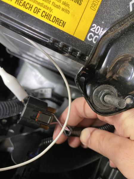

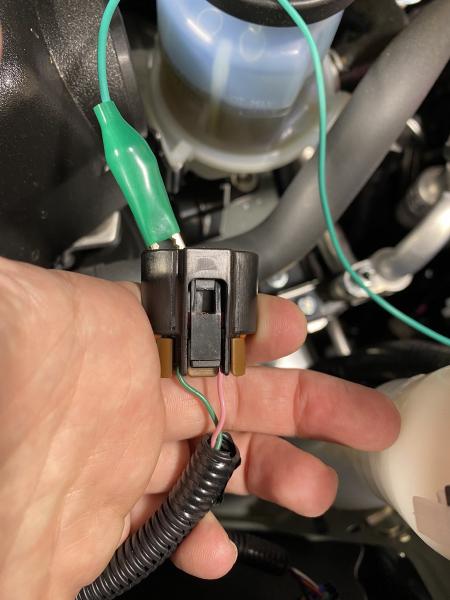

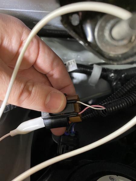

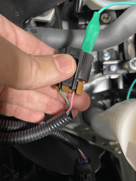

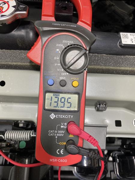

Completed this with dynamic LEDS ( 9005 HP48 LED Bulbs ) and harness with slight change to harness. First - verify your wiring. Measure dc volts from passenger side green wire to drivers side white w/ black wire. Engine will be running, I measured 13.9 volts.

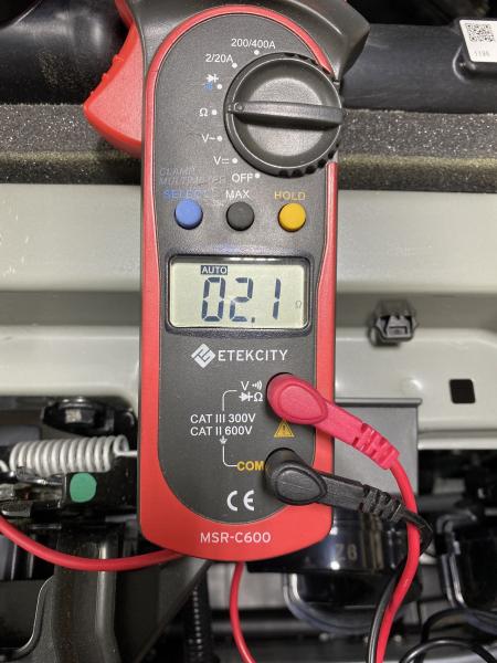

Next , verify the pink wire does indeed run from the passenger side to drivers side. 2 ohms
Get a set of harness extenders. I used the same as mentioned above… the red and black were reversed on mine and my OCD made me fix it, red = +dc.

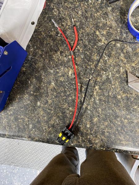

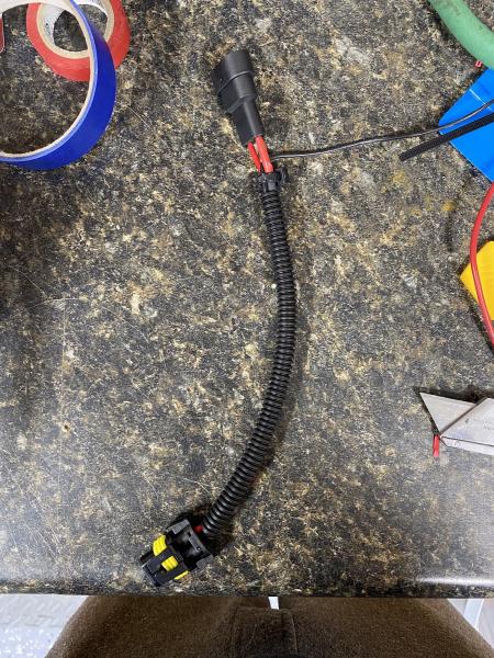

Here is the harness disassemble and jumped over to the drivers side.
Then reassembled for install.

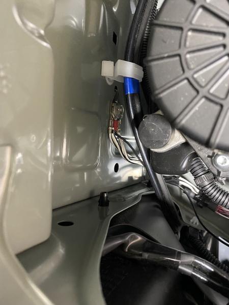

The only change I made is instead of running a black common wire back to the drivers side light, I just caught chassis ground on the fender. This means you only modify the extension on the passenger side. You actually don’t need an extender on the drivers side if you use this method.
Black wire with red barrel below.
Thank you for the photo's and taking the time to document this! I like the cleaner ground and not having to mess with the driver side. This mod makes the truck look the way it should have from the factory. I assume your setup is now flicker free?
No flicker at all as I think they went away with Pulse width modulation for DRL when they changed to the LED setup. This mod gives you full 12.8VDC (est) at the fixtures so you get full spec voltage for the LED bulb. Also just as important, you don't want to blind people with your DRL so you need to respect the lumen outputs as well. The LEDs from Dynamic are really great for this application.
