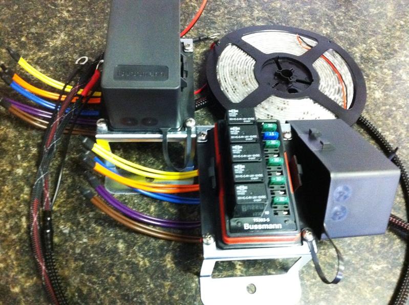

It's the aux fuse box at the bottom of the page. It will have 5 complete circuits with 30 amp relays. So, just run power from relay to whatever and the connect switch. Genius, really. Never have to tap off the battery again. Well, at least for things that are rated 30 amps or less.
Thanks for the tip, I just picked up 2 of them as well. I wasn't happy with the blue sea fuse box and then having random exposed relays. This looks like a great setup.

Erik @ Wired Wagon came through FAST!!! And so did the LED strip.
Looks like Eric does good work. I contemplated sourcing all the parts for that PDM myself, but he's already done the work. How did you specify which wiring configuration you wanted (A, B or C)?

I told him I wanted 12v input. Which is C, I believe.

OK so all you had to do was just email or note it in the order.... Cool.

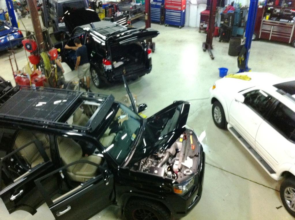

Some minor updates. I had a few friends over at the shop last Saturday and we had a "work on your truck" night. The ever elusive GotMo37 was installing almost an entire audio system, our friend with the Seqouia was washing and buffing his truck, and I was installing the led hood light and rock lights with the Wired Wagon relay system.
No pics of final install yet. We didn't end that night until about 3:30am. I'll get some better pics later.
