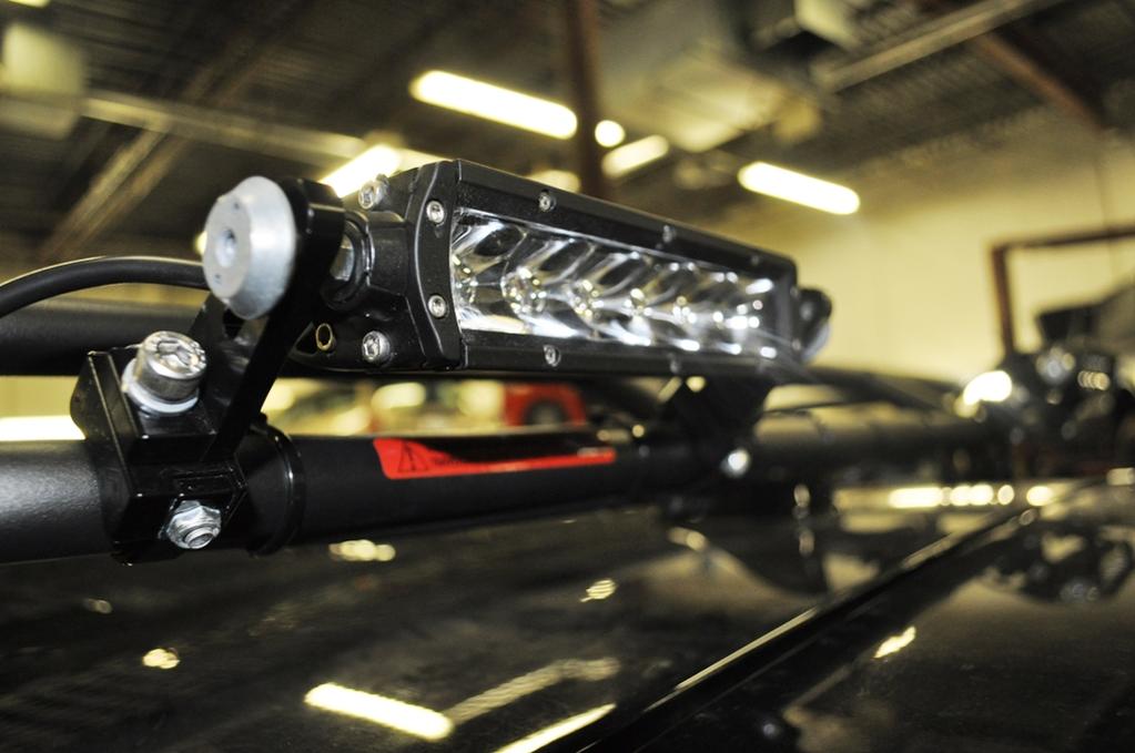

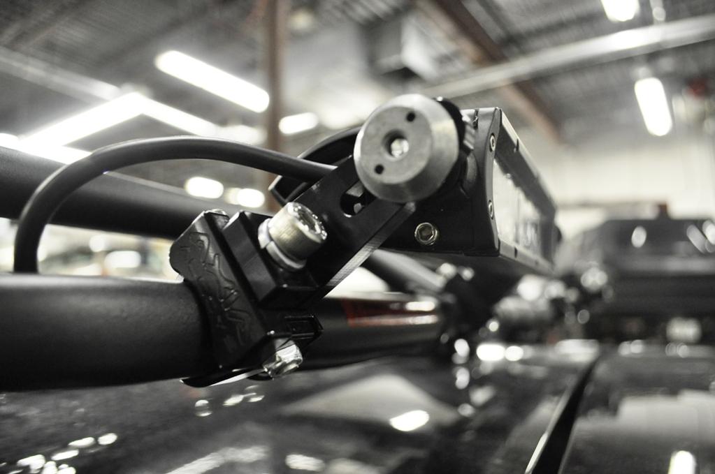

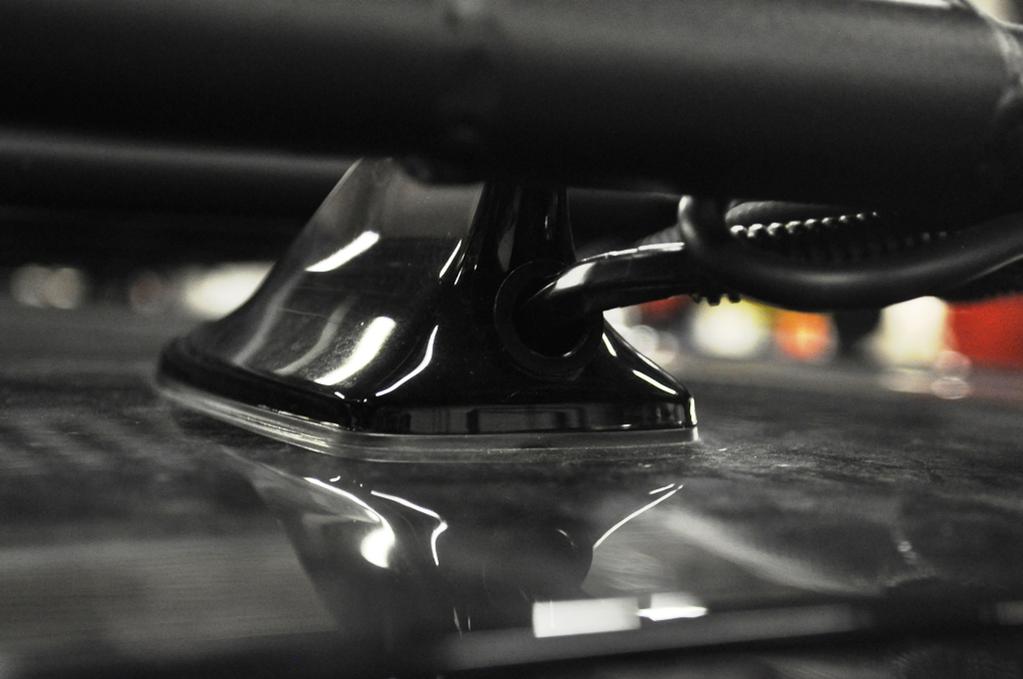

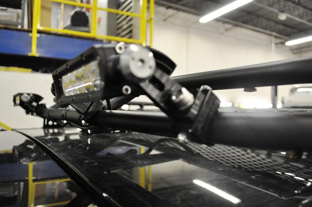

So, I've seen the wiring most of everyone has done here. Nothing wrong with going in through the factory location in the lift gate. It's actually a great idea (already has grommets, fairly water tight, etc...).
But, I knew I would be using the rear lift gate multiple times a day. I wasn't overly comfortable with the wire chaffing my paint over time.
I got rid of the factory head unit (went with Pioneer). I no longer needed the stupid antenna inside our shark fins. So, I/we (GotMo37) gutted the interior, ran the wiring through, installed a grommet, used the same ground for the original xm antenna and ran the wiring through the fin. Clean!
[MENTION=68685]Ducmonsta[/MENTION] Those brackets look great, certainly clear up the issue of light being blocked by the lift gate spoiler.
Question, (I have not taken apart my shark fin) can you go further in depth about the process of running the cables through your shark fin?
How'd you pass the connector through?
what size hole did you drill in your fin?
did you use a grommet to pass the cables through?
Seriously a great idea, thanks for sharing!

I'm assuming you are willing to get rid of the factory XM antenna and you'll only need 2 or 3 12ga wires. If not, it'll be really tight to get more than 3 wires through or wires that are bigger than 12ga.
To answer your questions, there is no connector to get through. You'll have to solder the connectors after the wires are run through.
I don't recall what size drill bit I used. But once you get the fin off, you'll have a pretty good idea of what the max size hole can be.
I did use a grommet, but mainly, I relied on the silicone to seal things up. The grommet size will be dependent on what size hole you drill.
If you look further in my build, you'll notice I scrapped the antenna fin idea and went with a bulk head marine wiring system. Ultimately, this is a better idea as you can use pretty much any size wire and almost as many as you need.
You can see better detail from this post forward... http://www.toyota-4runner.org/5th-g...ild-thread-very-pic-heavy-34.html#post1798402

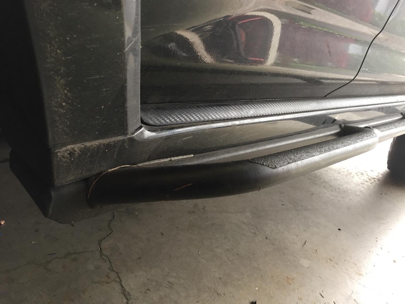

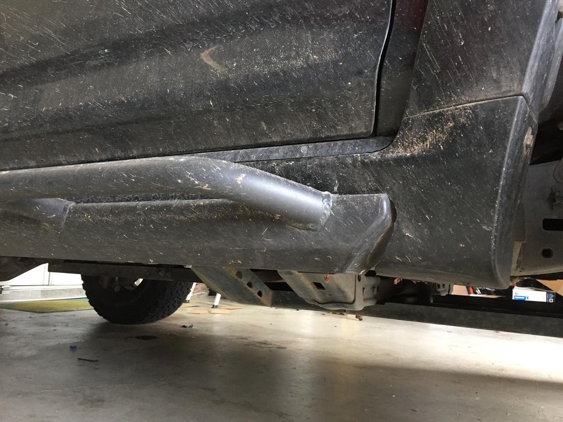

Promptly went to visit [MENTION=76752]helocat[/MENTION] at MetalTech 4X4 and proceeded to get fantastic service.
I specifically wanted the top shelf equipment hahahahaha. Ended up with Metal Tech sliders that fit a Trail.
I had to deal with either removing the Limited/SR5 rockers or trimming them. Of course, I opted for the hard way. But there was no way I was going to let it looked hacked.

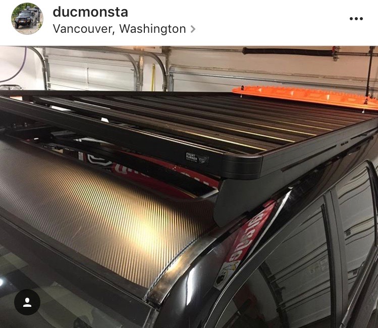

Began prepping for the new FrontRunner full length rack. You know me and this stupid DiNoc. But its for the roof and you'll never see it anyway.
Got my shipment from FrontRunner on Thanksgiving eve! It was going to be a long night.
Wrapped the roof!
I'll spare you guys the details but I installed the rack a little different than the instructions. You're supposed to use a rivnut tool to set the blind rivnuts in the roof. I elected to drop the headliner and use actual nuts inside. Word of caution while drilling.... you MUST be VERY VERY VERY VERY careful. The side curtain air bags are right there. The other key thing is, all of your metal shavings from drilling will end up on your airbag. Not sure how that's going to feel if it actually goes off.

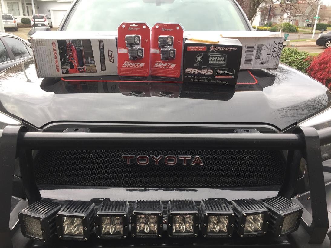

Another delivery from the brown truck! Updating the lighting with an 40" E2 for the front, Rigid Ignite diffused for alleys, a single SRQ2 for chase/eff you light with amber lens.
