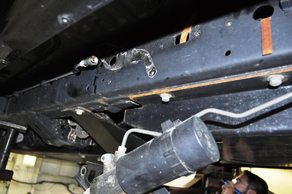

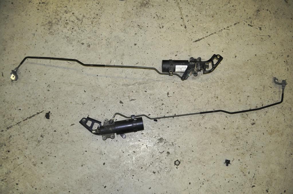

First order of business is to remove the XREAS system. Again, these sliders are intended for the SR5 and I am installing them on my Limited.
Remove XREAS reservoirs on both sides.
Throw them on the floor. The lines attached in this picture go towards the rear of the vehicle. The check valves at the end of these lines are what you loosend up when replacing the rear shocks.

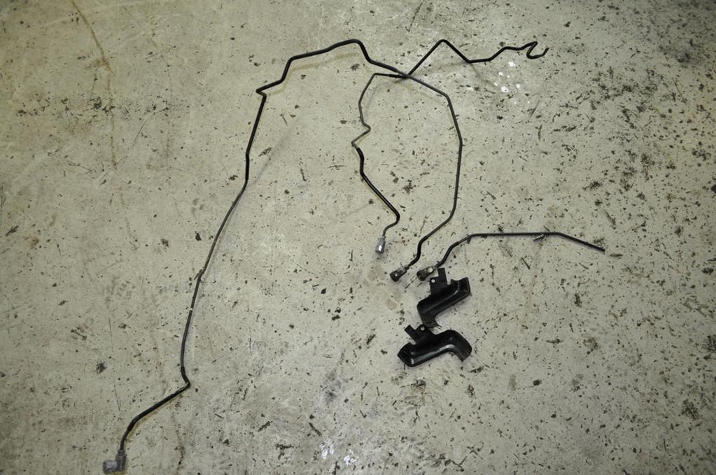

There are only 2 lines left in the XREAS system. Some have taken the time to save these. I'm not sure why, but if you're going to lift your Limited, chances are, you'll never reinstall the XREAS system. So, with some line cutters, off they go!

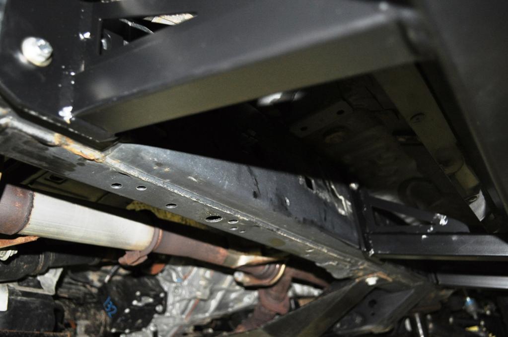

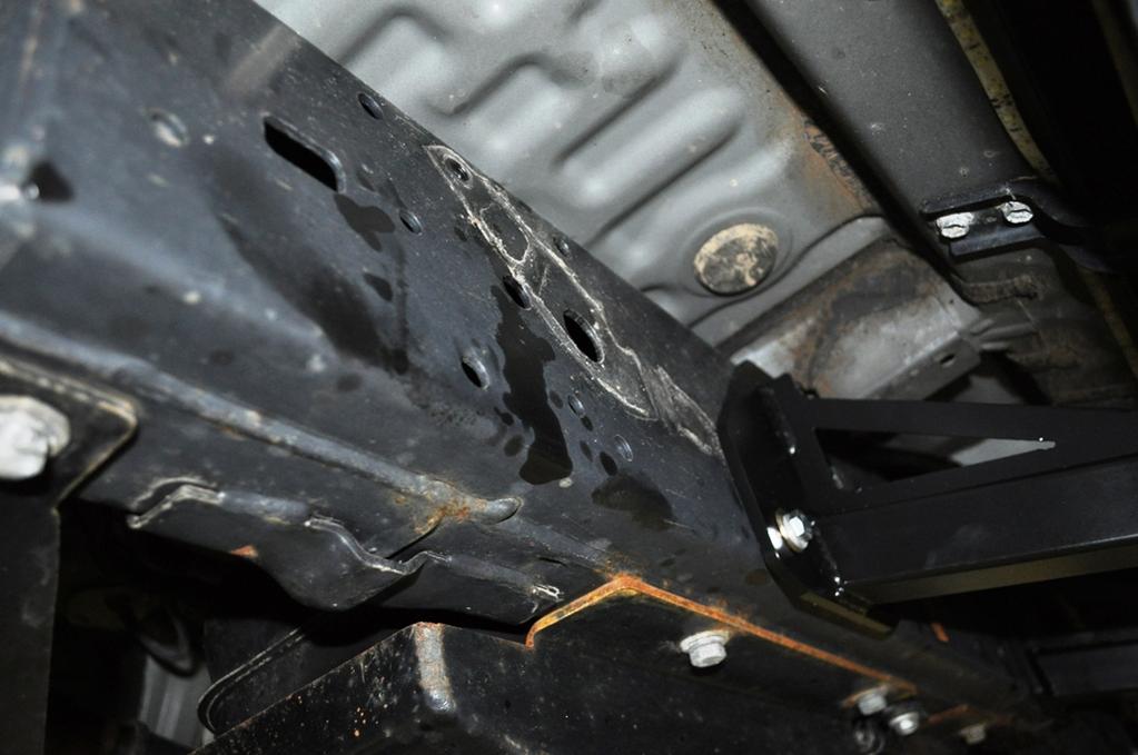

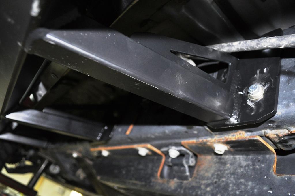

Next, all the holes line up EXACTLY where they needed to be. Originally, I thought I might be able to install the sliders with the XREAS canisters intact. You'll see where the XREAS brackets used to sit on the frame. Unfortunately, the legs of the sliders mount at the same place the brackets of the XREAS system do.
Here is the pass side framerail.
Drivers side
I would recommend anti seizing the hardware before you install them. If you're really anal, run a tap through the factory frame threads.
It is also good to note that you'll be able to use Shrockworks skids with Metal Tech sliders. There was absolutely no interference from one to the other.
Drivers side
Look at all that rust!:behindsofa:

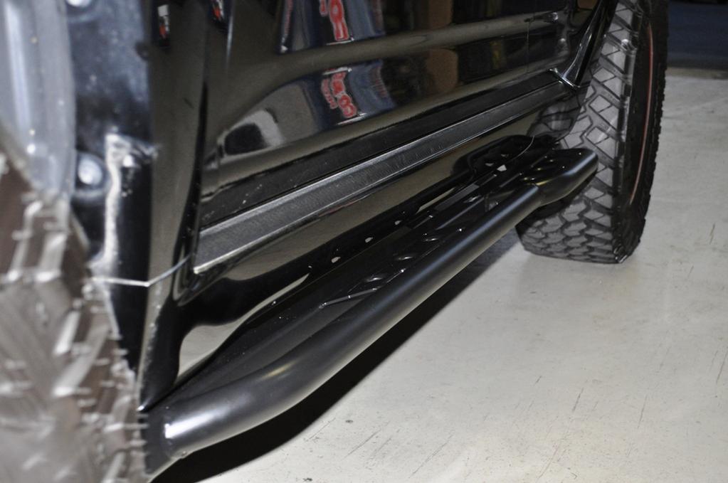

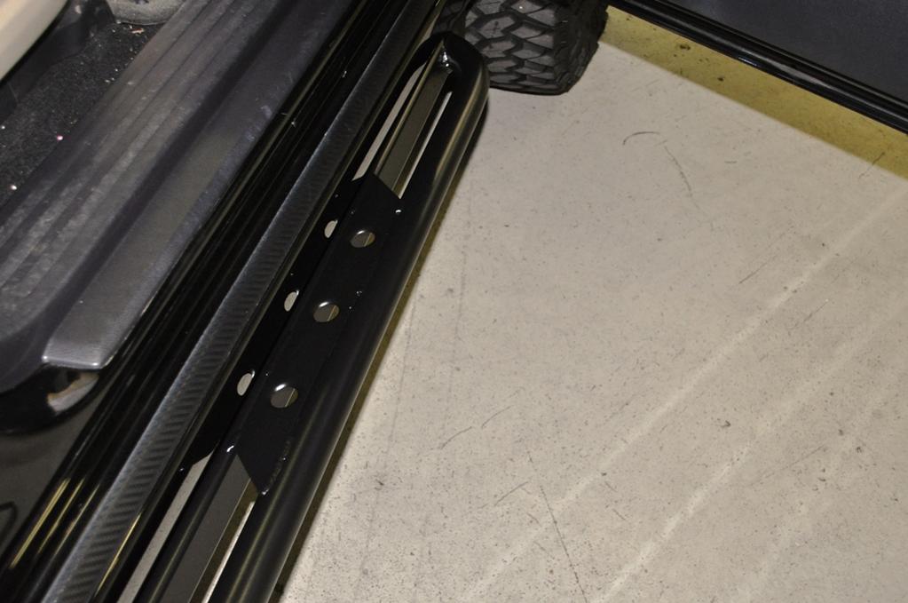

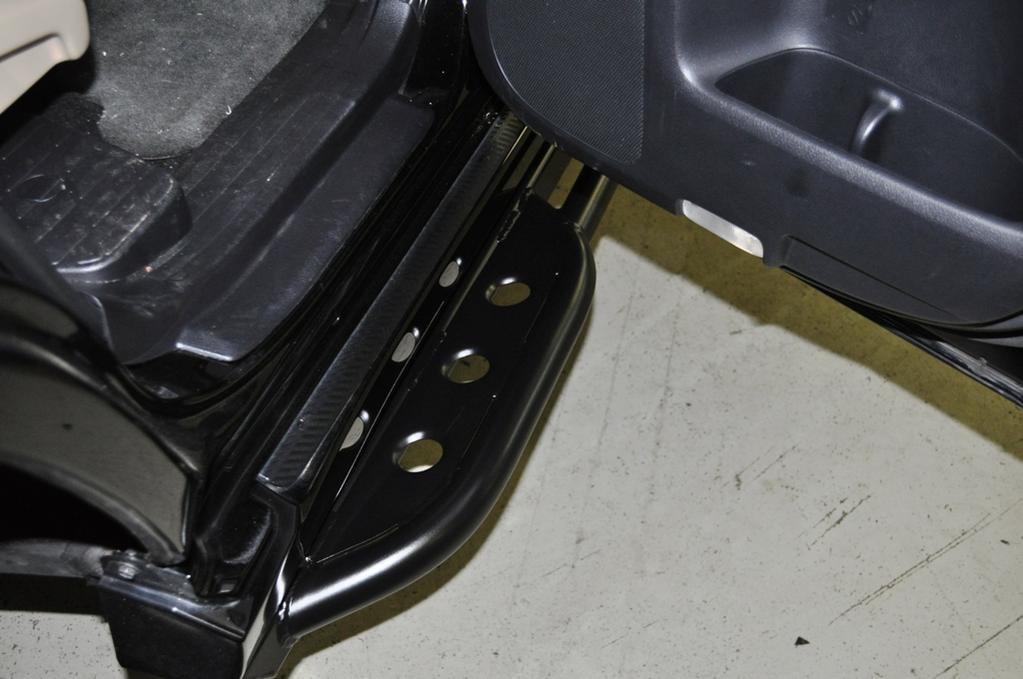

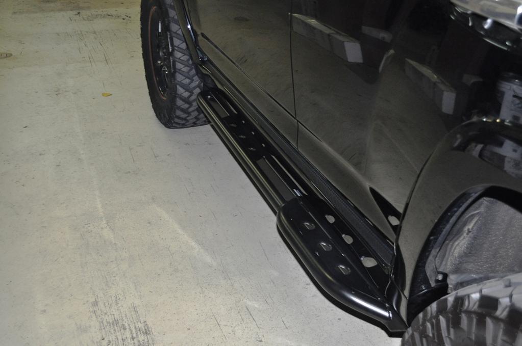

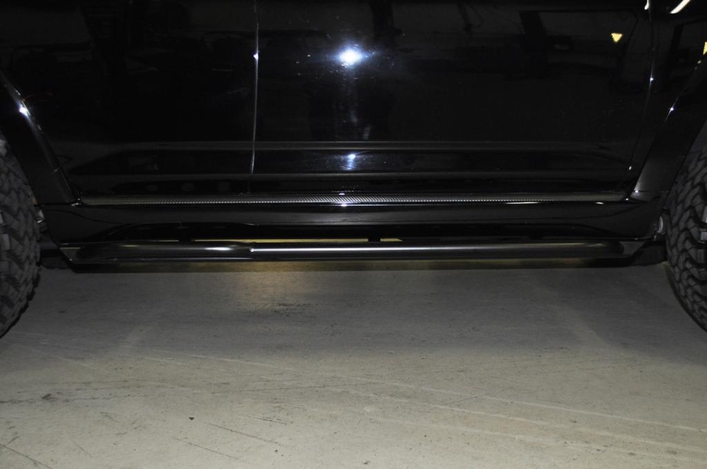

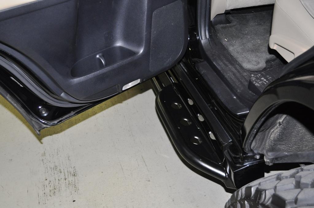

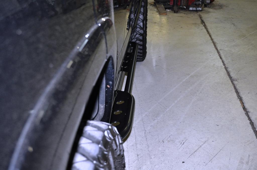

Anyway, here are some after shots to show you guys how they sit.
Pass side
Pass side front door open
Pass side rear door open
Driver's side with doors closed
Driver's rear door open

Bobby,
They look really nice, as does your truck. Thanks for taking good care of me at the shop this week. You guys are great! See you next time.
Ducmonsta
Is that the standard black finish that they offer for the sliders? Are they slippery when wet? Is there any texture to them?
I'll be ordering a set in the coming days.
Thanks!
Ducmonsta
Thanks!
As far as I know, this is the standard finish they offer.
Yes, Bon Jovi, it IS slippery when wet.:yo:
There is no texture to the finish. I have been toying with some grip tape for skateboards. Just trying to decide on the way I'm going to apply it.
Thanks!
I'll ask if they have any solution to this problem that can be applied to the coating.
