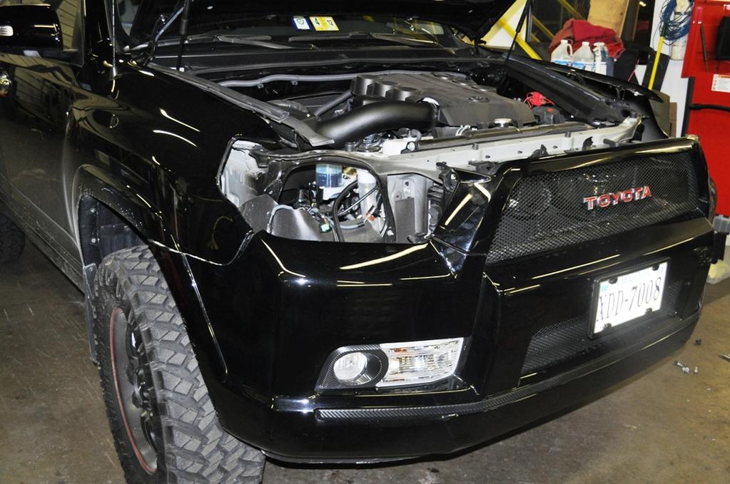

Some updates...

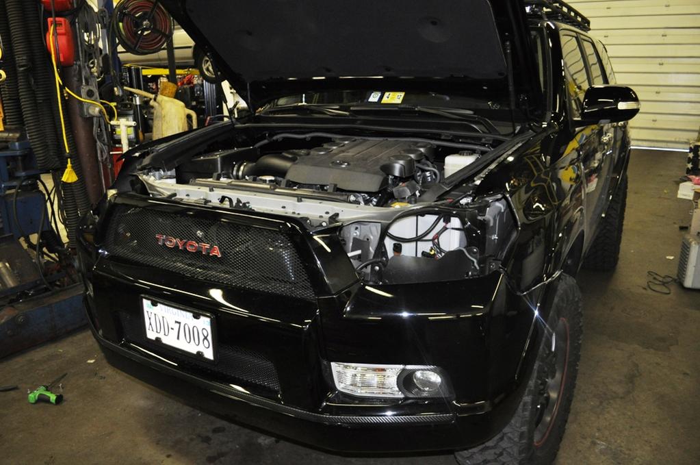

Had to send the lights back to Oracle for some minor repairs (3 leds on driver's amber strips went out). Glad to see they stand behind the product. But still had to remove them again. Man, I'm getting good at removing these things. Didn't even remove the grill.

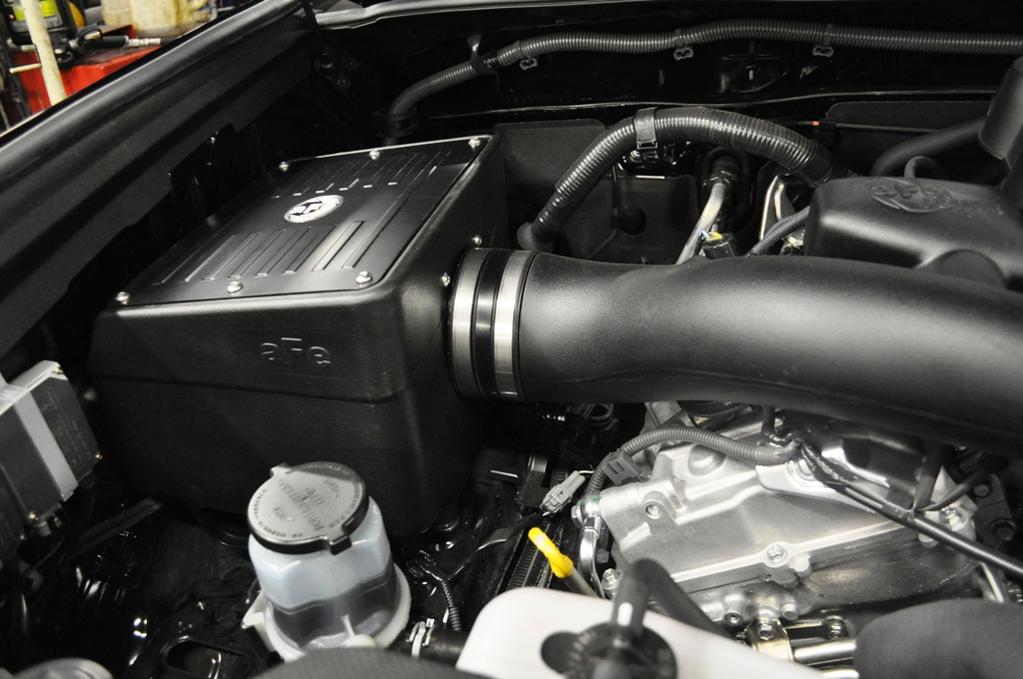

Of course, the AFE cold air intake system. Not expecting better fuel economy or increase in power, but just to enjoy the sound! I know, everyone's seen it. No biggie.
I will say, fit and finish is impressive.

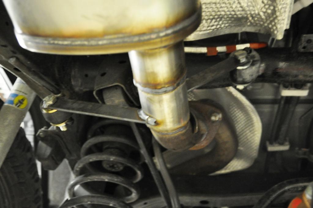

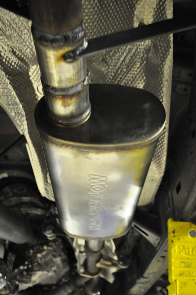

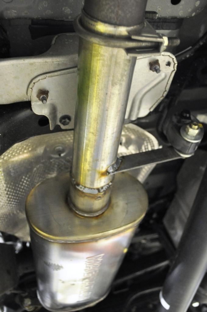

And to continue with sound. I decided to go with a Magnaflow 12556 (I think). 18" body, offset center 2.5". Yes, there is some drone. Bothersome? I don't think so.
Thought I'd go with some beefier hangers than the spindly ones the factory fatass muffler came with. I wanted a more solid mount. You'll see the welded plates on the "new" pipes coming from the muffler.
Kept the factory flanges and clamped the ends on. Just in case it gets too loud for me.

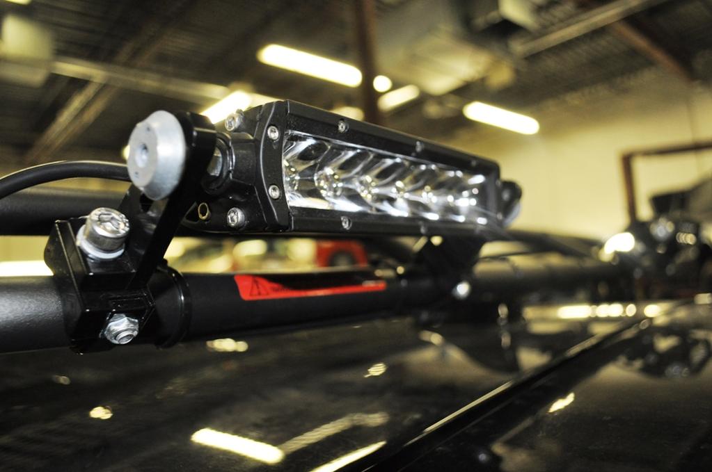

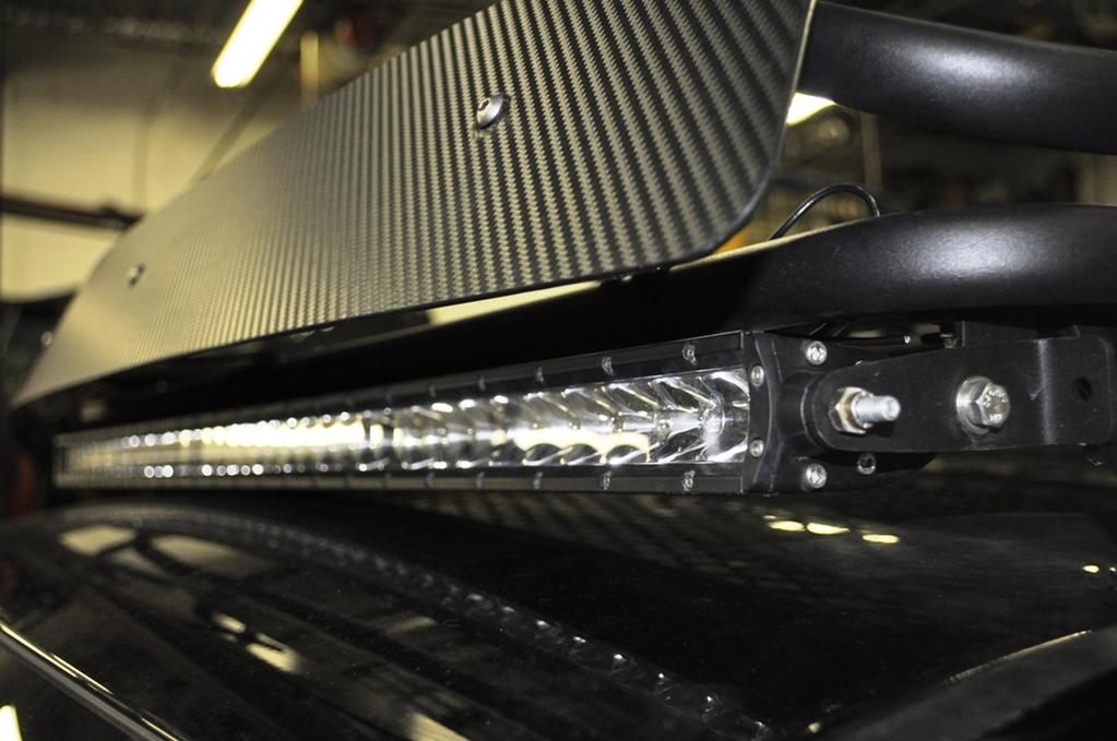

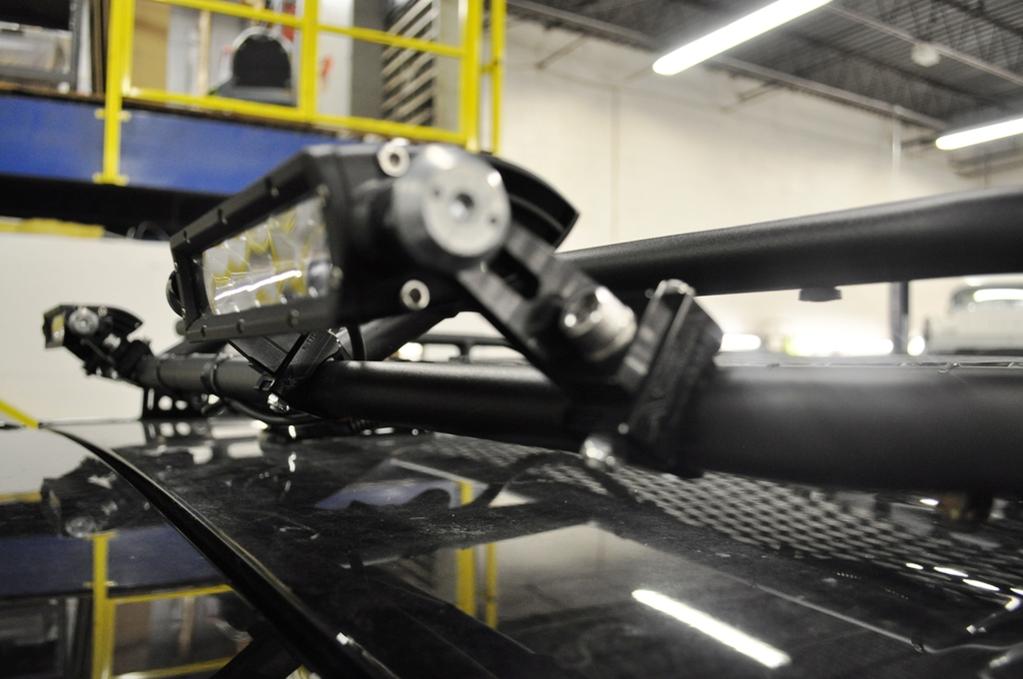

Started finalizing the wiring for the 40"SR under the Gobi. Here's a close up of the mount and limits to height if you want to mount one up.
There's about a 3/8" gap between the light and center of the roof.
Gotta give props where it's due. GotMo37 helped tremendously with the electronics set up. He's got all the experience with the audio and electrical stuff.
My shop will probably be installing a 40" E Series to the underneath of joneseyyy's Baja rack. Of course, this is after I do a write up for his Shrockworks bumper and Warn winch thats sitting at my shop!

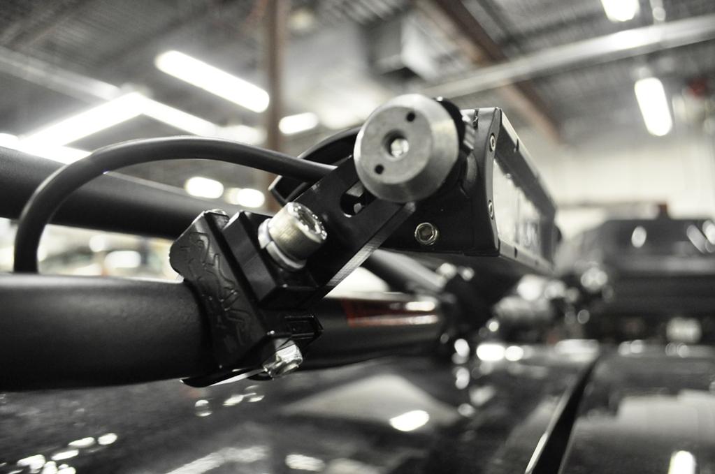

In regards to the back up lights...I originally was going to use 10SRs. I held them up there and it looked to be too much. The lights would cross-over the vertical bars in the rear and just didn't "seem" right. So, on went the 6"SRs. I used the aluminum clamp kits that Rigid sells, and boy, these things are PRECISE! Really top notch!
These mounts allow all kinds of adjustments. It really allows you to move the lights as far outward, away from the spoiler to get as much light to the ground as possible.
These are mounted so that the lift gate comes within 1/2" of hitting the lights with it open.

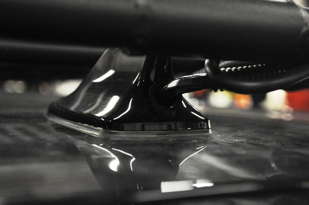

So, I've seen the wiring most of everyone has done here. Nothing wrong with going in through the factory location in the lift gate. It's actually a great idea (already has grommets, fairly water tight, etc...).
But, I knew I would be using the rear lift gate multiple times a day. I wasn't overly comfortable with the wire chaffing my paint over time.
Sidenote-check under your spoilers guys, there is probably paint starting to come off right where the spoiler touches the gate on either side of the windows.
Back on topic-
I got rid of the factory head unit (went with Pioneer). I no longer needed the stupid antenna inside our shark fins. So, I/we (GotMo37) gutted the interior, ran the wiring through, installed a grommet, used the same ground for the original xm antenna and ran the wiring through the fin. Clean!
