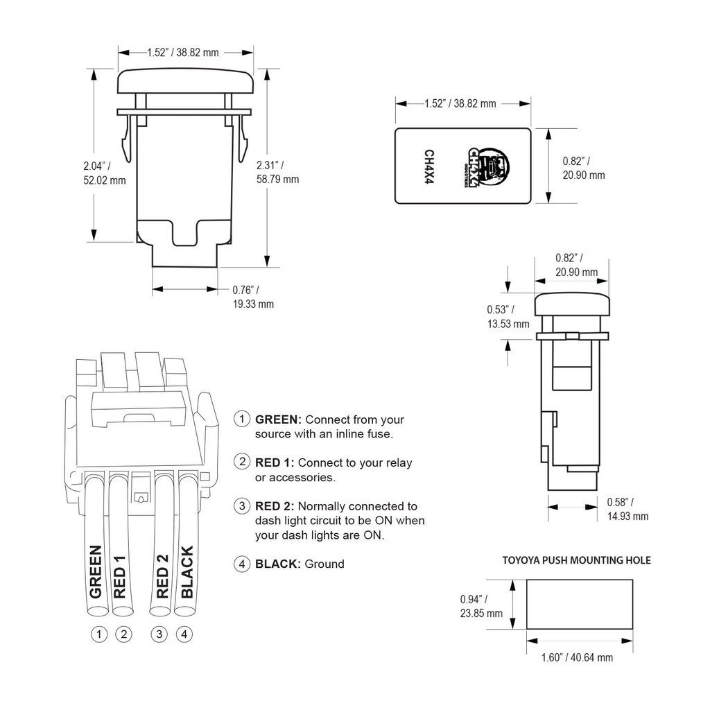

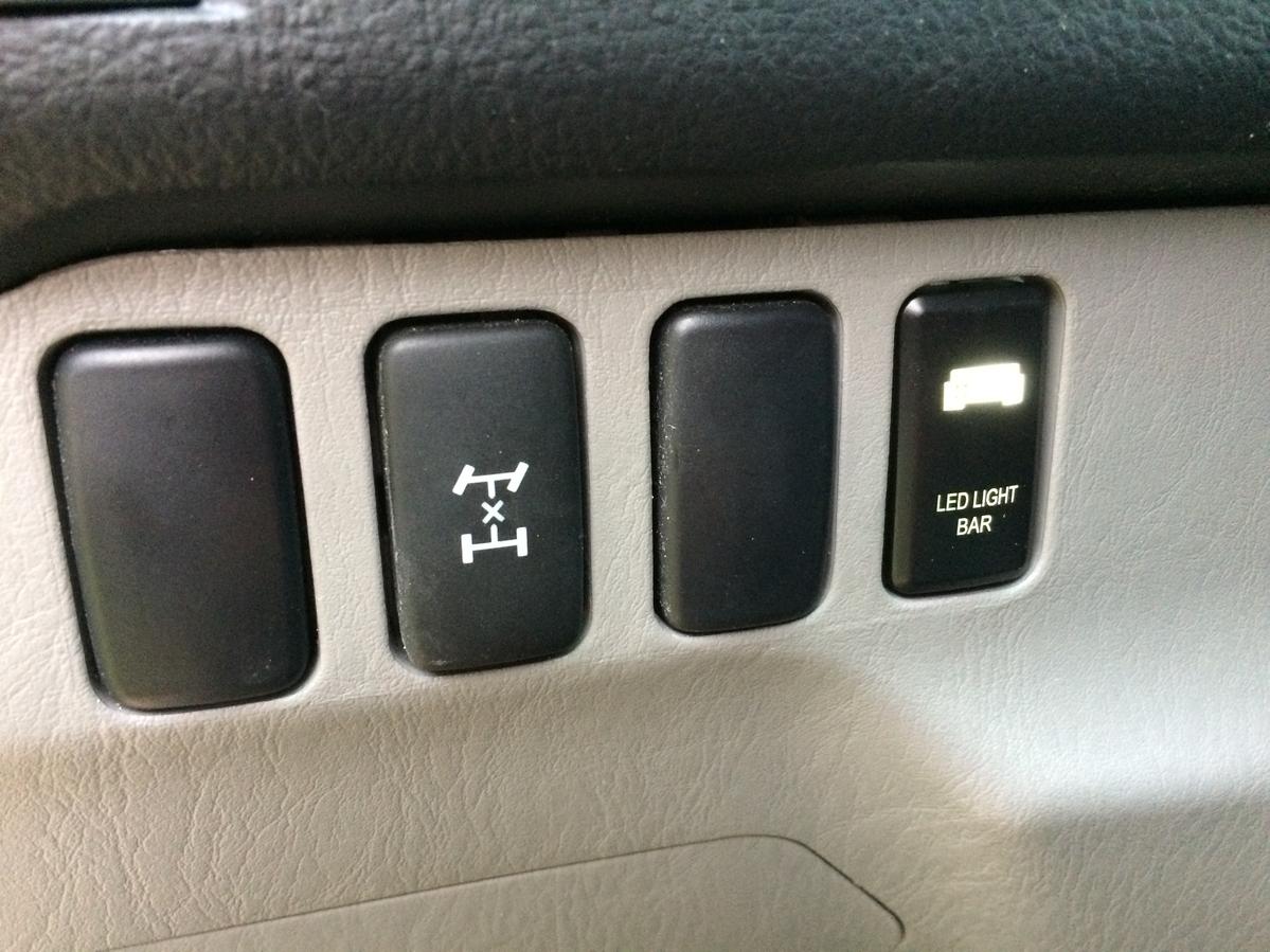

Mind if I ask how you wired that switch? I have a rear LED and ordered a very similar four wire switch from another vendor (I should have checked Amazon first).
My current switch is a three wire unit -
wire 1: power from parking light circuit for switch power and switch LED light (I used an add-a-fuse in the under-dash fuse panel)
wire 2: connected to relay
wire 3: ground
These four wire switch instructions show the above three connections with the fourth wire connected directly to a source with inline fuse (assuming a direct battery connection?). But would this even be necessary if I'm getting power to the switch via the parking light circuit?
I only used 3 of the 4 wires. The fourth is for the back light, when you turn on your headlights. I don't care about that, so I only used three. I have a relay installed for my bar, and a fuse block I purchased. This diagram is what I used. Hopefully it helps.

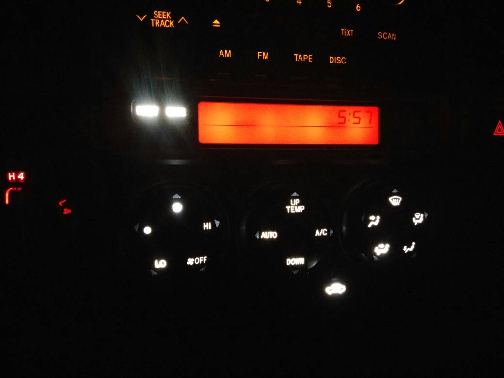

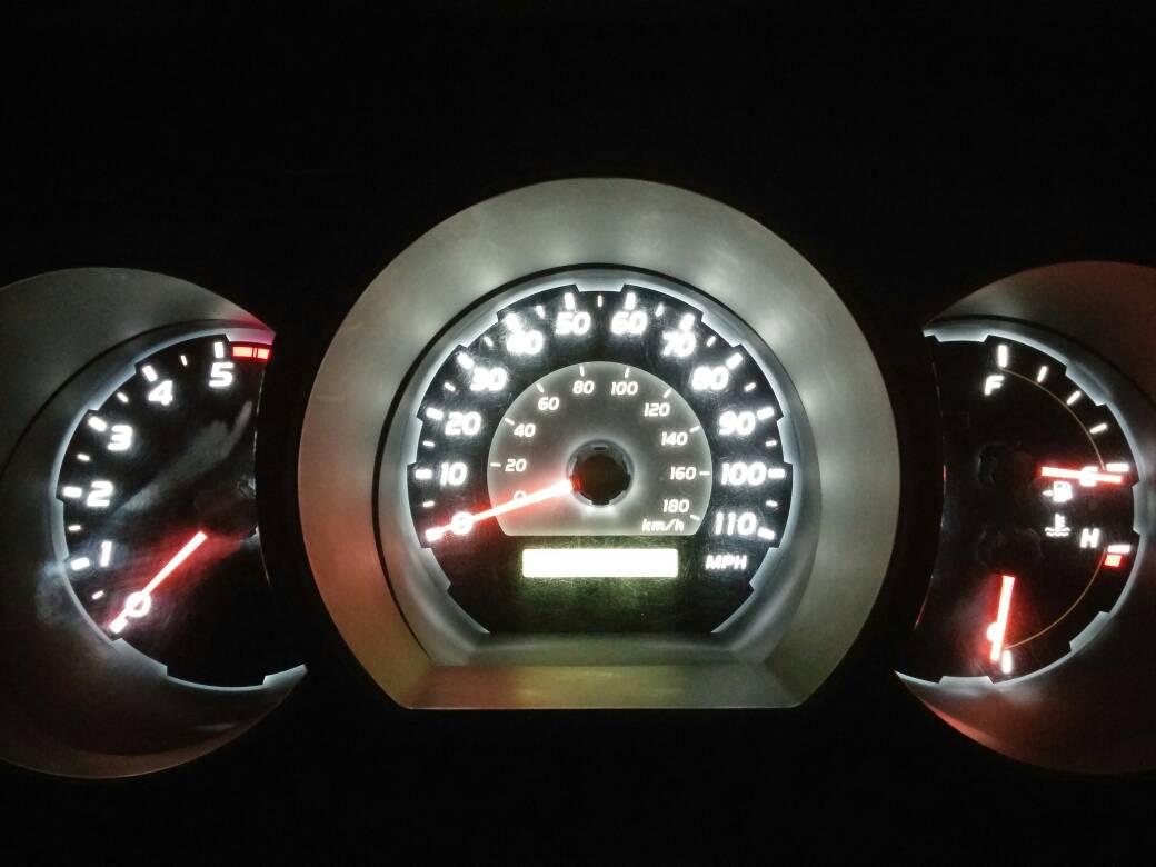

Just put in HVAC and speedometer LEDs from SB and Lighthouse. They look great and the HVAC cluster can easily be done in 10 minutes. Went for all white and red info display, which is more red in person.
The speedo requires soldering, correct? Also how did you do the hvac lights. I've converted all of my dome lights to green LEDs and would like to convert these also.
Yes the speedo requires soldering tiny LEDs that are base mounted, no wires, making it even tougher.
This thread should help you out: http://www.toyota-4runner.org/showthread.php?t=204633
SuperBrightLEDs has most the LEDs for the hvac. They are Neo3's and Neo4's.
LightHouseLEDs has the LEDs that you have to solder on.
