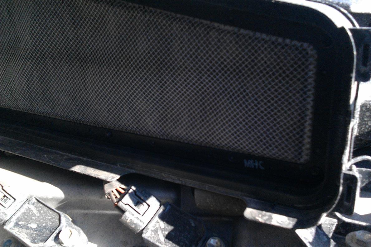

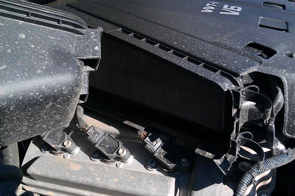

im confused.. my air filter looks different than this one.. is this only for the sport or v8..
i have the sr5 v6
The factory air filter setup is different between V6s and V8s.
However, both the V6 and the V8, have the HCF filter in the same location, so this DIY that I posted is to be used as a guide.
eskimochaos said:
open up the air filter box and seated right above the filter itself is the hydrocarbon filter. It mounts on rivets that are easily pried off using a flathead screwdriver. Looking at the hydrocarbon filter, it looks like a large fish tank filter with the same black beaded charcoal inside. Furthermore, it definitely restricts airflow. Blowing through it as hard as I could yields only a small amount of air that actually gets through it.
Is this only for California 4 runners, because the only additional filter I see is on the part entering the engine
