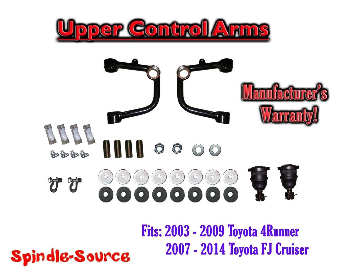

Looks like a new budget UCA showed up....
IDK, if people were hesitant at $250 for the silver ones then I'd definitely be suspicious of these at $235
2003 2009 Toyota 4Runner 2007 2014 FJ Cruiser Upper Control Arms 2WD 4WD | eBay

Manufacturer's Warranty!

Looking at ordering the new ebay ones do you think they will perform similar to the other ebay ones people have tried? Anything I should watch out for when I get these as i know very little about uniball vs these ball joints. Thanks

Has anyone read, or contacted the seller to be sure they are to be used to put a lifted truck into OE alignment spec? Hate for anyone to purchase this set and they be the same spec as stock UCAs (not helping alignment at all).
