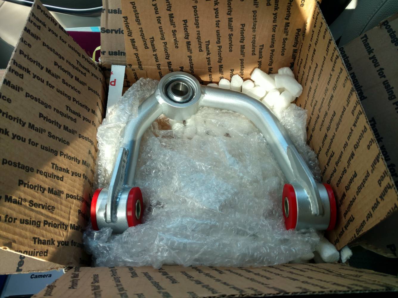

Thought I'd post a little here and keep this up to date. Ordered and installed these over the weekend. Price has gone up a bit from the OP but still a hell of a deal. About $350 w/ shipping. I put them on my '06 Tacoma, pretty sure these are all the same. Package came pretty much the next day as they were shipped from CA and I live in CA. Thumbs Up! As you can see they came out of the box With Out the ball covered in grease. Thumbs Up!
I did order some bushing replacements from Camburg (went with Camburg because they were black in color and they were the same price as All Pro, King etc.) I also ordered the All Pro uniball bolt to put in place of the supplied bolt as there was a failure in this thread. Granted those were installed upside down but cant hurt to have a better bolt (you can see that the seller has placed a "This Side Up" sticker on the UCA. Here's Your Sign!) Price now up to $450...
Decided to install them with the bushings/bolt they came with and will replace them down the road. Camburg & All Pro are a little slow on getting things processed/shipped and the rig needed these as she was def complaining with the OEM arms sitting on a 3" lift.
With the help of my roll dog and T4R counter part we got these bad boys installed without any major problems. She def needed an alignment after as she was chirping on every nook and cranny in the road and doing her best to yank me onto the shoulder or into oncoming traffic. Alignment went well and she's feeling solid as rock now.
Will post updates as the miles stack and the trails are run!
All in all I'm stoked on these!

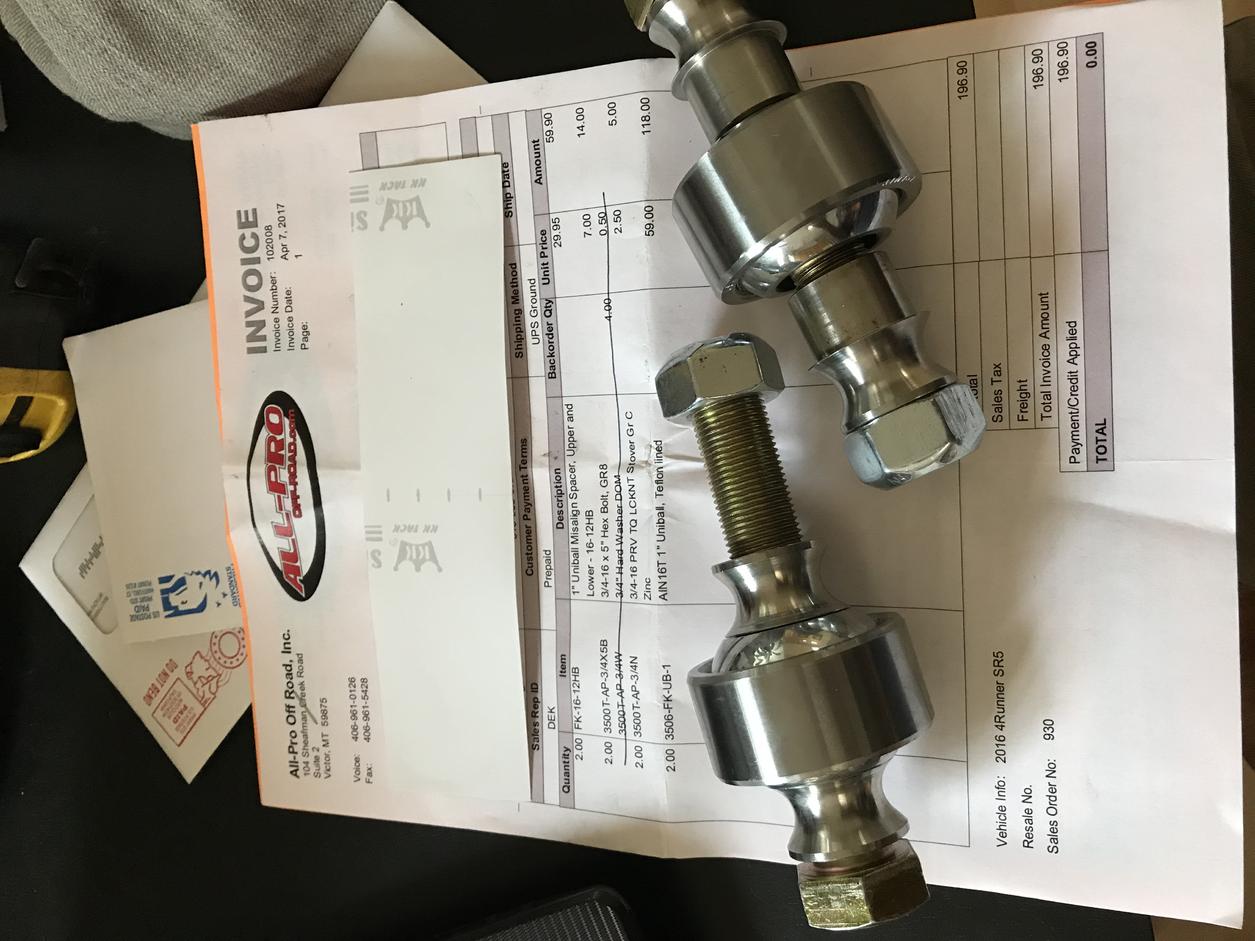

I bought some of these today for $100 off a guy who never got the chance to install them. When I got home I noticed that the metal sleeve is actually a tad longer than the poly bushings and that the uniballs do not swivel in the housing. I assume the sleeve will be alright since its longer than the poly (the exact opposite of what early posts seem to have) and also do I need to just lube the uniballs and "knock" them loose for lack of a better term? Thanks!
I have a set of new uniballs, misalignment spacers, and bolts for sale. Bought to rebuild some icon arms, but icon uses a different uniball. Bad reasearch on my part. Selling for $160 shipped conus paypal.
I'd probably hit the sleeve with a grinder just so everything's nice and tight. Depends how much extra we're talking about though. In regards to the uniballs, mine are definitely stiff. Not something you can just push by hand. I leveraged them into place using the spindle though.
Thanks for the reply probably gonna install them tomorrow, I put some 3 in 1 oil on them and let it soak then I was able to move them with a little leverage. I know you are supposed to use dry lube on these but I didn't want to purchase it for uniballs that might be seized.
