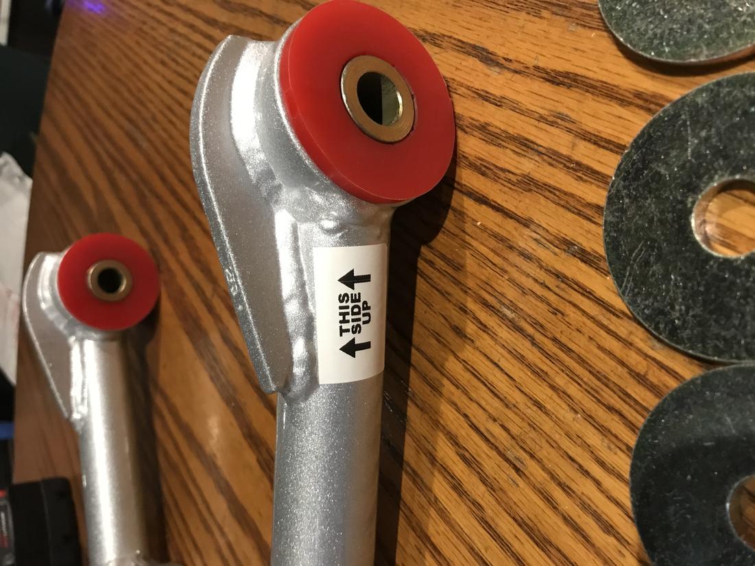

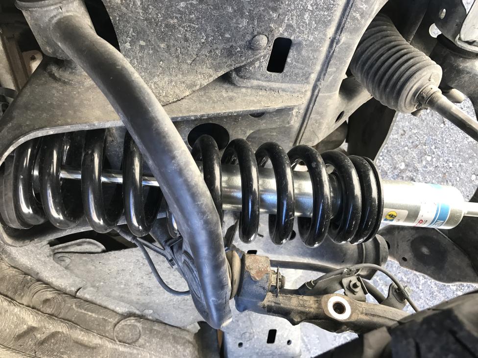

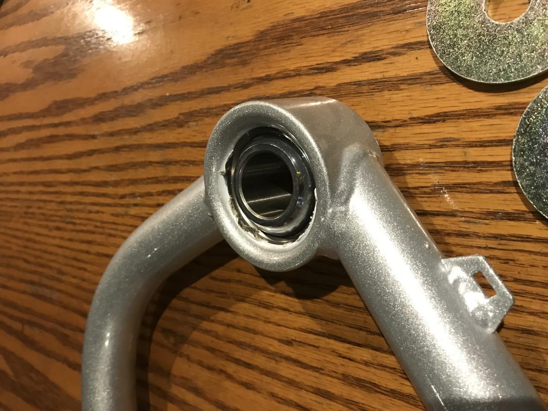

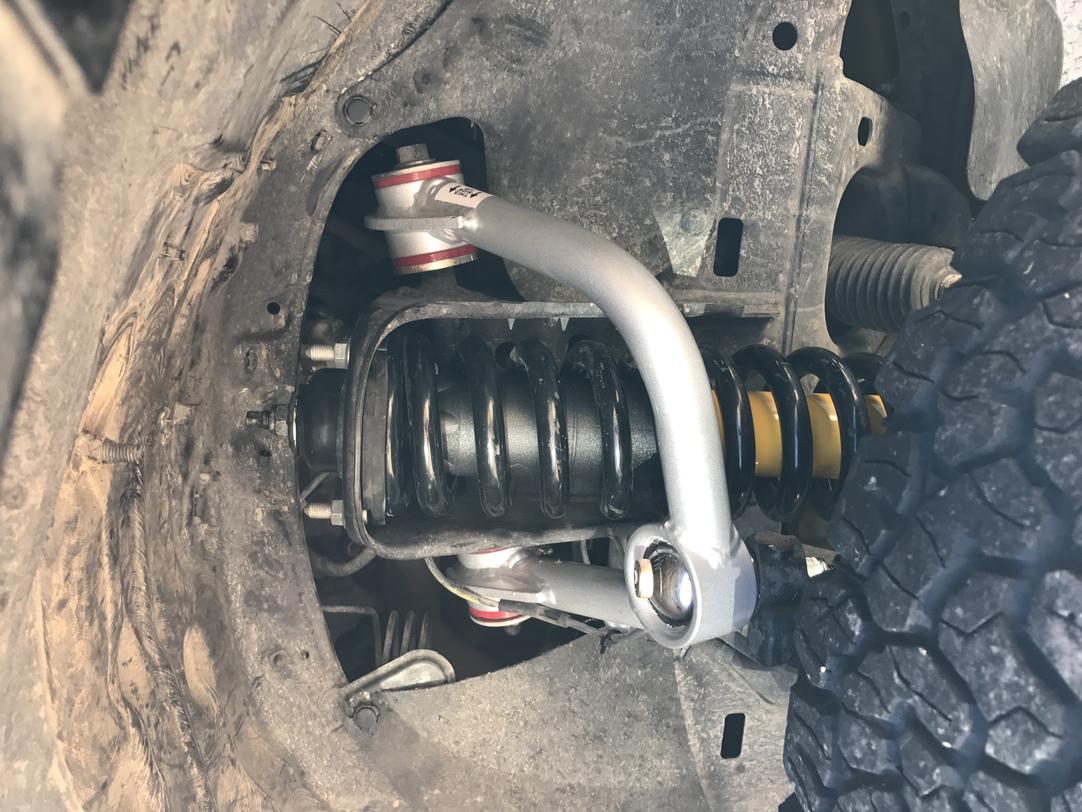

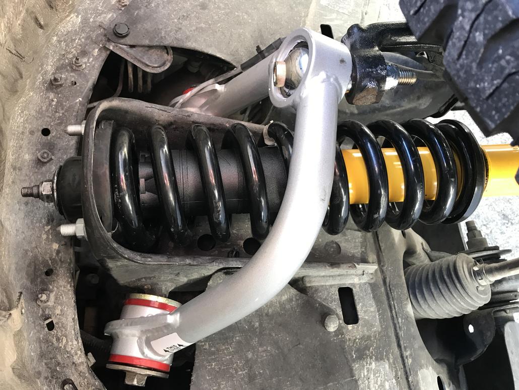

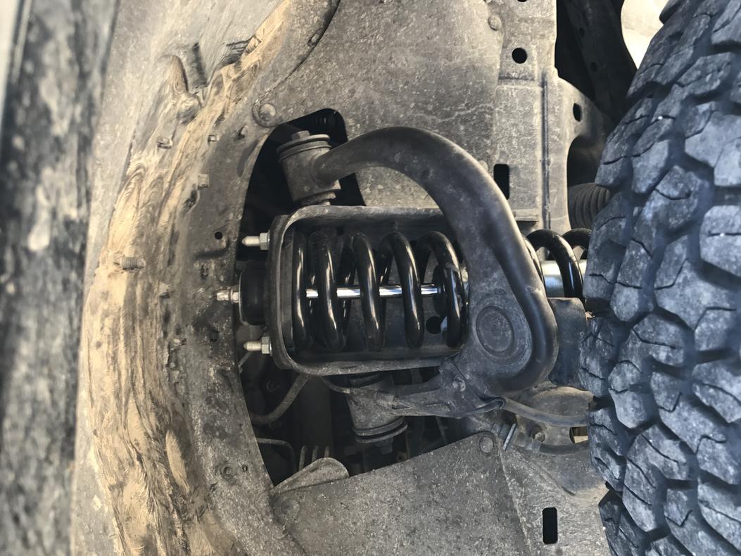

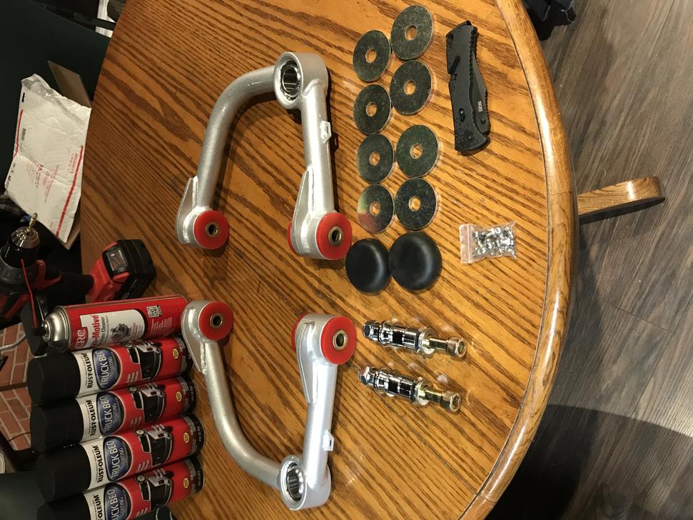

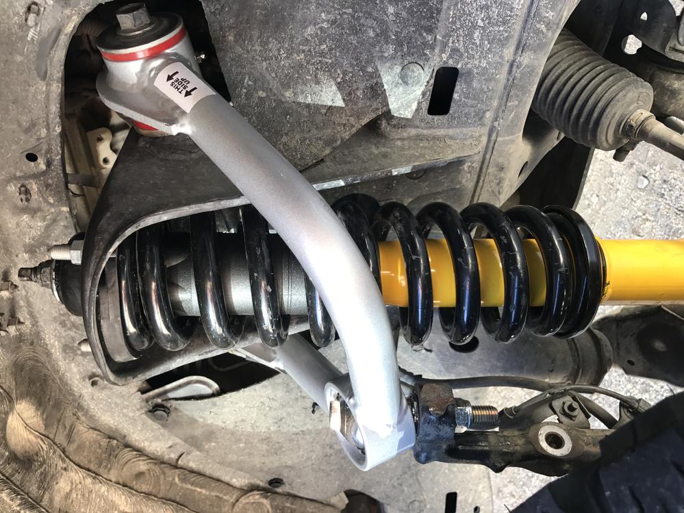

Thought I'd post a little here and keep this up to date. Ordered and installed these over the weekend. Price has gone up a bit from the OP but still a hell of a deal. About $350 w/ shipping. I put them on my '06 Tacoma, pretty sure these are all the same. Package came pretty much the next day as they were shipped from CA and I live in CA. Thumbs Up! As you can see they came out of the box With Out the ball covered in grease. Thumbs Up!
I did order some bushing replacements from Camburg (went with Camburg because they were black in color and they were the same price as All Pro, King etc.) I also ordered the All Pro uniball bolt to put in place of the supplied bolt as there was a failure in this thread. Granted those were installed upside down but cant hurt to have a better bolt (you can see that the seller has placed a "This Side Up" sticker on the UCA. Here's Your Sign!) Price now up to $450...
Decided to install them with the bushings/bolt they came with and will replace them down the road. Camburg & All Pro are a little slow on getting things processed/shipped and the rig needed these as she was def complaining with the OEM arms sitting on a 3" lift.
With the help of my roll dog and T4R counter part we got these bad boys installed without any major problems. She def needed an alignment after as she was chirping on every nook and cranny in the road and doing her best to yank me onto the shoulder or into oncoming traffic. Alignment went well and she's feeling solid as rock now.
Will post updates as the miles stack and the trails are run!
All in all I'm stoked on these!
