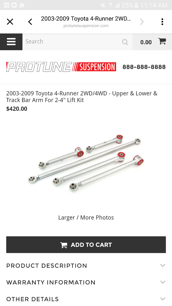

Which heims did you go with and how did you address the upper link issues with the misalignment spacers and sleeves in the bushings being too large for the 17mm bolt that the stock arms use? I've been running the lowers and track bar, but I never got my uppers situated.

They're imported by Jennifer Fan (who's actual name as best I can tell based on the financial transactions is really Min Hong Yuan) and who runs a whole group of phony companies by the names of auto.blitz, protune suspension, etc. None of which have a business licenses in California and all list 14010 Live Oak Ave Baldwin Park, CA 91706 USA as an address, but return shipping actually is going to elite-lift. It's a typically fly by night operation with cheap imported parts, no insurance, no business license, pays no taxes, takes no responsibility.

The problem if you haven't seen my comments earlier in this thread is that the ebay "protune" or whatever name they use this week uses a cast misalignment spacer and a bolt head that's small enough to fit through the uniball. The casting is poor and the wrong material too. It doesn't rely even have to be strong. But it has to be strong enough to not fracture when you torque it to spec. Just the math on the tensile strength suggests that 90 ft/lbs should cause a fracture. If the misalignment set were manufactured correctly - they'd probably be a decent arm for the money. Welds were good. Bushings are shit and so is the uniball - but those are cheap enough to replace. The most critical part fails under normal installation. And it's the easiest part to get right. All they need to do is re-design it so it uses an off the shelf ball joint. They could literally charge the same price for arms that just fit a high angle ball joint and not even include them.

Ironically "protune" is actually a registered trademark of Fox the real suspension company.
