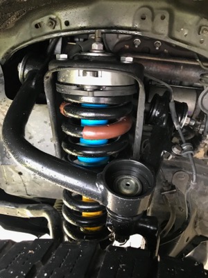

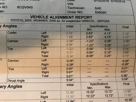

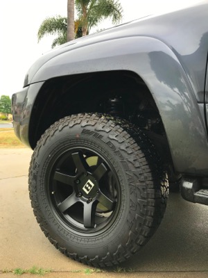

Just had some trd offroad shocks off a 2019 tacoma, 2inch spacer, and the eBay upper control arms from spindle source installed. Previously had a daystar 2.5 spacer and with this new setup raised it another 2 1/4 inches putting me at right under 39inches ground to fender. So id say about 4inch lift from stock. My question for anyone running these eBay arms or any others, did you still have trouble getting caster to anything 3degrees and above? Went to get an alignment done and the tech was only able to get slightly above 2degrees on both sides, keeping toe and camber in spec. Said adjustment bolts were maxed out at these settings. Tech seemed pretty competent, didn't rush with the alignment either, and even showed me that he couldn't adjust the caster anymore without screwing up toe and camber. Alignment feels pretty good, but ideally I would like to get the caster to spec. Just wondering if anyone else has had a similar issue with low caster and aftermarket uca.
As for the upper control arms, cant really give any kind of review yet as Ive barely put any miles on the car with them on, but install was pretty straight foward. No issues getting them on, except for the washers that came with them. Theres not enough room to get all 8 washers on, so went to home depot and bought some thinner washers to go on the inside bushings. But yeah they feel pretty solid, should last, hopefully. :thumb3:
