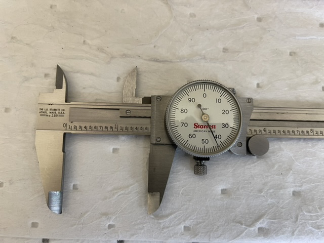

I threw a micrometer on the stock Tokiko shock I have from my 21 ORP and the Eibach 2.0 coilover to show the difference.
The photos aren't posting but you can see them at my website, Shocks - Jeff Feekin

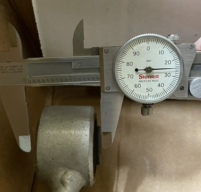

Ok, I likewise, as was [MENTION=649535]smooey[/MENTION] was thinking about the measurements here. So I pulled out my micrometer and took some measurements.
I want to have whatever I need when I do the coilover install.
So this is my findings:
Photos in this order.
Opening of lower shock mount with OEM coilovers installed from factory. 1.643”
Measurement of Toyota TRD FJ Cruiser lower coilover mount. (Same as 4Runner / interchangeable) 1.625”

I had the gallery set as private so you'd have to follow the link to see and just made it public. edit - I just checked the link in FF and MS edge and it's working so hopefully you can see them full-size now Shocks - Jeff Feekin .
Here is a link to photo 1 https://photos.smugmug.com/Shocks/i-BNW7JtF/0/2d9ec725/M/OEM shock-M.jpg
and here is 2 https://photos.smugmug.com/Shocks/i-GBgzJFk/0/d93d1fb4/M/Eibach Shock-M.jpg
Hopefully those work.
I did my measurements in mm but can redo in inches.

You are correct that once tightened that play goes away. It's after that, that you may or may not have a problem depending on how you look at things and/or if you make any suspension changes.
In my case I went from stock to the Eibach 2.0 coilovers and 2 weeks later then went to a TRD pro Fox suspension.
When I pulled out the Eibachs the Fox shock would not fit in the lower mount because when you tighten it up to remove the play it bends the lower mount. It wasn't even close to fitting.
I found that to be freaking annoying because in my experience it's not as simple as a hammer and a pry bar as other posters have said. And it added probably 1.5 hours to the install to open the brackets open enough to get the shock with the correct size bushing in and the hole for the bolt lined up.
I'd prefer to not bend and rebend something to attaches to my suspension but that's me and my comfort level.

I don't want to diminish your issue, but it really isn't that hard to bend the lower shock mount brackets back into place with the correct tool/leverage.
Those that have experience putting on suspension components know this is a very common occurrence across different vehicles and suspension offerings.
Out of curiosity what is the correct tool to use? The opening is only 1.55 inches wide after being compressed to fit the Eibachs and I couldn't figure out anything I had here to fit into that width and account for the limited depth I had to work with.
I suppose I could have reverse engineered a press with some all thread and a couple of nuts inside the mount.
A pipe wrench has worked for me every time.
Pretty easy fix.
Put them back in the box. Reinstall OEM suspension for now. Return the eibach for a refund.
Place order for King or Fox.
Well hell. I would have never thought of that but it would have seriously made my life easier if I had.
If you can't get enough bite from the metal to metal contact using a pipe wrench, you can place a rag over the shock mount and then tighten the pipe wrench down.
I've also used a crescent wrench with success (sometimes it doesn't work, as you've experienced). If you're not getting enough leverage from a crescent wrench, placing a metal pipe (or a jack handle if you have the room) over the crescent wrench's handle will give you more leverage.
