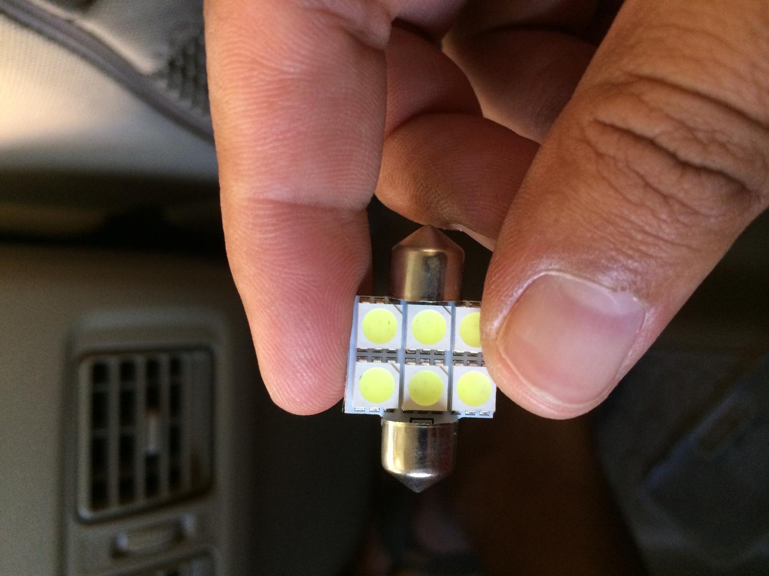

Thanks for the response!
Changing an existing LED in the cabin dome light to another LED light. Exact same type of light. (attached a pic).
I didn't do anything with the first LED i put in except pop out the incandescent bulb and pop in the LED. No Problems. So I guess no insulation or anything. This is the kit I bought: http://www.amazon.com/gp/product/B00FW1JXGO/ref=oh_details_o08_s00_i00?ie=UTF8&psc=1

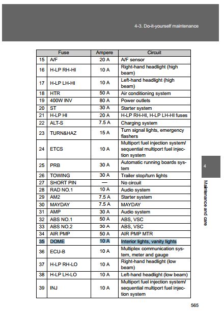

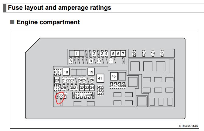

Pics attached to show which fuse.
Also - I installed the LEDs months ago and everything was fine until today, when I replaced just the dome light. Didn't do anything else on the car.
