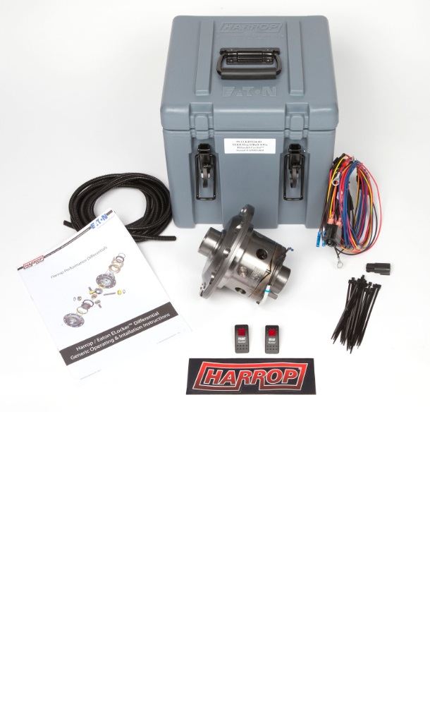

Thanks for being here Ben. I'll ask a question asked by someone earlier: Are we talking about just a locker or a complete 3rd?
Hi Mate, I think this image should be able to settle the argument with exactly what you get with the purchase of your Harrop ELocker.
