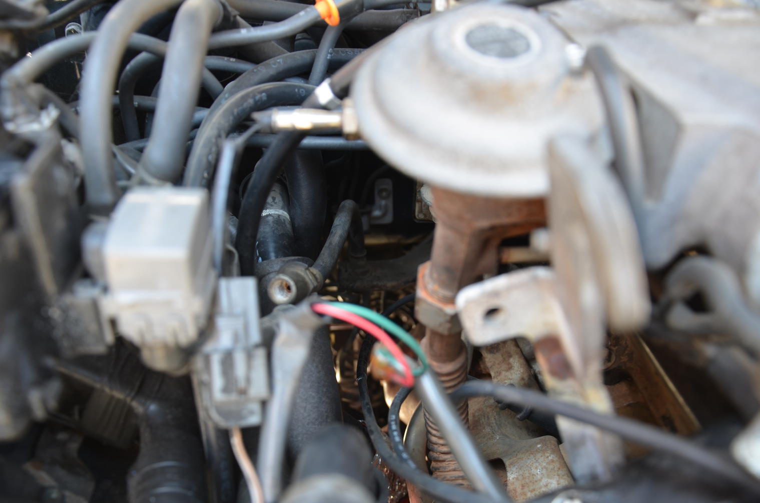

Hi everyone, I recently bought a 95 4runner that someone else had done an engine replacement on, I have a few hoses that are disconnected and I have no clue where they go.

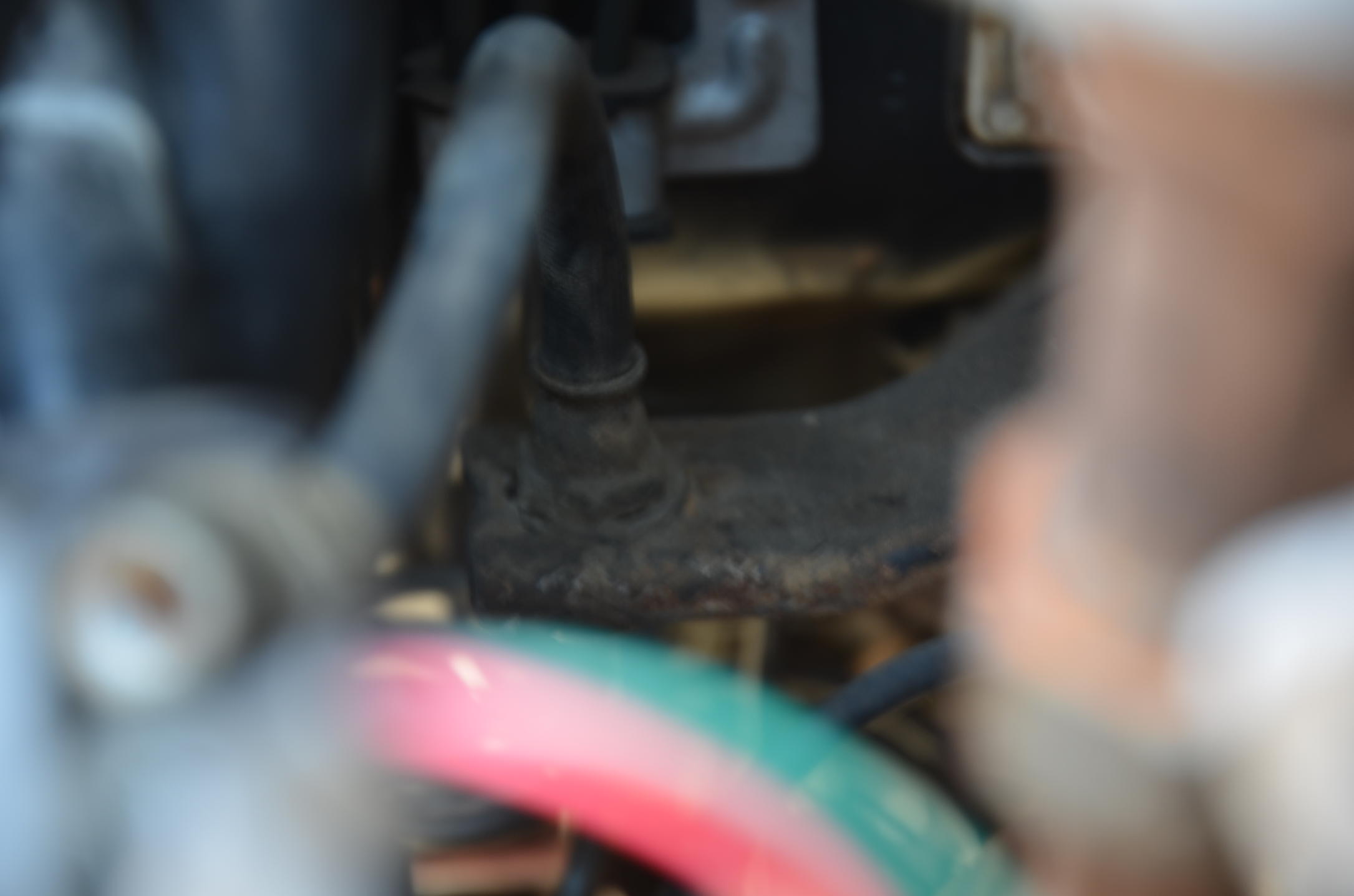

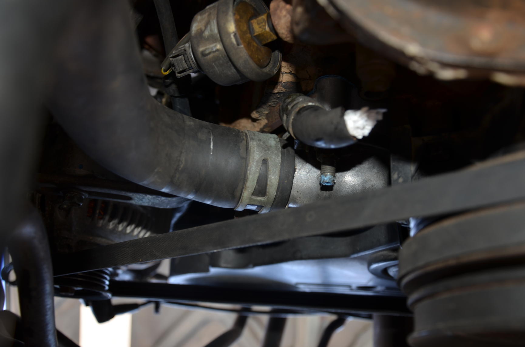

Here are the pictures, you can seethe one that has paper towel in it by the lower radiator hose and the one coming off of the bracket off of the engine, one looks like water for something, and the other looks more important/high pressure.

Oh and its a 1995 with the v6, heard a lot about them, just not too many good things... here are the other pictures blown upDSC_5766.jpg

Is this truck an auto or manual?
The break line looking hose on the engine, is a clutch line, and should attache pretty much straight up on the body to a line coming off your clutch master. Its the felxable line that goes from the body to the engine.
