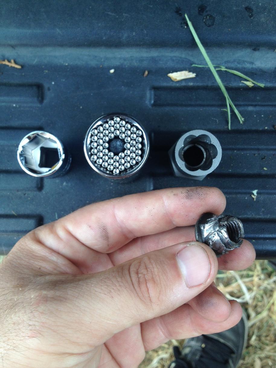

I finally got the last bolt from the pipe that goes from the cat to the exhaust manifold area!
I bought three different round bolt removers, the first two (the left two) didn't quite do the job as the bolt was really seized and really rounded. I bought the last one and as I was trying to remove it I felt like it also may not work but then, POP and it came undone. I am so glad that problem is solved for the most part.
