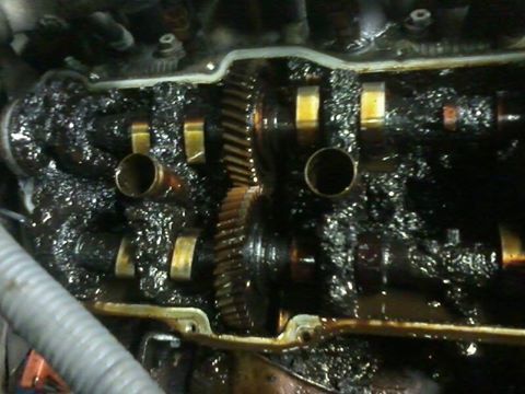

Anyways heres a motor with too much oil, and no oil changes for years.

I recently bought a motor from JDM, having it installed down the street at a shop near me, hope the know about the sensors.
Ouch, that is hard to look at. What are they charging you for the install?
