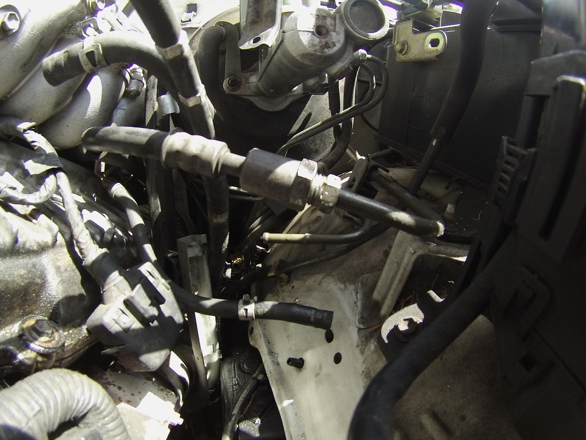

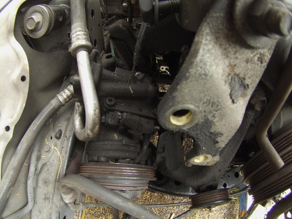

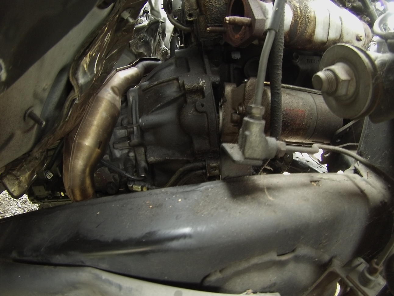

I am taking a look in the light and I am finding little odds and ends that aren't disconnected. I hope that nothing more was damaged.

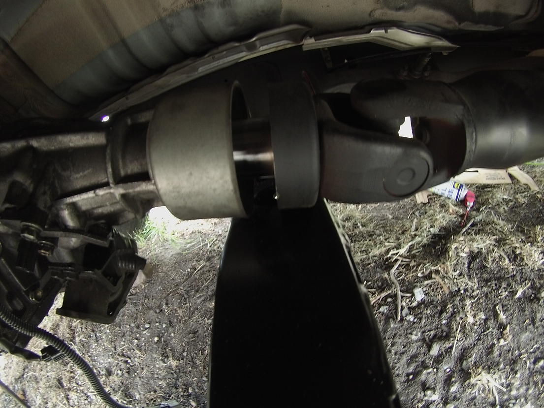

Okay, I got the engine free from the transmission with some firm pulls and jacking up the transmission again. I got the driveshaft back together with the transmission using a rachet strap.

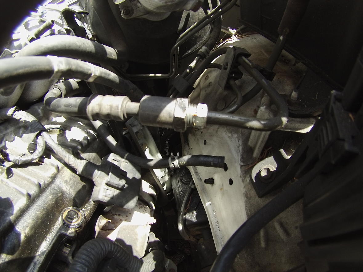

I found some little odds and ends that went unnoticed before and I can only find one more thing that needs to be detached. The problem is that I don't know how to take it apart...
I am using 19mm and 14mm wrenches and loosening the piece apart but the problem is that the more I loosen the piece the tougher it becomes to loosen. I sprayed some penetrating oil to no avail.
How the hell do you get this piece apart?
Pics included.

The two pieces almost feel seized. My guess is that you need to loosen the two pieces and then slip the hose over the hard line to separate the two pieces but I do not have experience with this and I am afraid to break it.

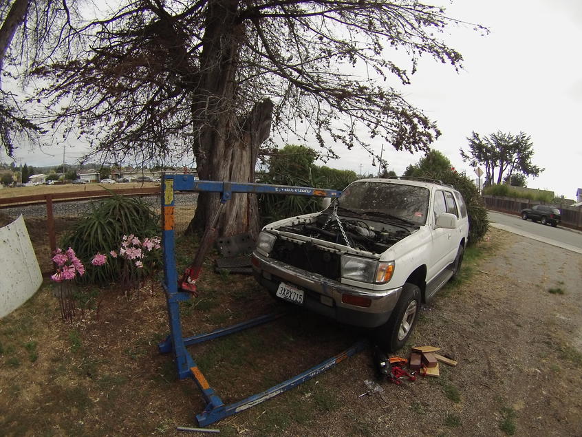

Okay, I got the engine out!!!!!!! :guitar3: :guitar3: :guitar3:
I just build an engine stand to put the engine on...but i don't know how the heck to mount the engine!
There are 4 metal areas where I guess I would put bolts but it didn't come with bolts to attach to engine and I don't know where on the engine to mount it. I have maybe 30 mins left of the engine hoist so I need to get the engine on that mount ASAP
Engine stand set up
if your are trying to mount the engine to the engine stand and if you have your transmission disconnected you use the current ones to hold the engine on the stand. 17mm transmission bolts.
you postion the Engine with the hoist pilot one and adjust the other 3. and then tighten the all up .
PM me if you have any questions Ive done a tons of swaps and upper heads repairs .

I guess what I was doing wrong was not taking the clutch plate etc off :redbrick:
I got it on the engine stand. The only thing is that I only took the clutch plate off and not the flywheel. It is secure but I am not sure if by not taking the flywheel off that I will not be able to fully service the engine.
