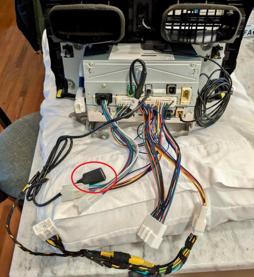

Ok so an update. After speaking to Brian at AutoHarness it appears my USB adapter harness was missing from my order so we have to figure out replacement and then I should have USB. According to him there is also a remaining unused connection point at the back of the head unit. I will show in pictures once I get to my laptop.

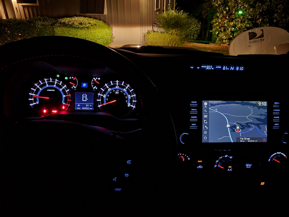

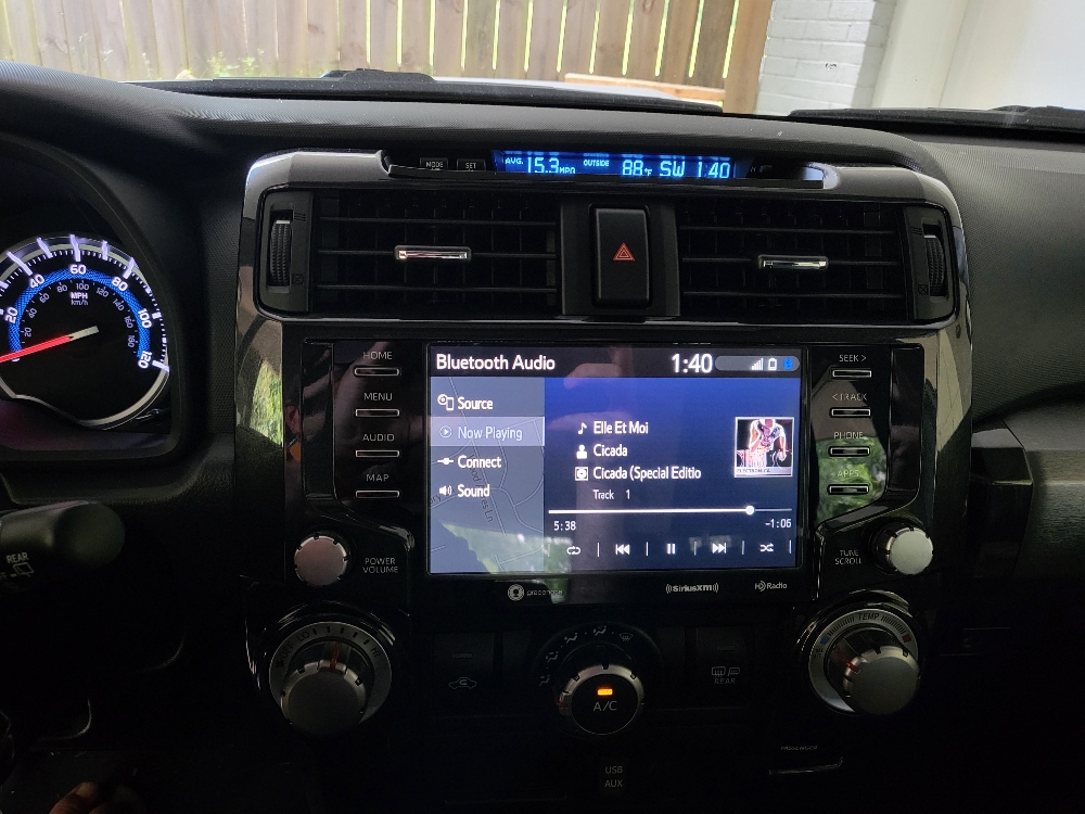

Here is a picture last night. It really does change the cabin. Hopefully USB can get sorted this week. Once Hazards are situation I will do a proper addendum to this.

Can you help clarify what this actually connects to on the USB side in the center stack? I keep seeing images of this USB adapter harness but there is no USB A type connection on the OEM USB port so I am confused as to if there is a second part of this harness that no one is showing or if people are swapping out the OEM USB port which is also not being stated.

I did it! I found a salvage 2020 non-JBL nav head unit and I have successfully retrofitted it into my 2012 TE!

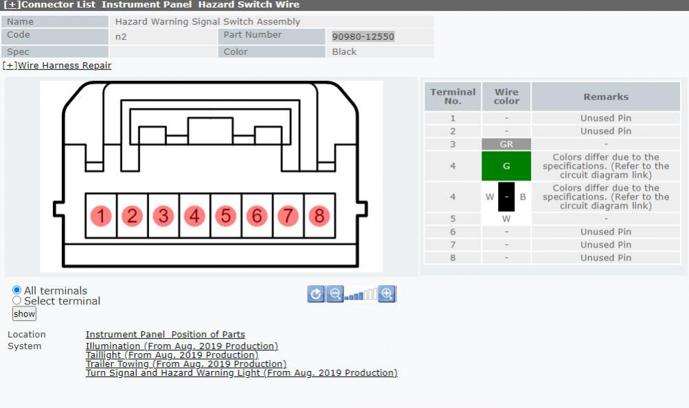

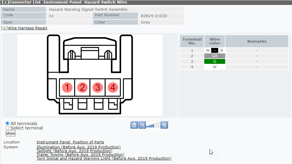

Hazard situation is still pending. Toyota came back and said that the hazard harness for the 2020-2023 MY 4runner is NLA which I find to be absurd. You cannot tell me that you will swap out an entire 4500 head unit if the hazard harness has an issue? That part is $14... Anyways, Brian at Autoharness is looking into this. Here is the pinout of old vs new.

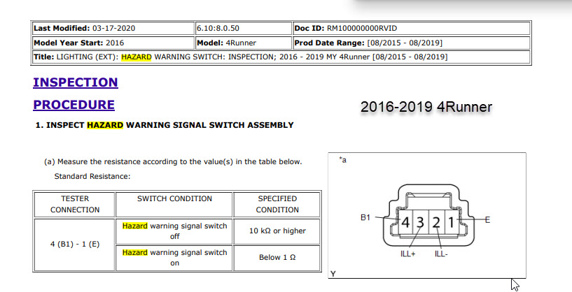

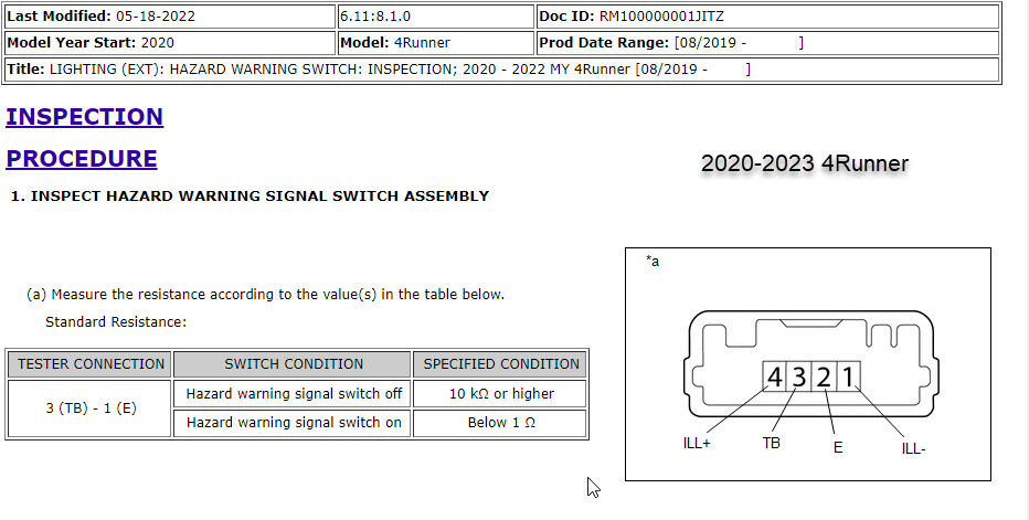

A bit more clarity on the Hazard Switch connectors between the model years.
