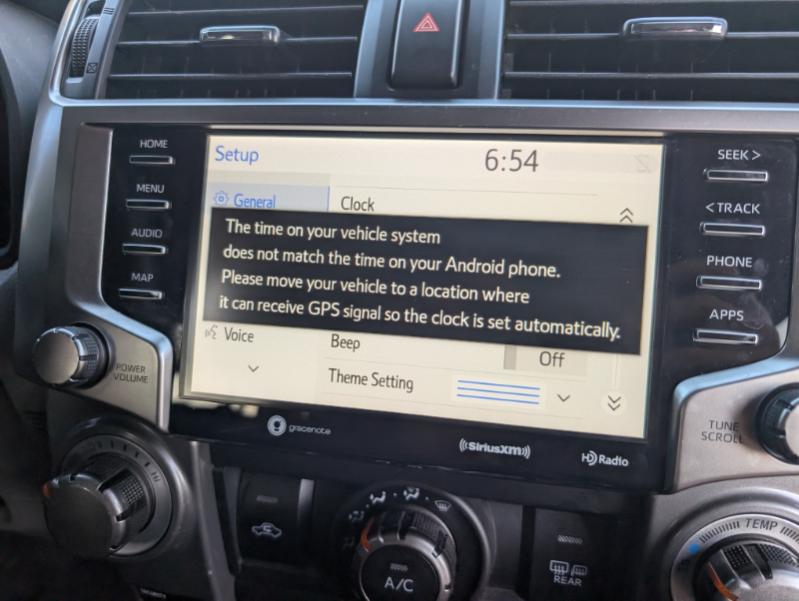

Question on the Android auto side of the swap. I went from 2012 non JBL Nav to 2020 non JBL Non-Nav thanks to autoharnesshouse.com. Everything seems to work. Did the hazard swap. But the auto time set by GPS doesn't seem to be working. I've sent a note to Autoharnesshouse.com and awaiting their reply.
Is there a GPS cable I should have plugged in? Or do I just need to wait for the GPS (in the unit?) to sync with satellites?

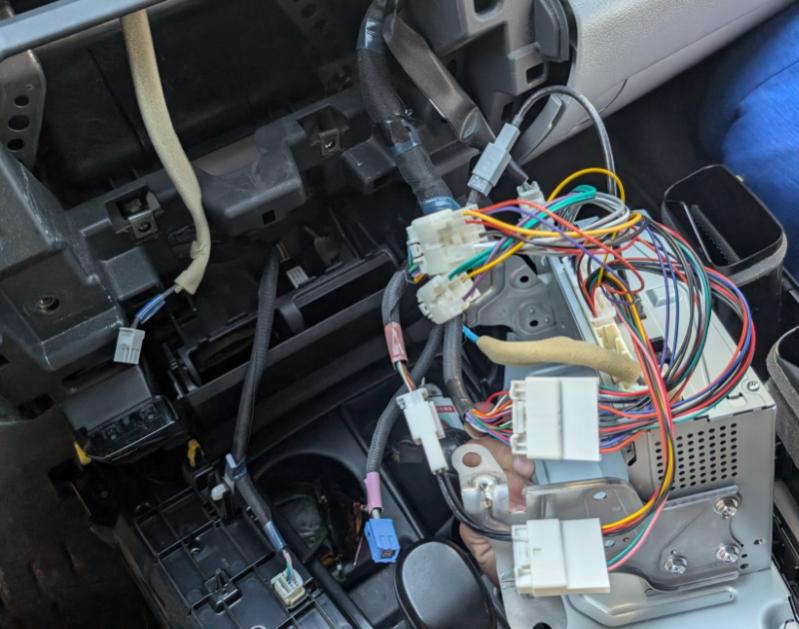

I'll try and post a picture. You'll be able to see the gray plug and blue plugs that aren't used in the swap.
Thanks all! This thread has been extremely helpful in my swap.
Yes there is a harness needed for the gps, from checking what i have saved its the following part.

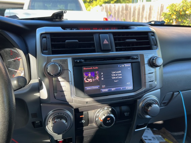

i have a 2011 trail with the basic radio. no nav. basic screnn.
it looks like i should just be able to pick up a 2014-2019 entune HU and plug it in and rock and roll. is that correct or since i did not have navigation to begin with do i need an additional piece?
i notice some listings on ebay have an extra box in the back of the HU or they have a micro SD card with nav on them.
anyone know the difference?
