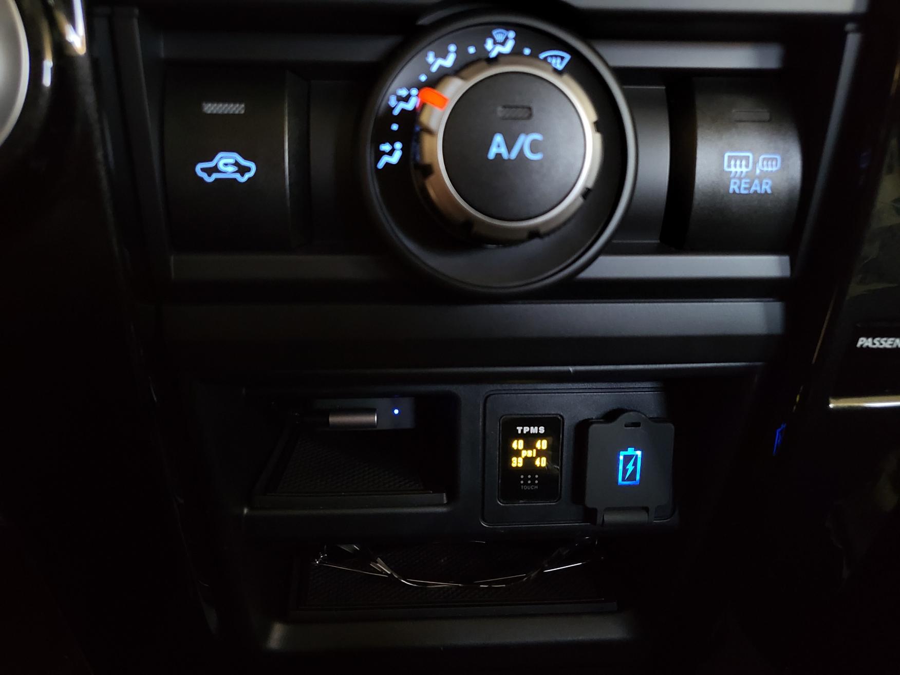

Yes, it is tucked into the cubby. Same issues though trying to find a stable usb cable setup.

I only use Android Auto which only works plugged in via usb 3, which aside from how much uglier it is than carplay, it works great.
I've been meaning to get the Motorola MA1 for wireless connectivity because I've heard great things. Unfortunately, they have been sold out everywhere.
Does your android auto work through the stock USB port? Few of us have noticed that you cannot get a proper connection when using the stock port.
It did at first but then I started having problems with it connecting. To note, the stock usb port in my 2012 is in the glovebox. In the center dash under the head unit where 2014+ models have the USB, my vehicle only has an Aux port. I purchased a third party usb-3.1 adapter and got a really good usb-3 specific cable and it works everytime.
Amazon.com: USB 3.0 Male to USB 3.0 Female AUX Flush Mount Car Mount Extension Cable for Car Truck Boat Motorcycle Dashboard Panel -(3 Feet - 1 Meter) : Electronics
I installed this in place of my cigarette lighter. Don't smoke so not a big deal for me.
