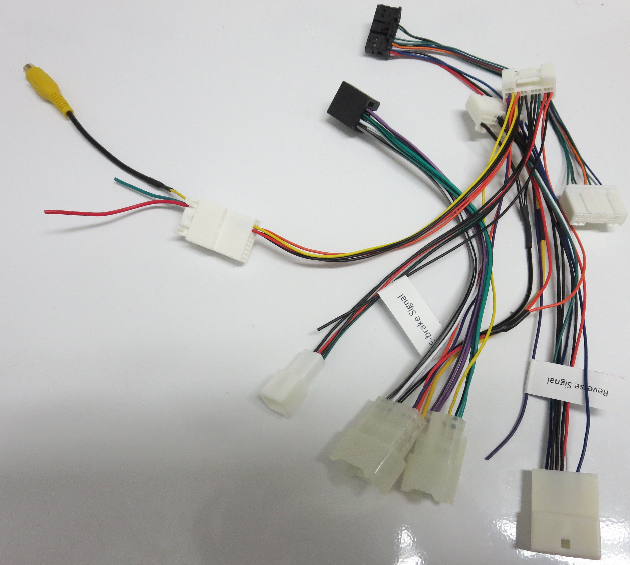

there is a 3rd party making a harness adapter. Reach out to them about it for better information, think they're in this forum somewhere.

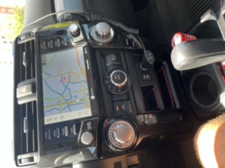

Thought I would add my 2 cents here as I just installed a navigation unit out of a 2021 4runner in my 2011 SR5. I'm super happy with this install. It really updates the interior and functionality of the older 4runners. Only time will tell if the blue lights from the new unit will bother me enough to switch them to orange. Mine didn't have a backup camera, so now I'm onto that to get one installed.
I bought the harness from AutoHarnessHouse and he installed the correct plugs for my 2011, so I didn't end up needing the adapter harness from Toyota listed in the first thread.

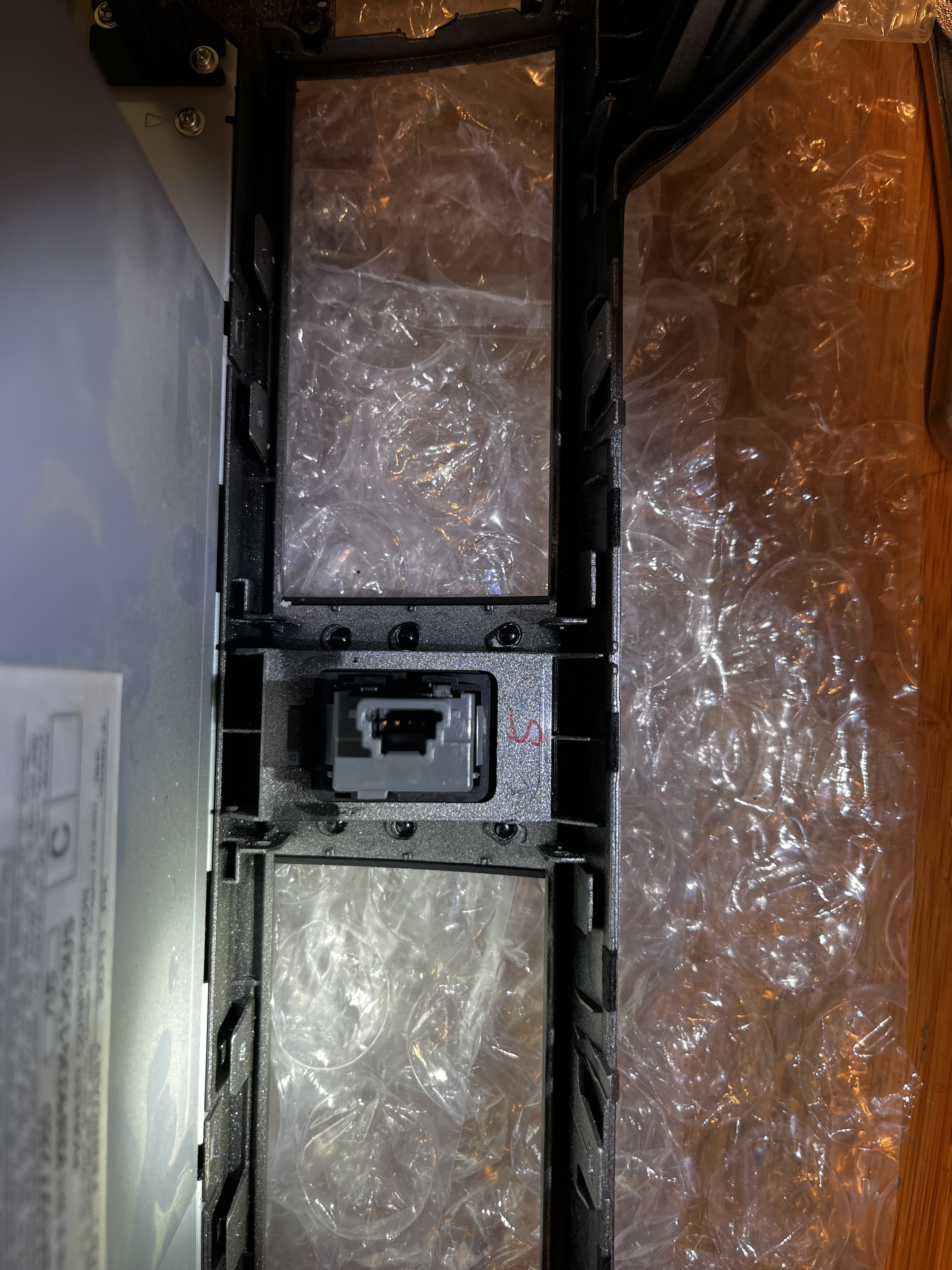

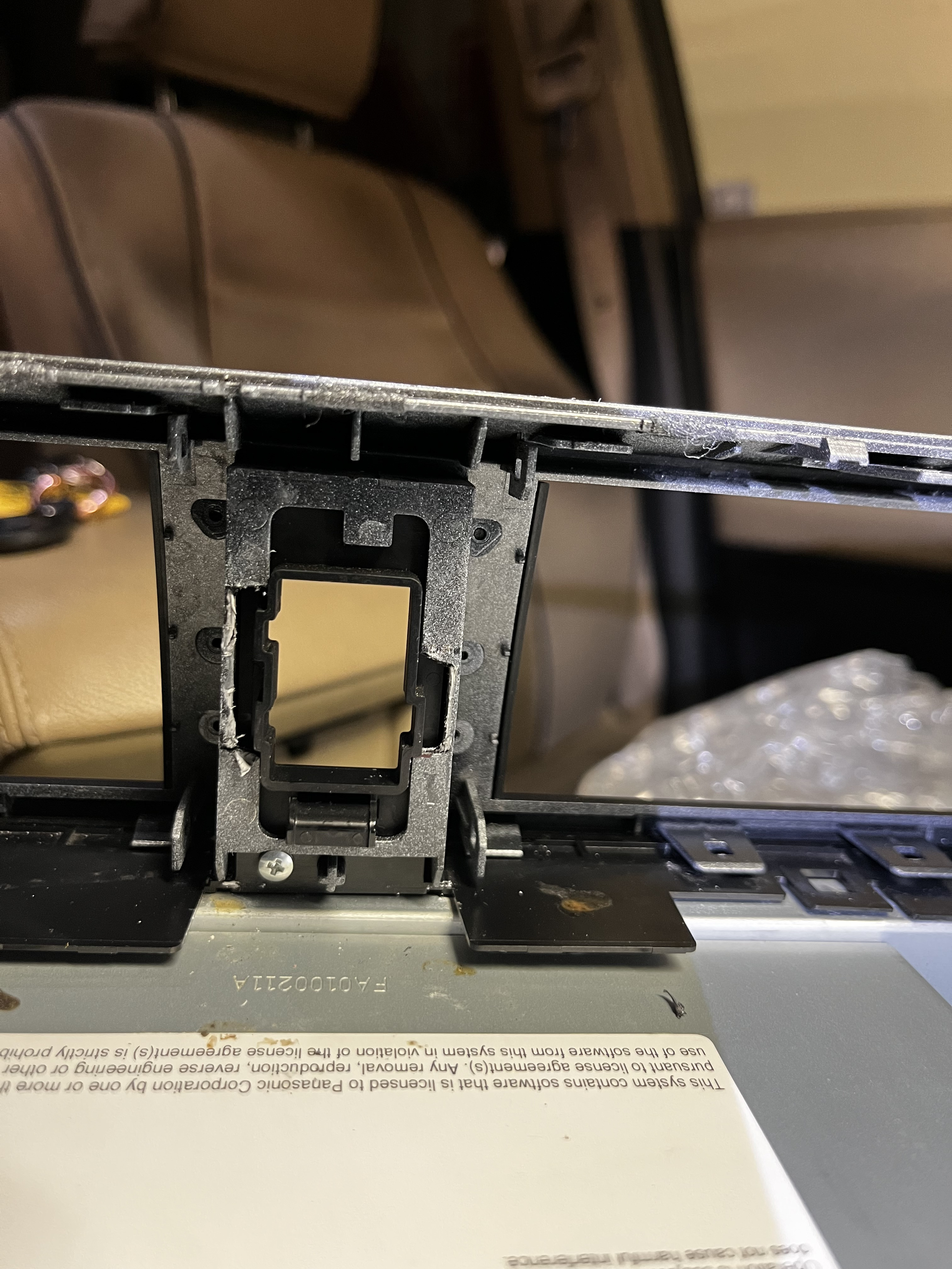

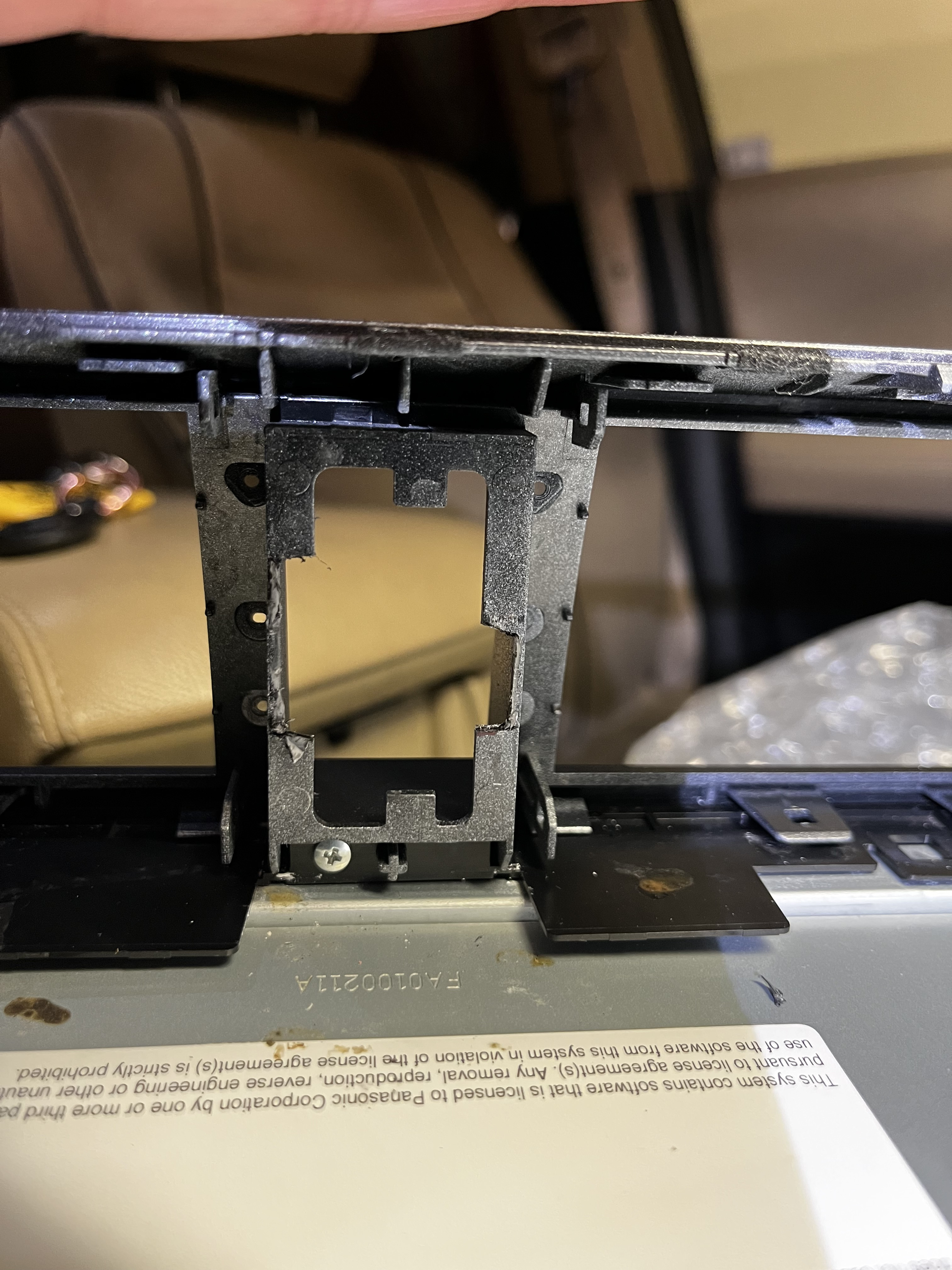

As far as the hazard switch, I was able to remove the hazard switch housing from my original radio unit and fit it in the new unit. This allowed me to keep my original hazard switch. The below photos are from a 2011 basic radio unit. Not sure if the 2014+ are the same.
The six black nubs you see on the sides, you need to grind them off and the hazard housing will pull out.

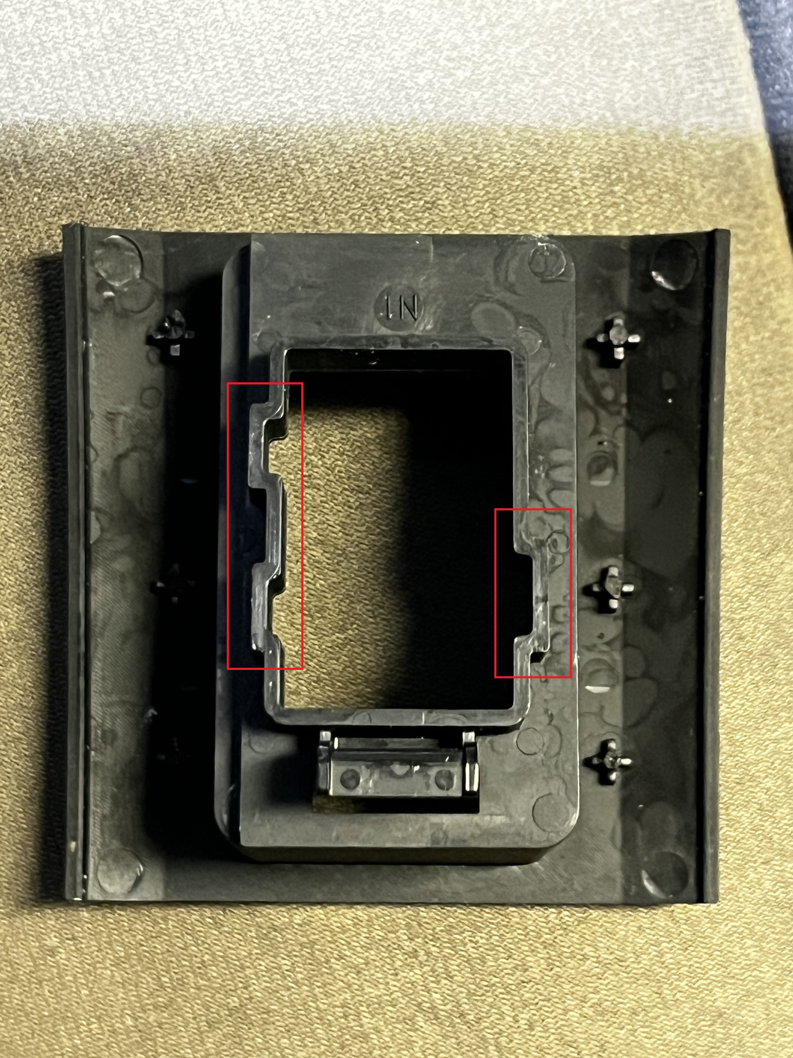

This is what the hazard housing looks like. The three protrusions (two on the left and one on the right) keep the housing from directly sliding into the new 2021 unit.
You have to remove a bit of material from the new unit for it to slide in.
I then just used a dab of super glue on the six nubs and it slide right in and is good to go now.

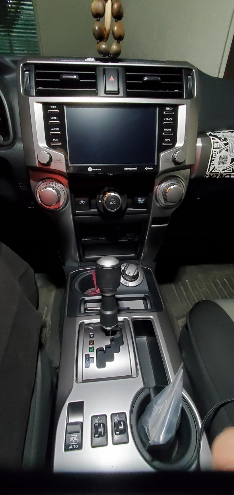

I recently did the swap - adding a 2020+ headunit to my 2015 SR5 PREM with navigation. The only thing I noticed that did not work was the rewind/fastforward buttons on the steering. Also, the up down controls when in phone and other settings. Has anyone else noticed this? Was there a fix? Thanks!
